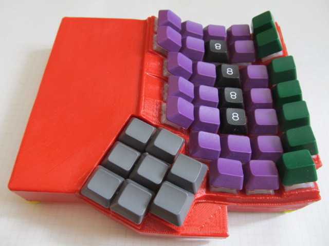

This is the best I’ve been able to do on a keyboard with two flat halves, using standard keyboard switches and keycaps, but I think much better can be done with a more dimensional shape:

I would go for 4 rows (one below home row, two above home row) for a flat keyboard and 5 rows for a contoured keyboard.
Except these 4/5 rows, there should be keys intended to be pressed by thumbs only. One may call it a thumb cluster or thumb row/rows.
More or less I agree with jacobolus except the tilting and therefore (partial) "stabbing" being wrong for the top row. My reasoning is simple: When you want to press a key in the top row you need to move there first from the home row. This movement will result in forward kinetic energy of the finger. Why not to dissipate that energy on the switch press? A rather long key travel of CherryMX helps here.
Without any tilting on the top row you need to stop the finger forward movement with muscles and then actively press down. Anyways me and jacobolus know we disagree here as well as one more point about finger knuckle loading when typing in steno way compared to a normal keyboard way :)
Here is my example which uses some "stabbing" of the first row.
