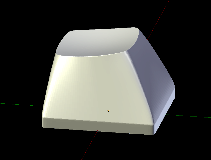

Give me a few days for pictures. I currently have the mill running a proper mold for resin casting a set of prototypes onto OEM stems. For now here is a render

Doubleshots would need to be single piece for sure. The dimensions do not work out well for a 2 piece doubleshot.
A two piece PBT with dye sub would be the easiest and cheapest option but I do not have the capability for dye sub at this point. The more I look into it the more I think I need to develop the capability for dye sub.
- macmakkara
- Location: Finland
Drool~~~~~ that render looks amazing. I could love with Blank PBTs. But at some point dyesubs would BE fantastic.
I don't really care about doubleshots...

Oh my, these as white on black doubleshots would be irresistible!

Just out of curiosity - since the Model M backplate is curved - would there be one spherical key cap mold for all positions? Or would you vary them by row to more closely match SCM?

They are specifically designed for the IBM curved plate and are uniform from row to row like the factory caps. The only thing they share with SCM is the spherical top.
When SCM development resumes I will look into provisions for a BS mount for flat plate customs if there is interest in it.
