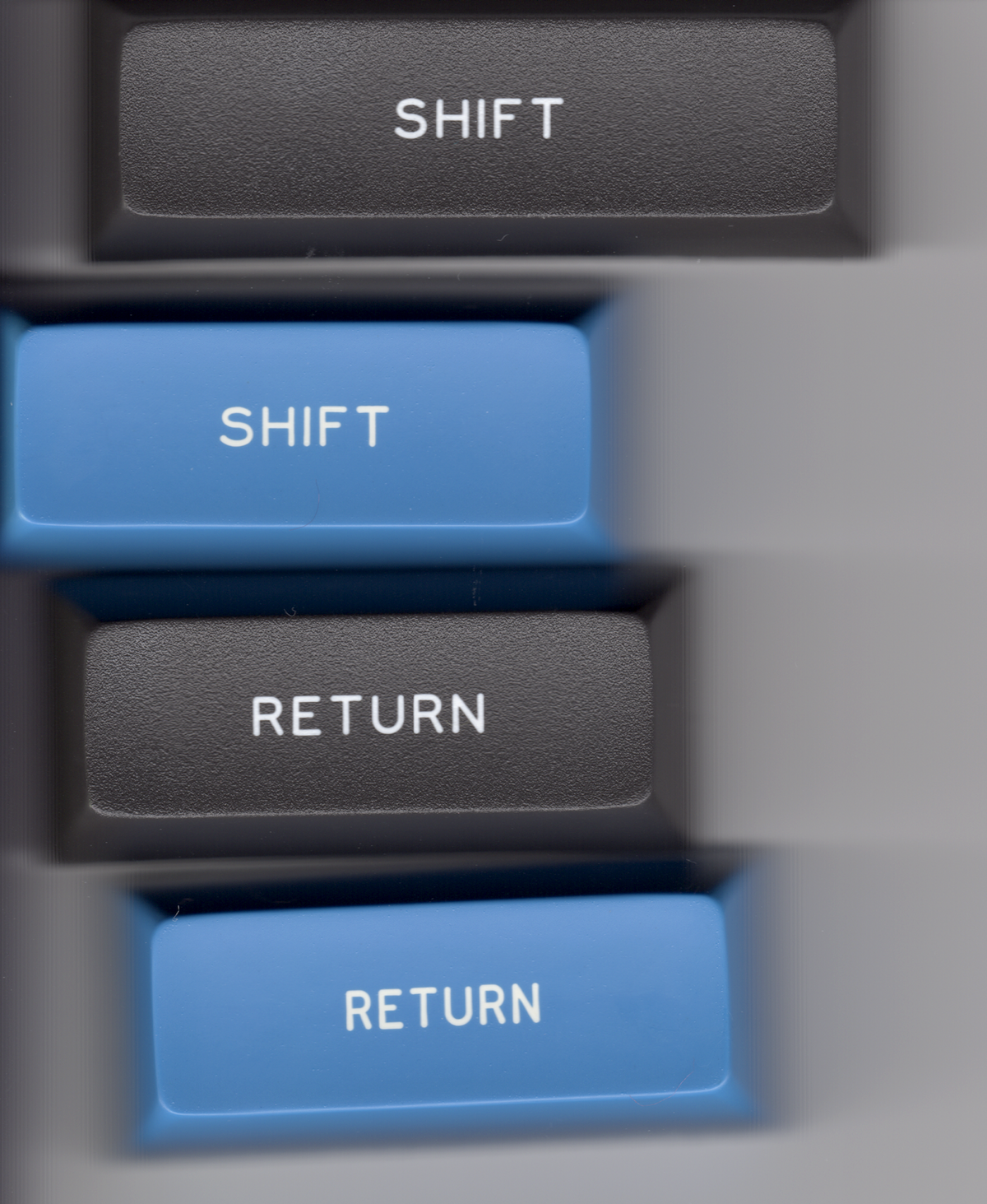

12 Sep 2015, 22:08
Hey Zslane, I finally scanned my caps. A bit on the late side, I know. But I scanned SP's SA and DSA doubleshots side by side. Here's a very small (but still quite hefty) version of the PNG file:
Tiny SHIF T.png (2.12 MiB) Viewed 5704 times
They just don't kern those Ts at all!
If you want the 151 megabyte original (already run through pngcrush etc.) I can share it via Dropbox.
Note how they are similar but not quite the same. The RETURN legends are especially distinct, SA vs. DSA. These caps are DSA Dolch and Round 4 SPH.

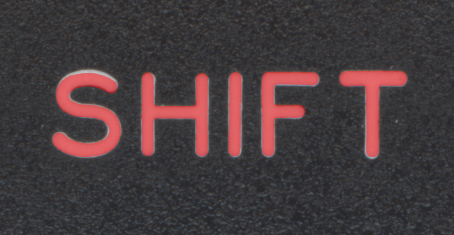

13 Sep 2015, 01:02
A comparison via image overlay shows that all of the letters on the blue SA shift key, with the exception of the S, are identical in shape and spacing as my Dolch DSA shift key. The SA key's S is slightly compressed vertically compared to my Dolch DSA key.
White legend is DSA, red legend is SA
So the question is, what accounts for this difference in just one character? Is this due to the difference in top surface curvature? Is this an example of the variability inherent in SP's manufacturing tolerances? Maybe a combination of both?
Now I can re-trace the S from Muirium's scan and submit a new vector file for SA keys with that version of the S, but we face the prospect of it becoming further compressed if what we're seeing is a curvature artifact. Or I could submit the same vector file as the DSA key and go with the idea that it would look like the scan once it is used on the SA key.
