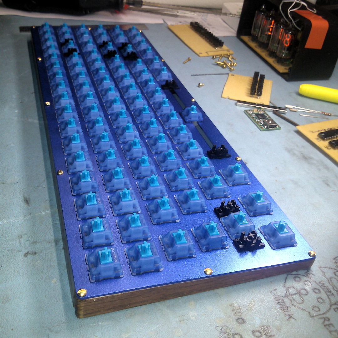

Went ahead and ordered two Teensy 2.0 boards. A Teensy 2.0++ wouldn't really do me all that much use, as I'd need to feed something like 11-12 wires to an external number pad to use it in that manner. It makes far more sense to use a port extender, like how it's done in the Ergodox. Then you can just use a a four conductor cable (like a phone cord or a TRS connector with an extra ring) and communicate with I2C.
Now, speaking of that... I've seen some people use the MCP23017 and others use the MCP23018.They seem rather similar. One appears to be strictly open drain output on the GPIO, one seems to have more I2C address configurations. Is there a preference among the community, or a preferred chip for use with the firmware? I'd love to get it ordered at some point, even if I don't use it right away. Is the Teensy software written to prefer one or the other. Also, how does the Teensy handle hot swapping on the I2C. Can the firmware be configured to gracefully recognize when the number pad (port extender) is disconnected?
richfiles

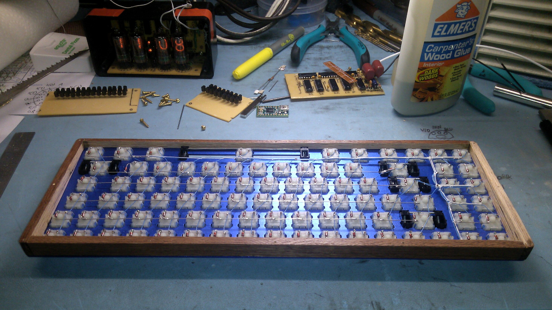

13 Jan 2016, 08:22

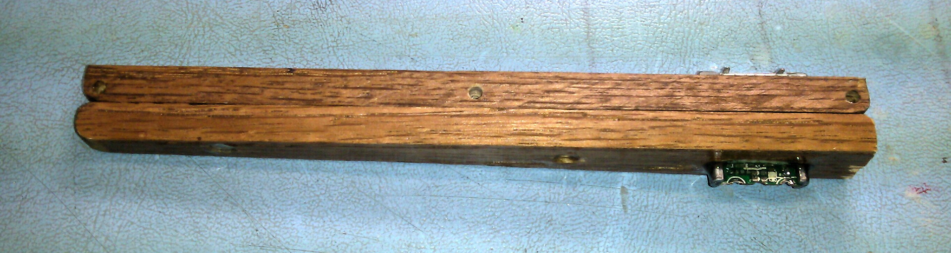

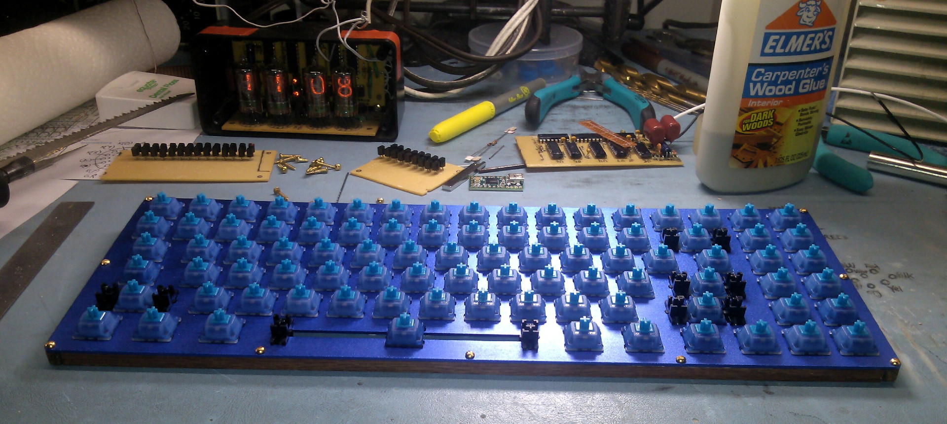

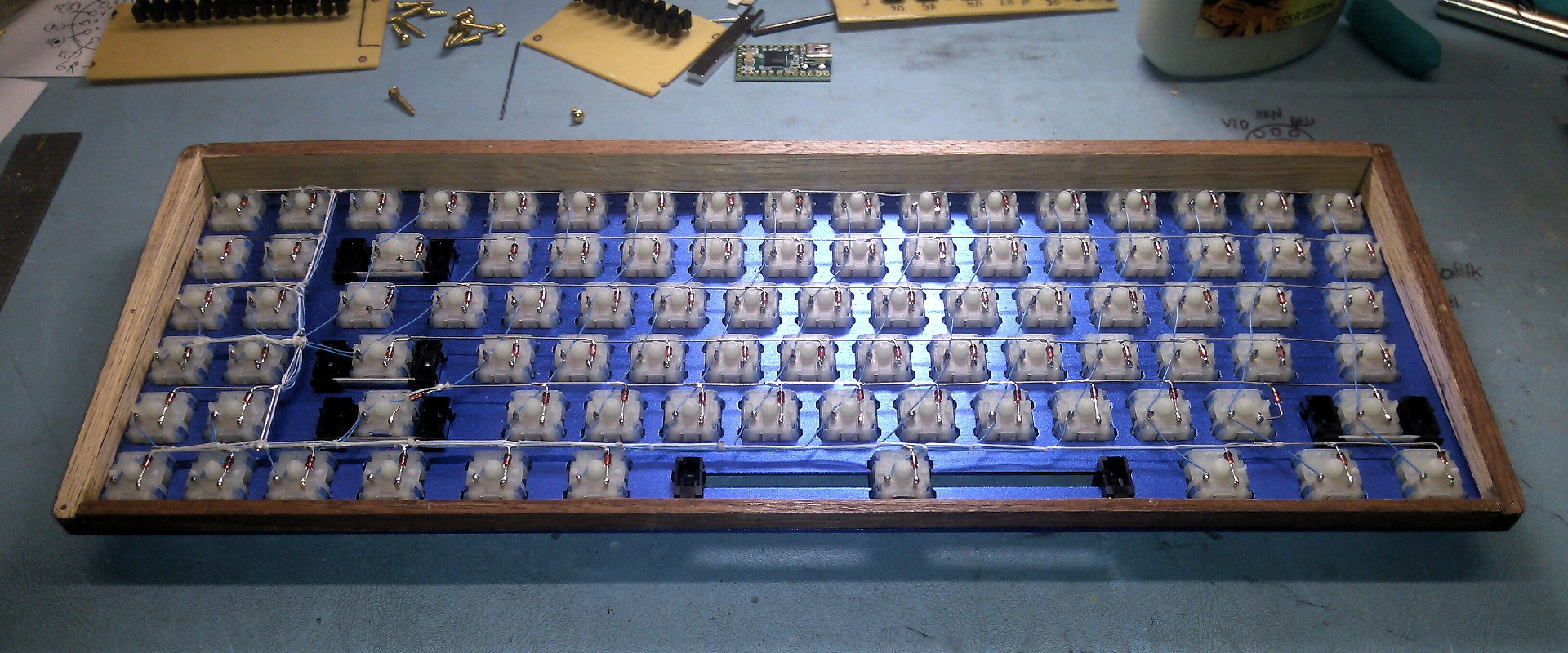

Got the wood trim cut and pre assembled. I'll be taking it back off to make the USB opening, as well as the port for the number pad attachment point. The wood is oak... and was a pain to cut and file. everything was done with a hand saw and a hand file. Used a dremel to pre-drill the holes for the brass screws.
There's plenty room in the back for the teensy to just simply sit beneath the switches.

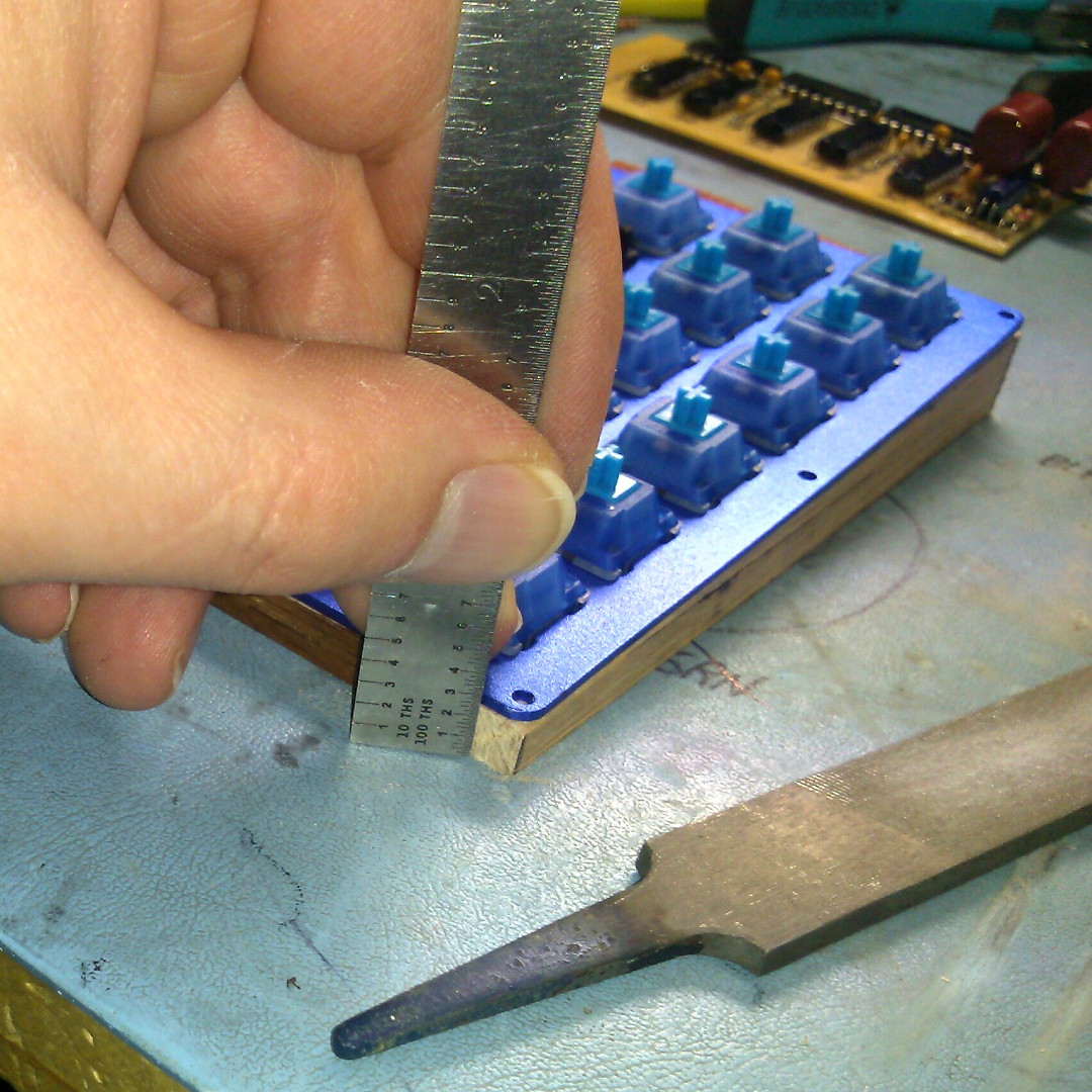

The keyboard is built at a slight angle. The front trim is 1/4 inch thick, and the back is 1/2 inch thick. (6.35 mm in front, 12.7 mm in back)
With the plate included, the current thickness of the front edge is 0.3 inches (7.62 mm). I'm sure a little thickness will be added with the bottom plate. I'm considering some thin copper or brass sheet for the bottom plate. I'll need a plastic insulator to shield the switches. If the copper or brass proves to be too stupidly expensive, I'll just probably cut out a steel plate from the side of a PC case or something.

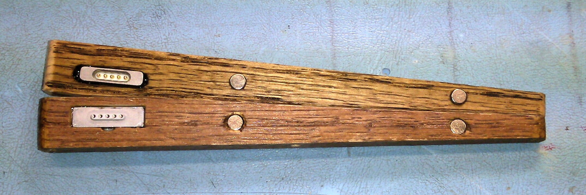

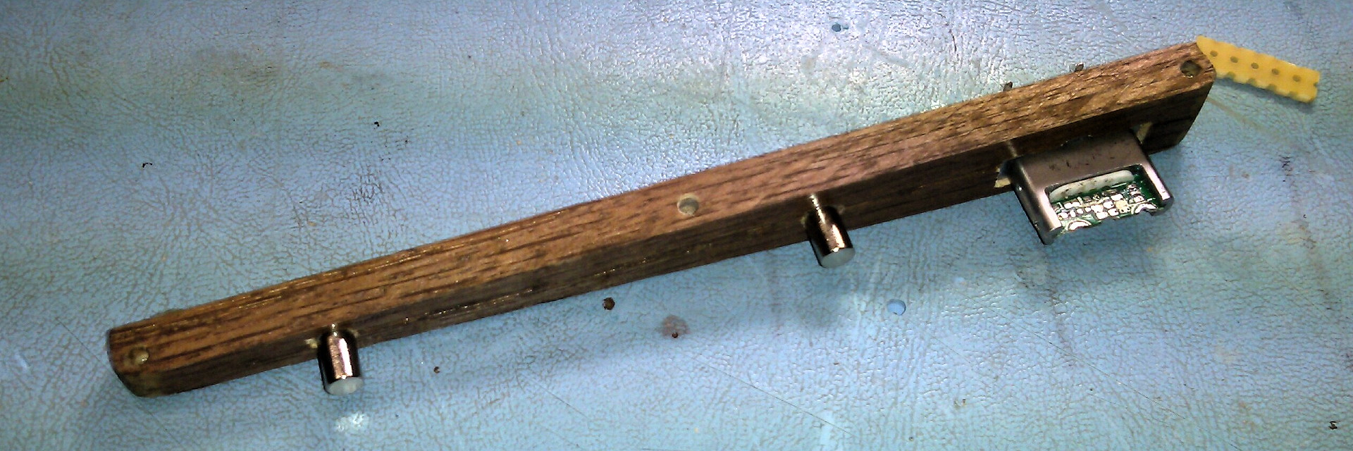

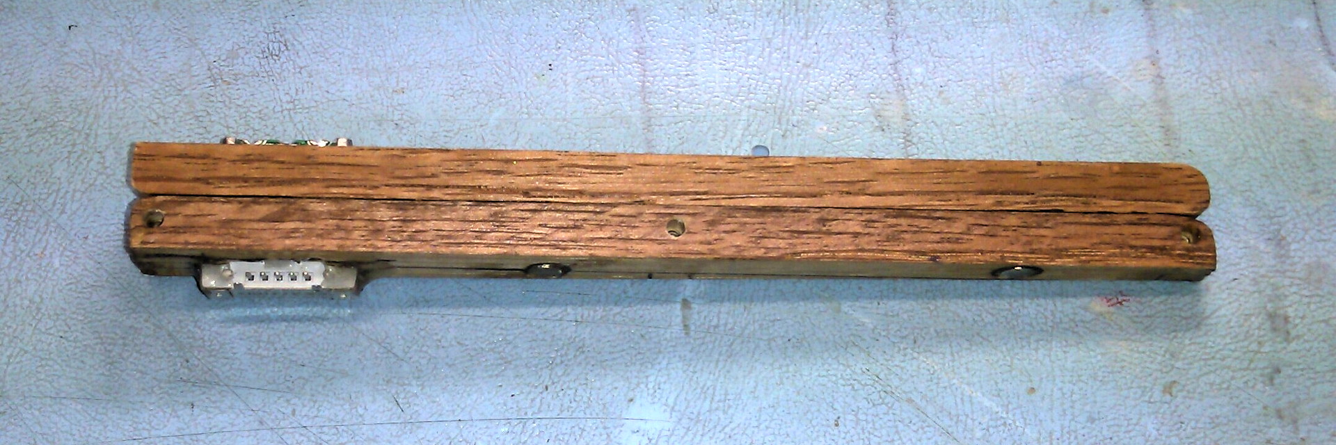

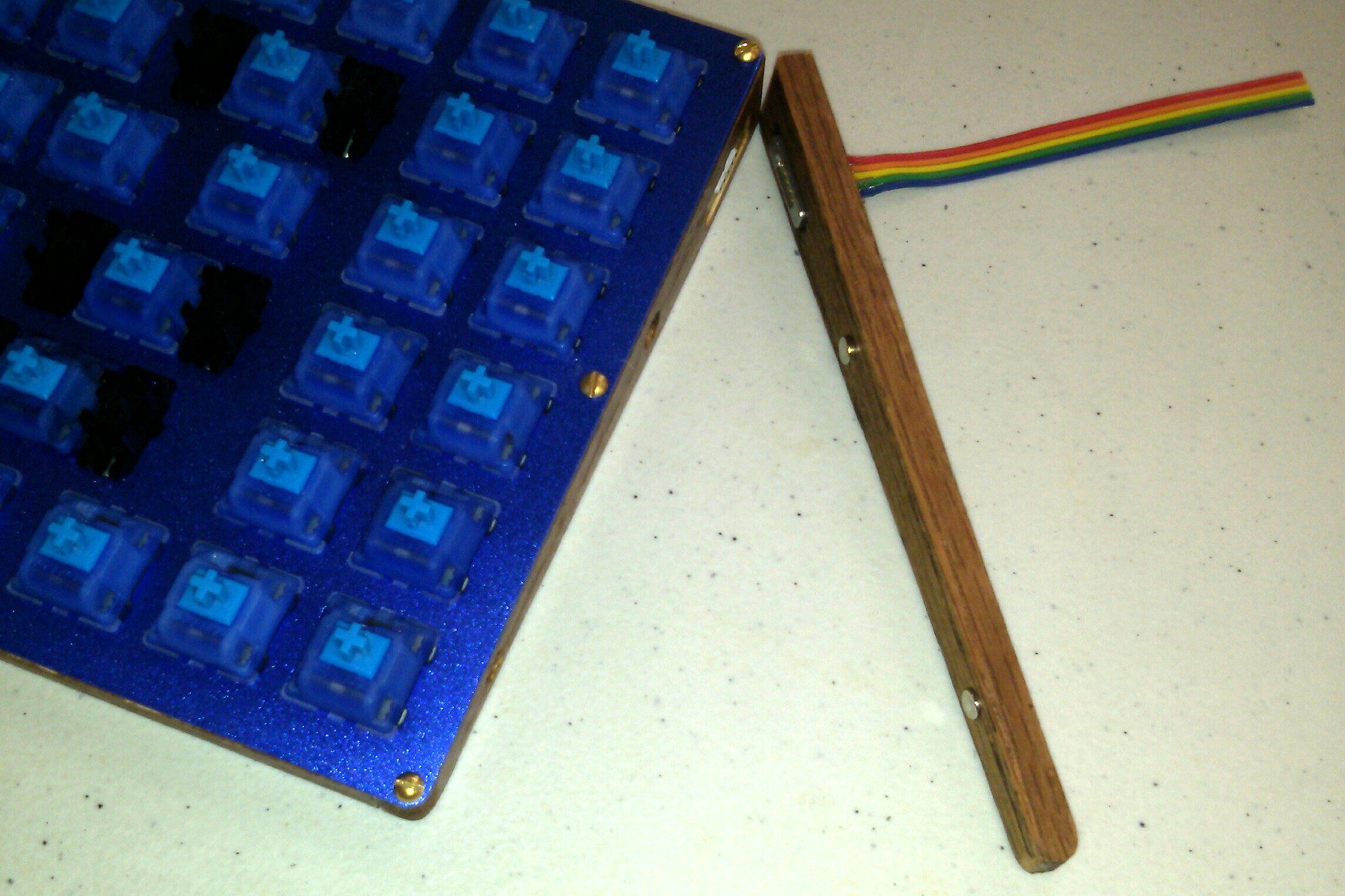

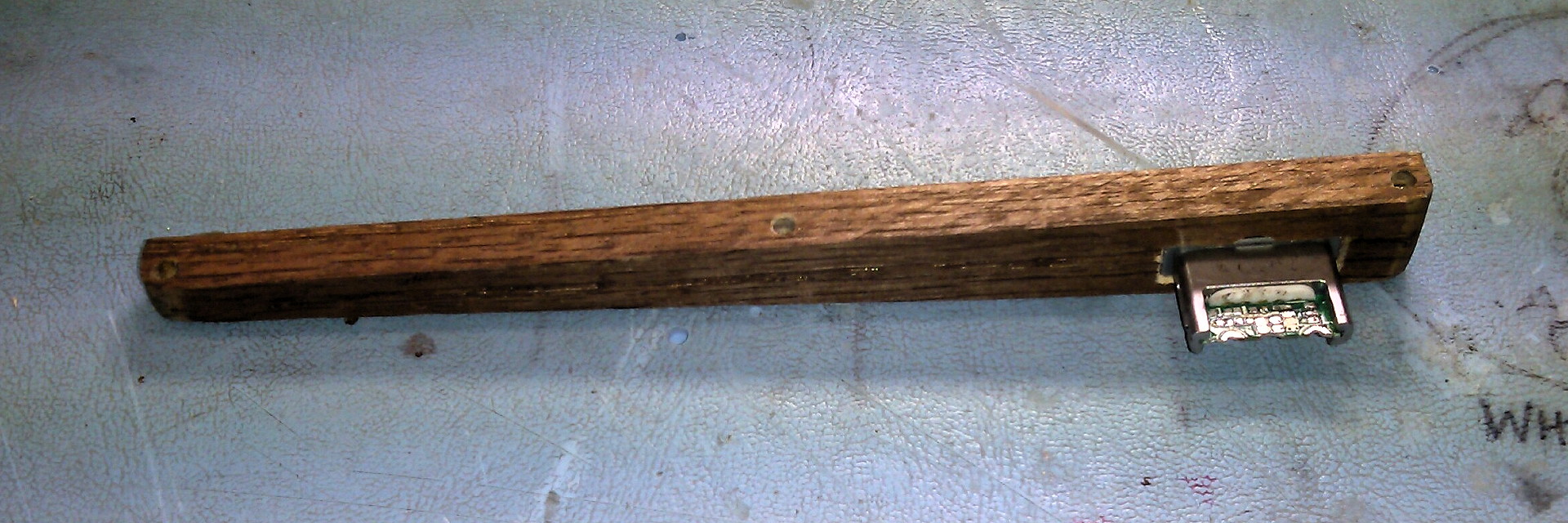

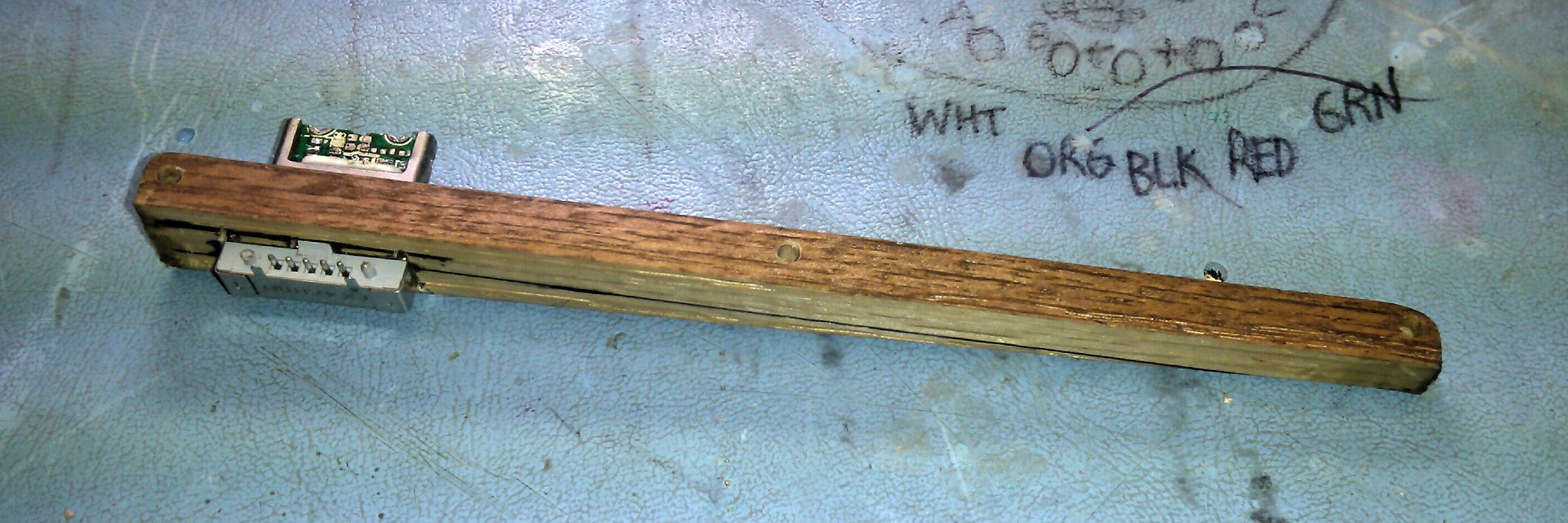

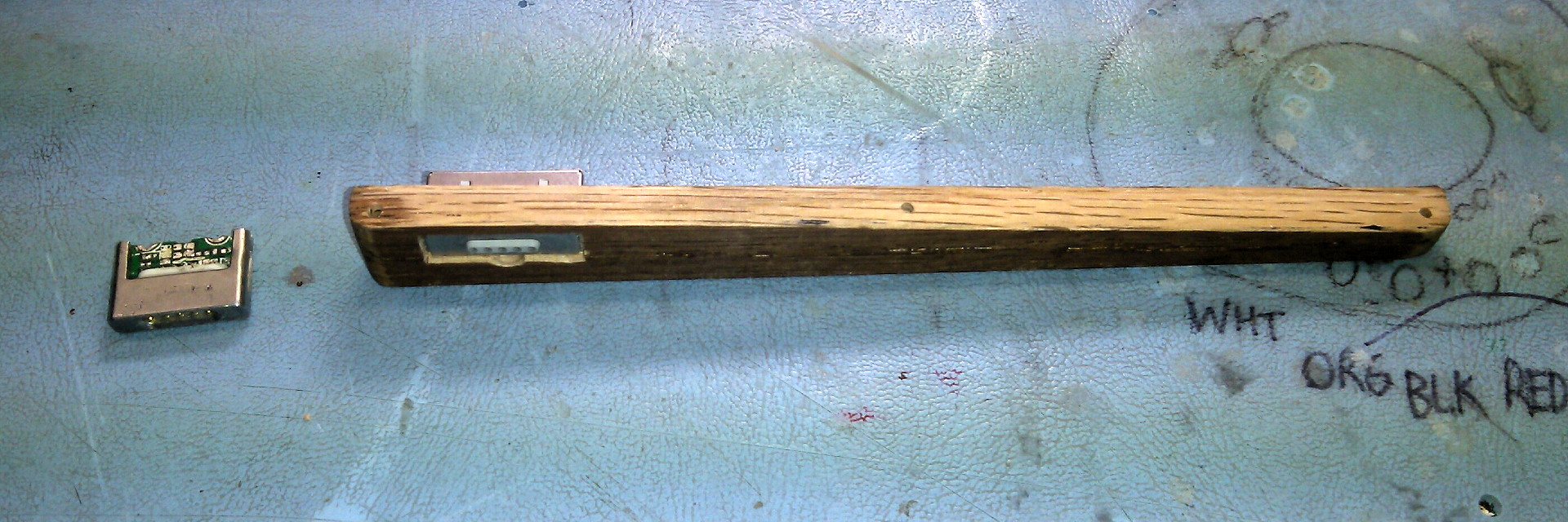

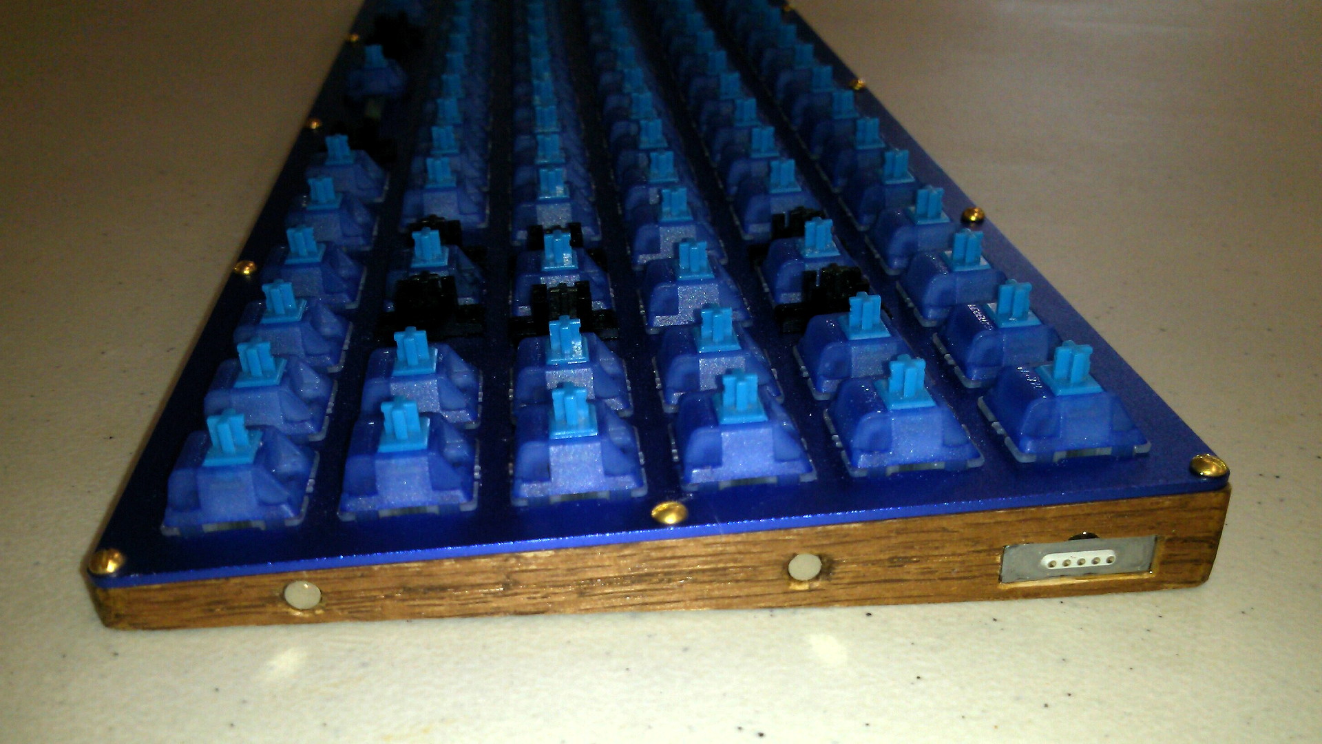

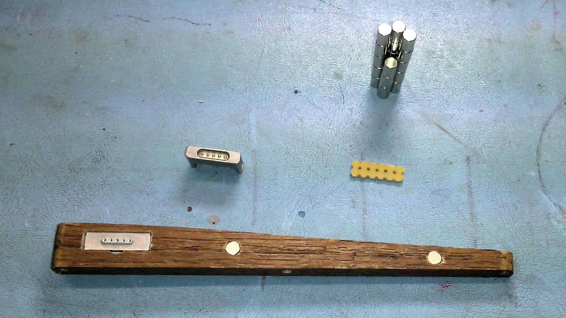

I got the MagSafe connector fitted into the side frame of my keyboard. I have not finished the frame parts for the number pad yet... It got late, didn't wanna disturb the neighbors with late night sawing and drilling and filing... I might have thought about it though... :evilgeek: :lol:
Pics should be self explanatory. I have not re-stained any of the cut areas of the wood, so ignore the lighter color, for now. The magnetic receptacle and the magnets are both fitted. The MagSafe receptacle sits slightly inset, with the contact plate being flush with the edge of the wood. On the number pad, the steel rimmed plug segment will protrude just slightly from the edge of the number pad frame, and will slightly insert into the side of the keyboard. The magnets on the number pad side will also slightly protrude, to form a positive mechanical lock when the two separate halves are fitted together.
I'll pick up some 5 minute epoxy from the store tomorrow, to set the magnets and connectors permanently. I might try to use a thin bead of wood glue around the seam of the MagSafe receptacle, since good wood glue accepts wood stain, and I can basically fill in the gaps around the connector. My cuts were not... ideal... Anyway, close enough. I can work with what I have, and the gap is still technically tight enough to hold the connector in place without the epoxy applied yet. Oak is a pain to work with, and I ain't redoing that piece! LOL ◴‿◶
Got the notice that Signature Plastics has shipped the Danger Zone keycaps to Massdrop, and they should have them by the end of the week. I'm so excited! My first custom keyboard is a mere couple weeks to completion! Anyway, I've "ejected" the Commodore 64 keys. Watch that canopy! :lol: It was a cool novelty, and useful for testing the feel of the keyboard, but we all know what keys are really intended for this keyboard... 8-)
So, I have pics, enjoy the build progress so far.

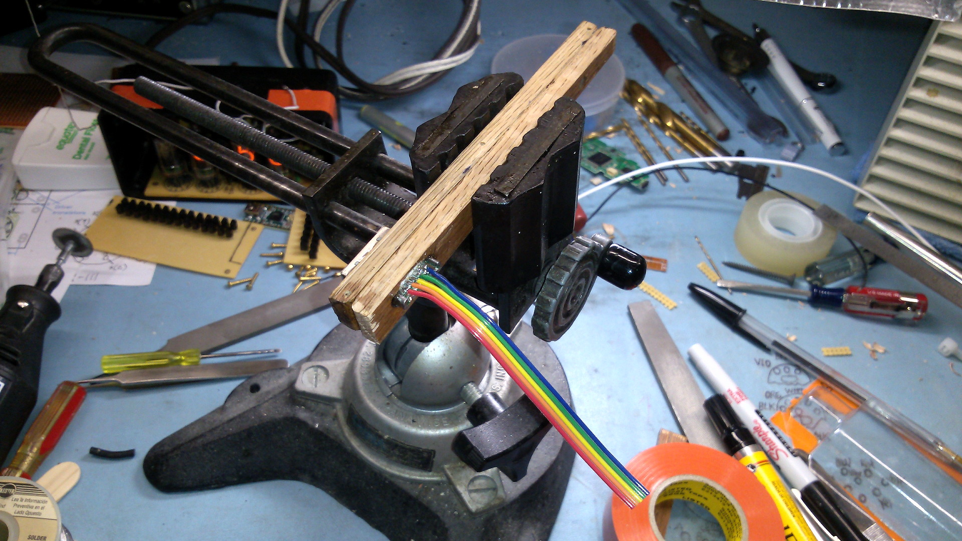

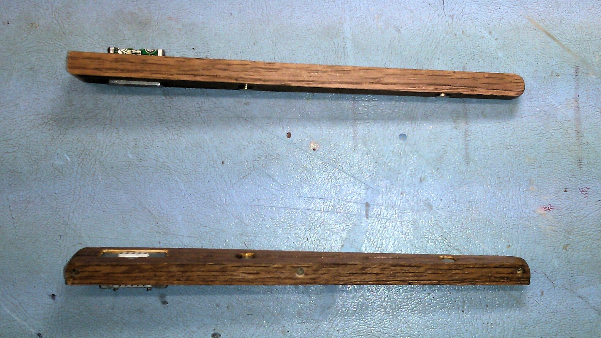

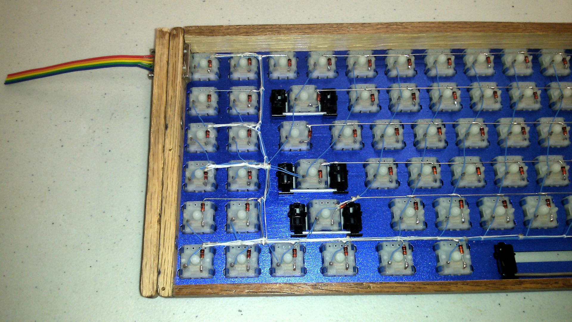

Well, the MagSafe based number pad attachment has been completed. It comes together with a solid snap! I'll be setting the number pad frame parts aside, till I can get a plate made for the number pad. I can now reassemble the frame to my keyboard, and once wired in, I'll be ready for a number pad upgrade whenever I have the opportunity to build it.
https://www.youtube.com/watch?v=YFRzutJ8VVA
The magnets are inset on the keyboard, and protrude slightly on the number pad side. This helps create a positive lock and keeps everything nicely aligned. The connector on the keyboard is flush, but the magnetic portion is inset. The steel shroud on the number pad side slightly protrudes, surrounding the contacts, and fitting into the inset portion of the keyboard side of the connector. That definitely helps with alignment.
The most important part... It passes continuity tests. None of the 5 pins are electrically shorted to one another, and I have proper conduction from one connector to the mated connector. It is ready for installation!
richfiles
04 Feb 2016, 00:52
Doesn't it kinda look like the handle of a steak knife? :mrgreen:
Got the part mounted. Just enough clearance to clear the wires. Too tired after work to solder it today... Work was easy... Stupid Fallout 4 kept me up late! :lol:
It fits NIIIIICE!!! It self aligns nicely, as well.

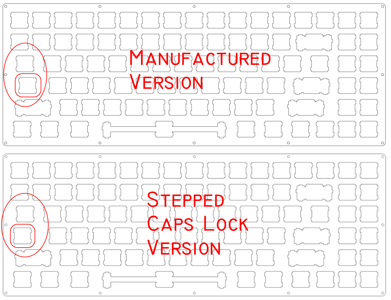

Now for the bad news...

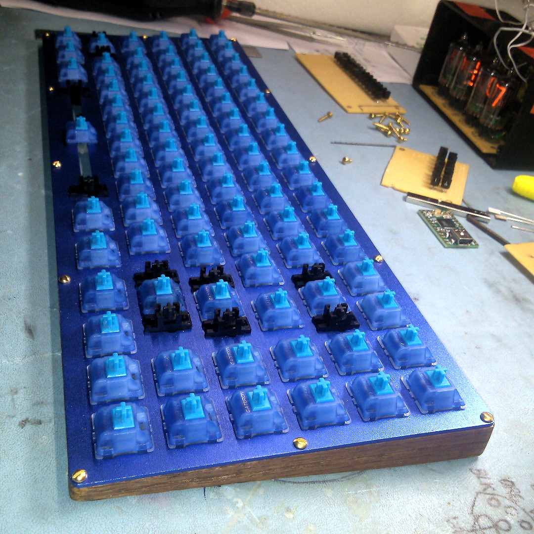

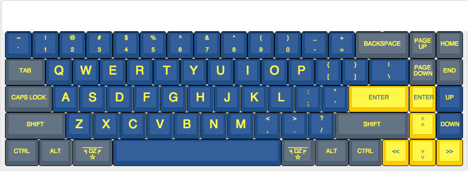

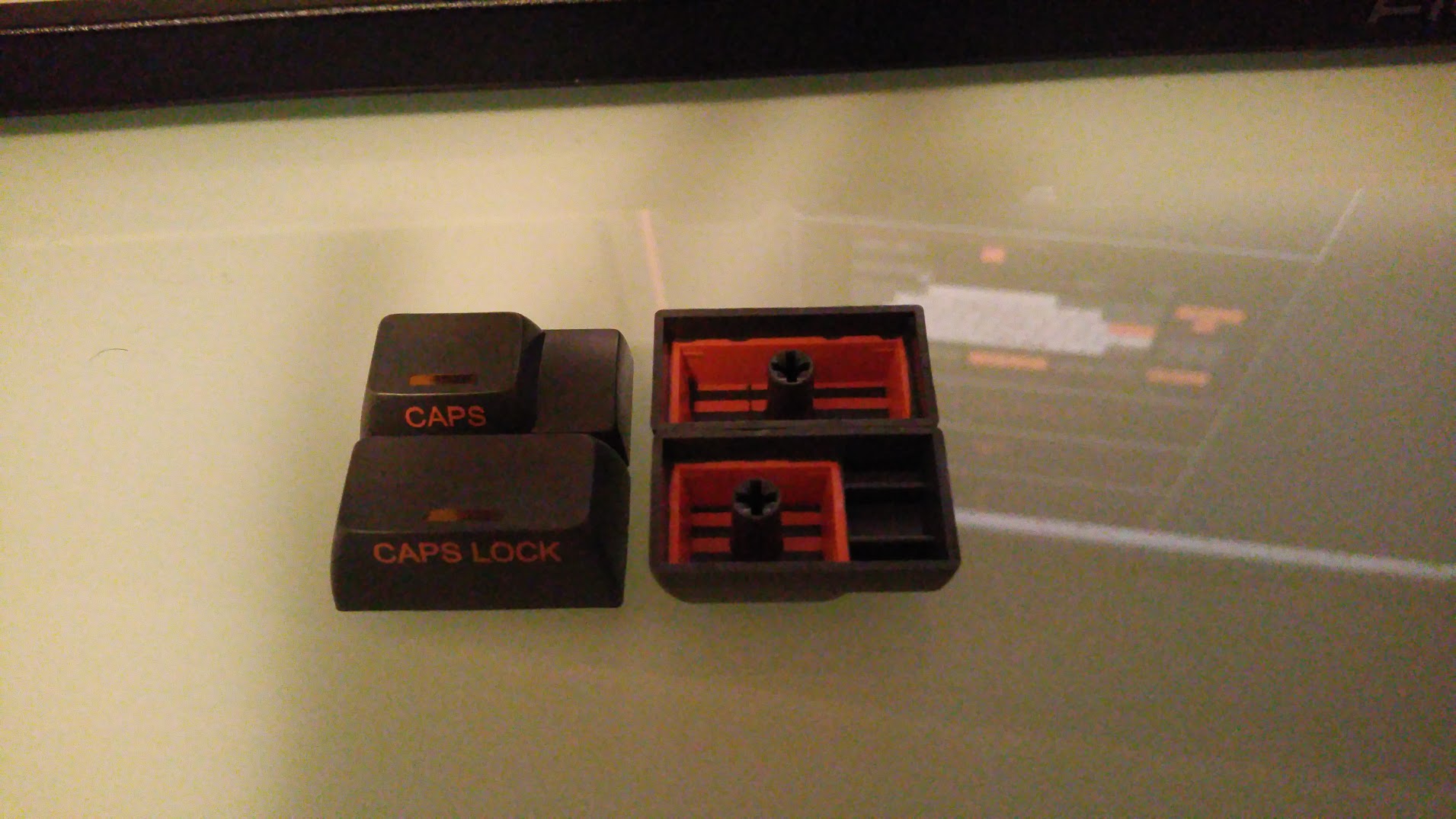

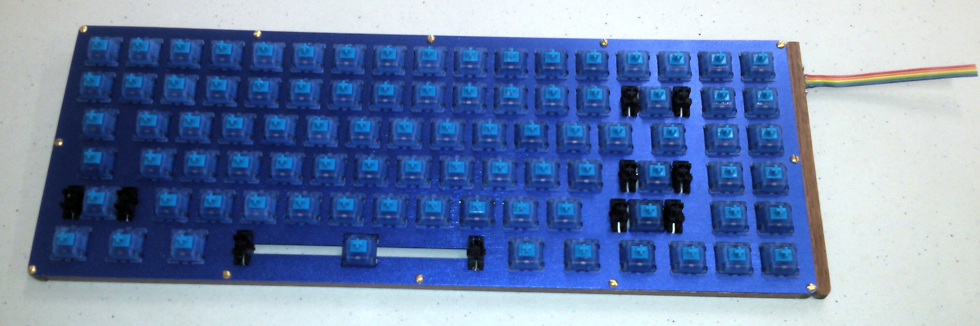

I was casually looking at keyboard stuff, and came across this HORRIFYING picture...
Oh, say it ain't so! When I was FIRST doing this layout, I mentioned (back on page 22 of the Massdrop Danger Zone discussions pages) that I wanted to use the stepped caps lock, and asked if the stem position was centered...
https://www.massdrop.com/buy/danger-zon ... alk/277804
"Also, is the stem on the caps lock key centered with no stabilizer? I intend to use the stepped caps lock key. The plate was generated based on the stock Keycool 84 layout, with my modifications performed to it. I don't wanna order a plate and find the caps lock key is wrong."
I was told it was fine, but having seen that picture, doubts were raised. I didn't know if it REALLY was fine or not? The comment that said it was fine never actually mentioned the Caps Lock, just said the layout was fine. I didn't remember if I knew how to do stepped keys in the layout editor back then, and got terribly worried that now, that this close to the finish line, I might have screwed up. The example pic from the layout editor back then had a standard Caps Lock key shown, even though I mentioned wanting to use the stepped cap. If I had submitted that DXF file for the plate manufacturing... Dang it... This is bad... :cry:
I really hate the thought of not being able to use my stepped Caps Lock on this thing...
So, I checked it... DANG IT! I've confirmed it... my plates are wrong
I re-ran my current keyboard layout through the plate builder, and the Caps Lock switch is offset to the left of the tab switch, when a stepped Caps Lock is indicated from the Keyboard Layout editor.
My plates have the Caps lock offset slightly right of the Tab switch. ╱)⤳⁔⤺(╲
Does someone actually KNOW what the exact distance of offset is? Looks like the only way i'm getting a stepped Caps Lock is to grab a file and mar up my pretty little anodized plates to make this work. I'll have to cut a filler and epoxy it into the gap left by widening the switch opening in the plate.
Matt_
05 Feb 2016, 01:44
You'll have to offset your hole by 4.76 mm to the left in order to use your stepped capslock.
That's a bummer, but you should be able to correct it. File down the left side of the opening (put masking tape on your plate in order to avoid scratching it), then glue a 4.7mm wide piece of something (possibly with a larger piece of something under the plate to support it) to prevent the switch from moving laterally. Good luck!

I may try to turn this to my advantage. My original plan was to drill a hole in the stepped area of the caps lock key and mount a light pipe to redirect the light from the MX LED to the hole, as a caps lock indicator. I realize I can do it even easier now. If I can do it right, I'll drill my hole, and glue a tube to the hole, to make the light off. The tube will pass through a hole in the filler piece, and my LED will be below the plate.
I got some blue model paint too, so I can get it "close enough" to the color of the plate.
It might almost look intentional... :roll:

I've been looking into things, and it seems that there is already a documented stem modification for making a stepped caps lock fit a keyboard designed for a full caps lock. I think I'd rather give that a shot, than start hacking up my plate. There are gracious people who have already offered their Danger Zone stepped Caps Lock key (since some keyboards just don't use it), so even if I dont get the key cap mod right initially, I DO have backup options if I go that route.
Still gonna mod the key with a lighted window to indicate if caps is locked or not.

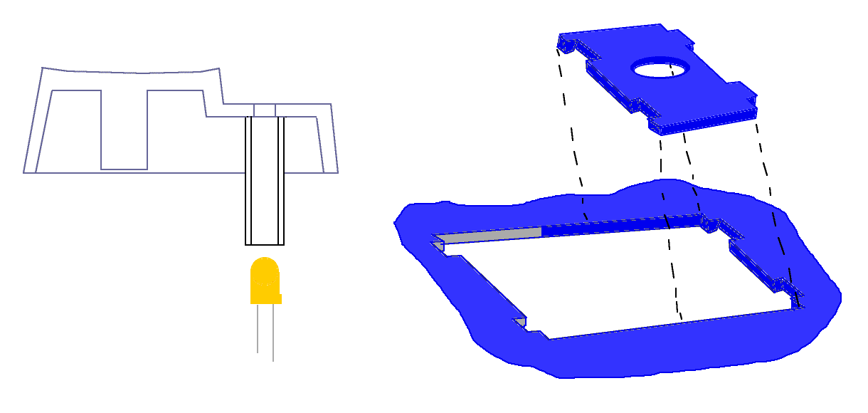

I have also been considering underlighting. I can't say I've really been a fan of it in the past, but I can see the value in acti g as a homing guide when ambient lighting is otherwise low or off. I have found some amber LEDs, that while not as cheap as I would care for, will arrive shiped in 2-3 days (local company). Still have not decided if I will dimly illuminate all switches, or just get the borders. Since I have no PC board, LEDs would be a potential problem. If I habd wire them, I prevent the top housing from being removable.
Do the tiny SIP sockets that people use for LEDs fit inside the lower housing, under the LED? Never tried. I could hand wire SIP sockets in, if that indeed works, then I'll be okay.
Matt_
10 Feb 2016, 18:24
Yes, SIP sockets fit inside the switch and won't prevent you from removing the top. However, you'll probably need a PCB to keep them in place — hand-wiring them would be a nightmare.

I did ultimately decide to go ahead and install LEDs in all the switches, not just select ones. I'm aiming for VERY dim lighting, so I used diffused 12 mcd amber LEDs. The intent is to mimic the low intensity instrument panel lighting of aircraft panels.

At least I can FINALLY install my USB connector. Thing FINALLY arrived from the UK. I've already figured out how to install it securely. I'll use the dremel to cut a slot on the inside of the back trim panel for the PC board to slide into. I'll drill a large hole and file it rectangular for the USB plug to pass through, and I'll drill two small holes perpendicular to the PC board and lined up with the mounting holes to pass a pair of screws through. Since the PC board slot will be on the inside, I can get away with a crude cut. I just have to not cut through the wood completely. It won't be hard, thankfully. A small square of proto board soldered to the end of it, and the other end of the proto board soldered to the teensy will provide the anchor point I need to secure it safely.
