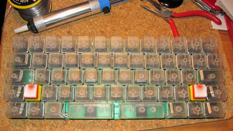

thats looking sharp...how wobbly are the 3u keys without the stabilizers?
Soarer
14 Nov 2011, 14:02

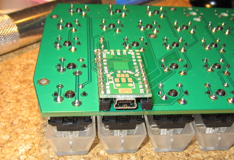

Very! But they work fine over about a two key width in the middle. What's annoying is that there is room on the PCB to fit the stabilizer holes for these 2.75x right shifts, but I didn't think to add them. If I drilled them now, one or two tracks would have to be patched. I might do that once I've got some firmware running on it :-)
