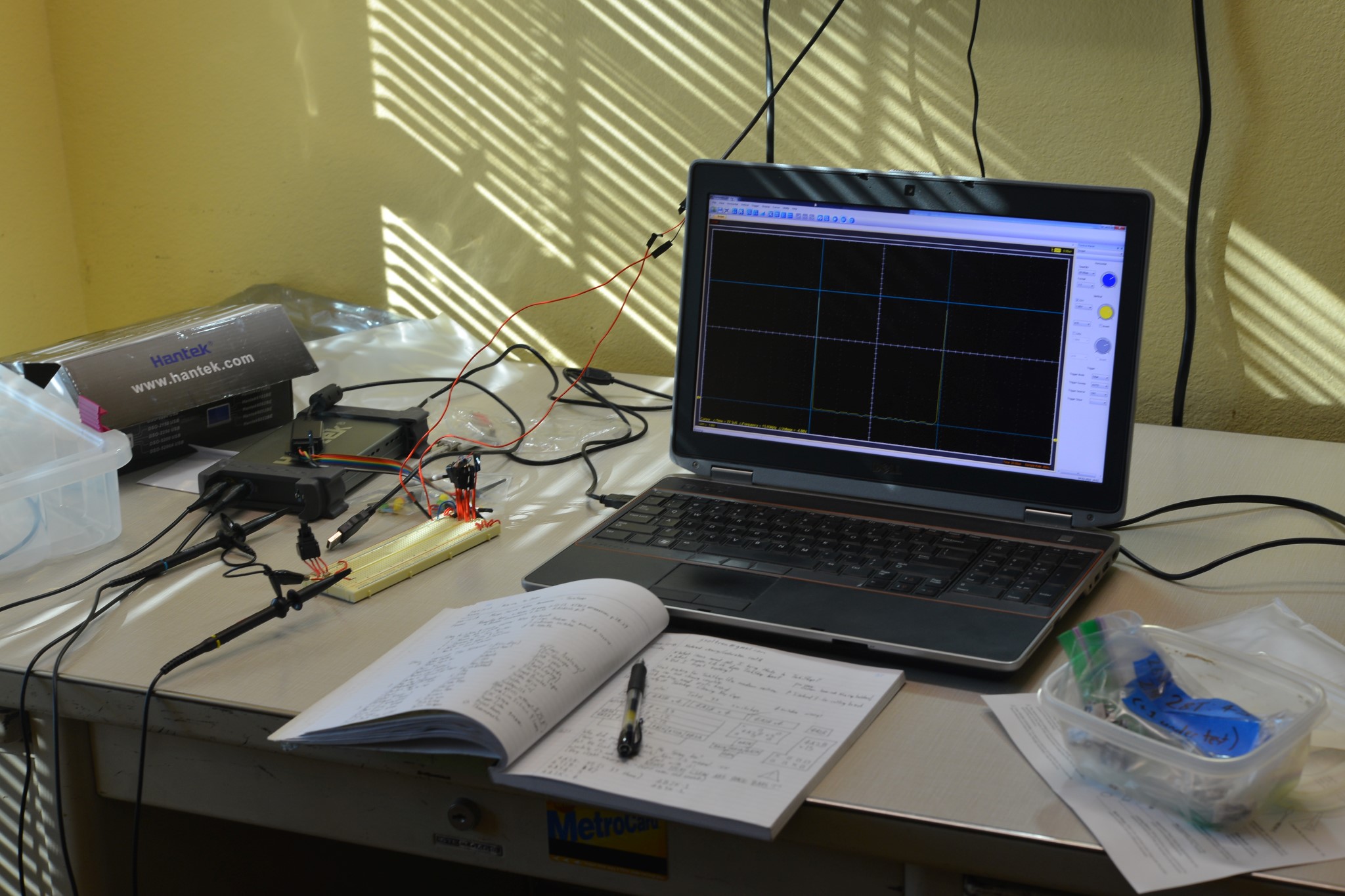

Lab notes and bench setup for switch testing:

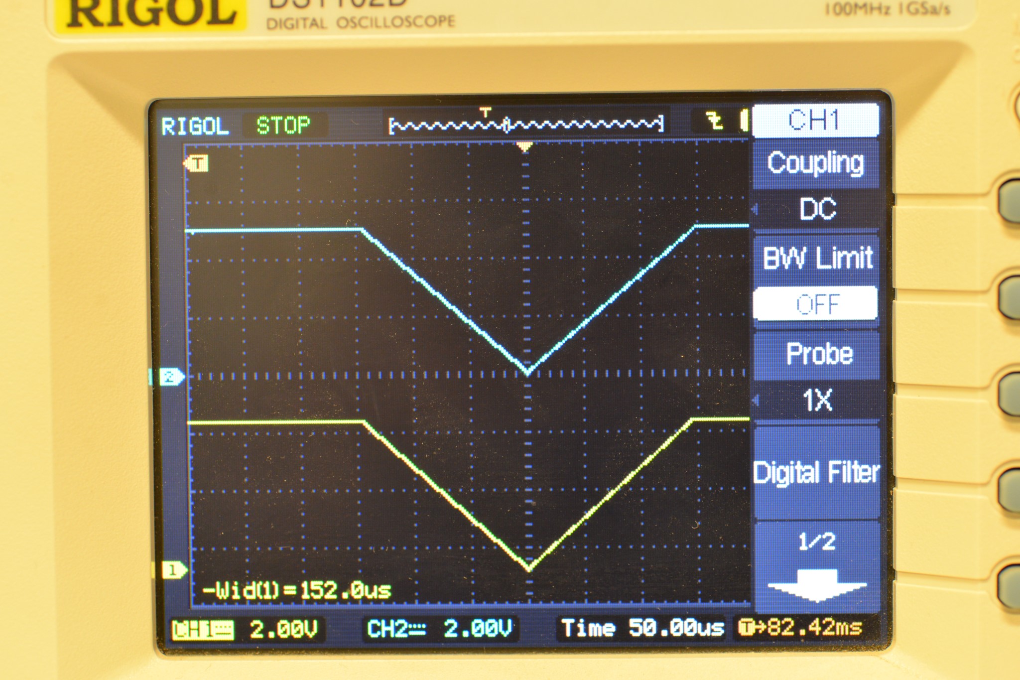

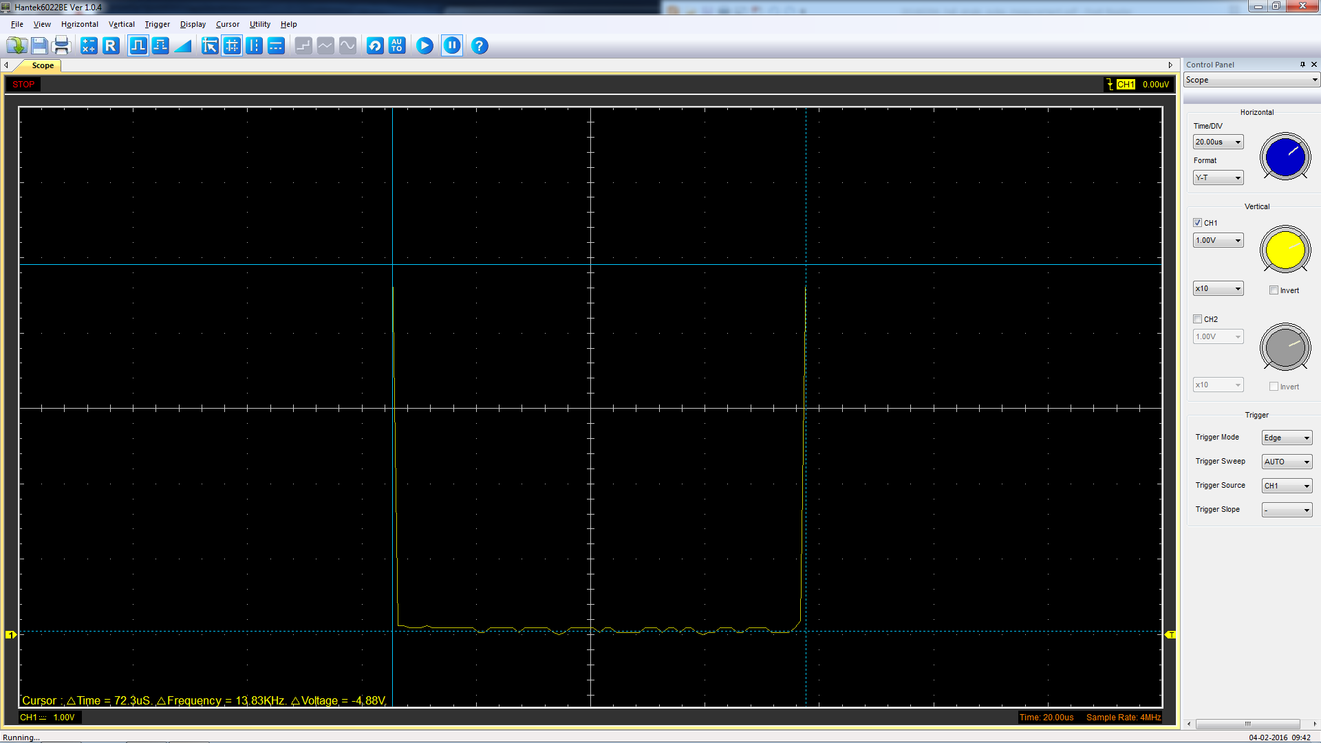

Oscilloscope plot of resulting pulse when a key is pressed. You only get a "press" event, not a "release" event. Yuck!

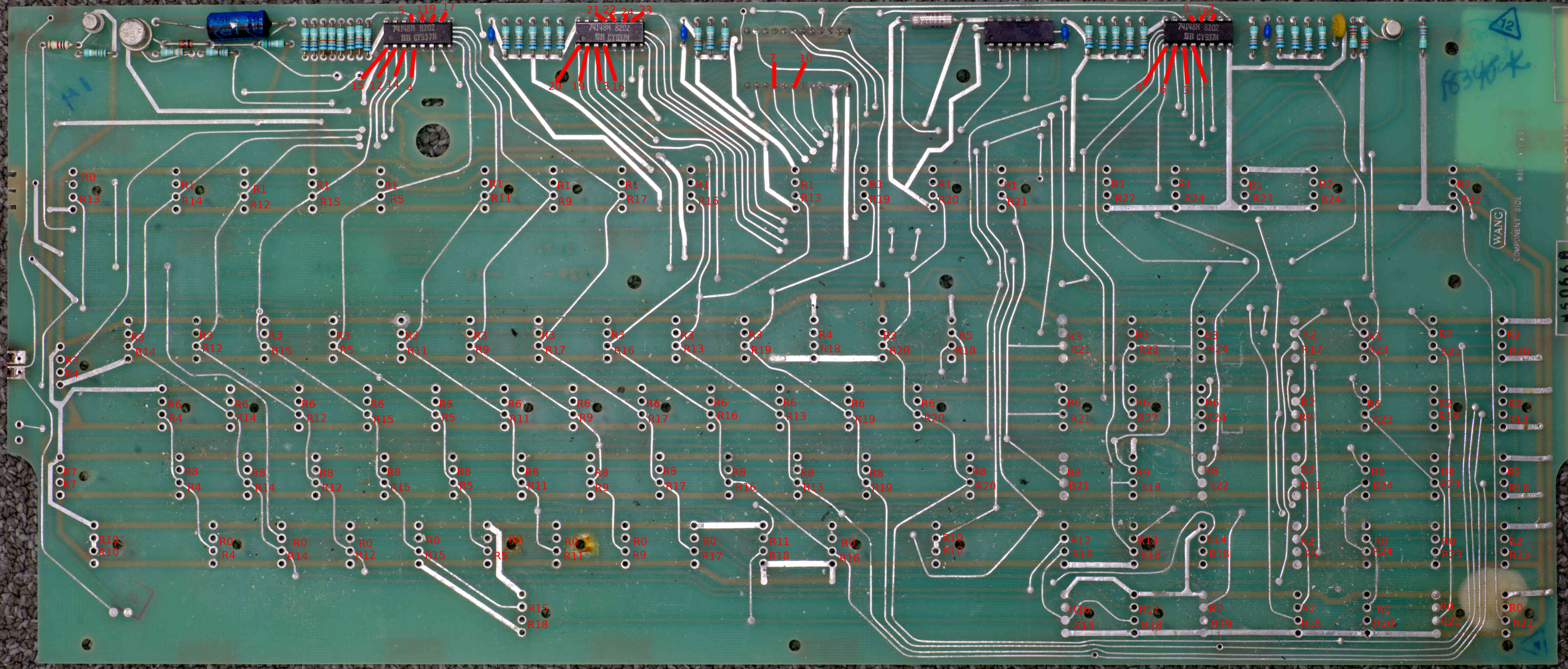

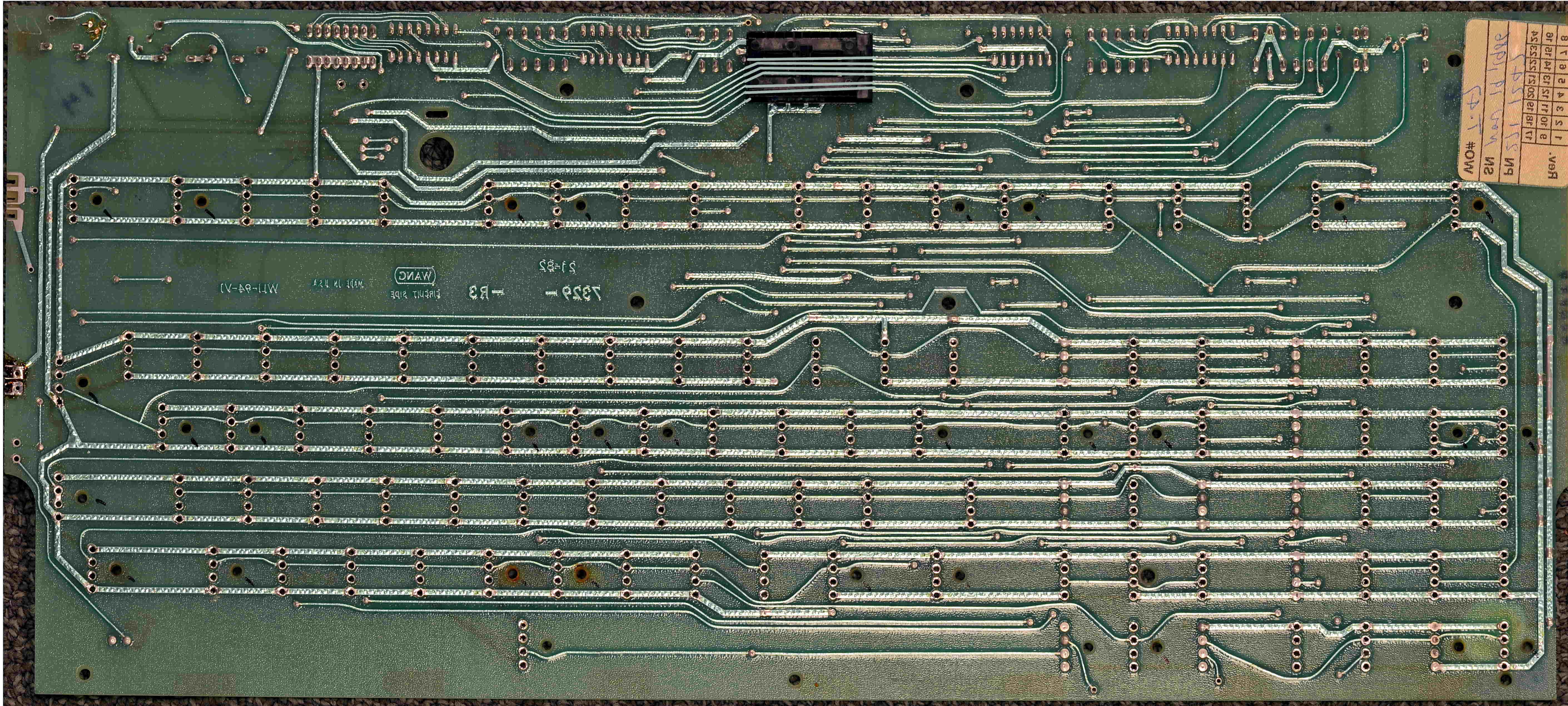

Quality photos of the front and rear of the PCB with all switches removed:

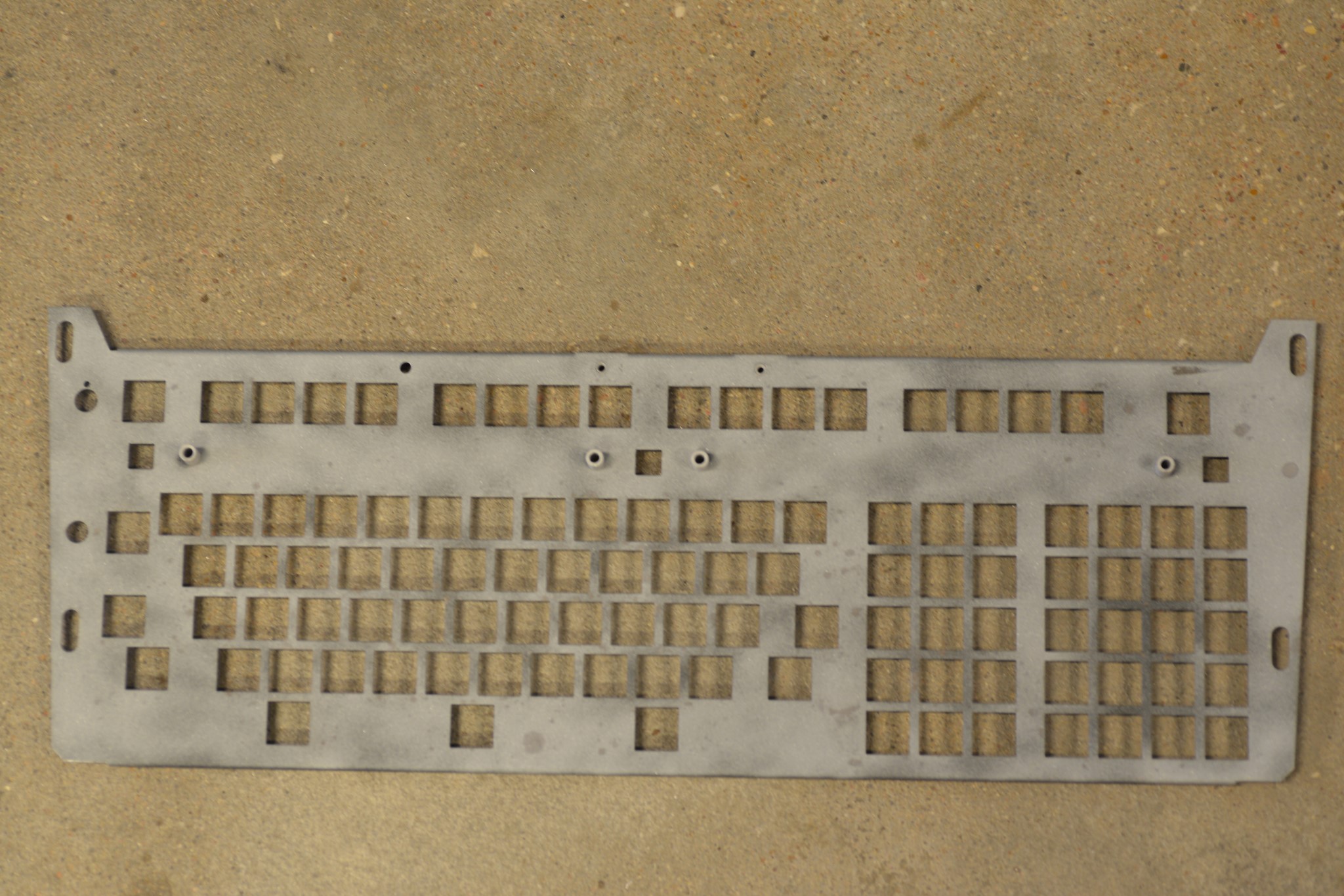

Switch plate, being sand blasted in preparation for powder coating ("coming soon") :

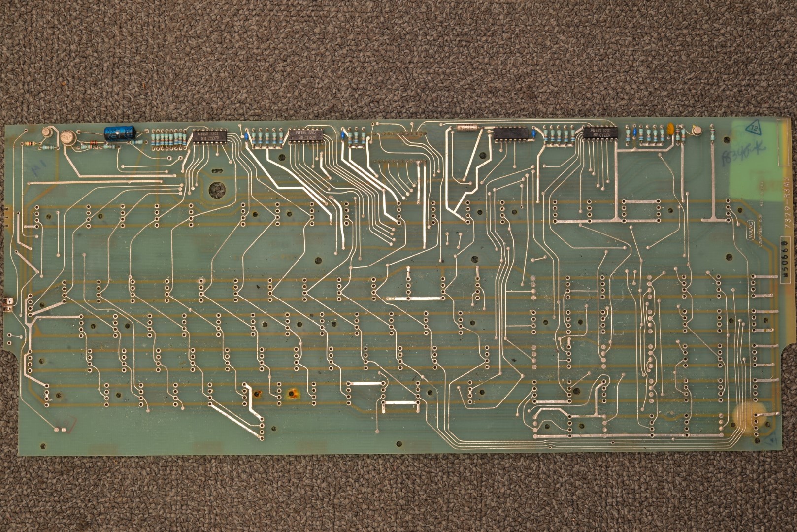

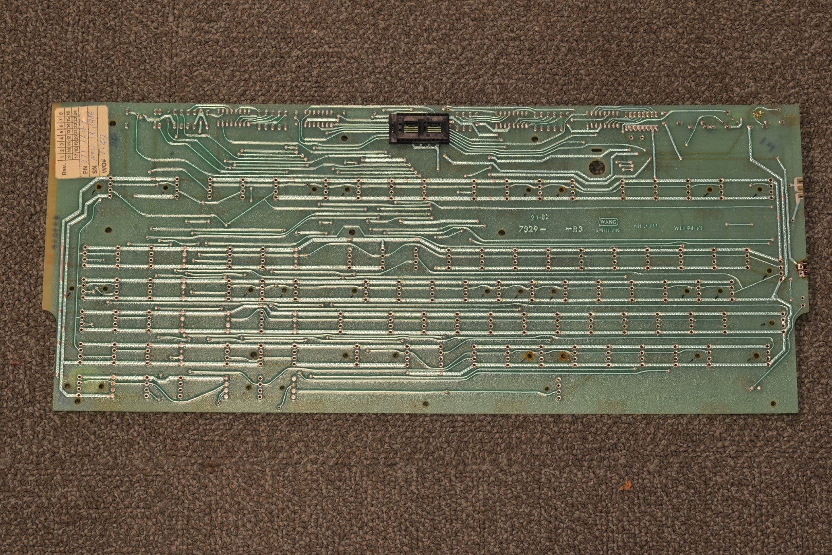

tl;dr: I recommend to implement a replacement controller to achieve NKRO. My plan is to remove the 74148 encoders, and strobe the matrix directly.
Today, I had a chance to have a good look at the high quality photos I took of the PCB. I mapped the matrix of the PCB to pins on the 74148 encoders on the top edge of the PCB. I edited the photos to make it easy to flip between the back and the front of the board. I also mirrored the back of the board to make it easier to trace. See photos below - high resolution!
In total, there are 25 "rows" that need to be strobed. This is few enough pins that a Teensy 2.0 could cover the matrix. A Pro Micro, however, does *not* have enough pins and would need a multiplexer of some sort.
Why not just use one of the 74148s as a multiplexer? Simple: they are priority encoders, meaning that switches can block other switches.

Looking back at my switch plan, it looks like the Lock and Shift keys used a different kind of switch: a "4B3A", whereas most of the rest of the alpha keys either use either "4T2B" (angled stems) or "4A2B" (straight stems).
I wonder if the 4B3A switches had different sensors in them to facilitate latching keys. If so: I'll need to test every single sensor before re-installation. I had removed all of the sensors from all of the switch housings in order to clean the switch housings in my ultrasonic cleaner.
Perhaps these 4B3A switches have sensors that implement what would be my strong preference for how sensing could work: switch goes low when key is pressed, and high when key is released. If you can't hold keys down this board is useless for gaming.
Further: it does look like the keys are arranged in a row-column arrangement. All of the lines coming into 74148 #1 and #2 (from left to right) are "columns" and all of the lines coming in to 74148 #3 are "rows". As labeled in the image above everything has a "R" prefix for "row". Specifically, using my labeling convention above, these are the rows, 0, 1, 2, 3, 6, 8, 18.
Also: note that a number of switch positions that were unpopulated earlier, are valid places to put switches. This is handy for say modding the keyboard to have an inverted-T arrow cluster.

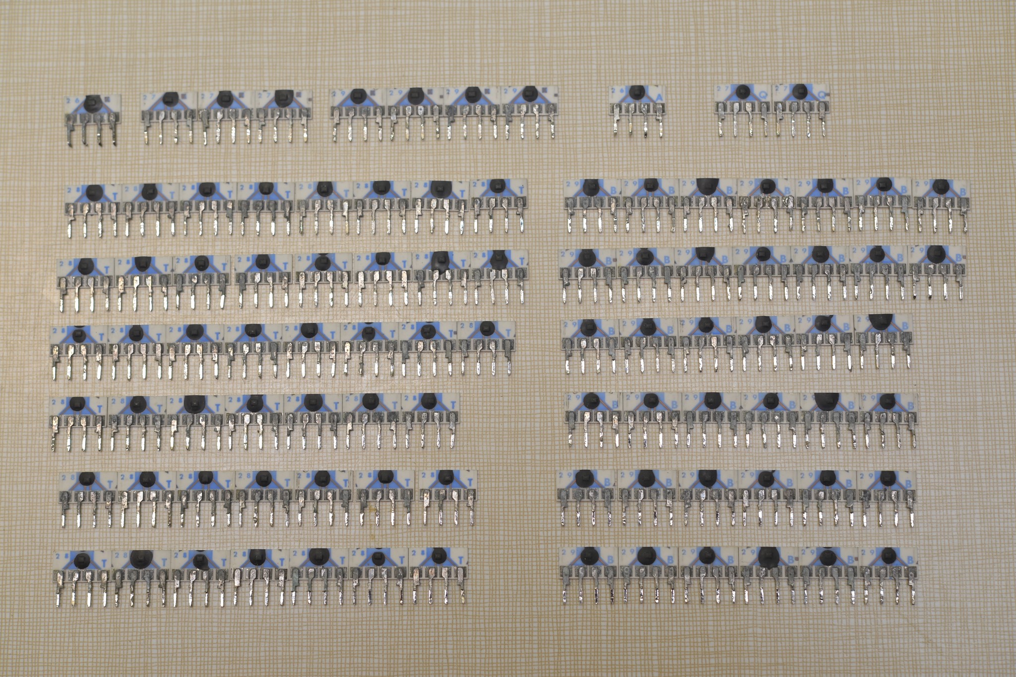

Last time, I discovered that there must be some difference in the different kinds of switches that are used in the keyboard. Some must emit a low pulse, some must stay low to act as modifiers. Since I pulled all of the sensors out of the switches I now have a needle in a haystack problem to find what should correctly go where.
I sorted all of the sensors from the switches. I have:
26A - qty 1
29B - qty 38
26K - qty 1
27K - qty 3
29K - qty 4
27Q - qty 2
28T - qty 46
Total 95
I don't know the significance of these codes. These are the letters that are printed on the sensor boards themselves, not the switches.
I know for a fact that "28T" is a single low pulse sensor. Moreover, I finally managed to get some time to play with my Hantek 6022BE USB oscilloscope and get this lovely capture.

My trip to Fry's was a success. They've become what Radio Shack used to be: a reasonable place to buy test equipment and discrete components. I should have more updates soon.
I'm getting better results out of my USB connected oscilloscope than the bench top one I was using earlier. I need to look into this.

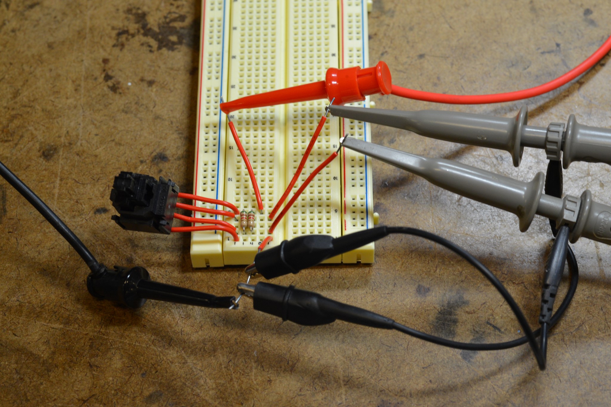

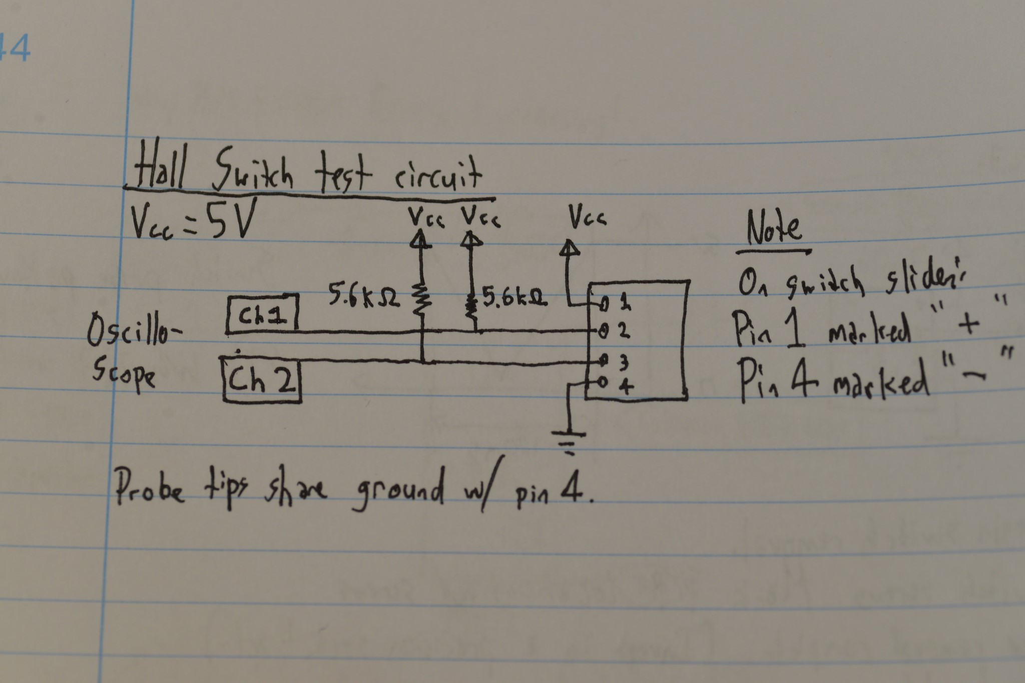

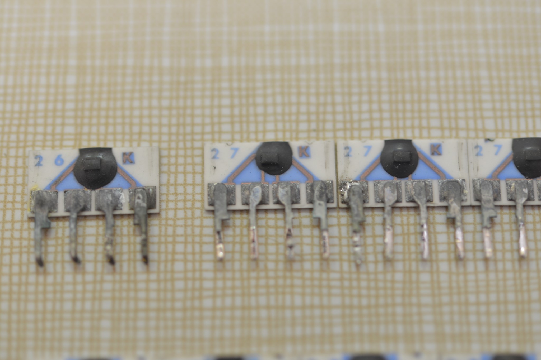

tl;dr: 26A and 27Q are the "special" sensors. 4B3A is a special switch for modifiers that stays low when pressed. I can put the board back together now.
I purchased some "IC Test Leads" (test clips) that made it much easier to test Hall switches in quick succession.
What I've found:
Sensor types 26A and 27Q (as well as 99A7) are the "pull low" variant: the pull down resistor is pulled low as long as the sensor is active. As long as the key is held down, these are low. These are the "Lock" and "Shift" switches.
All of the other sensor types I tested - 28T, 29B, 26K, 27K, 29K - are of the "low pulse" variant. The open collector output is typically pulled high by a pullup resistor and I usually see 5V here. When the key is pressed, or held down, the open collector output drops to about 0V. This happens for 60 *microseconds* as posted in the earlier oscilloscope screen shot.
My guess is that the extremely short pulse time is an attempt to prevent ghosting. The way the board is wired, when a switch pulls a row or column low, it will appear low regardless of anything else happening. This isn't like mechanical switches where current either flows or doesn't flow and can be impeded by diodes. By design, I think this only gets 1KRO. There is no way to tell if a key is being held or if it was pressed once.
I'll need a really fast scan rate to catch these pulses. 1/(60 microseconds) is about 16.6 kHz. I need to sample at least double this (Nyquist rate) to see the output. I'll probably scan at about 40 kHz for starters to see if this works.
I guess the next step is to wire up a little toy 2x2 or 3x3 matrix and see if I can adapt one of the existing keyboard firmwares out there to read these pulses, or write my own. For the whole board I'll need a total of 25 input pins again: 23 for the matrix and 2 for the modifier keys (ideally 3 for the mods). A Teensy 2.0 just barely has enough pins (and doesn't let me tell the Shift keys apart). A Teensy++ 2.0 has more breathing room in this regard.
