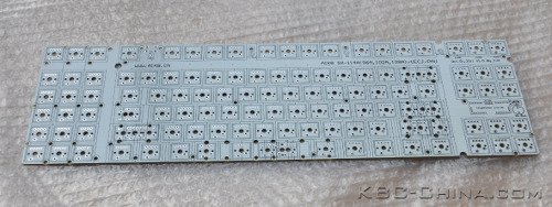

http://www.likeyboard.com/forum.php?mod ... a=page%3D1
likeykeyboard.com, preiously know as bbs.kbc-china.com. imsto posted a bunch of pictures of a Poker converted to use the Chameleon controller. You might need an account to view the pictures.

Looks like they've stolen my ideas!litster wrote:http://www.likeyboard.com/forum.php?mod ... a=page%3D1
But luckily they didn't do it right and messed up the design with a stupid controller placement!
- AIKB_GX11a.jpg (46 KiB) Viewed 8774 times
mintberryminuscrunch
oh.. but it pcb mountable so that is a win
Last edited by mintberryminuscrunch on 15 Nov 2011, 18:57, edited 1 time in total.
- 7bit
- Location: Berlin, DE
- Favorite switch: MX Lock
- DT Pro Member: 0001
- I've asked to add those 3 extra columns to the left some weeks ago (not possible becuase the controller does not have enough pis to make use of these)laden3 wrote:with all the respect. LOL7bit wrote:Looks like they've stolen my ideas!
- Filling up the bottom row was my original idea!
- Spitting right shift was my idea (OK, this existed before)
- filling up the area above the cursor keys was my idea too (this also existed before, except on a Tenkeyless)
- To have a super-short Return right of \| is my own idea!
However, they failed to completely fill the cursor area, becuase of their stupid controller placement and
don't have the 1 unit key left of left shift. Also, the Phantom will be platemounted.

All Datacomp produced PCBs (Leopold, Archiss, Razer BlackWidow) use this style of PCB since ever they came out over a year ago. Full support for even Japanese spacebar and 1x1 windows/app keys.7bit wrote:[
