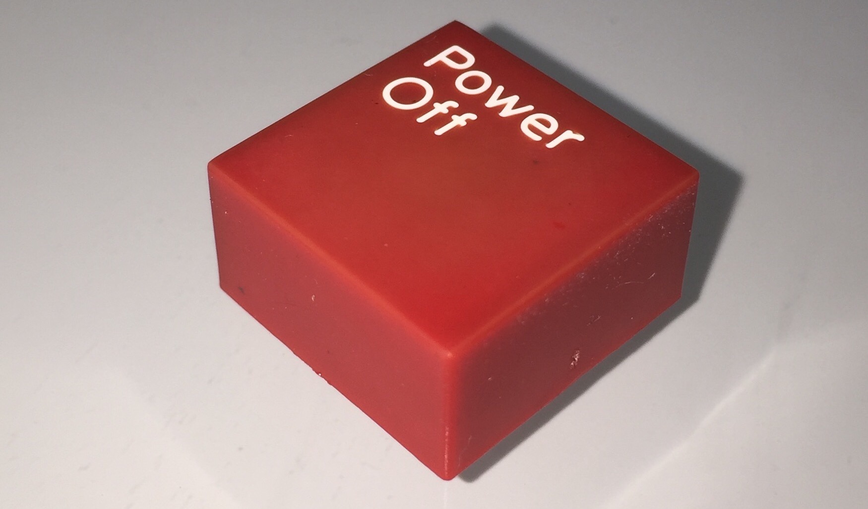

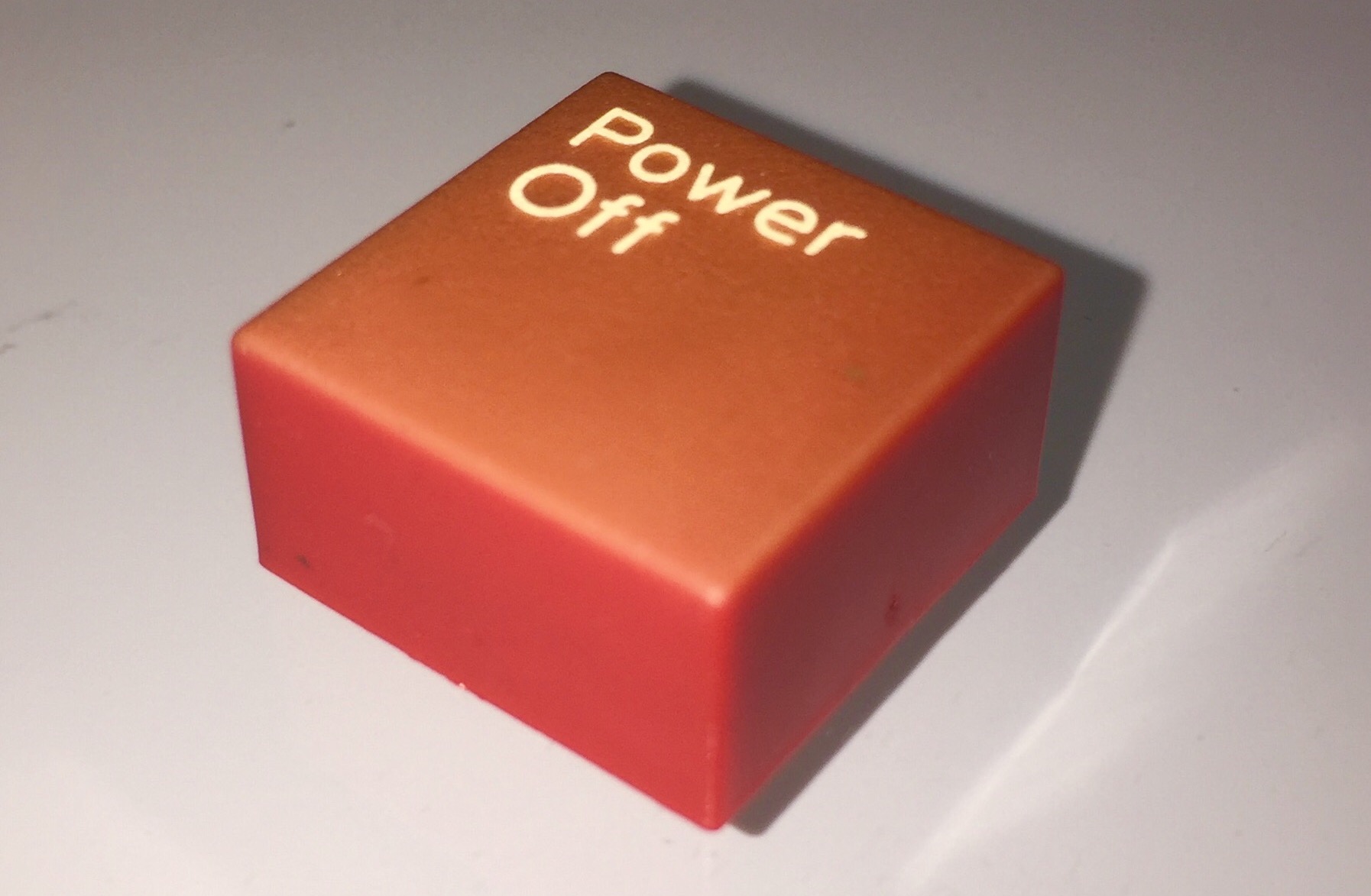

So next round of sandblasting done. This time I FINALLY put in a set of SAD caps. Not a full set, just an ISO-enter. That's usually the worst worn single keycap. And since I found it VERY helpful to demonstrate the effect of sandblasting, I again taped half the keycap for a direct before/after comparison.
Here's the pics:
Gave my best to capture some of the shine the upper half of the cap has:
But here's the bomb, using my USB "Microscope" again you can so clearly see where the tape ended :)
You can also see that the legends haven't suffered at all. ZOOM IN :)
I am pleased with the results. Comparing the surface of the treated keycap with a keycap that is known to see very little use (ROLLEN!!!) you can tell a slight difference if you wanted to. Either I didn't sandblast long enough or the pressure wasn't high enough but the effect is a little less amazing than on ABS caps. Still works great on PBT caps. Will try a longer exposure and a little higher pressure. I feel like the grain I am using for ABS also fits perfectly here so I will not start experimenting there ...
