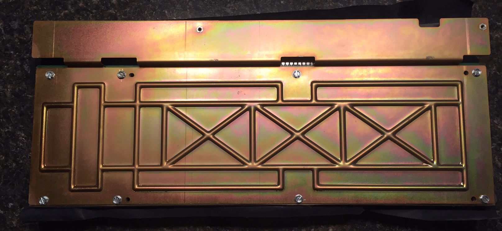

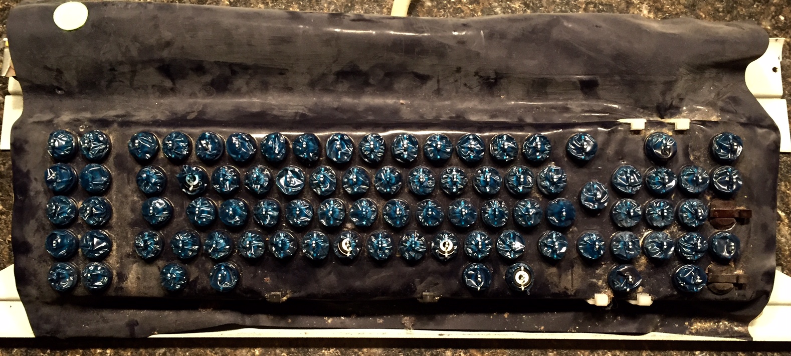

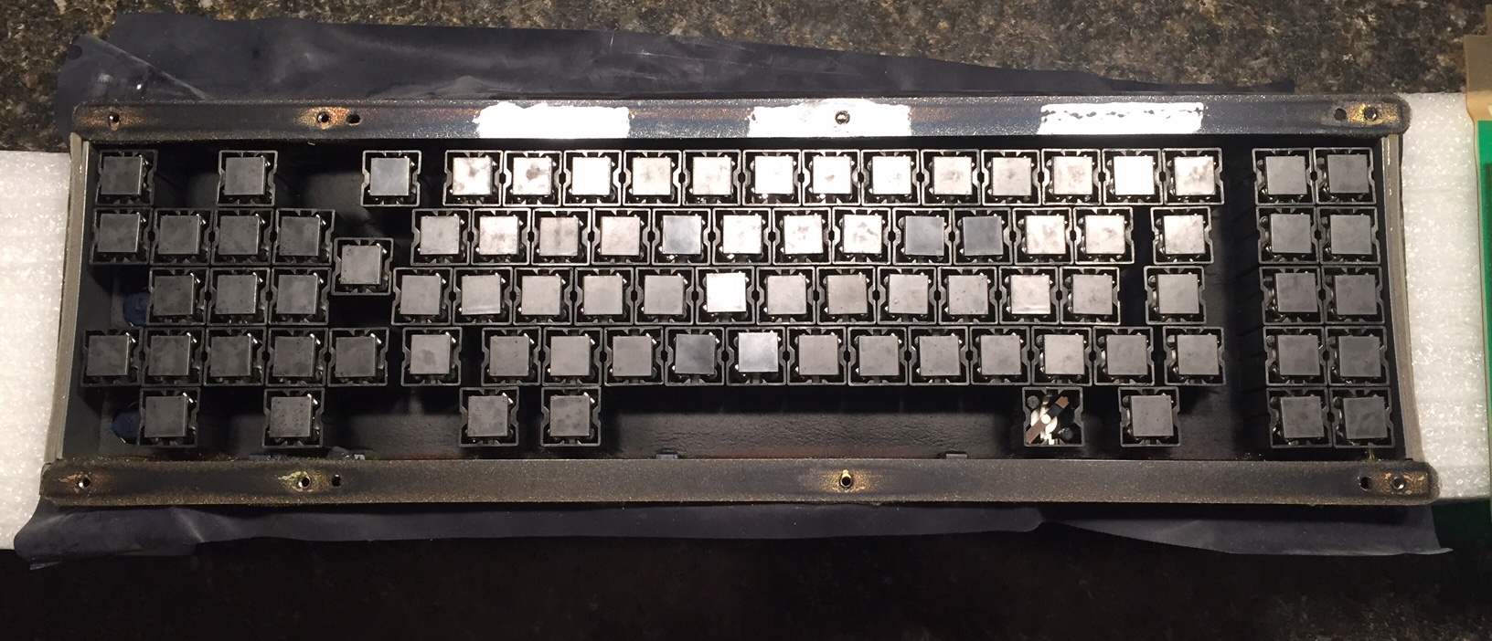

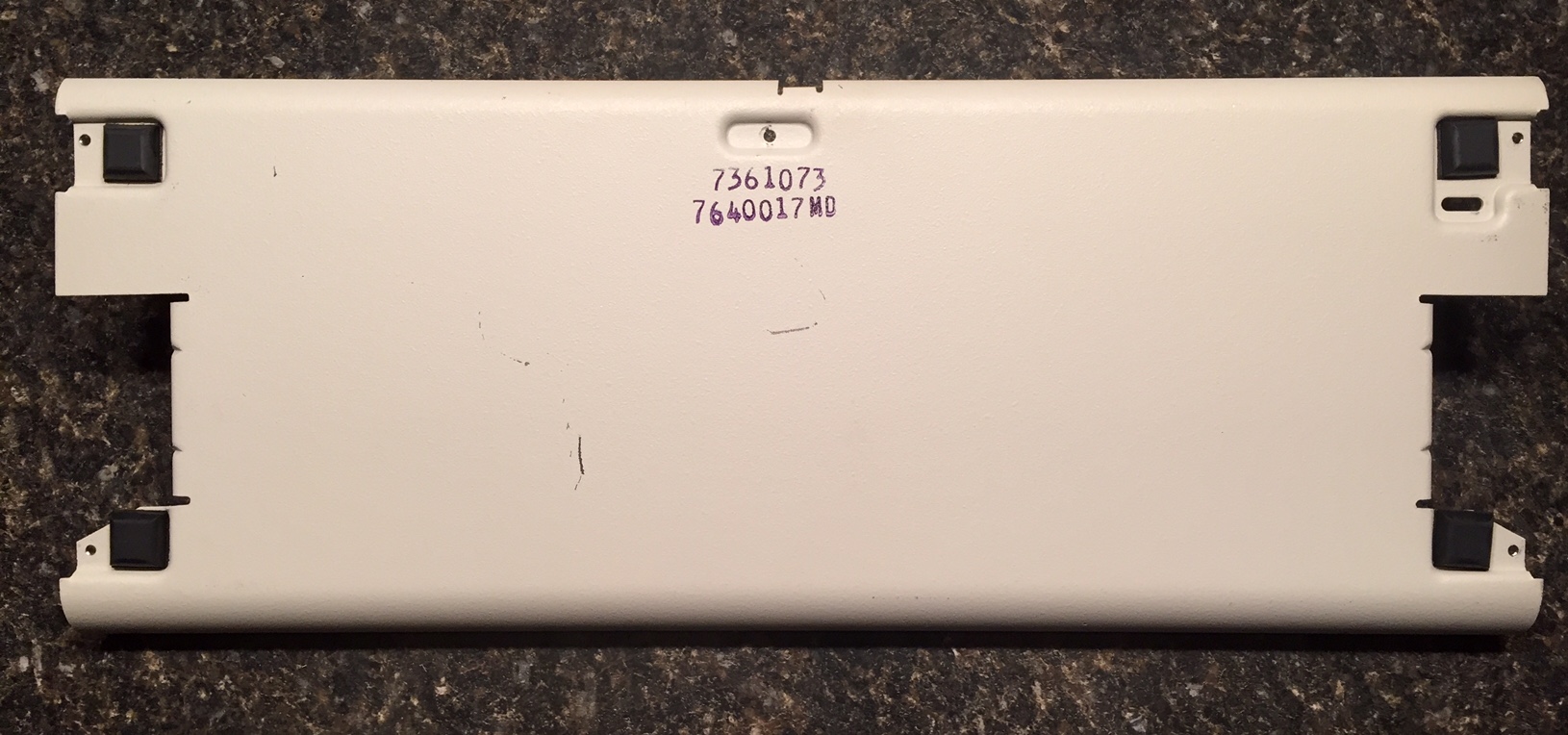

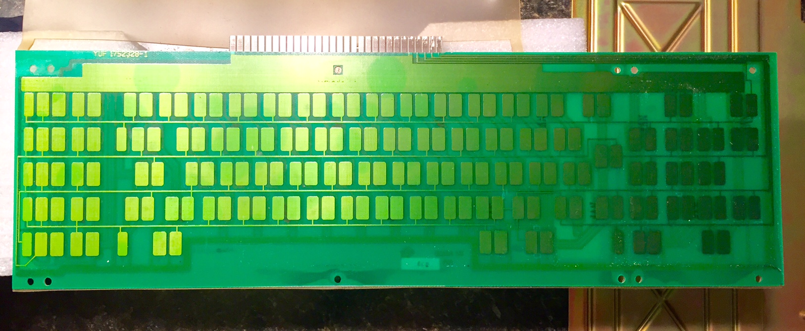

Pulled the 5251 apart further, and am really happy with the shape of the PCB, foam, and lack of debris. All the attached pictures are "as-is" (no cleaning) with the exception of the case bottom. I've learned previously that these ink stamped model numbers come off very easily with nothing more than water, so take care while you clean it. I typically get rid of these debris shields in lieu of an alternative membrane (usually because they are beyond repair and I don't like the additional force they add to the key actuation), but will probably just blow this one clean using the compressor at around .5-1 bar. Overall very pleased, the controllers are in, and it is clacking away.

Nice! Looks very similar to the condition that the one I'm typing on now was when I got it. I really would like to have something protecting the switches from contamination but I just could not stand the way the contamination shield made the keys feel. It came off pretty nicely all in one piece and I could probably put it back on if I were so inclined, so I feel almost bad about it given that usually they're destroyed. But really, they are just otherworldy-good without it and pretty ho-hum with it.
