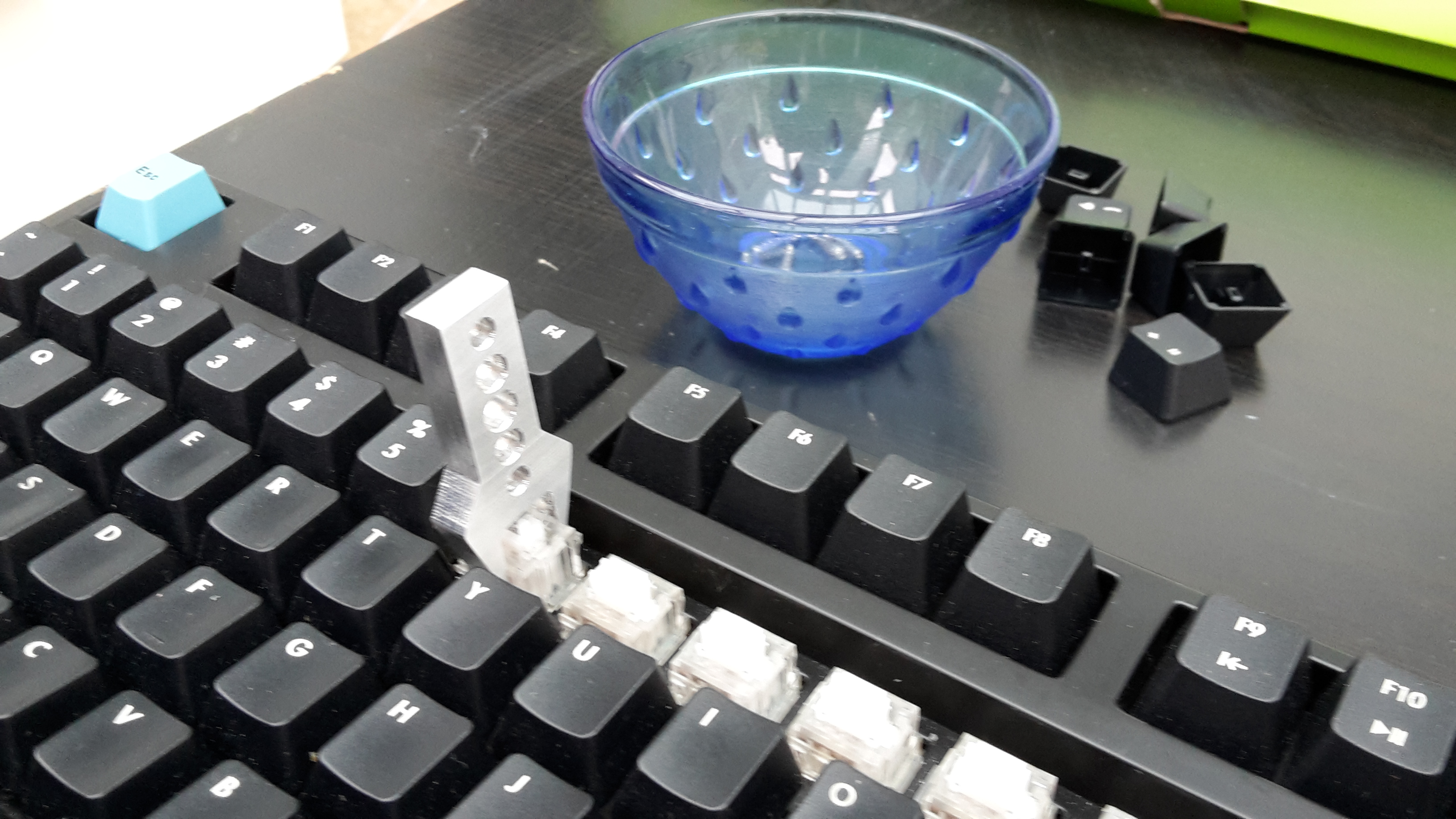

Zombimuncha
28 Jun 2016, 16:02
They're he-eeeere!
Thanks Mr B. I can't wait to try it out!
Edit:
Alps tool
Alps tool
I did a whole row of spring swaps in just under an hour tonight. With the tool it's a little quicker and a lot easier.

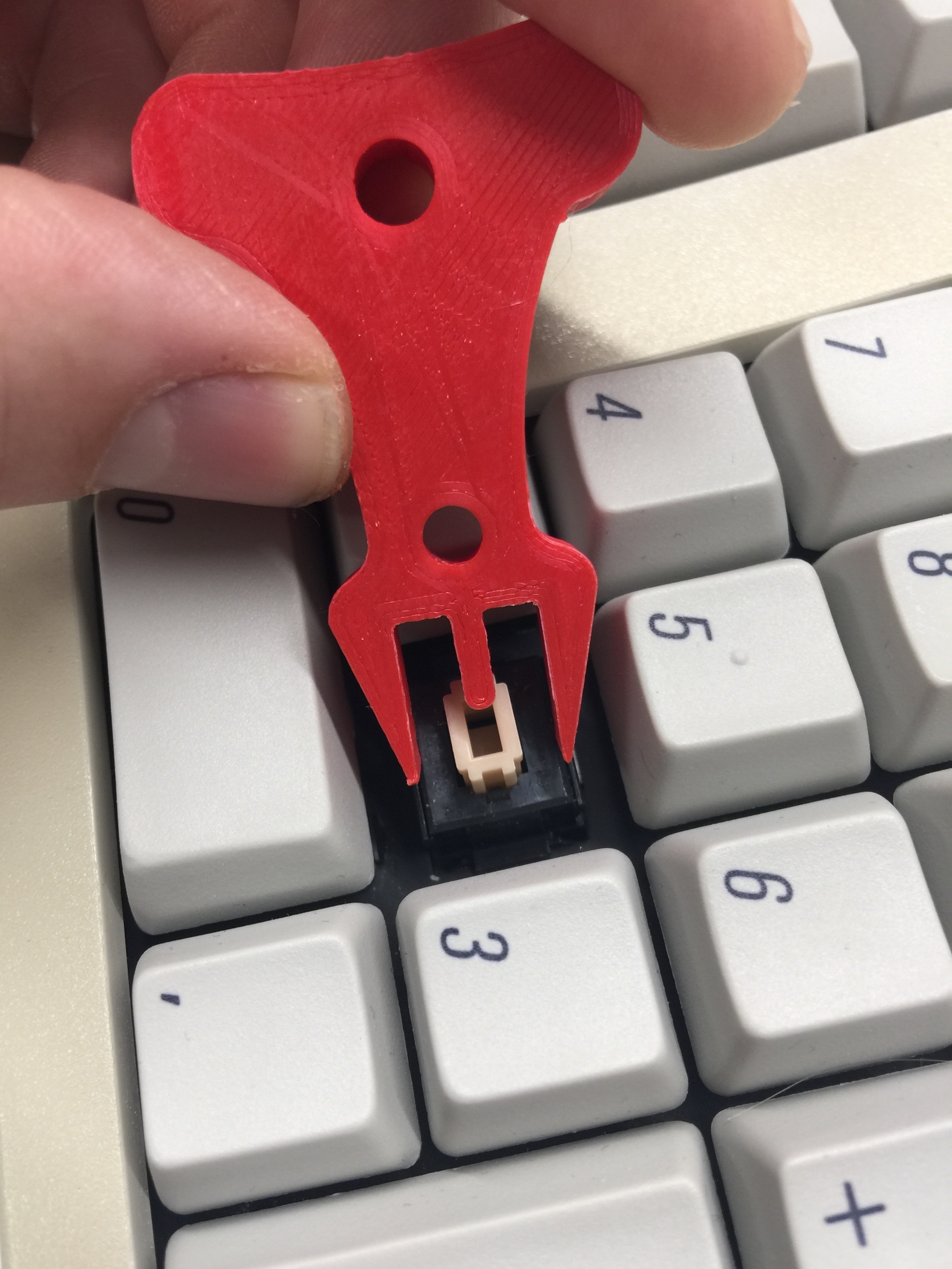

16 May 2018, 11:19
They are pretty cool , i have one and use it all the time.
I did file down and polish up some of the tooling marks tho , just to reduce scratches on the case of the switch.
It must have done about 300-400 alps switches sand still going strong.

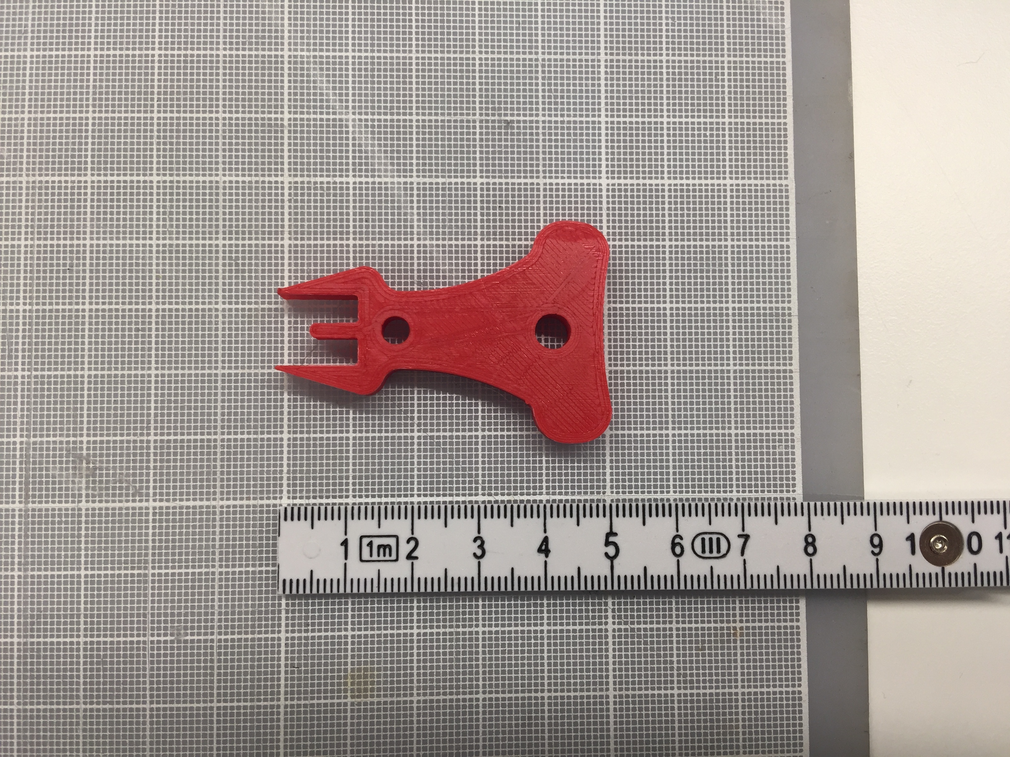

I'll be 3D-printing a copy and see how well it works. If it's sub-par I'll see if I can have one CNC'd from aluminium.
Edit:
So far my printed version works just fine, but the real test will be to see how long it lasts before the tips start to warp or bend from all the prying.

Blaise170 wrote: Because grabcad requires you to create an account, I've uploaded a copy via Github here.
By the way, does anyone know the dimensions for it? I'm trying to get it uploaded into Shapeways but I can't figure out the correct dimensions.
I looked at the model in Fusion 360 and measured the longest point to be about 5cm. After printing it in that size it worked pretty good!
