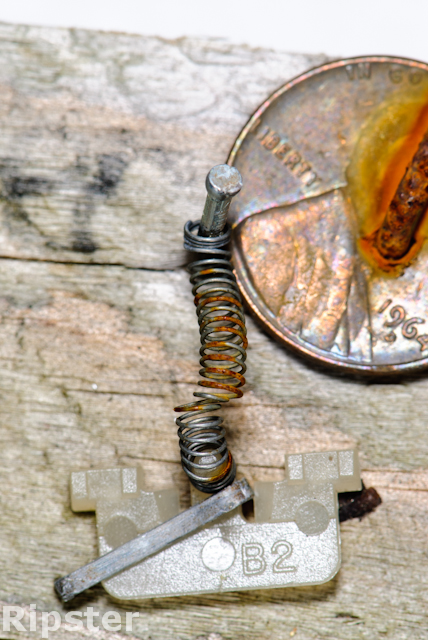

Have you seen the RipOruster?
Looks like it is confirming that stainless steel thing (although still magnetic so not COMPLETELY stainless).

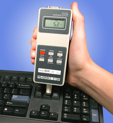

But seriously, even the cheap ones cost 200 bucks :/
Sorry to change a little bit the subject, but I notice that you have a force gage. Do you think you can let me know how much force is required to pullout a keycap in either a FILCO, Leopold, or MODEL M board?
Actually its just a random image of a force gauge i found on the web...
It was a humorous reply to ripters "how to measure without coins" post which was removed >.>

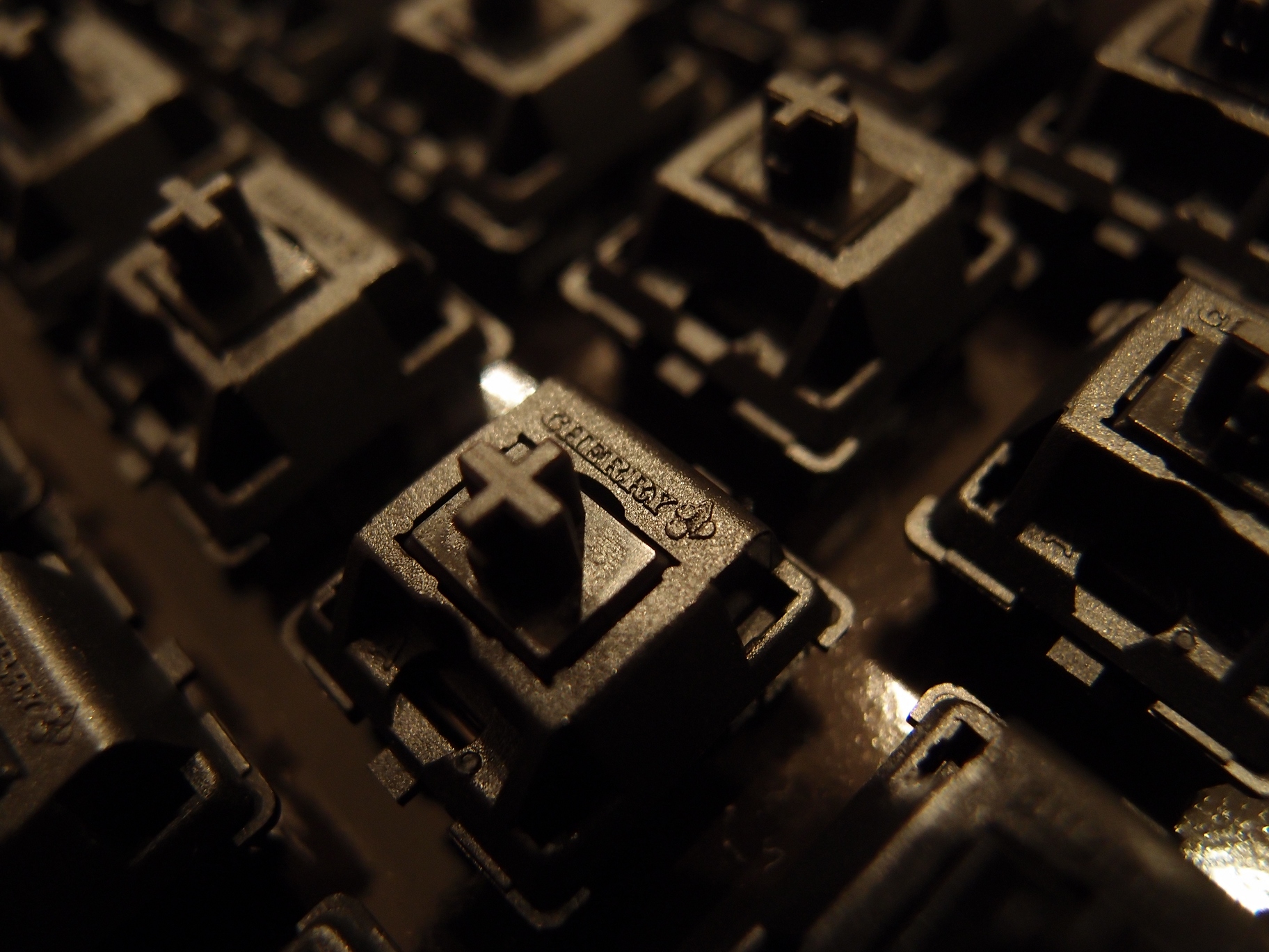

So am I right that these black Cherrys are Vintage MX Blacks? (G80-2551HAD)

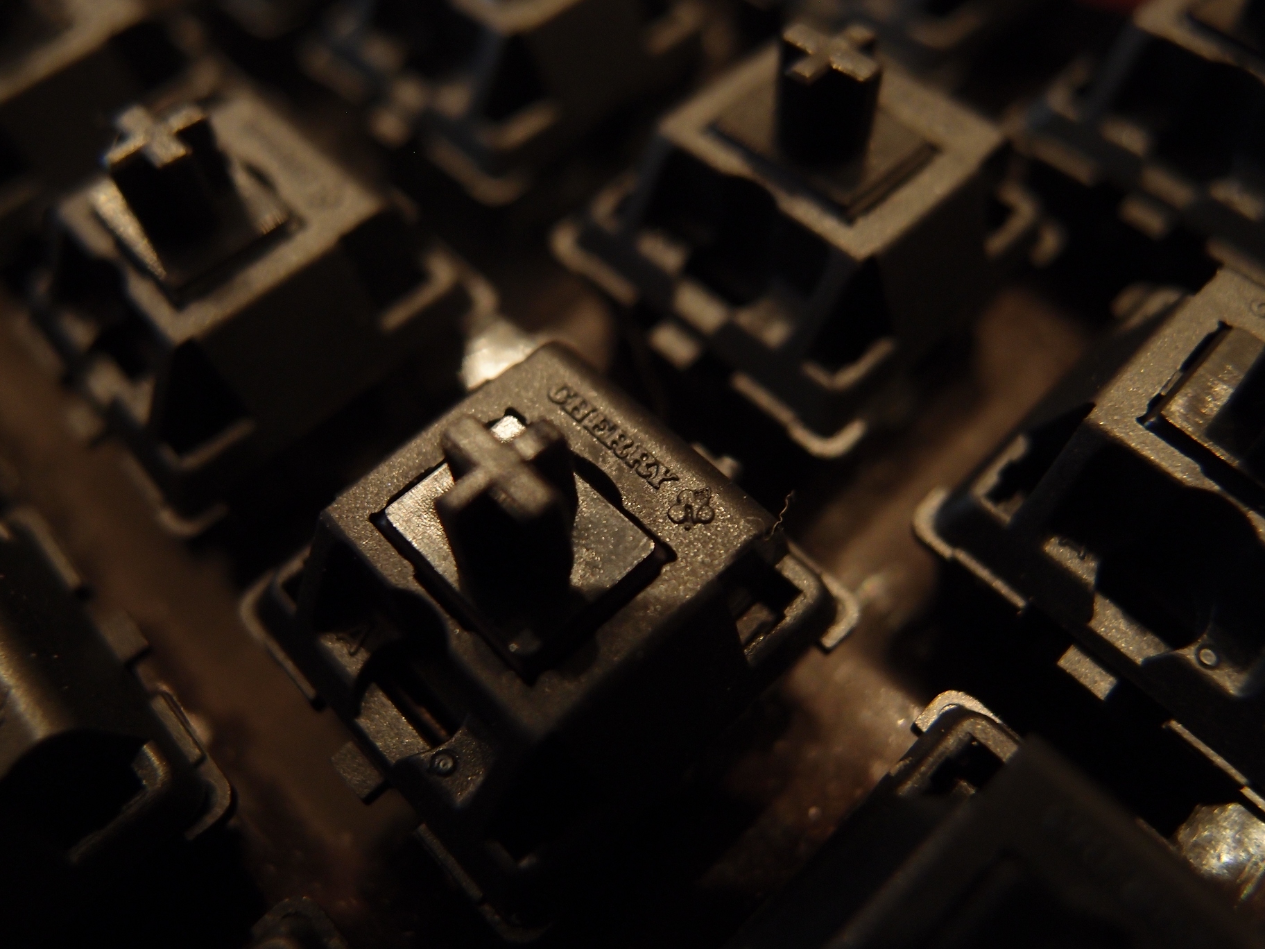

EDIT: Here as comparison a photo of my G80-1800HAD:

Tarkoon wrote:So am I right that these black Cherrys are Vintage MX Blacks?
yes
JBert
09 Jan 2012, 21:41
How can you tell? The logo seems normal to me...
Tarkoon
09 Jan 2012, 21:45
If I compare to the two pictures in the opening thread:
At the new switches the upper left cherry circle is top alligned with the cherry text.
At the old switches the cherry is higher and bigger. (as on my picture)
Just compare where the top right edge of the Y is located compared to the upper left cherry.
EDIT:
I just remembered that I also own a G80-1800HAD and took a comparison photo. (added it to the post above)
You can see easily that the complete logo is smaller...
kaiserreich
10 Jan 2012, 08:02
Not sure whether the logo is accurate in determining whether the switch is vintage or not.
The 2551HAD was made in 1993, so it should be vintage. (serial number F 36)
I have the same WYSE keyboard shown in the picture below:
The switches has small CHERRY legend, but it was made in June 1993.
If the sizing is used to determine whether the switch is vintage or not, then this 1993 WYSE is not?

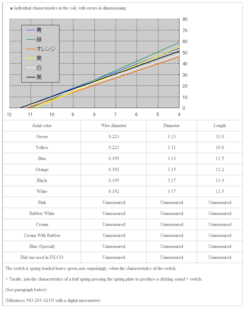

ripster
19 Mar 2012, 16:53
Not bad.
Especially compared to IBM's
Why are the Koreans making gold springs again. For Bling?
Haven't they read Hooke's Law?
Complicated ALPS Spring Comparisons.png (51.86 KiB) Viewed 12233 times

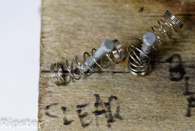

Latest RipOruster results after one year in the elements.
hmm... I'd add it here but...
http://geekhack.org/showthread.php?3119 ... RipOruster!
Perhaps Cherry MX is not rustproof, metal never is, but impressive nonetheless.
Safe to say ALPS can also handle a water bath (at least the switch). If bored I'll reassemble the switches and check conductivity.
http: //geekhack.org/attachment.php?attachmentid=29641
And don't stick your mechanical keyboards in the dishwasher. That would be stupid.
http://geekhack.org/showthread.php?3171 ... post600888
Bathing in the shower MIGHT work...
http://geekhack.org/showthread.php?3185 ... You-decide

ripster wrote:Latest RipOruster results after one year in the elements.
Finally a moment to tell you, I still feel that your RipOruster is ripping people a new one.
The IBM spring at least is not comparable to the others, seeing how it touches a coin (that is clearly rusting) and has both a nail on one end, and a tack on the other (presumably with differing metal mixtures); ensuring corrosion taking place..
ripster
12 Jun 2012, 20:56
Experimental DESIGN FLAW!
Also in my link you can see that at Macro levels the pic shows slight oxidization at the spring/brad contact tips!
For anyone doing a PhD thesis using the RipOruster I suggest plastic tiedowns to hold the springs.
