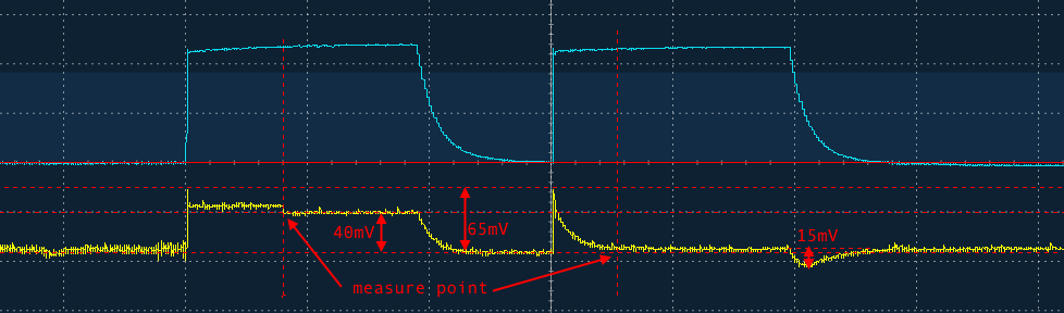

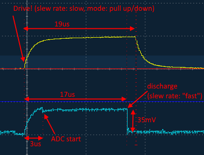

DMA
22 Jun 2016, 06:33

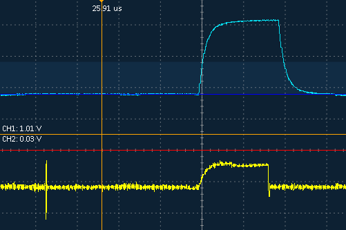

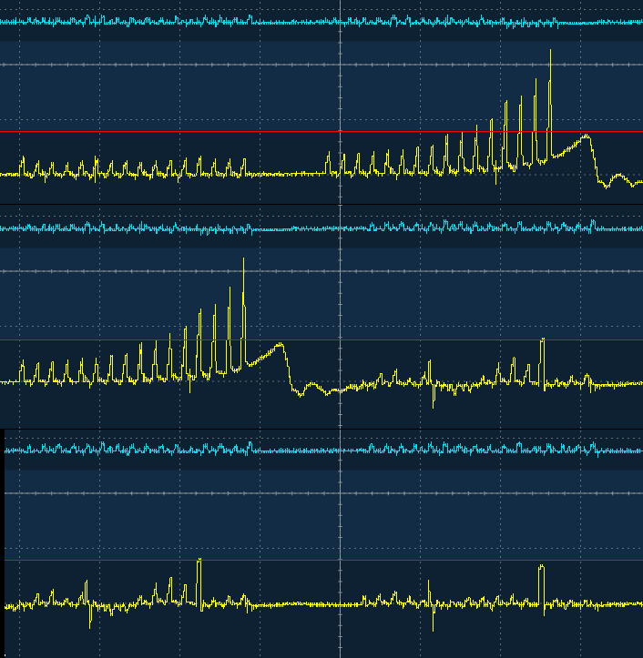

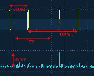

Chapter XXVII, in which protagonist discovers current-limiting resistors.
Yay, cypress thought about us, and put 5.6kOhm (on average) resistors into the pin drive cicuitry, which can be shorted out if not needed.
The picture becomes much nicer (which is not a surprise, they limit pin current to less than 1mA)
Nice.
WTF, what are those?
Will try to improvise the star ground next. basically, will tie all 3 ground wires from the matrix as close as possible to USB ground (that would be the ground of the reset pin - I would scrape off the solder mask around it though and apply a good dose of the tin to get larger cross-section). It is not possible to access Vssa (analog ground) of the prototyping kit - or I would tie sensor-side and middle ground wires to that (as IBM did).
Next is reimplementing scanning ADC using both on-chip SAR ADCs and not using interrupts. Should make it 4 times faster (right now all 8 columns are scanned no matter if the pin is tied to the ground or not).

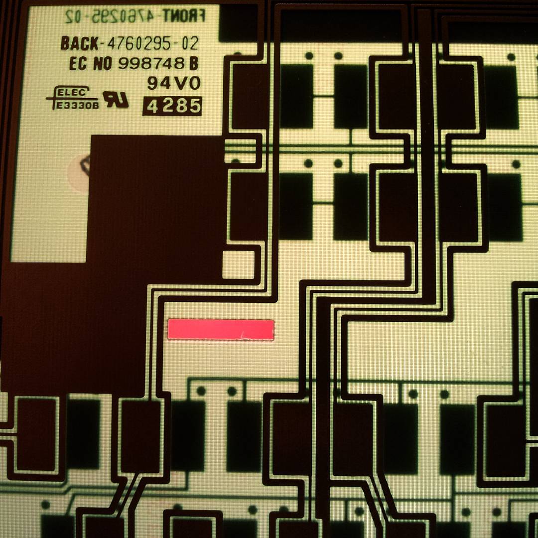

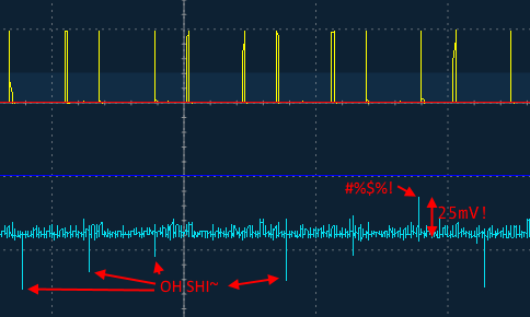

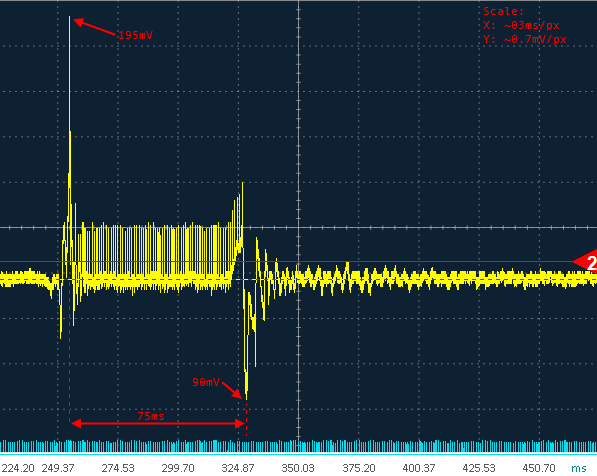

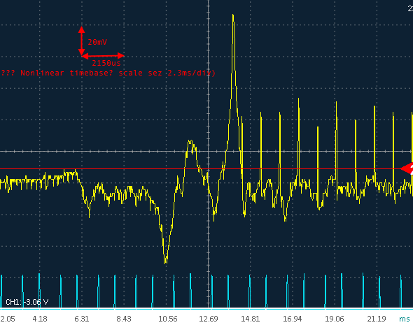

TIL that the ground around model F's connector is laid out in a very interesting way.
Ground traces re quite thick - ~4x signal wires, ~2x thicker than +5V.
Around the sense lines there's actually 3 ground buses: one just above the connection points, one in parallel on the other side of the PCB, and then there's 2 traces connecting both sides of those to the drivers' ground bar (towards which is towards the top of the picture).
But that's not all. The chassis connecting pad only connected to _outer_ of two ground wires coming to the matrix, by the separate trace. And the other end of the pad is connected to +5V by a rather large capacitor (looks electrolytic! Can't understand markings on it, though :( ). If I understand the message correctly, that means IBM wanted to keep high-frequency stuff on that ground, while decoupling the lower frequencies. Need to actually find some time to read Howard Johnson. Probably not worth it for one-off project though - almost 400 pages, after all.

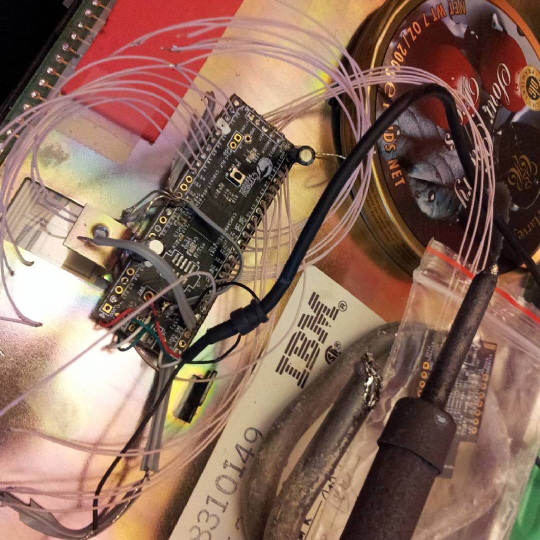

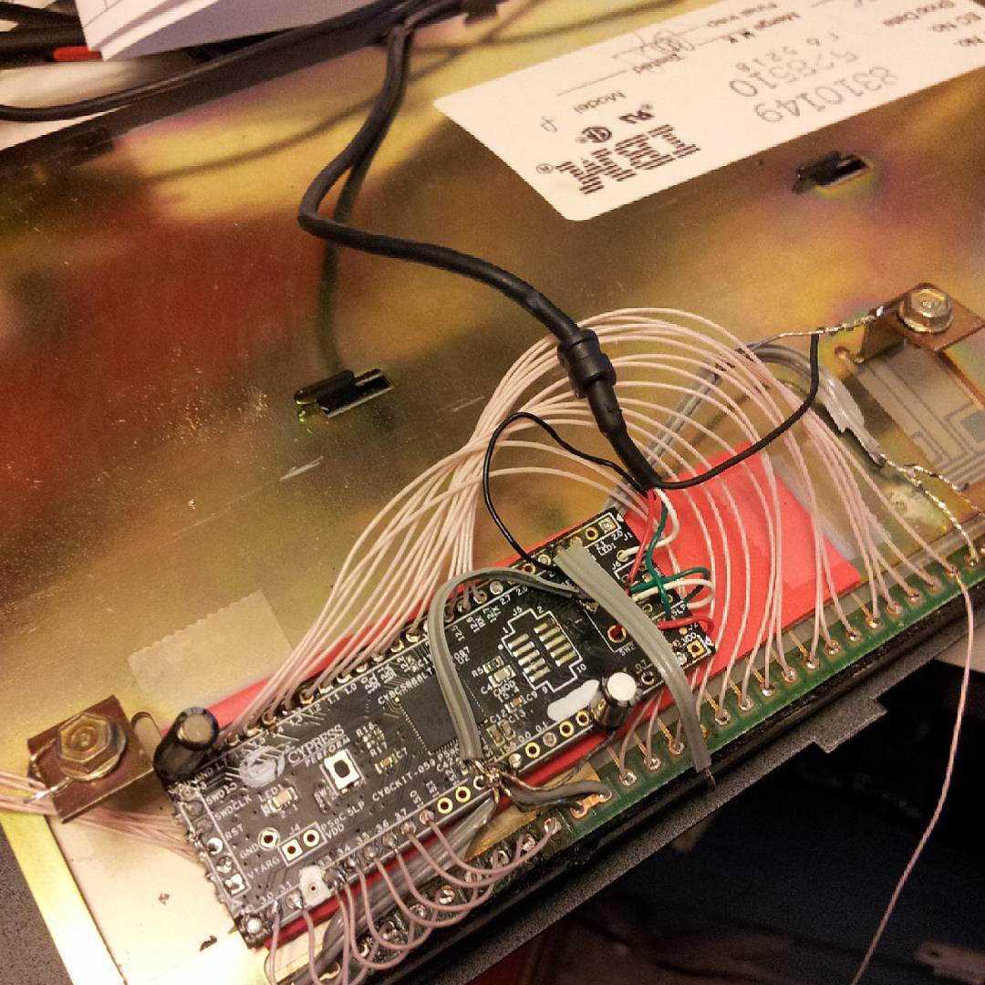

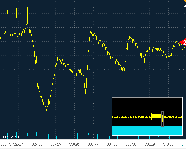

Anyway. All this analog shit is much harder than it looks, it seems. Since this is not a mass-market product - monte-carlo design methods are fine. So there will proably be a "measure once, cut twice" setting in a controller if one wants faster readouts and is willing to pay with readout stability :)
That's all for today - will solder the controller back to the board, do a smoke test and off to bed.
..I miss model F being my daily driver. The controller is good enough for private use, but yeah, to make it reproducible requires much higher code/physical design quality. AEKII is not that bad.. but it's no IBM. Coworkers are grateful for me switching away from buckling springs though :)
Update: self-test is green, reboot is.. good!
Controller survived a whole lot of abuse without much apparent damage.
White nail polish base, if you wonder, is "pins with capacitors on them, do not use".
The results are not much better though:
Spikes aren't gone, nope. Larger bypass capacitor on Vref also doesn't seem to help - though it's and electrolytic cap, may not be good enough.
And here's the stuff you have to work with:
This will probably get better with proper PCB design though. And something which looks more like a cable, kekekeke.
Update2: larger cap on Vref actually helps!

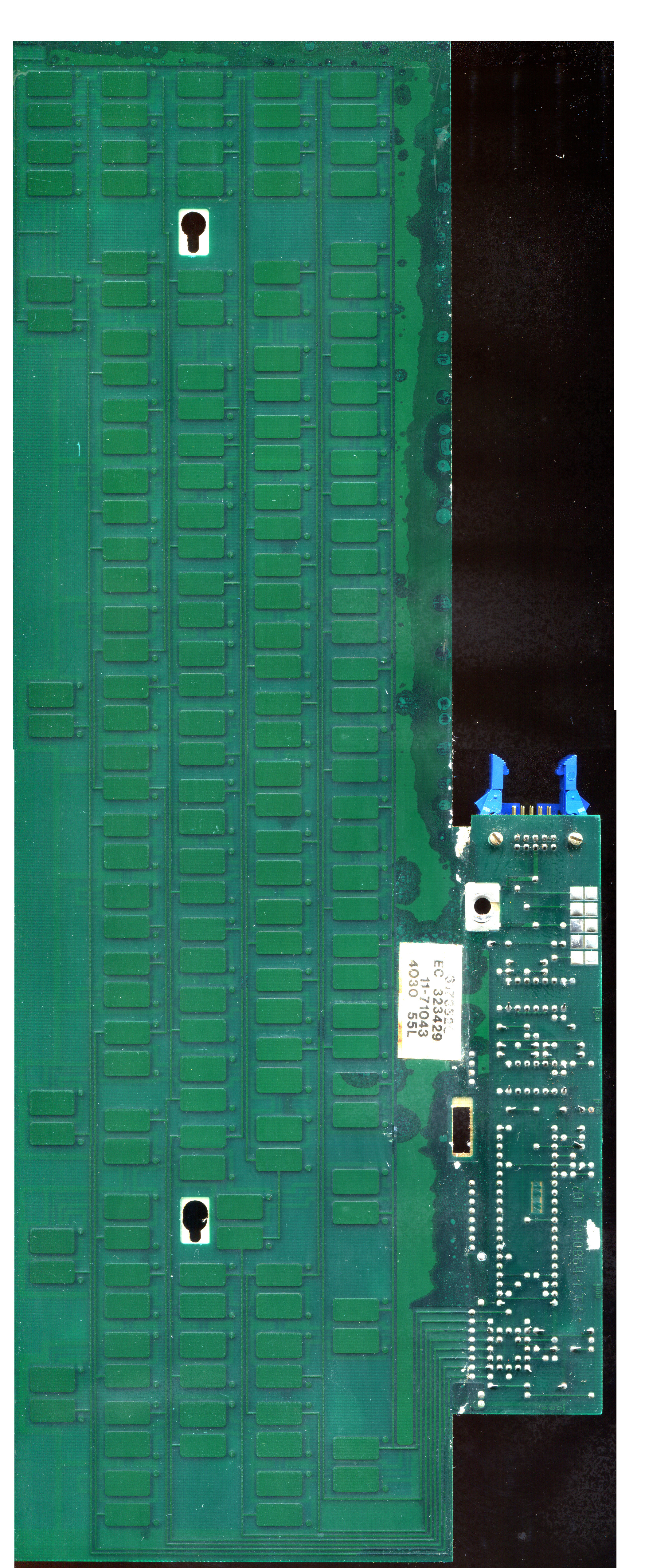

DMA wrote: So, if anyone has such a PCB laying around, I would very much like to see the pictures, front and back, with closeup of the connector from both sides. I want to figure out if it worth connecting all 3 to the A/D ground point or the driving-side one can be connected directly to the ground at the USB entry point (A/D ground junction is _behind_ the chip if you're looking from the USB socket side, so there should be less switching noise on it).

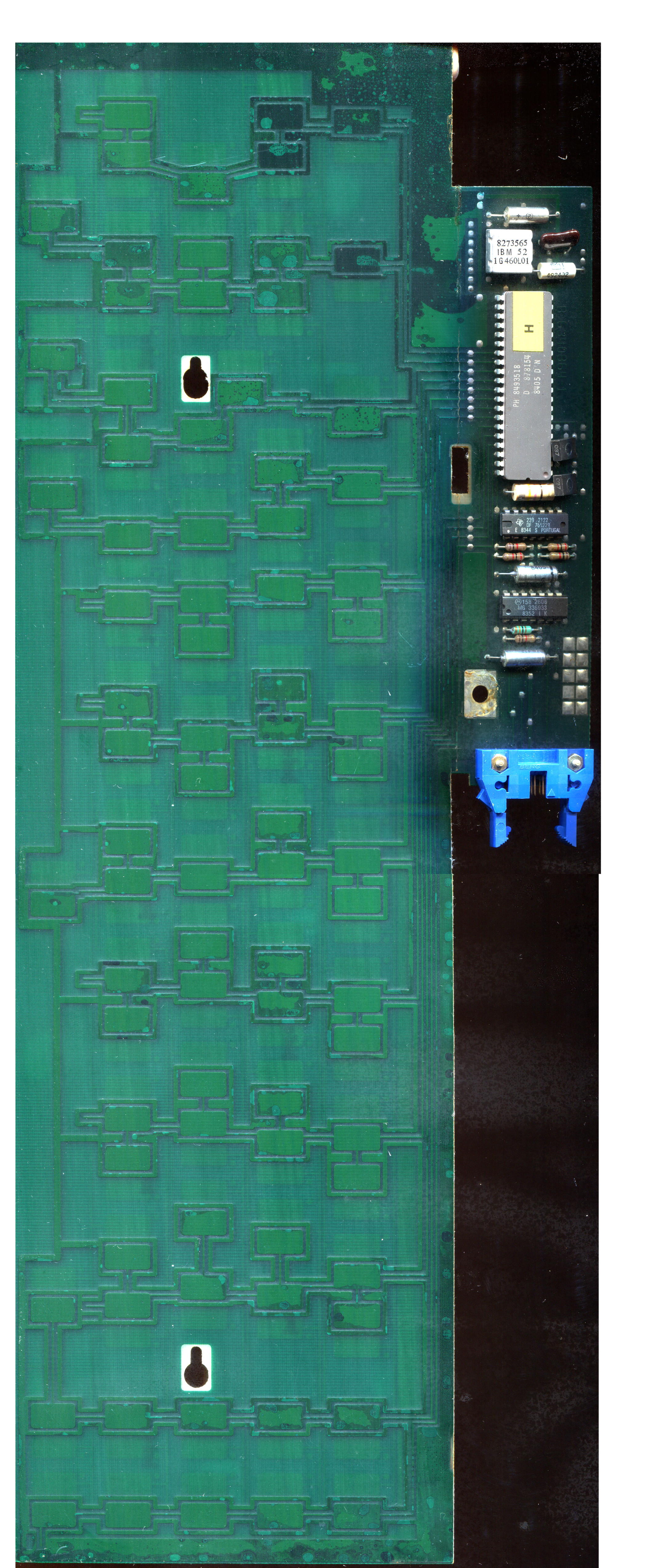

Will this be of help? It's an IBM PC-XT version. I can try to scan the Bigfoot PCB too, if time allows.
DMA
24 Jun 2016, 19:01
tigpha wrote: Will this be of help? It's an IBM PC-XT version. I can try to scan the Bigfoot PCB too, if time allows.
Thanks, it does help. F122 is different though - it has ground plane on both sides of sense lines. Probably because it's larger.
But seeing different examples of the mostly same design allows to understand it better, so this was more valuable even.
Is the dark stuff corrosion? If it is - does that keyboard even work?
Bigfoot PCB would be nice to see but only because bigfoots seemingly don't have a controller, only drive/sense parts. At least it looks like that from the schematics on kbdbabel.
One more interesting thing about XT PCB - I can't find any calibration pads. F122 has it somewhere around right Ctrl. Looks like a small square thing between normal keys.
Update: Found it! It's between F keys and the control - piece of sense line going nowhere.
Glad to be of service. I'd like to see scans of an F122 PCB to see the differences.
DMA wrote: Is the dark stuff corrosion? If it is - does that keyboard even work?
Yes, I think it's cupric oxide. The solder mask must have pinholes that exposed the copper to air. This PCB is from a keyboard that was worse for wear, and must have been flooded at some point. I have no idea if it works at all. I'm salvaging parts from that one to donate to the siXTyPerCent I'm designing.
DMA wrote: Bigfoot PCB would be nice to see but only because bigfoots seemingly don't have a controller, only drive/sense parts. At least it looks like that from the schematics on kbdbabel.
There's not a lot different in the Bigfoot matrix layout, the style resembles the PC-XT layout quite closely, except that the PC-XT matrix is 8x8, whereas the Bigfoot is 16x4, if I recall correctly. The PC-XT and Bigfoot only differ in that the controller chip is simpler since it demultiplexes the address lines and strobe lines. The square silver capsense chip is probably very similar.
DMA wrote: One more interesting thing about XT PCB - I can't find any calibration pads. F122 has it somewhere around right Ctrl. Looks like a small square thing between normal keys.
Ah, I see it too, but I don't believe it's what you think it is. You will notice that all traces end in that way. I guess that the column and row traces all cross each other, and that these crossings have to be an equal number. You might be able to see, along the position of the space bar, that there are similar "dangling" ends on the column traces on the other side of the PCB, that cross the bottom horizontal trace.
I think that one of the Bigfoots has a calibration pad, which looks very much like the others except that there is no corresponding key matching its position. The keyboard in question is my main driver at home, so it may be a while before I pull it apart again, unfortunately.

That little trace to nowhere is ... every row crosses every column exactly one time. This is true for all IBM model F. I'll post pictures of 122, AT, and Kishsaver when I get home.

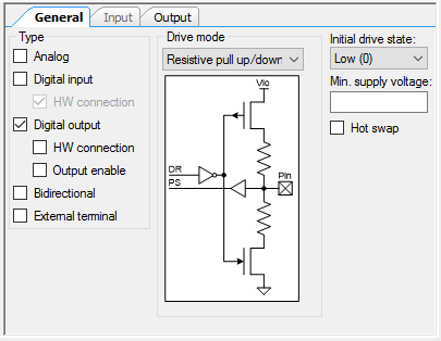

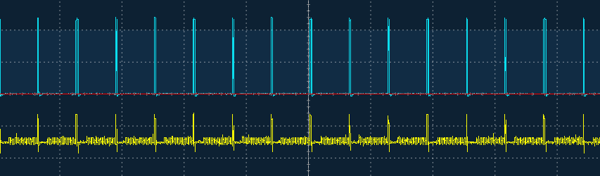

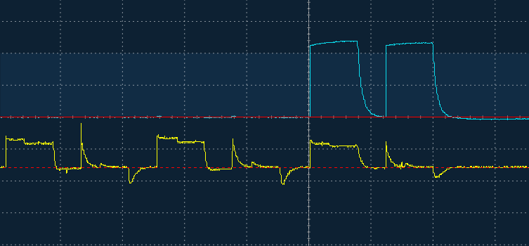

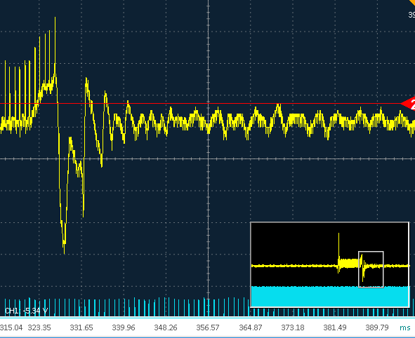

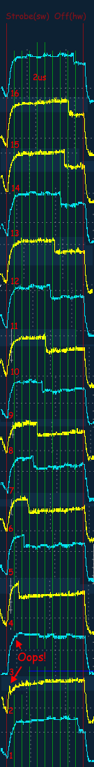

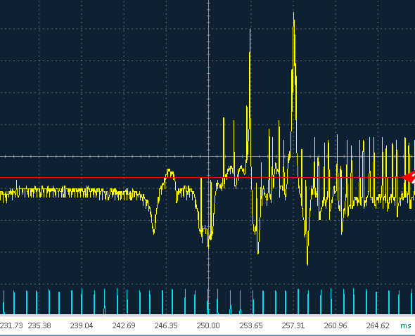

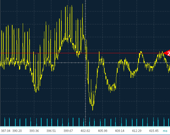

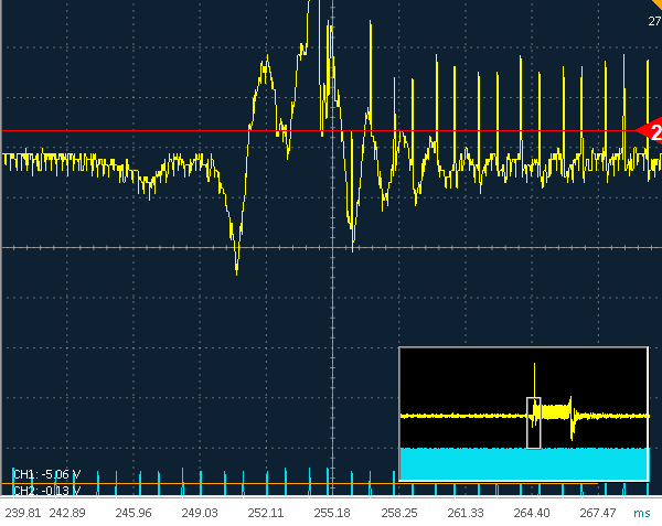

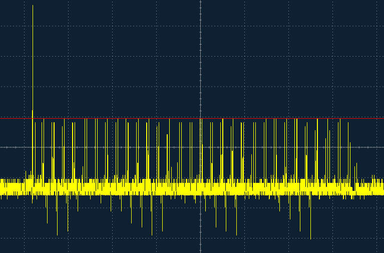

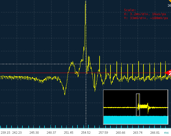

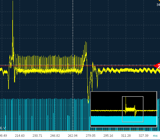

I'm writing this post using the
Well, I tried.. after the above line backspace produced all F-keys pressed together :)
Anyway. I have good news.
The ringing was generated by impedance mismatch between the (driving line + grounded sense line) and the driving pin.
After reconfiguring the pins to "resistive pulldown" and doing some other stuff on the side so that the pulldown resistor can be disconnected by CPU signal looks like this:
Whole row (It is NOT EASY to push all 16 keys at once - my hand is not long enough!)
And the overview!
Still, backspace lights even F1 sometimes, and left alt sometimes mometratily triggers things up to F24 and numlock.
So. Strong drive + tuned resistors on sense lines should bring the false positive rates down, but debouncing will still be needed. Will try to test dual-ADC non-pin-wasting design over the weekend, see if scan rate can be brought higher than 2kHz so there's enough time budget for debouncing.

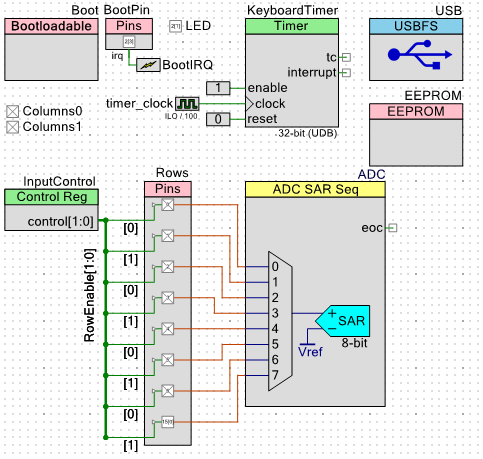

DMA
27 Jun 2016, 03:16

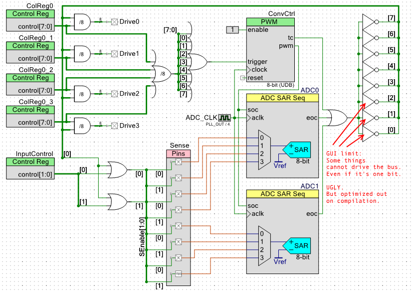

I'm out of macrocells (whatever that is). And there's no chip with more of those!
It looked like this on previous step.
It used 40% of macrocells available on the chip.
Then I tried to use both ADCs. It escalated quickly - next wanted to push column reading, including pin management, to hardware in an attempt to reduce duty cycle (I'm still hoping that readouts will be calmer if given more time for the matrix to settle down).
Also laid the ground for 32-drive-element matrix - though this wasn't the culprit.
out of macrocells.png (78.71 KiB) Viewed 10146 times
Now it doesn't compile - requires 207 macrocells out of 192.
So will need to sacrifice something.
Also it looks like dual-ADC PSoC5 is $12+. I remember people objecting to $10 per MCU, so probably all this dual-ADC idea isn't worth pursuing.
Update: trying to make the dual ADCs with a single sequencer.
Doesn't work so far - but shorting out SoC to EoC produces 1us pulse, so there's a good chance achieving pretty low duty cycle, limited only by pulse rise time (and this can be made shorter with better impedance matching).

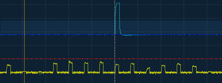

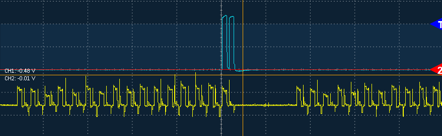

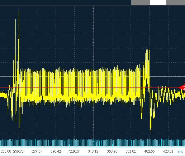

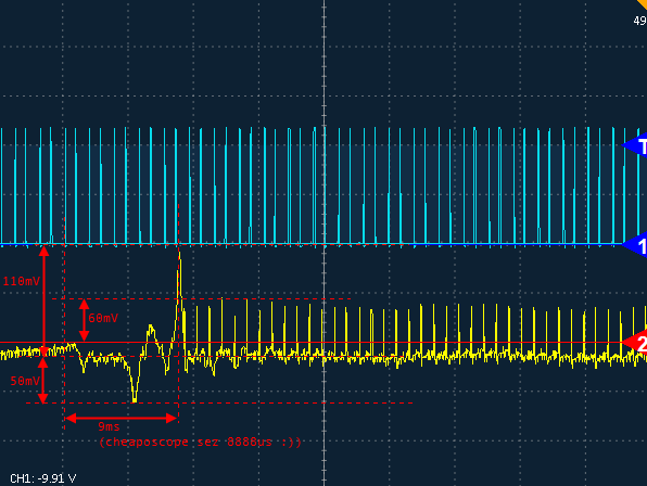

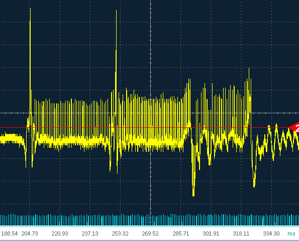

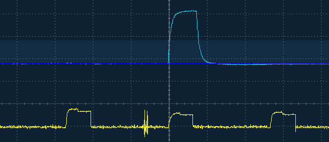

I was lucky today.
(note: blue stuff goes into the matrix, yellow stuff goes out of it!)
I accidentally cheap-o-scope to 50ms (whatever that means. It usually is at 50us at most) and lo! The macroscopic worldview!
Look as the key beautifully flies towards the sense card!
And here's the full keypress - seventy five milliseconds, roundtrip. I was able to make it as short as 45ms - but I'm too lazy to redo all the texts and arrows. Lots of attempts to the shortest keypress failed to register though.
Look at that in details!
Here's the keypress:
And here's the gory details. What a bitch to detect!
And then you have the steady state, and then it gets impatient and flies off
WITH A BANG AND THE ECHO REPEATING THAT SOUND OVER AND OVER
And it's not like that's an exception. It happens every motherfucking time.
And this is what happens when you take a 4-key chord. What a nice, smooth picture!
Look how they bomb the PCB
And fly away
But that's a chord. Surely things will be better if you press them more slowly?
NO
And that's all happens on pulled-down rows, mind you.
Luckily, this doesn't spread to adjacent rows. At least not next to the one I have a test point soldered.
Bottom line: I don't know how xwhatsit actually managed to detect keys reliably.

Spent almost 2 weeks banging me head on the dual-ADC version.
Fuck it, not going there.
Stashed the, for the lack of a better word, results. Just in case, you know.
Back to scanning ADC.
Meanwhile had this idea to drive rows and listen at the columns. Signal is surprisingly good. Can't read it properly though - and the problem is not noise, it's - again, looking at amount of ground around those columns, surprisingly - crosstalk.
Snapped pictures of every column's response to figure out if there's any time can be squeezed out of the single ADC.
Turns out I was starting the scan too soon. Put PWM between driving the column up and starting conversion. Turns out PWM cannot delay for less than 3us. Good enough in my case.
But why cypress doesn't just have a "delay X clock pulses" primitive is beyond me. You have to use PWM (or possibly a down counter?) for that.
Good news is that scanning is done by hardware, MCU can do something else at this time (like reading the results of previous column scan).
Looking at my F122's PCB I think the response can be greatly enhanced by shorting the ground traces between columns to the ground wire which goes to the controller. Because it's basically one looooong trace going around all those columns. Carries all the charge.
Interlaced scanning can help there - because of all those other columns forming a huuuuge capacitor between that ground trace and the "true" "ground" (let's leave the question of existence of such a thing to philosophers).
But sacrificing half of the scan rate makes me *frumple*.
PS: Funny thing is the crosstalk only affect keys to the left of the key pressed. Probably that ground trace's resistance to the left is lower than to the right.

Unsoldered everything to figure out why the hell the ? key behaves like it does.
THE PCB IS PRISTINE. THE FLIPPERS LOOK IDENTICAL.
It's mocking me :(((
So, at this stage I can't get a working keyboard. Need a second body.
