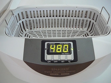

On advice from XMIT, I bought an iSonic P4820-WPB through Amazon for $89.00.
I've been using it for keycaps and Alps switch components, and it does a great job.
It occurred to me that an ultrasonic cleaner might be a way to clean keyboard cables -- especially coiled ones that are especially hard to clean. Has anyone tried this? I suppose if the cable has an unsealed end -- such as the header connector and its exposed wires -- that this part should not be submerged in liquid. Likewise, if the insulation were cracked, water could get inside the cable, and it would be difficult to dry it out. Otherwise, it should be okay. I will give this a try with an extra cable and post the result.
[ XMIT ]
29 Oct 2016, 19:54
Glad it works for you! I really wish mine had a basket like that, it would make life so much easier. They're only $15 on eBay. I'll just buy one.

I made my own basket with a much finer grid since I started cleaning stabilizer parts. They fall right through the gaps...
Still had some fine mesh steel mat that I bent into a little basket, haven't had anything fall through since :)
E3E
29 Oct 2016, 23:09
I've got a bunch of stainless steel seeves I used for dyeing key caps that'd probably work well. I definitely want to get a larger cleaner though. 2L is too tiny for me. D:
