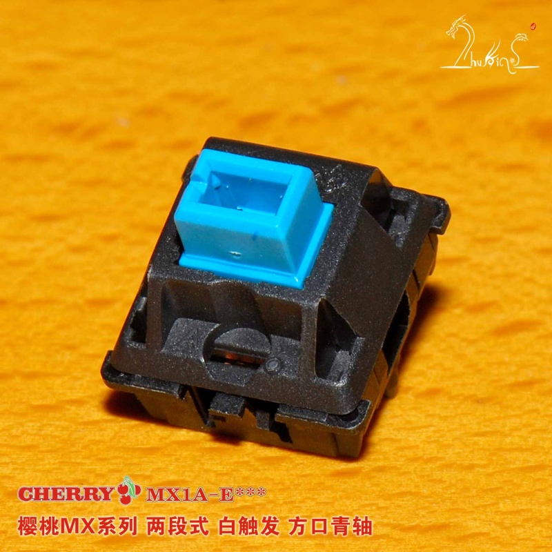

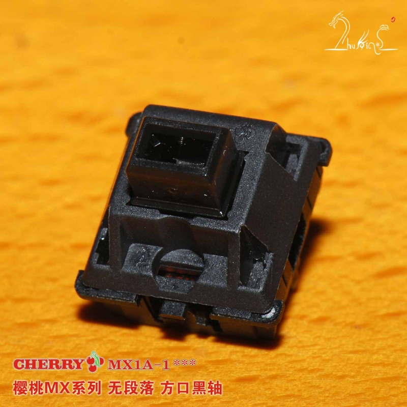

This is my Chinese friend 's two photos,Presumably you all know him.Unfortunately,I do not have them,They are‘Cherry MX ALPS Clicky’and‘Cherry MX ALPS Linear’,My friend told me,Many have been given to others,He has no superfluous,I would like to collect them very much.If you have , please contact me,Thank you very much!
这两张图出自我一位中国朋友那里,想必大家也许会认识他,很遗憾我没有收集到这两款轴体,分别是方口青轴和方口黑轴,我的朋友告诉我说他已经没有多余的这两个轴体,很多送了出去,我很想收集到它们,如果你们哪位有的话请与我取得联系,非常感谢!
06 Jan 2017, 19:10
I would not call it a "dwarf" switch: it seems to be the same height as a normal Cherry MX switch. The difference is that the distance between the PCB and mounting plate is greater. In old keyboards, the mounting plate was high up from the PCB, but German standardisation effectively required that the mounting place be moved closer to the PCB.
See the following illustration:
[wiki]DIN standard[/wiki]
The "dwarfism" switch will be a customer-specific part.
The other photos are of no use without knowing the product they were taken from, and the year that these products were made. They could be 2000s, 1990s or 1980s parts. They could be real or fake (see Aristotle Yellow). They could be from keyboards or they could be from industrial machinery. They could be stock products, or they could be custom parts. Without having this information, you can't draw any conclusions. Not enough Cherry catalogues and brochures have been found yet to know exactly what was available for sale in the past.
I don't trust Costar either. I would not use Costar as an example of a brand who would only use genuine major brand parts. Costar don't make keyboards anyway; they subcontract the work to other companies. It's hard to tell whether similar/identical parts from different keyboards were due to shared subcontractors or simple copying. For example, that Deyi keyboard has the same design of feet (with the strange hooks) as Focus and Tai-Hao keyboards. It's very hard to determine just which companies really do own factories and mould/stamp/drill/assemble/solder their own parts. Did Focus ever make anything, or did they only design keyboards and subcontract out the manufacturing? Monterey are another example: the K110 (as in the SIIG MiniTouch) was made in two separate factories: one in Taiwan (using SMK switches) and one in China (using Himake switches). I guess this was two separate subcontractors.

06 Jan 2017, 21:37
seebart wrote: :o :? This is one for Chyrosan 22. :P
Keep up! We've known about them for years — the person that UncleFan is referring to (Brother Dragon) is a member here and he posted his own pictures. They're all listed under [wiki]Cherry MX[/wiki].
07 Jan 2017, 00:58
Indeed, I wish I had these, just like those ProWorld switches. I've been wondering about these for a while, I really wonder where/what keyboard they came from.
UncleFan
07 Jan 2017, 06:33
Daniel Beardsmore wrote: I would not call it a "dwarf" switch: it seems to be the same height as a normal Cherry MX switch. The difference is that the distance between the PCB and mounting plate is greater. In old keyboards, the mounting plate was high up from the PCB, but German standardisation effectively required that the mounting place be moved closer to the PCB.
Thanks again for your information!That is to say,The "dwarfism" switch ,It is a product of adaptability.Is there anything else besides "dwarfism" Linear Clear ?Evidently, Many special switches,Are from Taiwan OEM.
