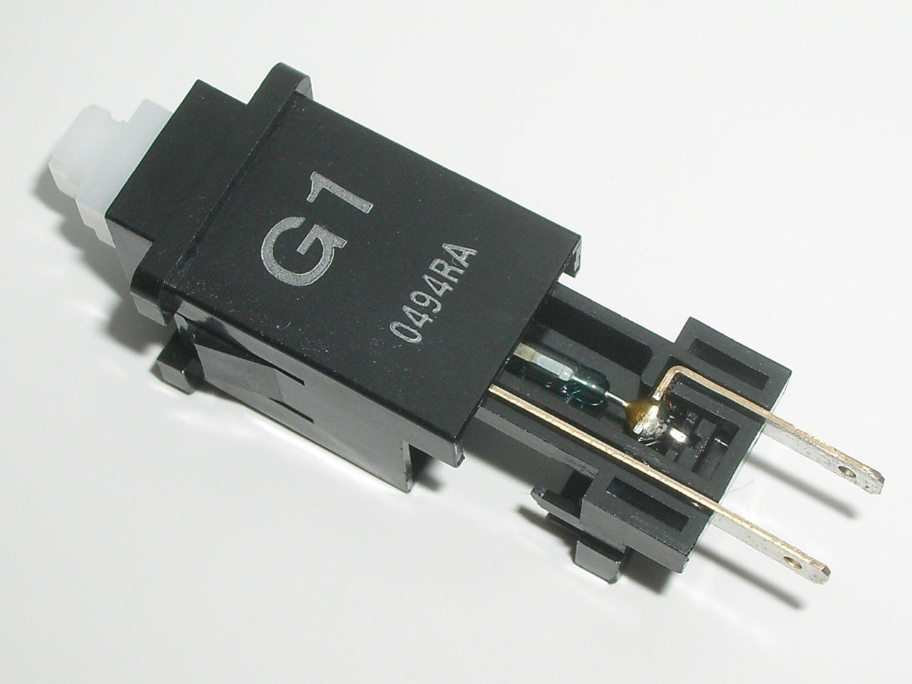

I didn't need to see inside them — it's just nice to have a photo or two of the G1 variant to show that more shapes existed in the range besides M.

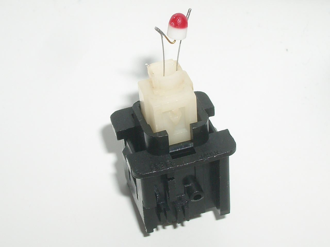

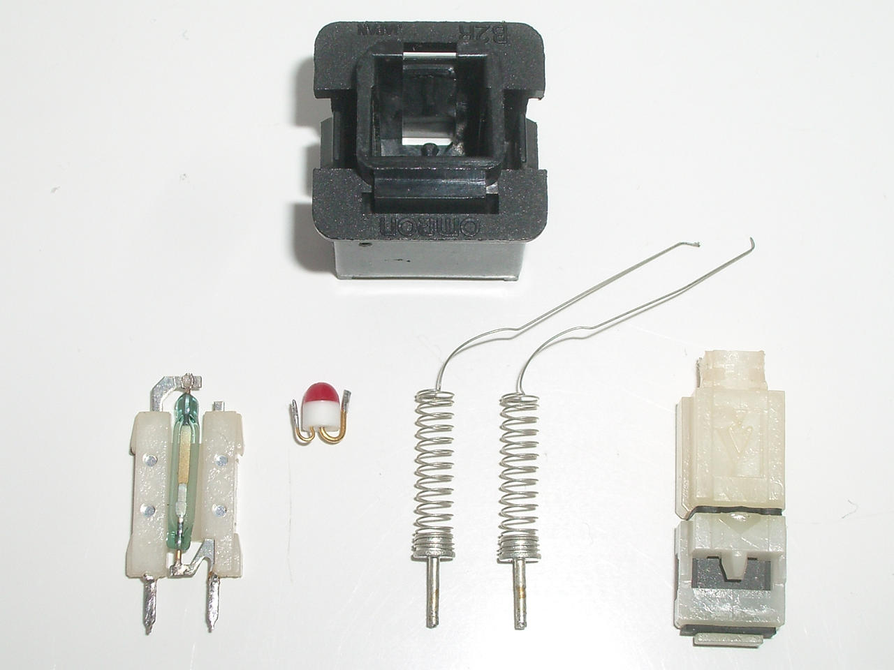

I knew that the LED version (now suggested to be B2R-ME1) couldn't use the same internals, but I didn't know what I'd find inside. It's definitely not what I was thinking:
B2R-ME1 1.jpg (72.25 KiB) Viewed 3348 times
B2R-ME1 2.jpg (159.68 KiB) Viewed 3348 times
B2R-ME1 3.jpg (105.09 KiB) Viewed 3348 times
"ME1" is written on the switch but you can't see it in the photo; the corresponding non-illuminated switch is M1, which is otherwise identical to M.
It's hard to see in the photo, but there's a cam track on the slider, so an alternate action version exists, and therefore this confirms one reason for the greebling on the shell.

Daniel Beardsmore wrote: I knew that the LED version (now suggested to be B2R-ME1) couldn't use the same internals, but I didn't know what I'd find inside. It's definitely not what I was thinking:
Very good pictures though.
22 Mar 2017, 09:36
I'm contemplating opening another (I have three) but leaving the LED alone — if executed correctly, the slider and both springs will all come out together. The conductor springs just rest in the bottom of the switch (giving you in effect sprung terminals). However, the POM slider is very slippery and since the pliers are likely to slip, it could end up crushing the LED. Getting the slider out isn't easy, and I've broken the keycap mount off one slider in the process already.
If I could get it right, I'd have the springs intact. However, you can't then remove those as they're soldered to the LED.
I'd like to straighten out the wires, but I'm not sure quite what shape they're meant to be. Largely vertical, since they go up inside the slider.

That construction with the LED atop those wires seems generously intricate.
22 Mar 2017, 18:55
The LED is wedged in fairly securely.

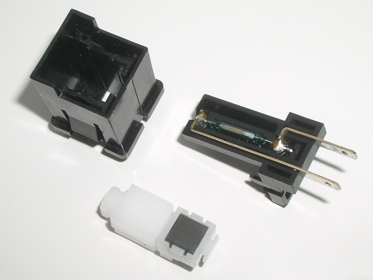

And yes, you cannot disassemble these safely without special tools. I got lucky the first time: the slider came out easily. Switch no. 2 required such intense force that it tore apart the ridge that holds the slider in, and ripped one of the springs clean in two. I don't even know where the rest of that spring is. The other spring got totally unwound.
To open these, you need a jig to hold both the slider and shell securely, and the very slowly (using low gearing) pull on the slider under constant motion until it comes out. There's nothing holding the springs down, but the slider removal is so violent that it will destroy them anyway.
That's my last spare switch used up — I have three, and I have one good one left. (8 good M, 2 broken M, 1 good M1, 1 good ME1, and 2 broken ME1. I can make 9 good M from the parts I have.)

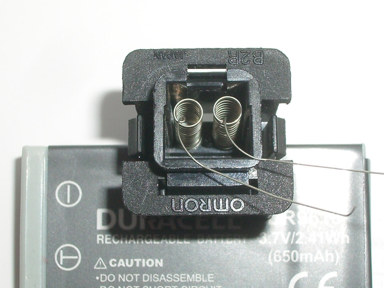

Ail wrote: Well, I tried everything to get that damn bottom piece to pull out from the top piece and while I did not break anything, I certainly did not get them to separate and the pins are starting to loosen on the switch I attempted to pull apart.
The legs cannot possibly loosen, but the one that you pull on gets badly bent in both axes from the extraction force. I'd already straightened it before I shot this:
In theory you may be able to lever out the base, but I couldn't get that to work.
The slider is exactly the same as B2R-M, but the rubber dampening rings are omitted:
These therefore can be used to replace broken keystems in B2R-M switches if you can get the broken stems out. These stems come out the bottom, so they can be removed safely.
