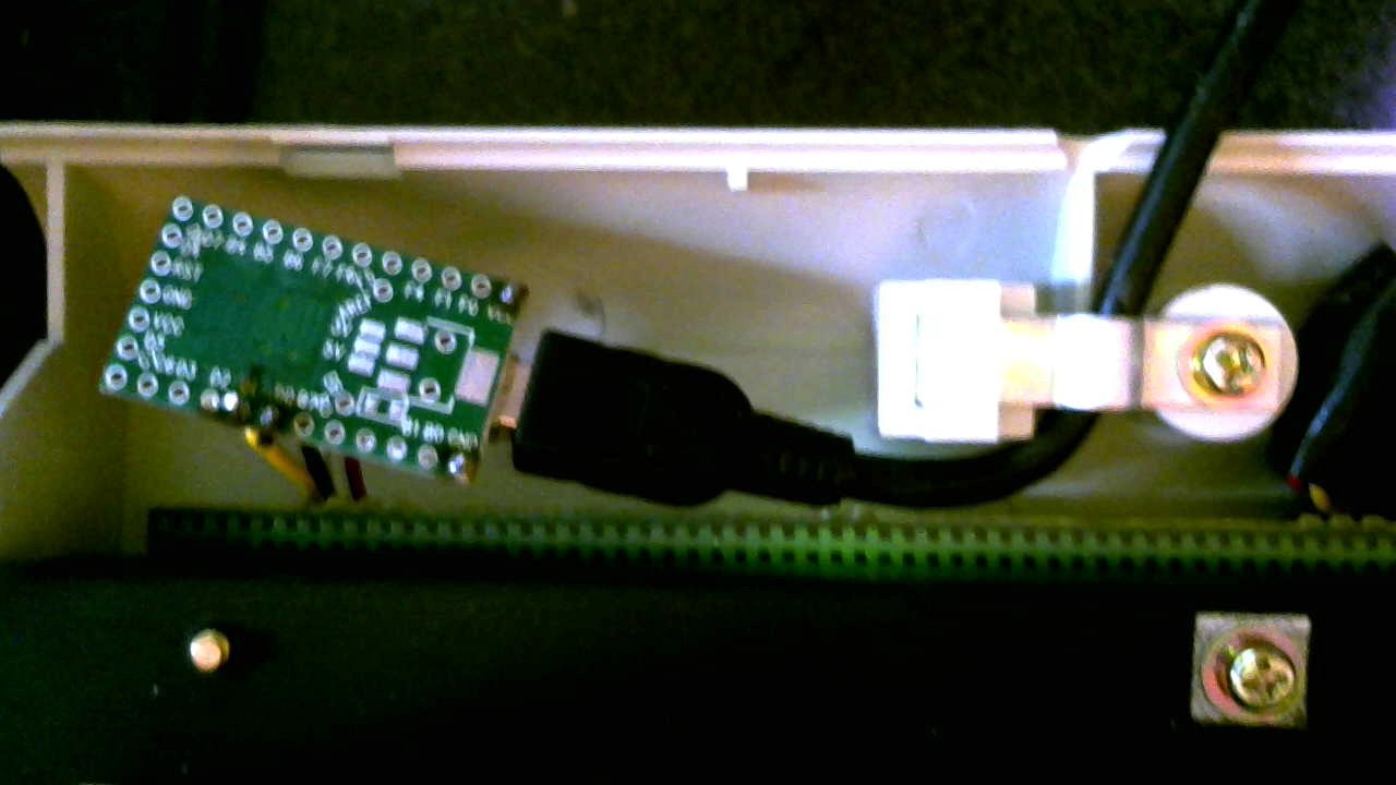

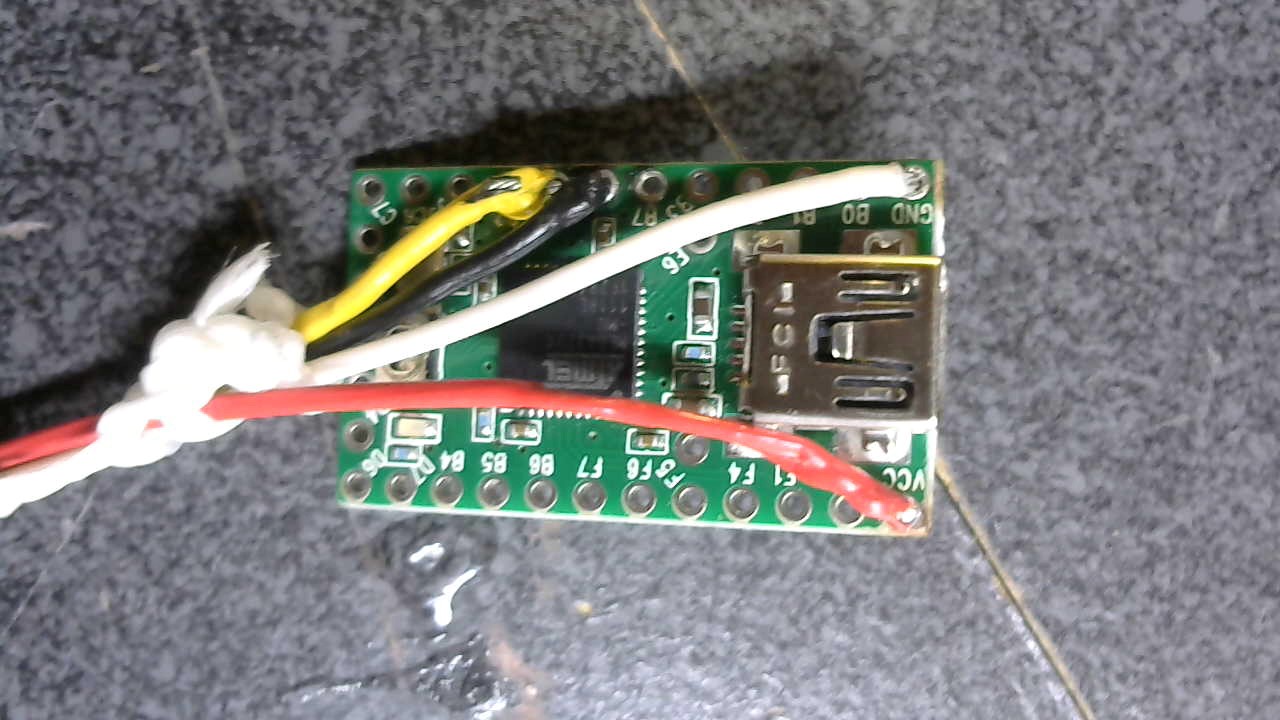

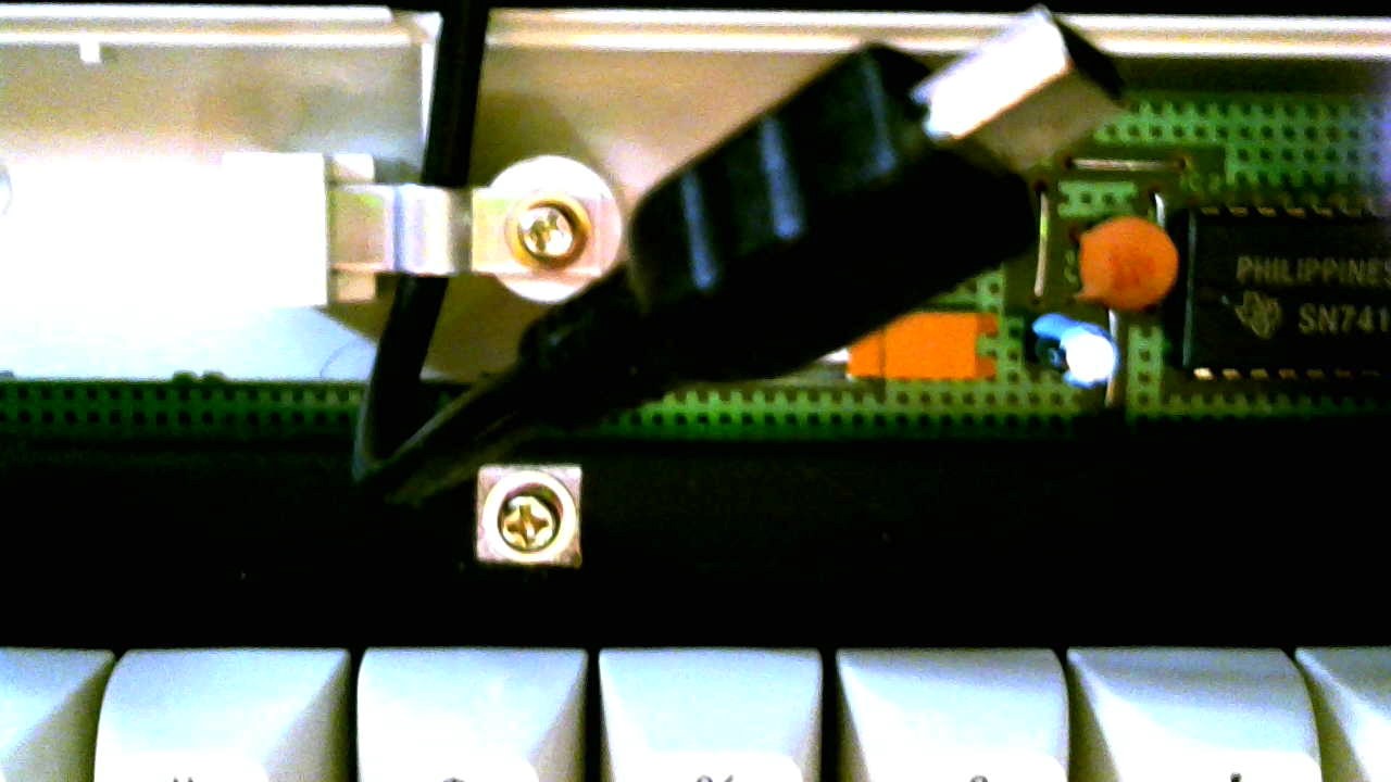

fsck it, now I'm interested... the board:

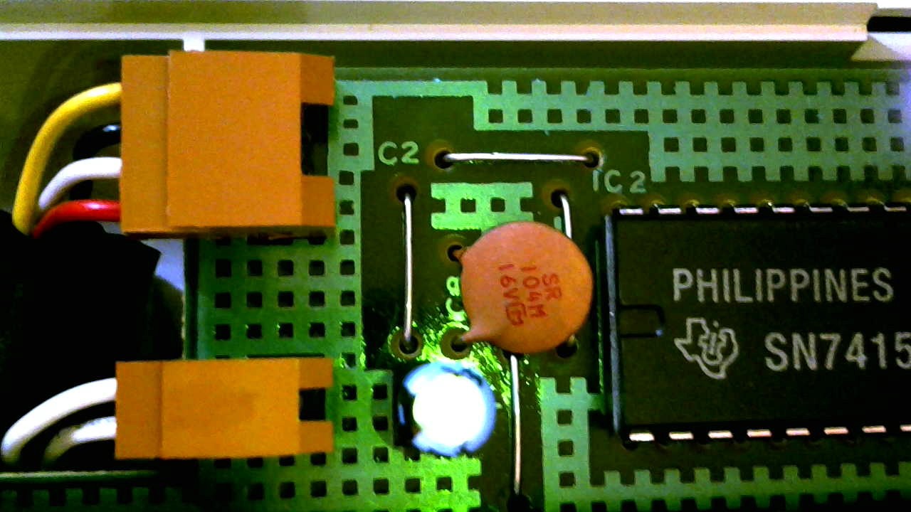

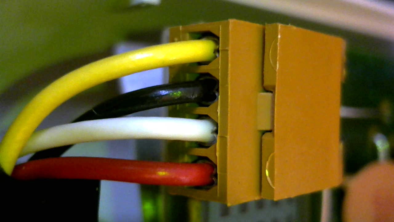

The connector you're interested in in context (top):

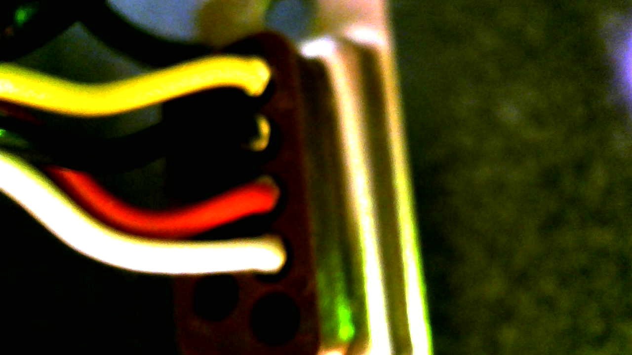

Closer... because I want to document the colours:

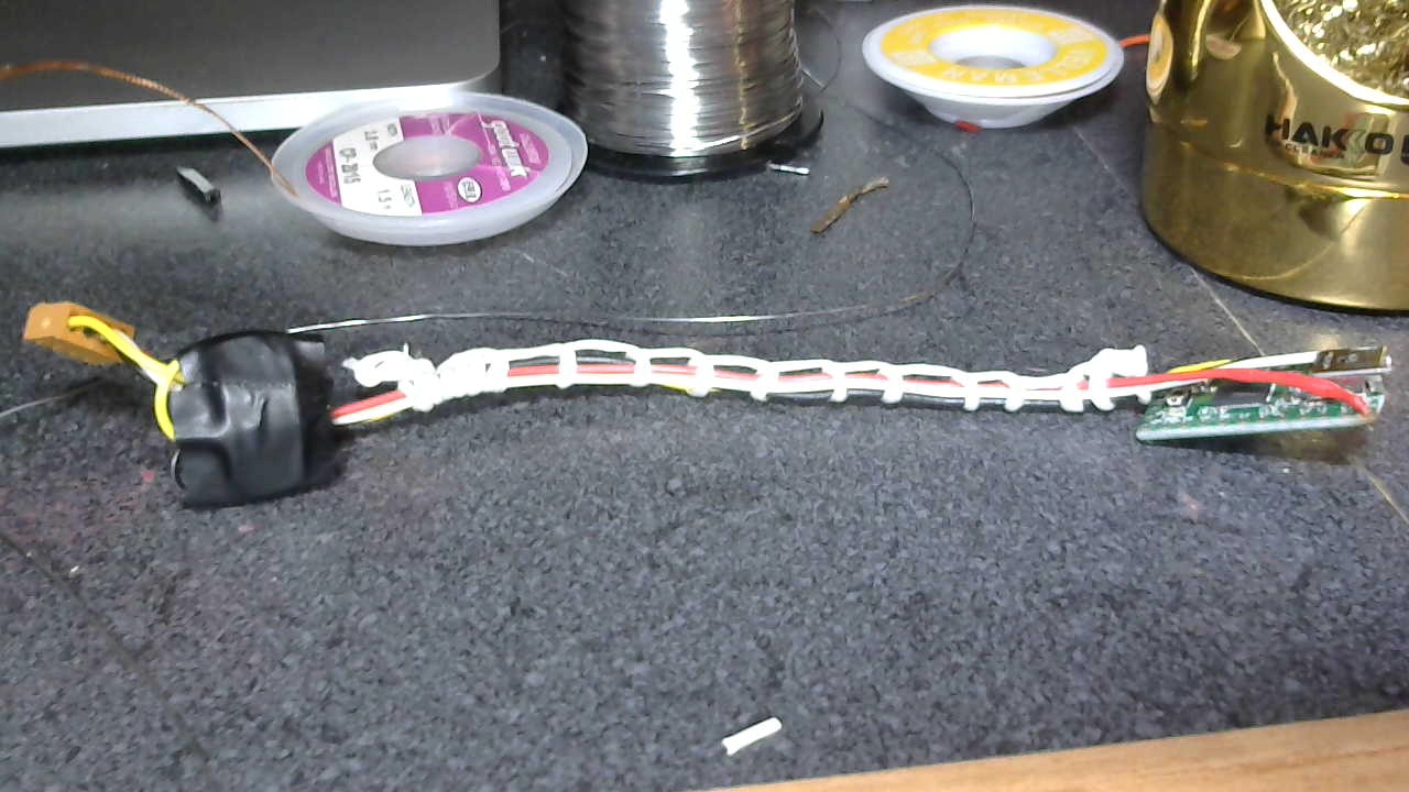

Now... let's take apart the plug at the other end... and note colours:
Remove the original cable, add USB to retainer:
... and steal the original connector:
... thus far:
__red__
20 Apr 2017, 03:44
DSUB-9
\ N 2 3 4 5 /
\ N N N N /
2 GND
3 VCC 5V
4 DATA
5 CLOCK
N No connection/No pin.
So - the colours of the cable are:
GND - White
Red - VCC 5V
Black - Data
Yellow - Clock
Chassis Ground - Ignore for now.

__red__
20 Apr 2017, 03:46
Sweet! I'm breaking out my soldering iron.
This is the 6th or 7th time this teensy has been re-soldered so I stand a decent chance of breaking it - but I'll give it a shot.
Warming the iron...

So Red to VCC, GND to White ... that leaves PD0 and PD1 for Data and Clock. Which goes to which?
__red__
20 Apr 2017, 04:13
just_add_coffee wrote:
GND - White
Red - VCC 5V
Black - Data
Yellow - Clock
/* Pin configuration */
#define IBM4704_CLOCK_PORT PORTD
#define IBM4704_CLOCK_PIN PIND
#define IBM4704_CLOCK_DDR DDRD
#define IBM4704_CLOCK_BIT 1
#define IBM4704_DATA_PORT PORTD
#define IBM4704_DATA_PIN PIND
#define IBM4704_DATA_DDR DDRD
#define IBM4704_DATA_BIT 0

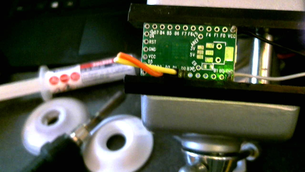

D0 Data
D1 Clock
Soldering cables (ps, I recommend you let me apply power first since I have a whole test lab here to debug)

__red__
20 Apr 2017, 04:31

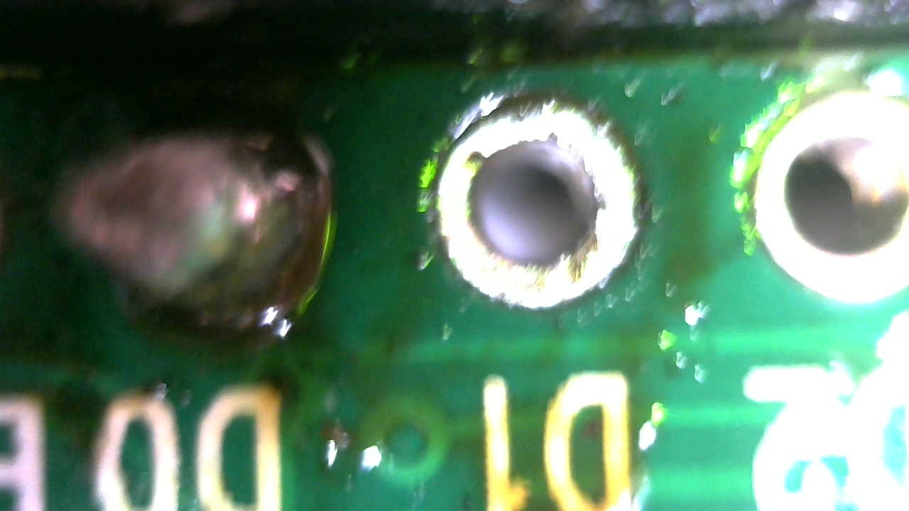

I'm having real problems with D1 due to my desoldering, may need to cheat - brb
__red__
20 Apr 2017, 04:35
^^^^ Nuke
__red__
20 Apr 2017, 04:39
There.
I dipped my wick and added heat. Ever seen a cleaner hole?

__red__

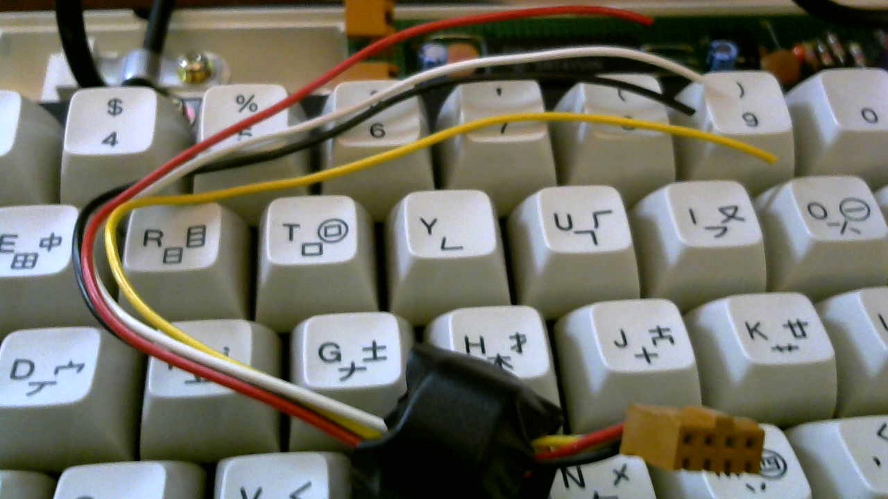

20 Apr 2017, 04:59
__red__
20 Apr 2017, 05:06
Confirmed, and typing this post on the keyboard with the teensy inside!
