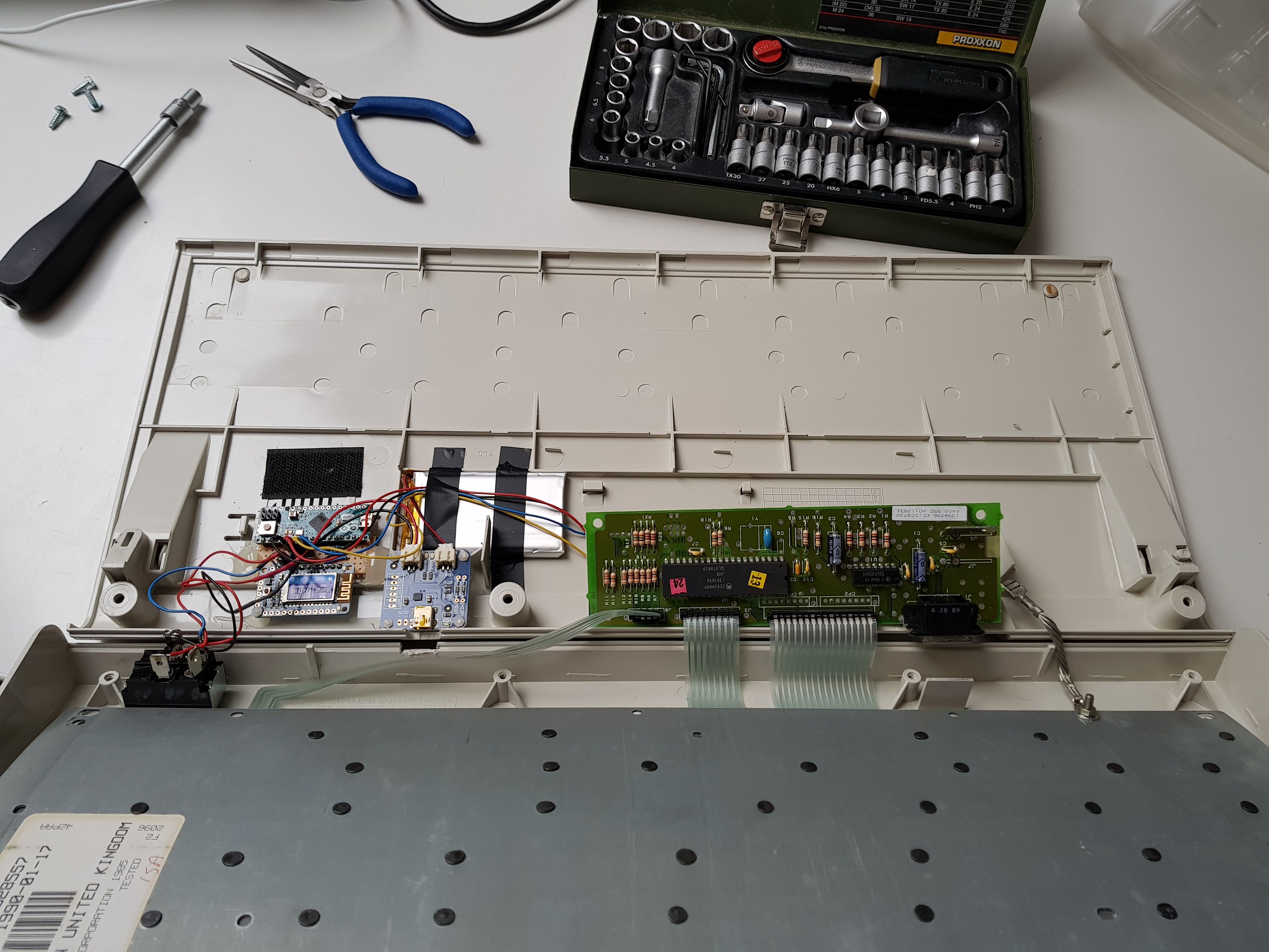

xueyao wrote: xwhatsit's capsense controller already has support Model F and is fully open sourced. It could just be built on with a Bluetooth controller and battery. No need to recreate the controller.
But it ain't right now, or is it? I don't see your point. More importantly, you can't 'just' slap on a BT module and battery and call it a day, don't be ridiculous. You will need a few extra bells and whistles or else
1. your circuit will not comply with USB specs (excessive inrush current when the battery starts charging),
2. your entire circuit will draw more current than necessary which is a waste of battery life and will require a bigger battery than necessary,
3. poor placement of the BT antenna will result in poor radio quality, or the BT radio might not work at all
4. poor layout, poor insulation and filtering + radio frequencies can affect the ADC that's necessary for sensing changes in capacitance
5. you will want to add some kind of battery charging circuit or charger IC, or you will not be able to recharge the battery in a convenient way
That's a bunch of things to consider and would require changing the layout of the corresponding PCB (if there is a reference layout for xwhatsit).
Now, if you've got the time and know-how to hack something together, that's great, but ain't everybody a whizkid, you know.

Wow didn't know there's so much to consider. Well at least there's a reference if u wanna design one I guess? I doubt a Model F design would sell well if u wanted to make money though since the M is way more famous.

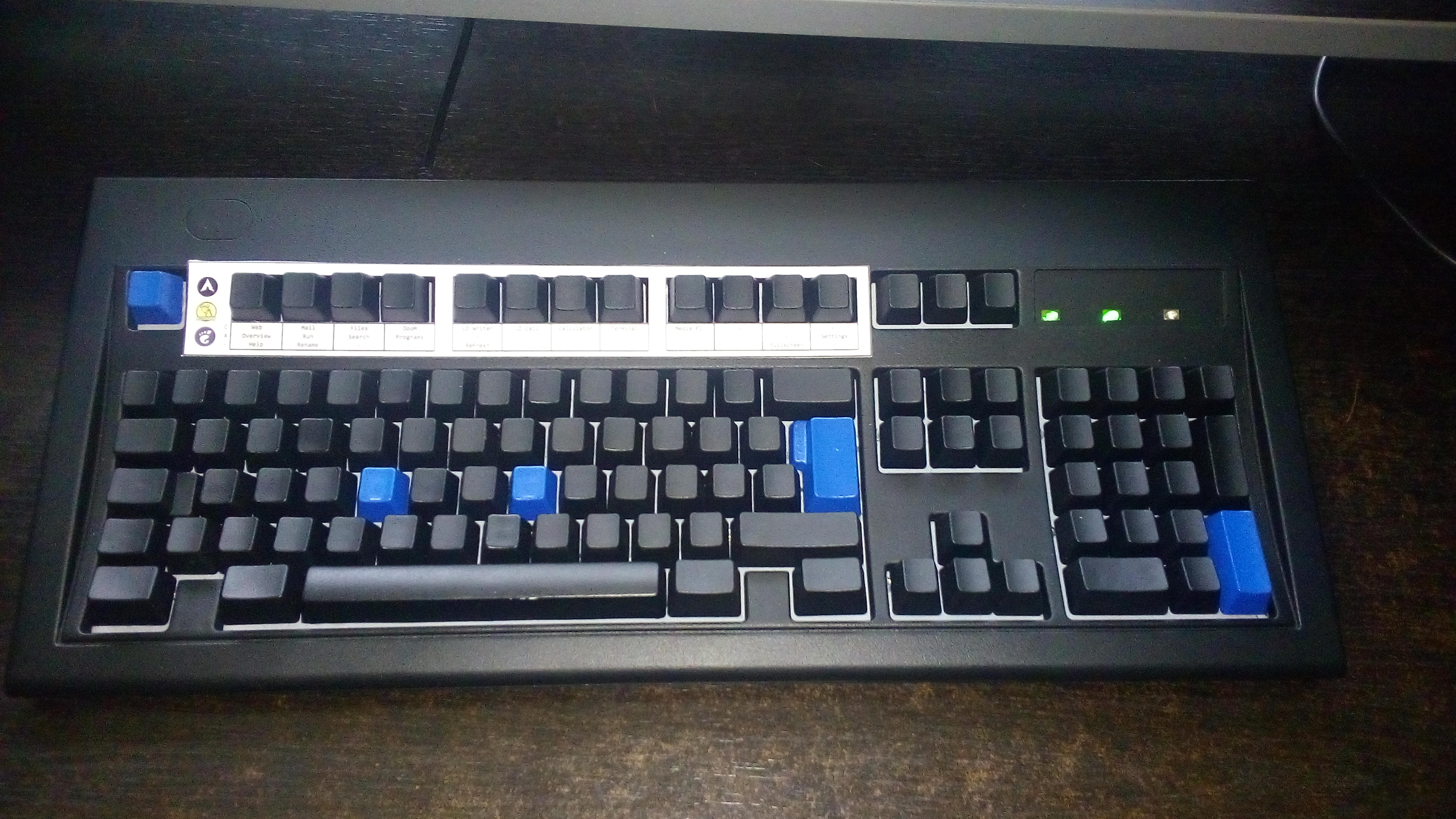

I had my dad's old IBM Model M from 1988 in the closet for a few years now, had painted it and was planning to make a controller for it myself, but then I found Jörn's ebay listing for it, got in touch with him and after some emailing back and forth, bought his controller. And am I glad I did. The controller has been working flawlessly so far, I can't say that I've experienced any lag (on the contrary even, DooM (the original of course) plays better with the Model M than with my "native" USB keyboard from HP :D) or ghosting, or other nasty effects. Jörn had included complete instructions + everything needed to install the controller, even 4 screws for closing up the case which was nice since I'd "misplaced" mine.
I've mostly used the keyboard over USB, but have connected to it over BT as well, and that went as well as over USB. Jörn did advise that the BT 4 controller might not work with an earlier BT chip, which is what I have in my old laptop (HP 2760p tablet PC), and he turned out to be right, my laptop BT chip apparently doesn't go looking for input devices, but the keyboard connects fine to my tablet and smartphone.

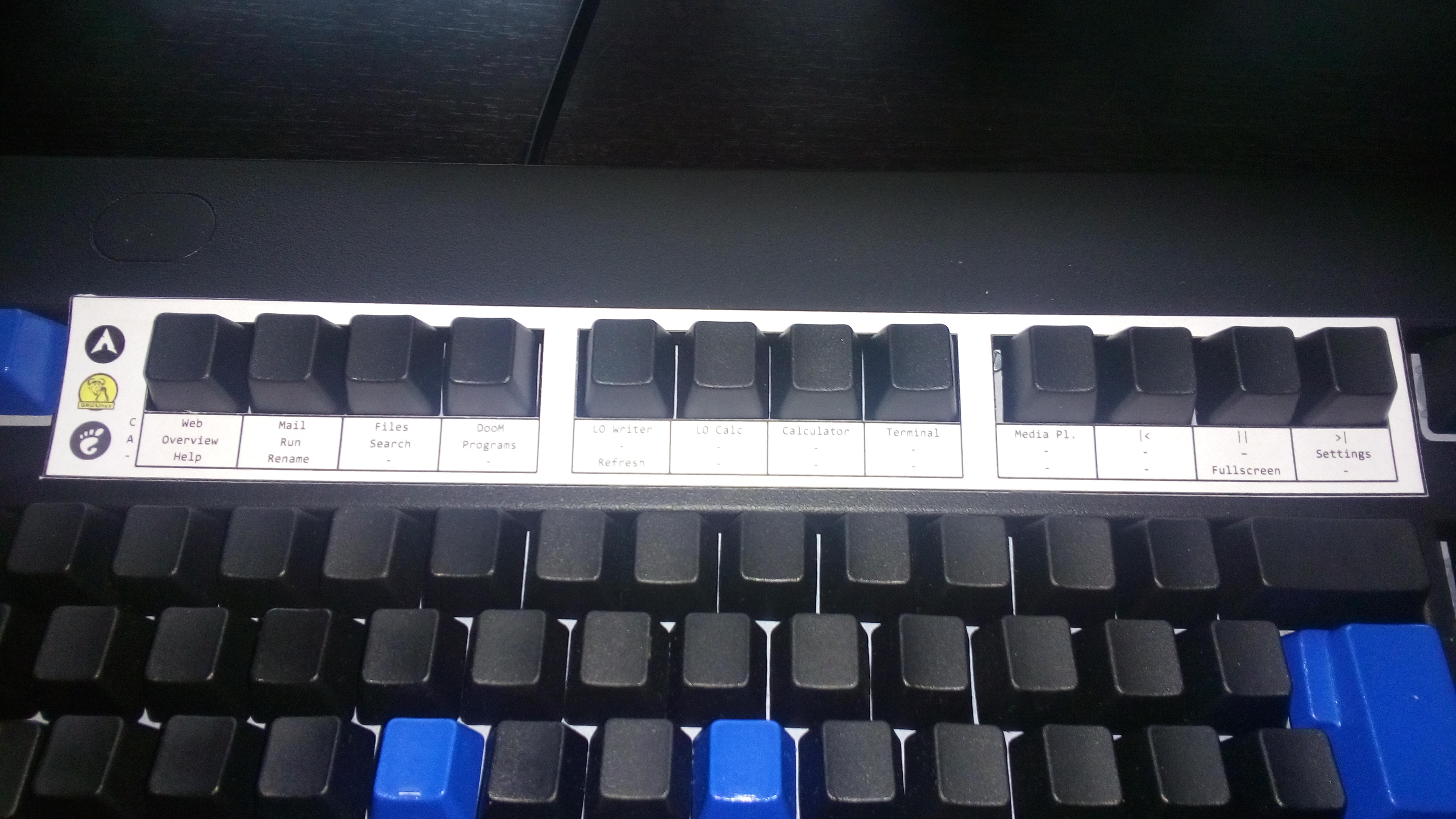

I included some pictures of my 99% complete custom keyboard, which I also bolt modded last week to fix some "sticky" keys, and of my desktop setup which is performing very nicely. I'm genuinely very happy that I went this route instead of making my own controller. I couldn't have done it any better myself honestly.
Some details:
Keyboard: IBM Model M from 1988 made in the UK
OS: Arch GNU+Linux
Desktop environment: GNOME
Use case: Work and music production mostly
Consider this my first post and a sort of 'hello'. I live in Belgium, if anybody wants to contact me, feel free.
PS if anyone is interested in the paper templates you can see in the pictures, let me know, I made them in LibreOffice Draw.

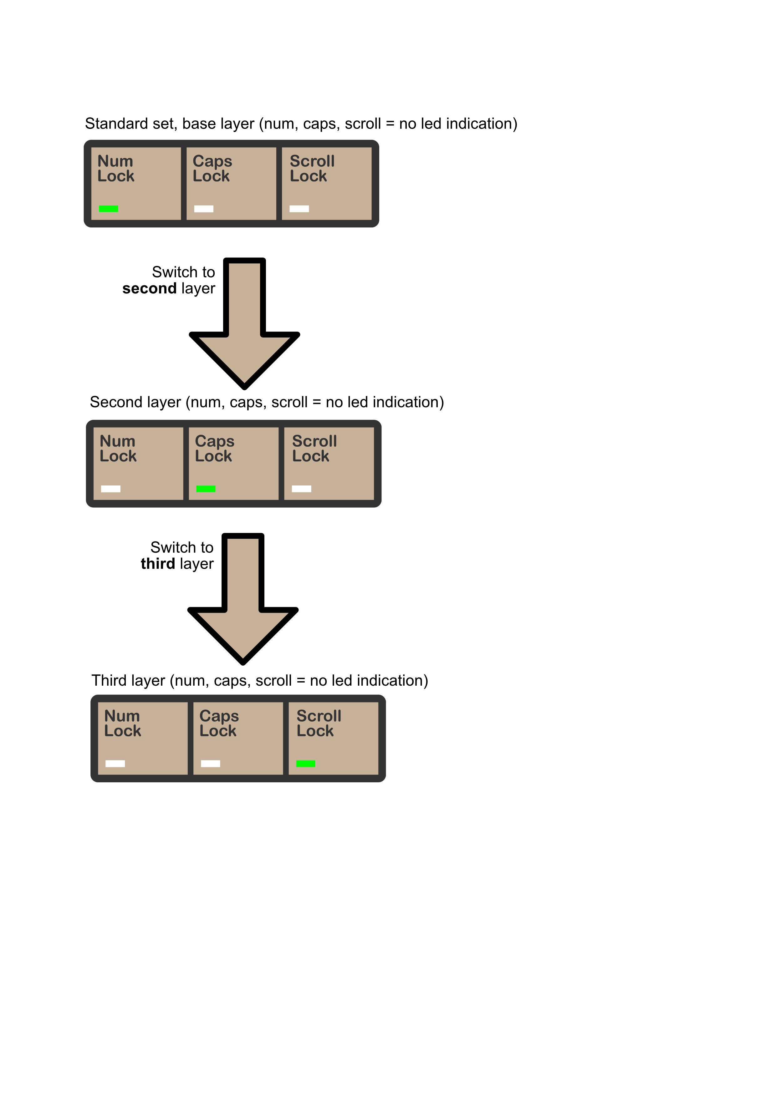

mind_prepared wrote: Up to 6 layers can be configured with a CLI. The next thing on the to do list would be a GUI for the programmer tool, something like the AIKON GUI, and I'm looking into that (actually Arakula, who posted feedback above, is looking into that right now). The firmware is pretty mature, but if demand justifies it, new features can be added. Pretty much anything you want. It's not meant to compete with the big guys though, s.a. TMK.
Quick question that I've thought about only now (and that may well have already been taken care of): after installing and stuff, when the keyboard announces its presence, does it have a fixed name, or can it be changed?

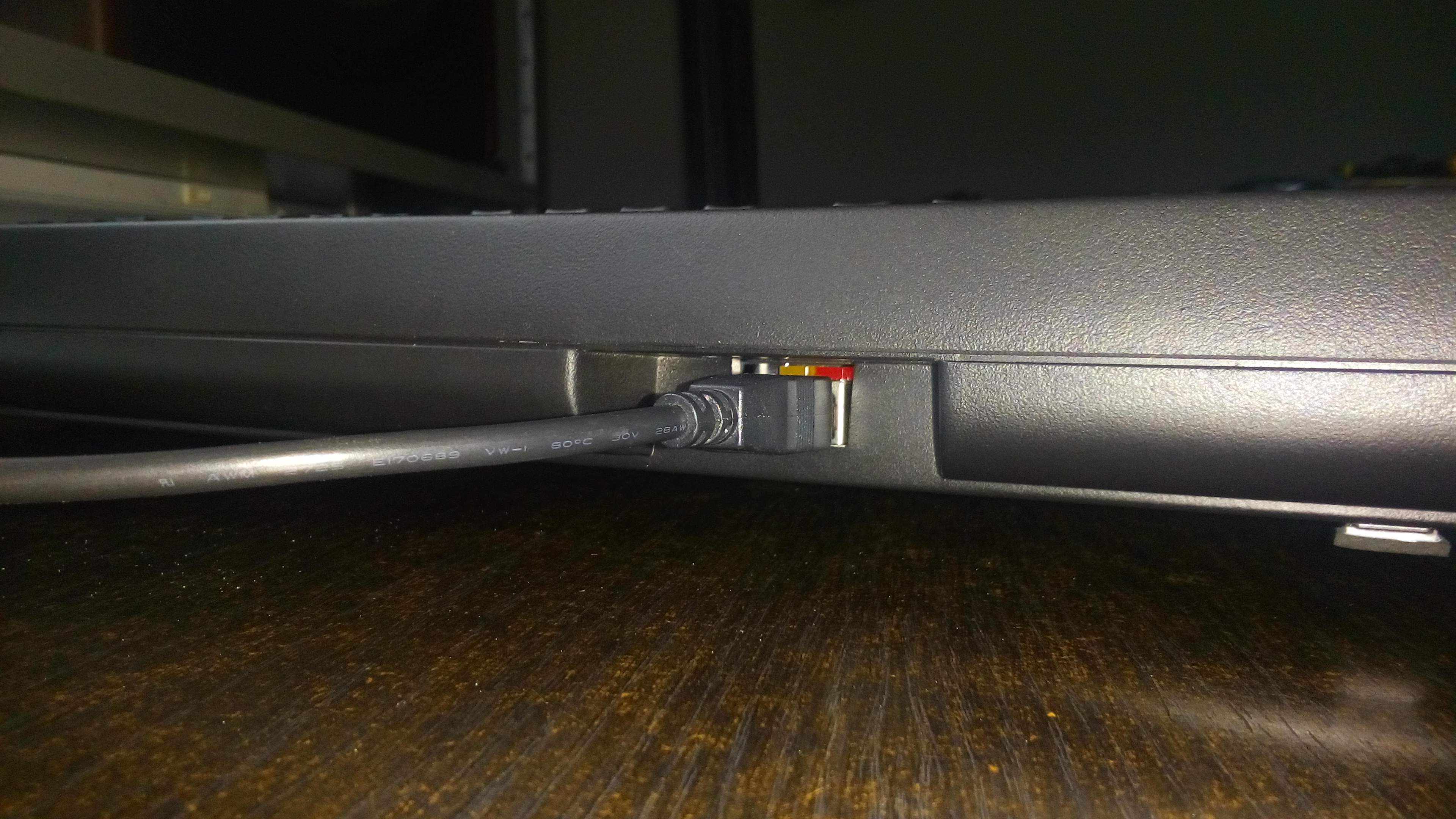

To anyone interested, I would like to inform you that I'm now also offering a BT-USB dongle that's capable of acting as a 'BT-USB bridge'/'USB cable replacer' along with my controller. The dongle can be used as a regular BT adapter that's controlled by the OS BT stack, but it can also function as stand-alone BT host that supplies its own BT stack. The modes of operation can be switched by software, too, if necessary. In the latter mode of operation, the dongle will present itself as a regular USB HID keyboard to the host system while pairing and bonding to the BT client device, in this case my controller, will be taken care of automatically. That way you can connect the keyboard to any USB-compatible system without any additional hassle. That might come in handy especially on legacy systems without any BT support.

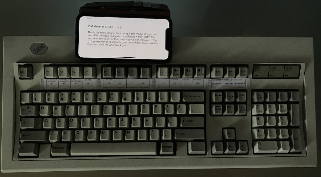

Hey Guys, this is my first post, as I ordered a Controller from Jörn and wanted to let you know, how happy I am with it.
For me the Model M is "the keyboard" - Brian Benchoff from Hackaday called it "God's own keyboard", and I fully agree.
I got my first Model M, when I was in Grade 2. I was just three years older than this awesome piece of hardware and since then I really love it. My flatmate turned crazy when I wrote my thesis on it, my colleagues later forced me to switch to a more silent keyboard in office and after I took it back home my wife made me use it during "non sleeping times" only. Never the less, it has since been in use.
After switching to an "all cupertino ecosystem" for my day to day office work (I use windows and linux machines for coding and testing) I kept the keyboard and continued using it with a ps2/usb converter. Times went on and the mice got wireless and I got fed up with the mess on my desk. So I looked out for solutions to lifting my beloved keyboard into the wireless age. The article from Brian mentioned above (see: https://hackaday.com/2011/08/09/gods-ow ... bluetooth/ ) was my first trace, but I never managed to get hands on one of their controllers. So time went on, other projects became more important and a new search a few years later led me to this article from Adafruit: https://learn.adafruit.com/convert-your ... d/overview. As it seemed to be little effort - maybe an afternoon + evening (+night) work, I started with it and stumbled badly. The software was pretty crappy and wouldn't want to run at all. I spent some nights bug fixing and getting it to work. But it was quite a pain to work with it. Luckily I found another guy - Roger from Google - who had the same issues and did another, way cleaner implementation than the one presented at Adafruit. You can find it here: https://github.com/rogerta/ModelM-BT. I was pretty happy with it in the beginning. But when typing at high speeds, some heavy lag occurred. What made things worse: Combining high speed with multi-key-presses made the Adafruit bt-controller freeze and re-send the same key infinitely. I even checked the serial connection between the Arduino and the BT-Controller with a logic analyser - the Arduino was fine. Sadly the BT-controller is closed source, so I wasn't able to fix anything there. After deleting some dozen mails from my inbox the converted keyboard went onto the shelve and another (cable bound) Model-M appeared on my desk. Until a few days ago, when I received Jörn's Controller. I ripped out my home-brew setup and replaced it with Jörn's hardware, recycling the battery from my failed project and adding some new LEDs and TRC, for which Jörn thankfully send me the links. Now I am finally typing on my very first keyboard again - wirelessly. I mapped the missing CMD-key to the left alt-key with karabiner under MacOS (see: https://pqrs.org/osx/karabiner/), as I did it with the USB-connected PS/2 keyboard.
To sum things up:
- Jörn's solution is a "drop in replacement" for the original controller - no fiddling, no tinkering, just screw up the case, put in the new board and you are ready to go
- I am mainly using it under MacOs, but have successfully tested it under iOS, Android, Ubuntu 17.10 and Win10. Key remapping worked via Carabiner, as Jörn's CLI is made for Windows (understandably...)
- All questions I had were answered very quickly and exhaustively from Jörn - I was really surprised about the speed and depth
- This board rocks! It's worth all the money you spend, as it is just hassle-free and perfectly supported
PS: Even though it might seem this way, I was not payed for this review. I am just really happy with this board and believe that one should support people like Jörn who share this with the community.

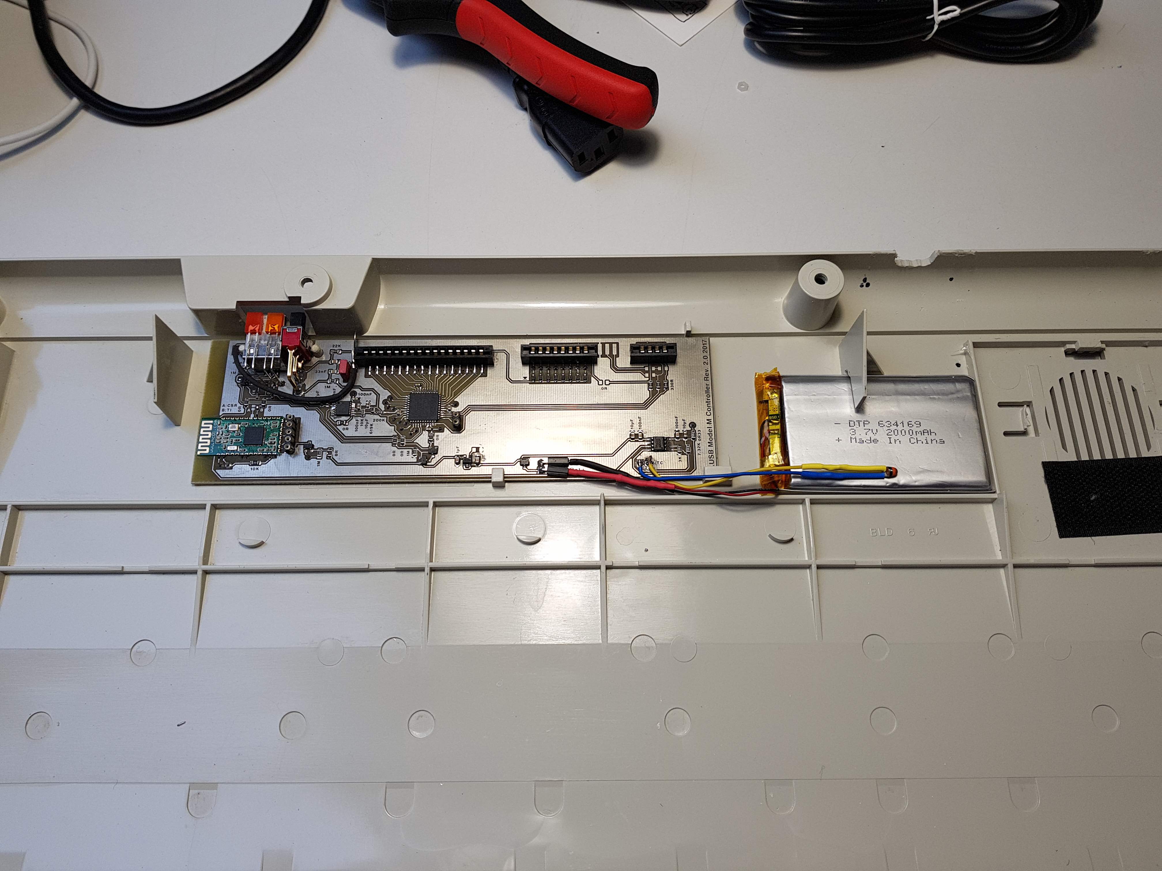

Following you can find two pictures - the first try with the Adafruit components, and Jörn's controller.
First try - only working at low speed
Jörn's version - working under all conditions

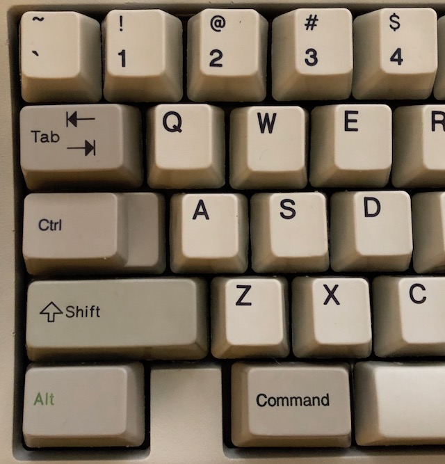

I made some modifications to the keyboard, once I received it. To be clear, it worked out of the box on all of my Macs (MacBook pro 2017 / Mac Pro 2013 / Mac mini 2011 / MacBook Air 2015 / MacBook Early 2016) by plugging it into USB.
The Mac modifications:
1. Modifier Keys
As I mentioned before, I need my modifier keys like I am used to. The Command Key needs to be at the place where you normally find the Alt Key. The Alt Key moves to the place of Control and Control replaces Caps Lock. (I'll explain how I still get Caps Lock a little later).
With Jörn's way to programatically change the position on controller level, I can plug this keyboard now into any device (also Windows) and have this setup for the modifier keys. On Windows the Command becomes a Windows Key.
Obviously I made the same change for the right Command and Alt (swapping places) and getting rid of the right Control key altogether.
2. Function Key and the F-Keys

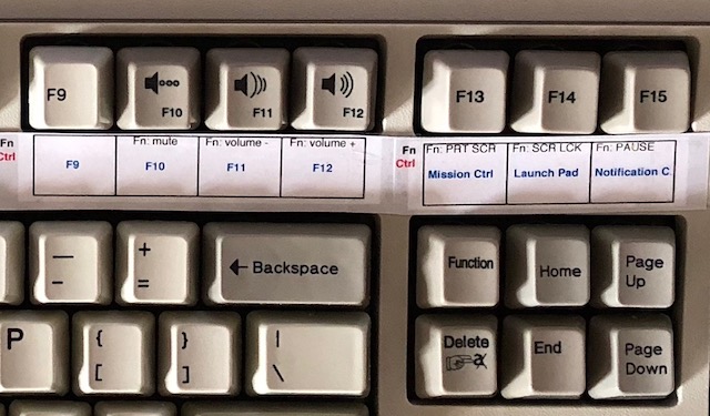

Normally I won't need the good old DOS keys PrintScreen, ScreenLock and Pause, that's why I replaced them in their primary function as F13, F14, F15. Again, the controller can be used to adjust things to all needs I can ever imagine.
As I sometimes still need those "DOS-Keys", I have actually done the next change. I have added a Function-Key, where you normally have the Insert Key (I rarely need it and can be emulated easily). This Function key is basically the second layer of the keyboard (you can have 7 of them). Specifically, Function+F13 becomes PrintScreen again and so forth. Additionally I use the Function-Modifier Key to make CapsLock available again. In my case Function+Control acts like CapsLock. Obviously I have also made "Insert" available as well, by pushing Function+Home.
The picture will make it much clearer as I have adjusted the keycaps accordingly (Unicomp).
The picture does also show the Volume / Mute buttons on F10/F11/F12. Those keys act normally when pushed without modifier. When they are used with Function, they act as those audio keys. And yes, they work in every newer OS without adjustments as it is part of the USB Keyboard standard and all comes from the controller.

darkcruix
27 Jan 2018, 22:45
Hi Michael (mtemmerm),
I have seen your F-Key paper printout (?). Mine is super ugly and I wanted to ask, if yo have a file available that you could share?

I have added extra case holes to the F62 and F77 classic cases that might be useful.

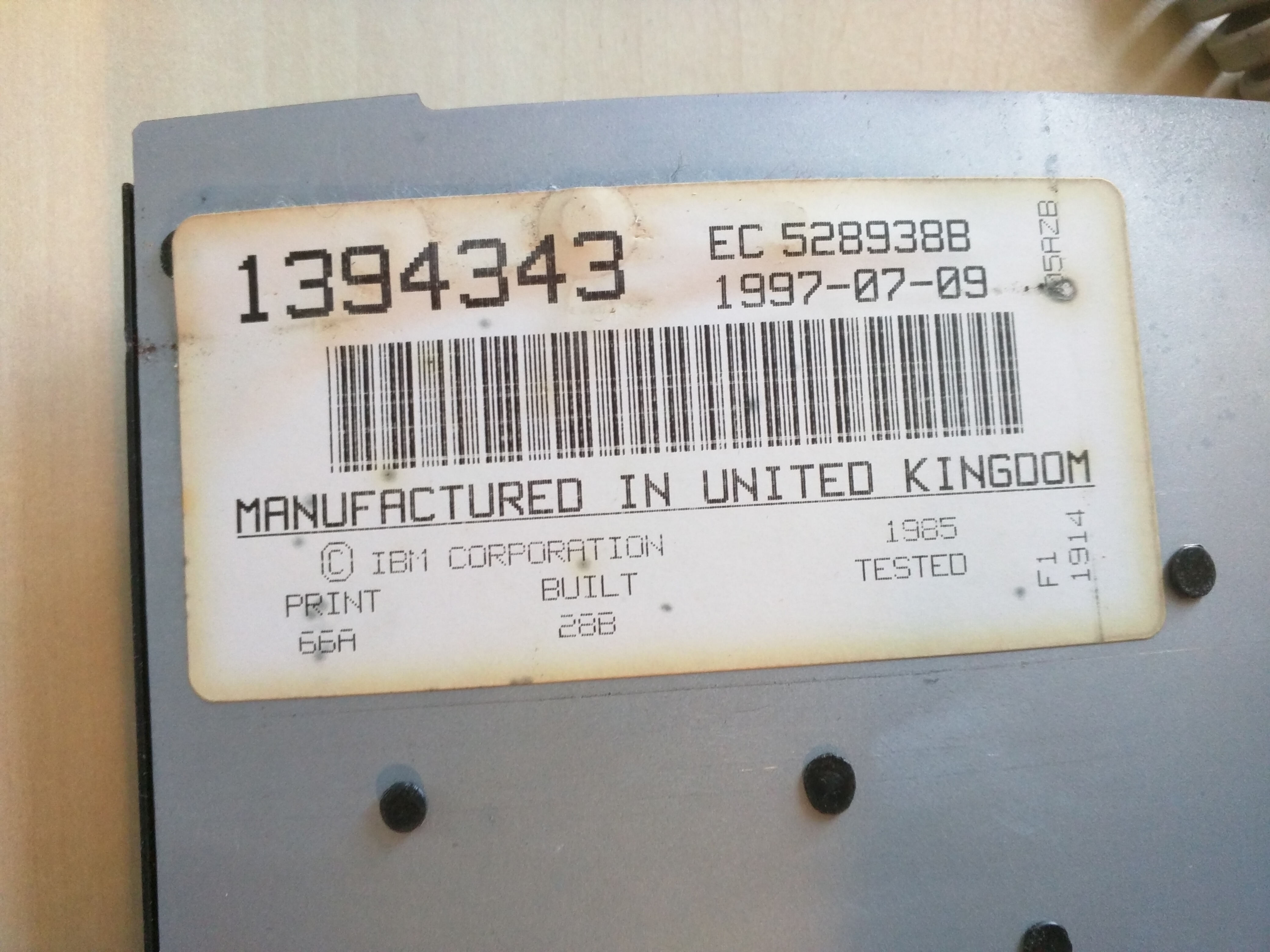

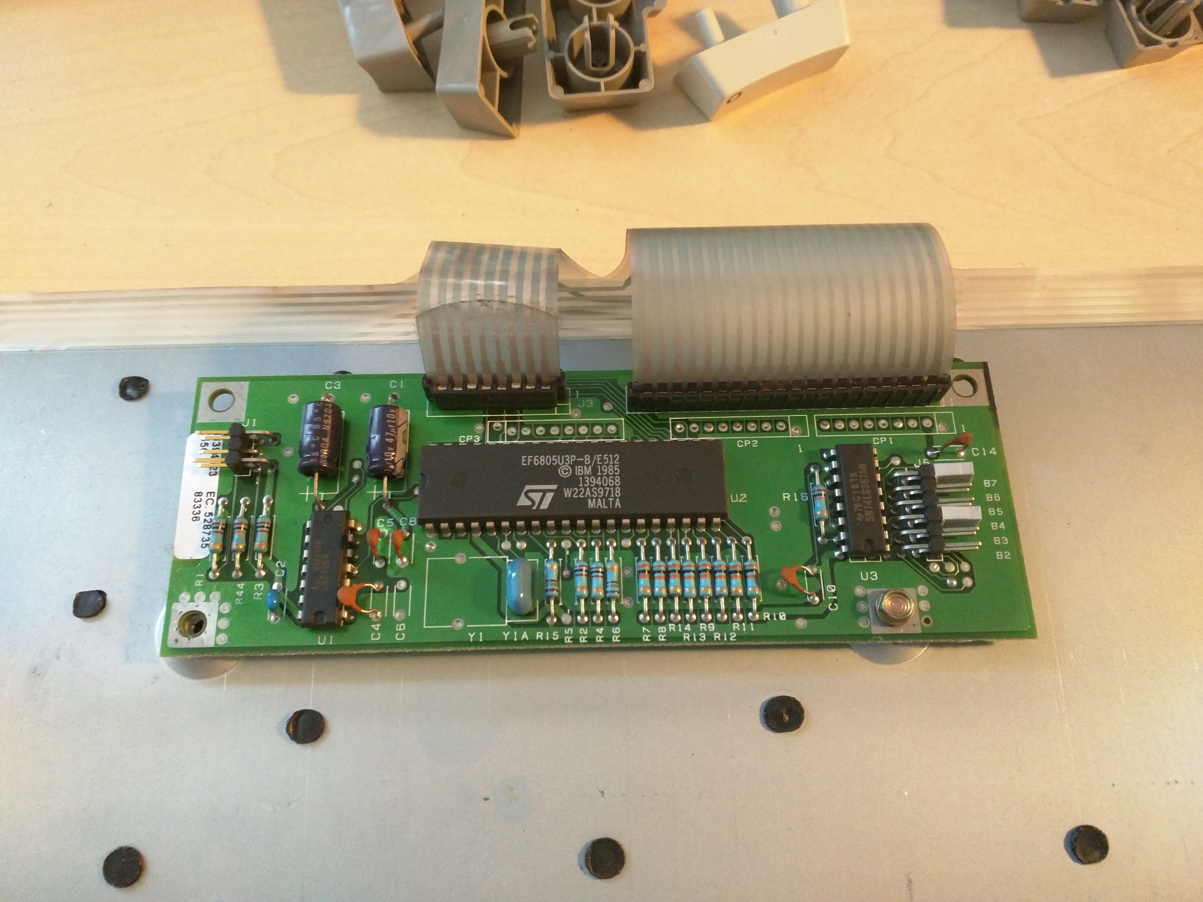

I got a IBM Model M122 (PN: 1394343, date: 09-jul-1997) that I have taken apart for proper cleaning. The keyboard uses a RJ45 connector, which isn't helpful, and I was wondering if your controller is compatible with the keyboard (I don't think it is). I have taken several pictures of the keyboard;
mind_prepared
28 Jan 2018, 19:24
Iggy wrote: I got a IBM Model M122 (PN: 1394343, date: 09-jul-1997) that I have taken apart for proper cleaning. The keyboard uses a RJ45 connector, which isn't helpful, and I was wondering if your controller is compatible with the keyboard (I don't think it is).
I've created a dedicated IC thread for people with a M122 or 4th generation/Unicomp M, here group-buys-f50/bt-usb-hybrid-controller ... 17525.html
Please cast a vote and leave a message so that I can add you to the list of people interested in a replacement controller for the M122.
I've already come up with an idea how to free four additional MCU pins to accomodate the M122's 20x8 matrix, I'll post my idea on the M122 thread sometime in the near future.

Hi,
I wanted to share an idea I had in regards of indicating which layer I am in when toggling through them. It is kind of a feature request, but I know this is very unique to me. I had two different ideas, I wanted to share.
So, I wonder if there is any demand for this, or is it just something I find very appealing?
Idea 1: Indicate the Layer number using the LEDs
First of all: this option would render the LEDs under Num-Lock, Caps-Lock, Scroll-Lock somewhat useless in their intended function. What it would do is to indicate only the layer 1 to 3 using the LEDs as shown in the picture below:
Direct layer indication 1-3.png (195.22 KiB) Viewed 33851 times
Idea 2: Indicate that your aren't in the base layer using the LEDs
This idea would keep the functionality of the LEDs and just adds a display that you're not in the base layer. The display would happen by slowly making the LEDs softer and brighter (breathing). When switching back to the base layer, the normal functionality would be back

Update: I've revised the PCB layout further and will shortly start making new one-size-fits-all kits supporting the SSK, M101/102 and M122.
