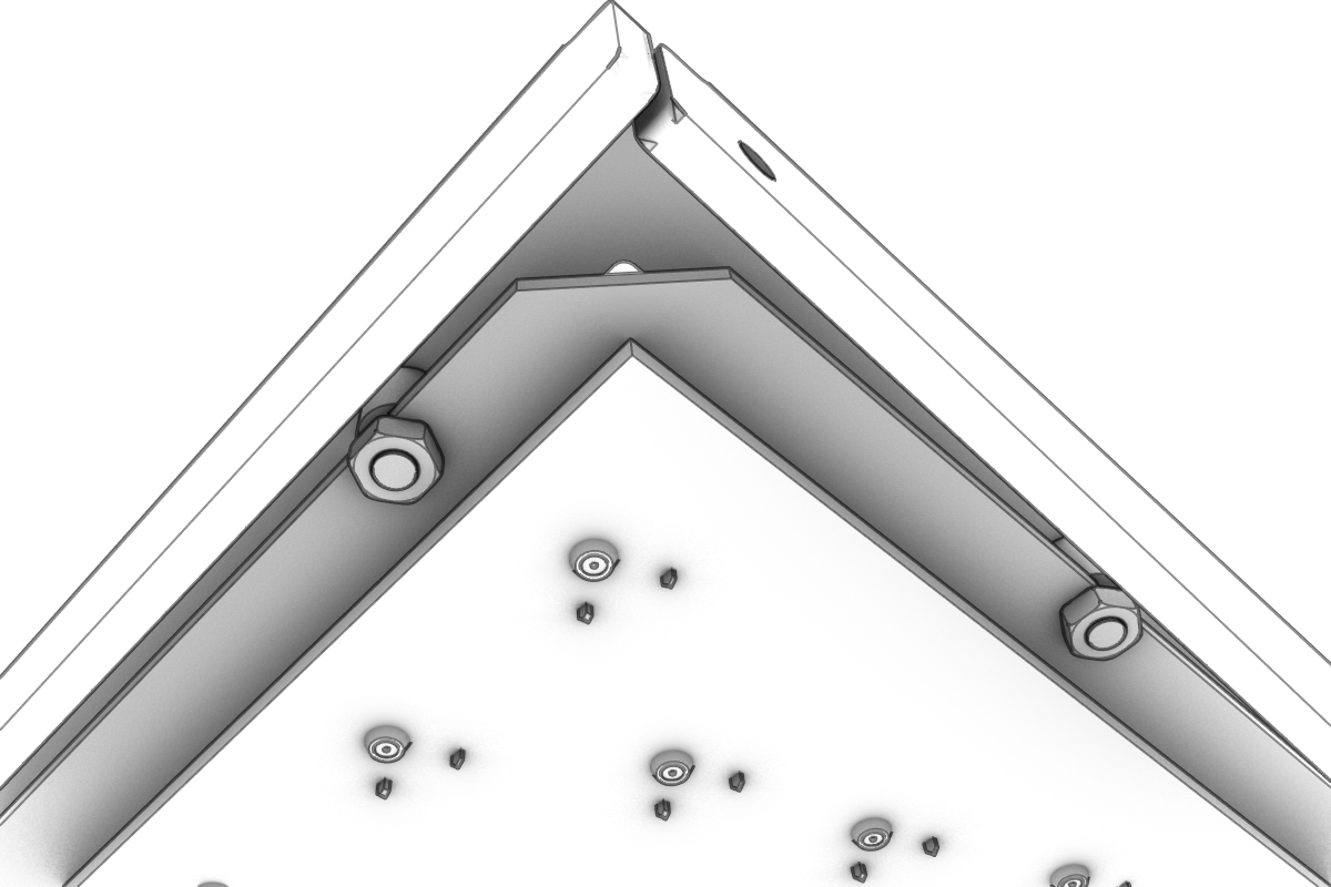

ok, you mean countersunk vs flathead or how the screws fasten the plate?
I guess you mean the last one. sorry I wasn't really aware, that it is not clear. probably I take this for granted too much.
later this day I'll just share some screengrabs from the cad app here.

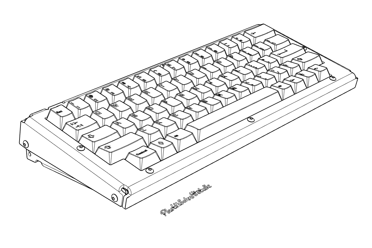

Wodan
ISO Advocate
22 Nov 2017, 16:34
PlastikSchnittstelle wrote: PCB mount?
maybe I'm missing something here, but I don't think PCB mount will be possible?
Damn man you really know how to trigger me.
Very nice drawing, you're really gifted. Can't wait for this to proceed.
22 Nov 2017, 18:26
Thank you very much :)
But let me clarify something regarding the style of this drawing.
It is kind of a standard or at least very popular style used in product design (maybe in architecture as well). It is mostly used in earlier concept phase of the design process. a few years back the standard procedure was to export the model from CAD and into illustrator and there deal with the line weights. today that's easier, this is more or less just a screengrab directly from CAD using a slightly modified display mode.
so long story short: this is not a very special style I came up with, it's a pretty standard type of visualization used in product design.

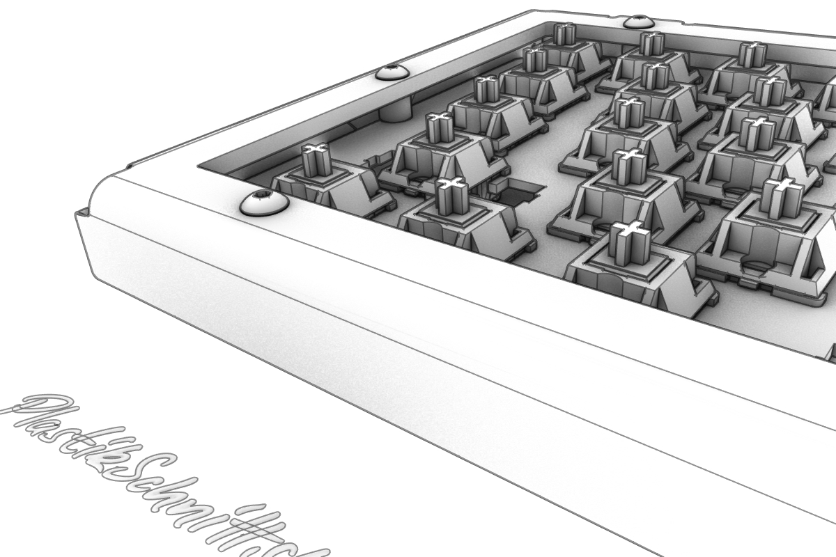

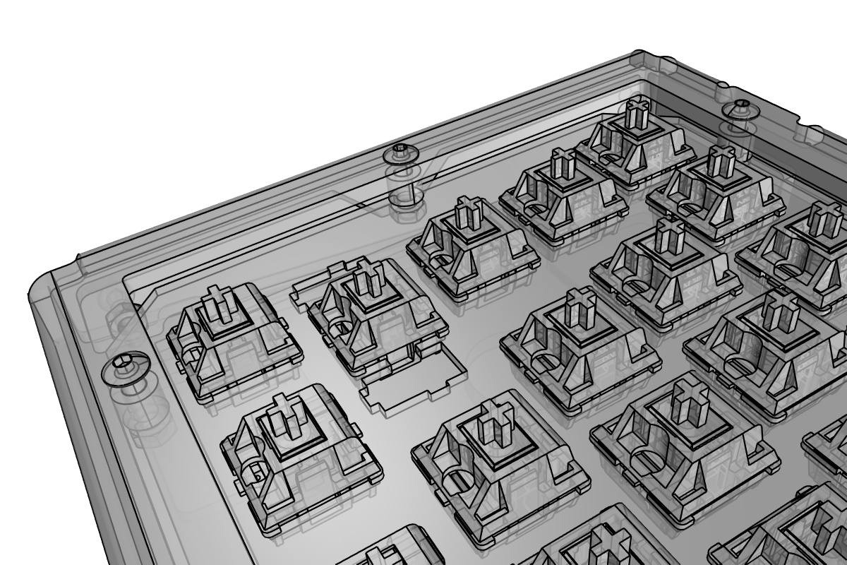

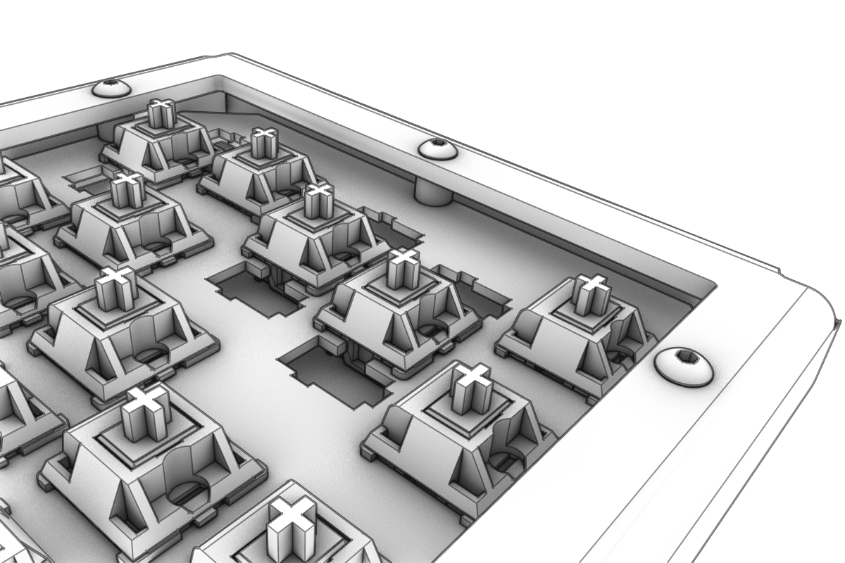

ideus wrote: The screw-affair could be easily settled by sharing some renders of the two options.
so here are some detailed views, hope they help to understand:

That's a pretty clever design! Would like to see countersunk screws or some very low profile ones though (like these: https://uk.misumi-ec.com/vona2/detail/110302280540/ ).
22 Nov 2017, 19:31
Haven't made a decision jet but probably going back to countersunk screws like seen in the initial renderings.
pomk wrote: That's a pretty clever design! Would like to see countersunk screws or some very low profile ones though (like these: https://uk.misumi-ec.com/vona2/detail/110302280540/ ).
WAIT, those "ultra low head" screws look really interesting - thank you very much for that link.
seriously considering that.
22 Nov 2017, 22:54
since wodan likes the drawing style so much, here is one more:
Myoth
22 Nov 2017, 22:59
PlastikSchnittstelle wrote: since wodan likes the drawing style so much, here is one more:
Wodan won't like it ... it's not ISO !! HERESY !!
