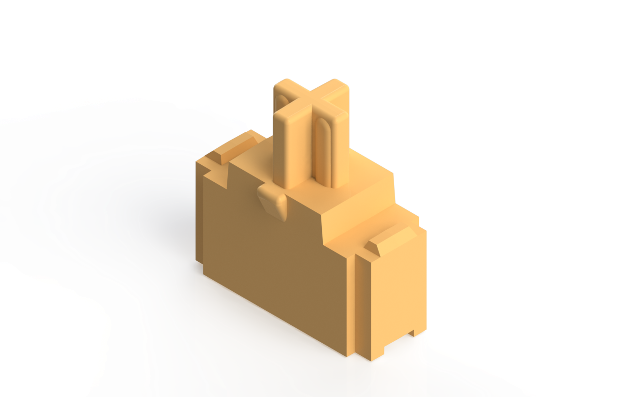

Update:
Here is the new proposed model change to support clicky switches, the little bump was added. Height is identical to the original, "short" design, and will not increase height of the caps at all. The addition is to prevent the click leaf from being able to catch under the keycap stem lip, and this makes it literally impossible for that to happen. Only downside is it will reduce the travel of the click leaf by 0.6mm, and may affect the point at which the click leaf actuates, can't say for sure if that will actually happen but it could. Now this isn't my favorite idea, but it is the last possible choice unless it is decided to not support clicky switches.

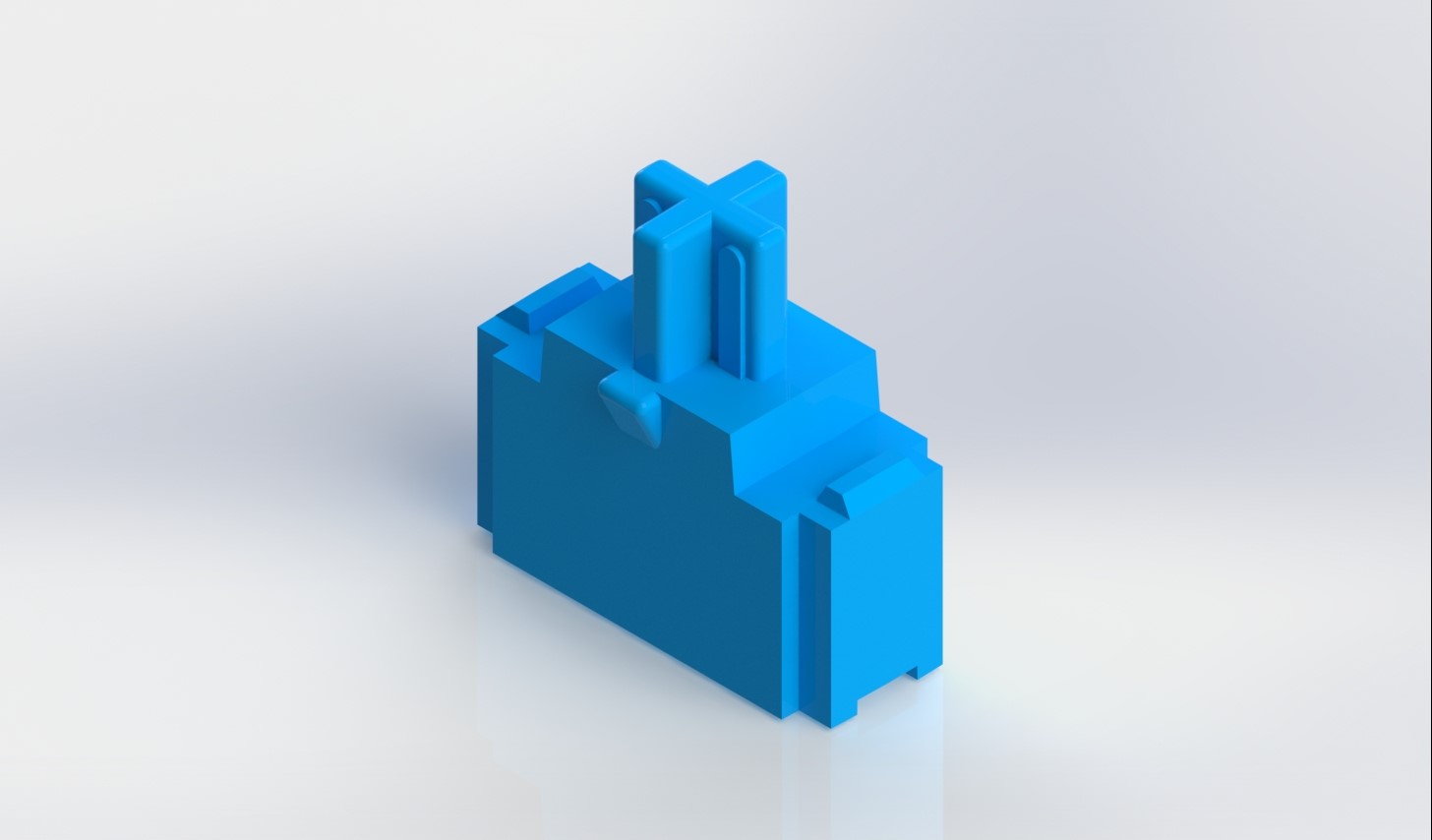

This is the color I have decided on, I wanted something that is different and not commonly used among the ton of switches out there today.
