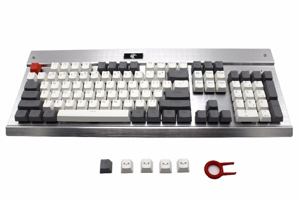

Blaise170
ALPS キーボード
28 Mar 2018, 17:36
Just got a backlit PBT set of Korean keycaps... Definitely hard to find anywhere else.

Blaise170 wrote: Just got a backlit PBT set of Korean keycaps... Definitely hard to find anywhere else.
I found these and didn't even know these colors existed in shine through.
Should look good on my wireless Plum.
Blaise170
ALPS キーボード
28 Mar 2018, 20:40
Yeah I saw that set too. Amazingly, the font doesn't have that atrocious gamer-esque theme that it seems like every keyboard from China has. This one:
Luna
Alt255
28 Mar 2018, 20:52
Yeah, luckily.
They probably won’t be the greatest caps ever for $25 but I like the color, they’re PBT and I wanted shine-through for the wireless Plum. Will be used mostly in front of the big screen or with an iPad when I’m sitting in the couch.
Laser
emacs -nw
28 Mar 2018, 21:29
Aren't the default, stock keycaps made from thick PBT and shine-through? (I don't know, just asking)
Luna
Alt255
28 Mar 2018, 22:19
PBT, white-beige with light gray mods but not shine-through.
Laser
emacs -nw
28 Mar 2018, 23:13
Aha, pity then :)
