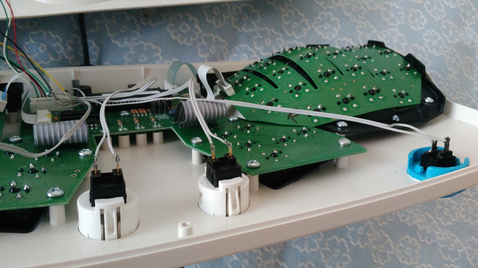

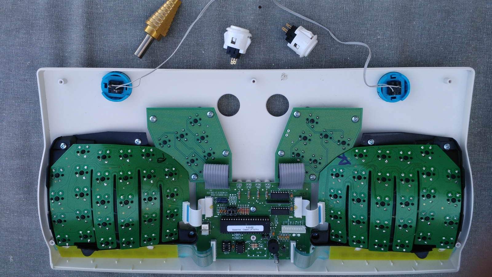

bjarven
20 Jan 2013, 22:59
Done! It was quite easy with a stepped drill bit.
Unfortunateny I don't have a soldering iron (yet, it's in the mail...) so the cables connecting the buttons were just taped on. They worked for a while but I think they've fallen off now that I've moved the keyboard. So now they're just sitting there looking pretty...

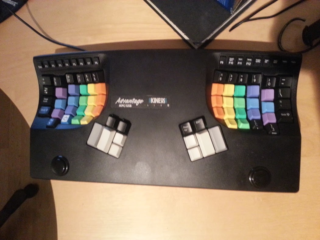

bjarven
28 Jan 2013, 13:27
sordna wrote:bjarven, congratulations on a fine looking keyboard!
Very happy to see you did the mod, you even put the buttons in a better position than I did!
Thanks! I took your advice on the placement, and put them a little bit further away from the thumb clusters. Today is actually the first day that I have them wired up, so I'll have to wait some more time before getting used to them. But so far they behave very promising! :)
I'm using them for AltGr at the moment, and I have å,ä,ö¸{}, [], () on the AltGr layer. Microsoft Keyboard Layout Creator 1.4 (phew long name) is very useful for creating easily redistributable layouts. As long as you stay on windows I guess...

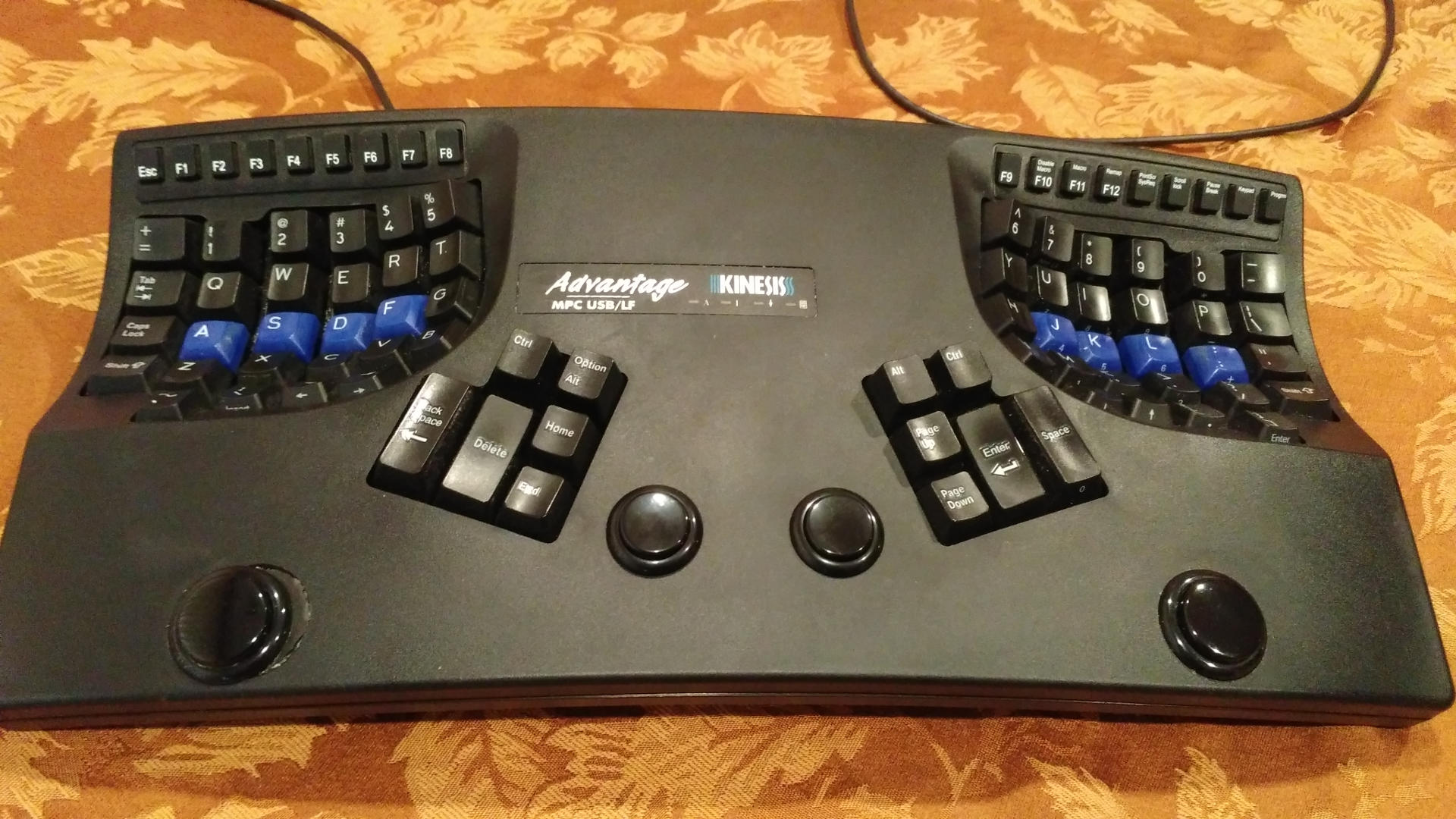

18 Jun 2016, 05:14

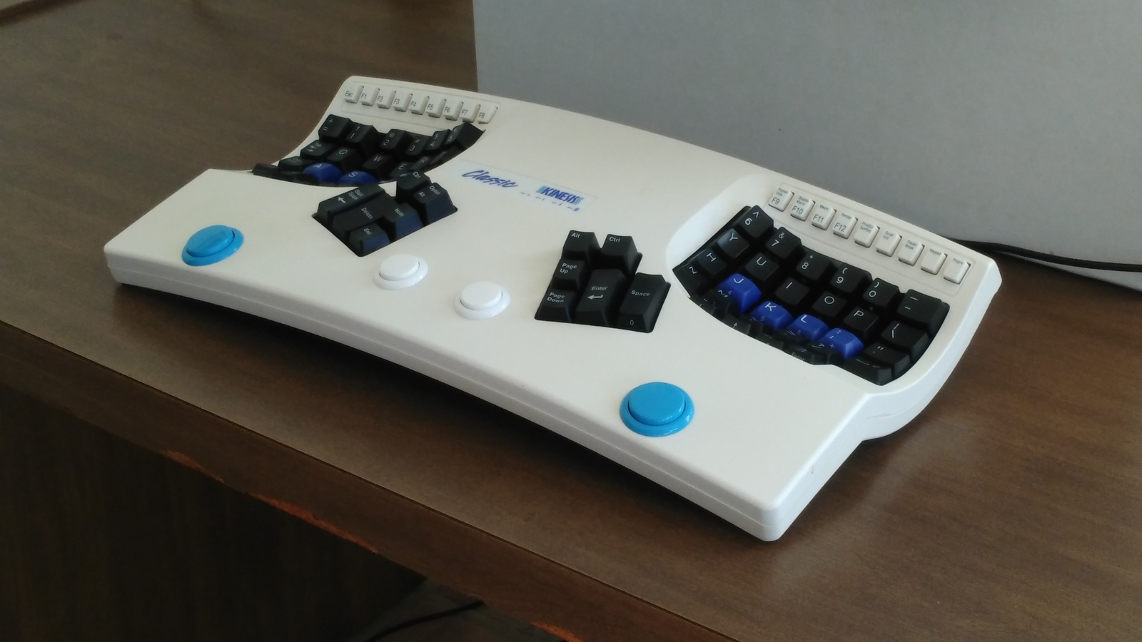

Added couple more arcade buttons to my work keyboard today

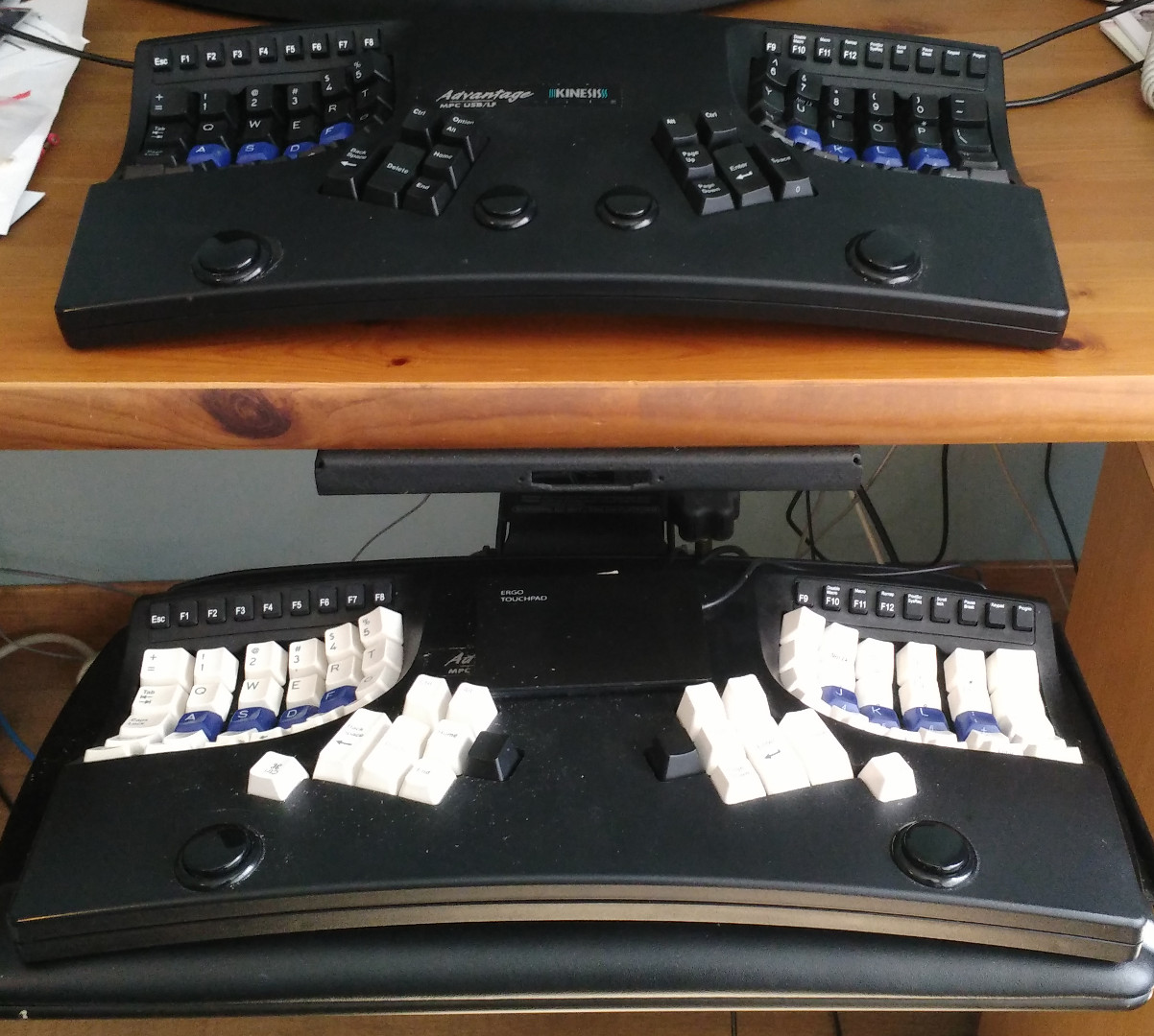

sordna
21 Jun 2016, 08:49
My 2 LFs together for comparison.

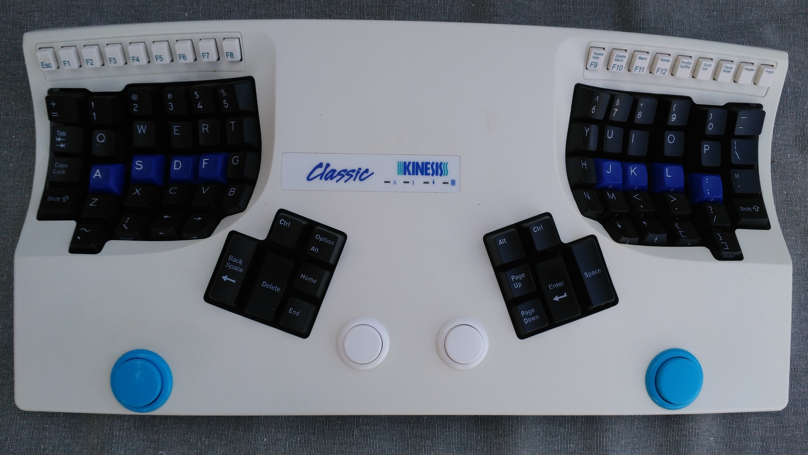

sordna
22 Aug 2016, 17:13
Did the 4-arcade button mod on my PS/2 Classic too. For the buttons near the middle of the keyboard I used Sanwa OBSF-24. They are smaller in diameter but quite a bit deeper in the case than the Seimitsu PS-15, but thankfully the case at the point I placed them has much more room than the spot where I drilled for the palm buttons.
By the way has anyone used these buttons: http://www.gamerfinger.com/hbfs30.html which take cherry switches inside? These HBFS-30 look cool and seem to be very low profile inside the case.

me n my unmodified* kinesis advantage are turning green with envy. :mrgreen:
* setting a numpad in the gap in the middle doesnt count as modifying, right? :roll:

I still dont get where I should attach the arcade buttons too..
Will have to look more into it. Also:How did you guys made the QMK mod??
(I know this thread is old)
martink
17 Jul 2017, 08:04
From the Geekhack link, the buttons attach to where the 3 footswitches are connected internally. Looks like the left/right button pairs are mapped to one footswitch each, so you could add up to six buttons.
