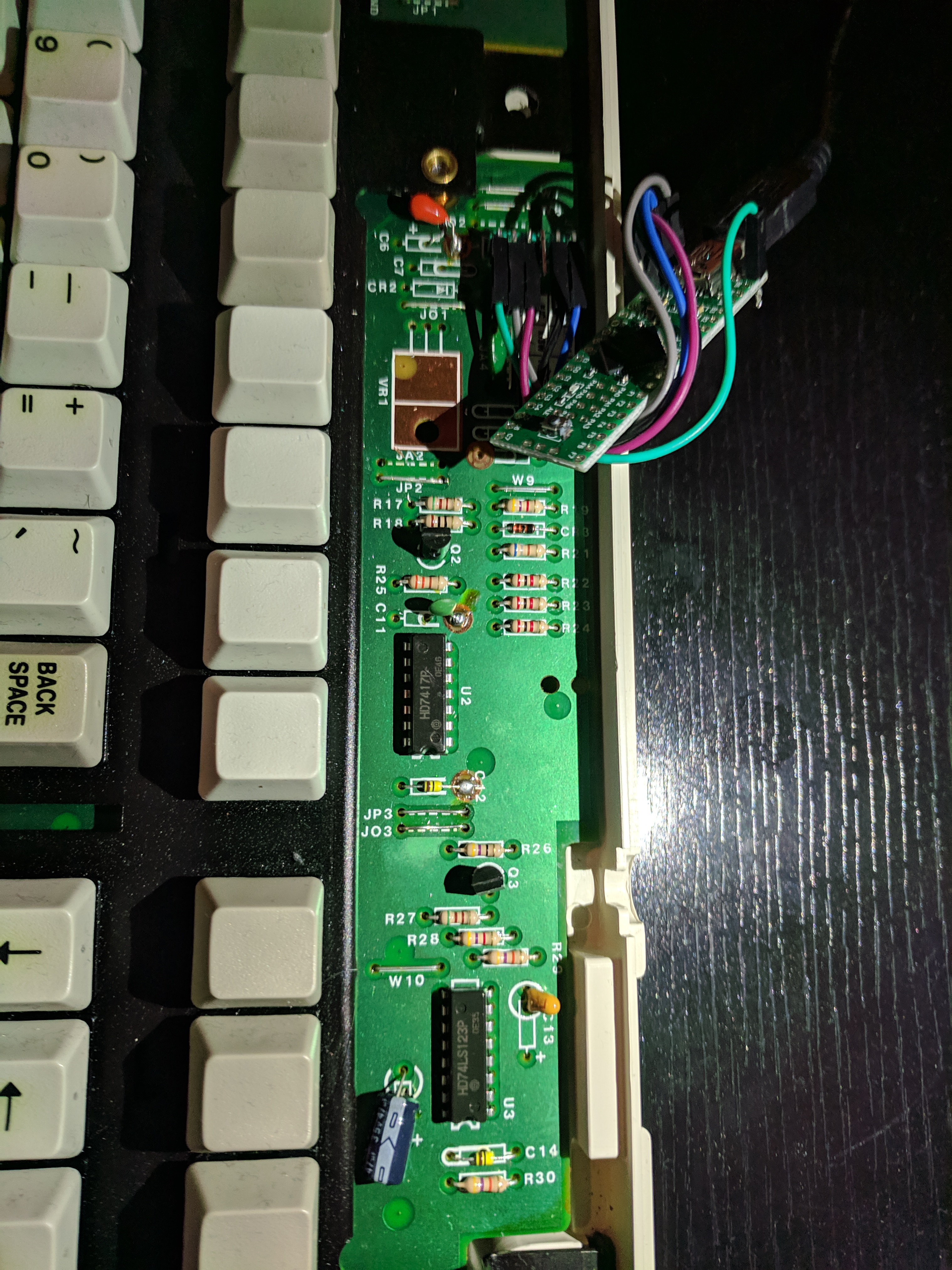

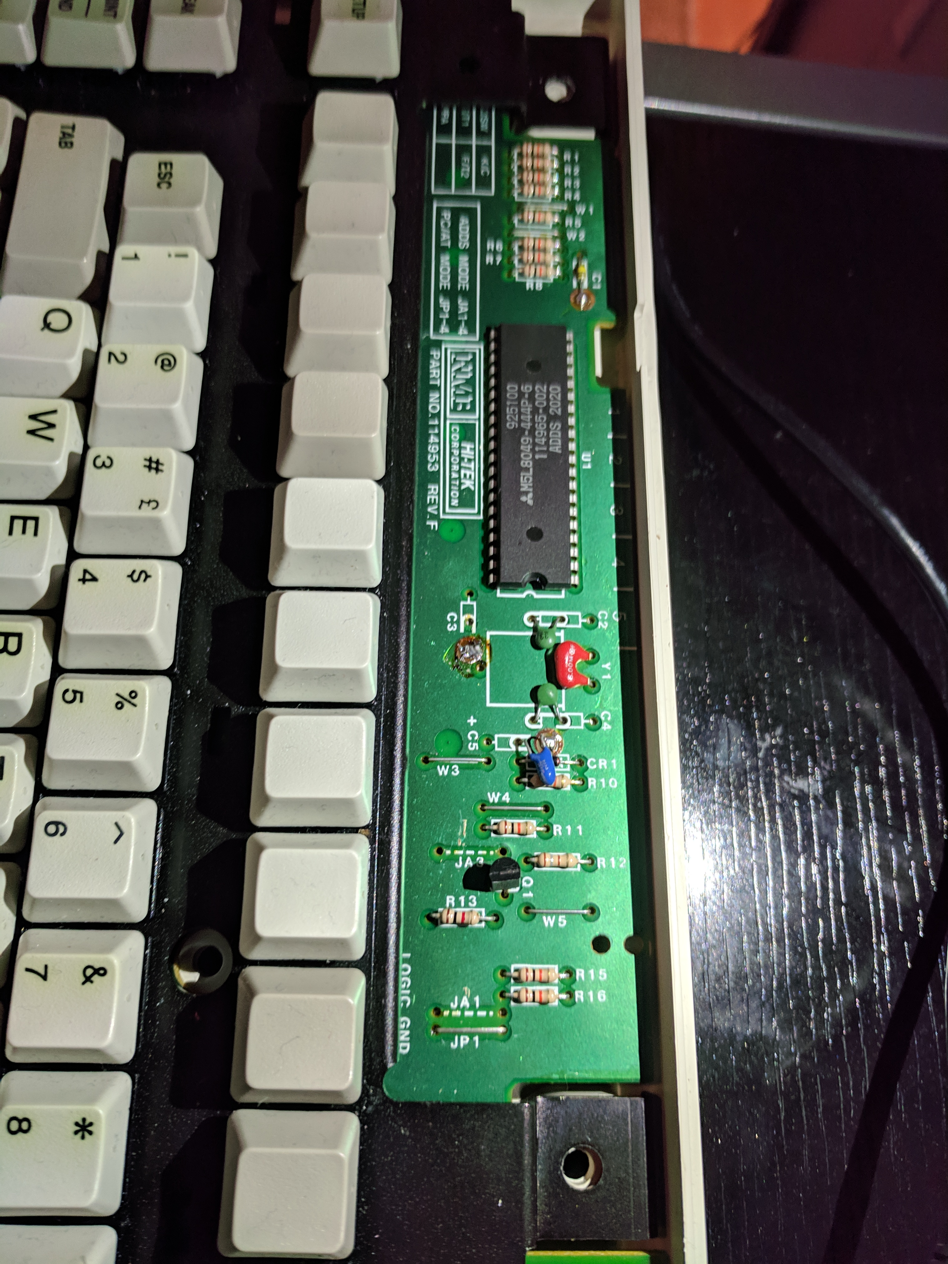

I have an update on this board and the information about the jumpers and the voltage regulator. I thought that this board looked familiar and that it was a board that was rebranded for a bunch of other companies that would be using them for their terminals. Well it turned out I was right when I recently purchased an ADDS ASCII and it had all of the jumpers already in place. Now mine didn't come with the voltage regulator so it just take the 5 volts.
Jumpers:
Here is a picture of the jumpers that came on my ADDS ACSII
I also have a NMB PC 122 with a voltage regulator and this board according to others on the forum needs more than the regular 5 volts. These NMB/Hi-Tek boards needs 9 volts because they are meant for a terminal that would be able to supply it.
Going to be using a teensy to convert this rather than use the cable that came with it because it was not in the greatest condition. Will be reporting back once I have the converter done and or issue/other information that I find.

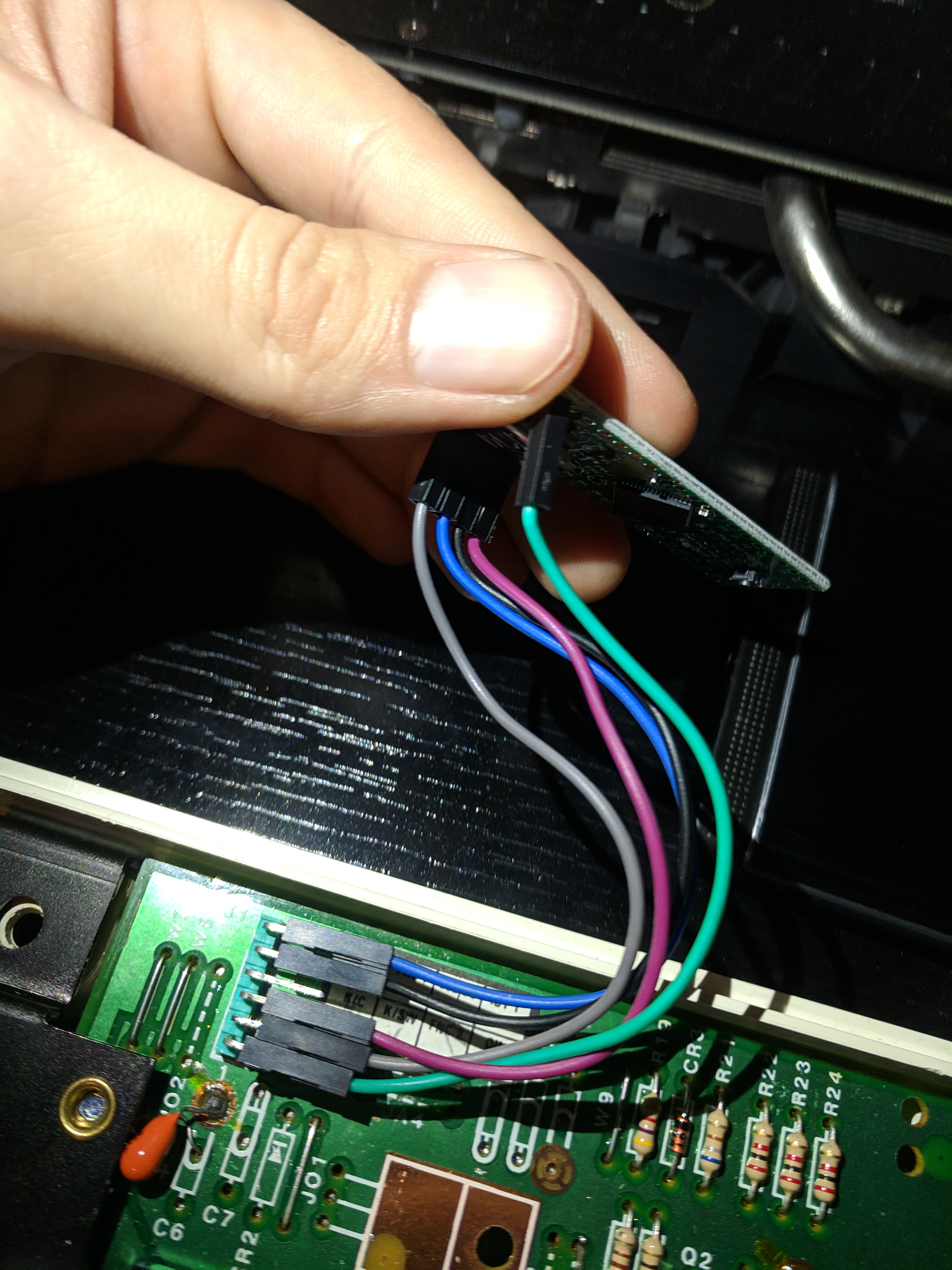

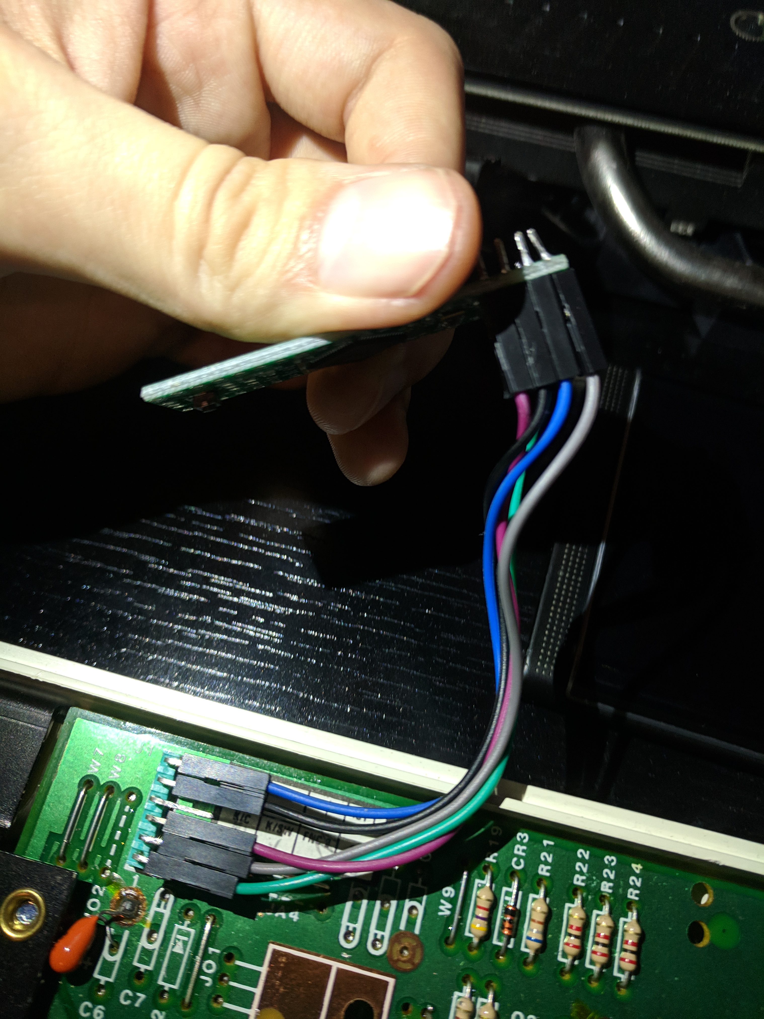

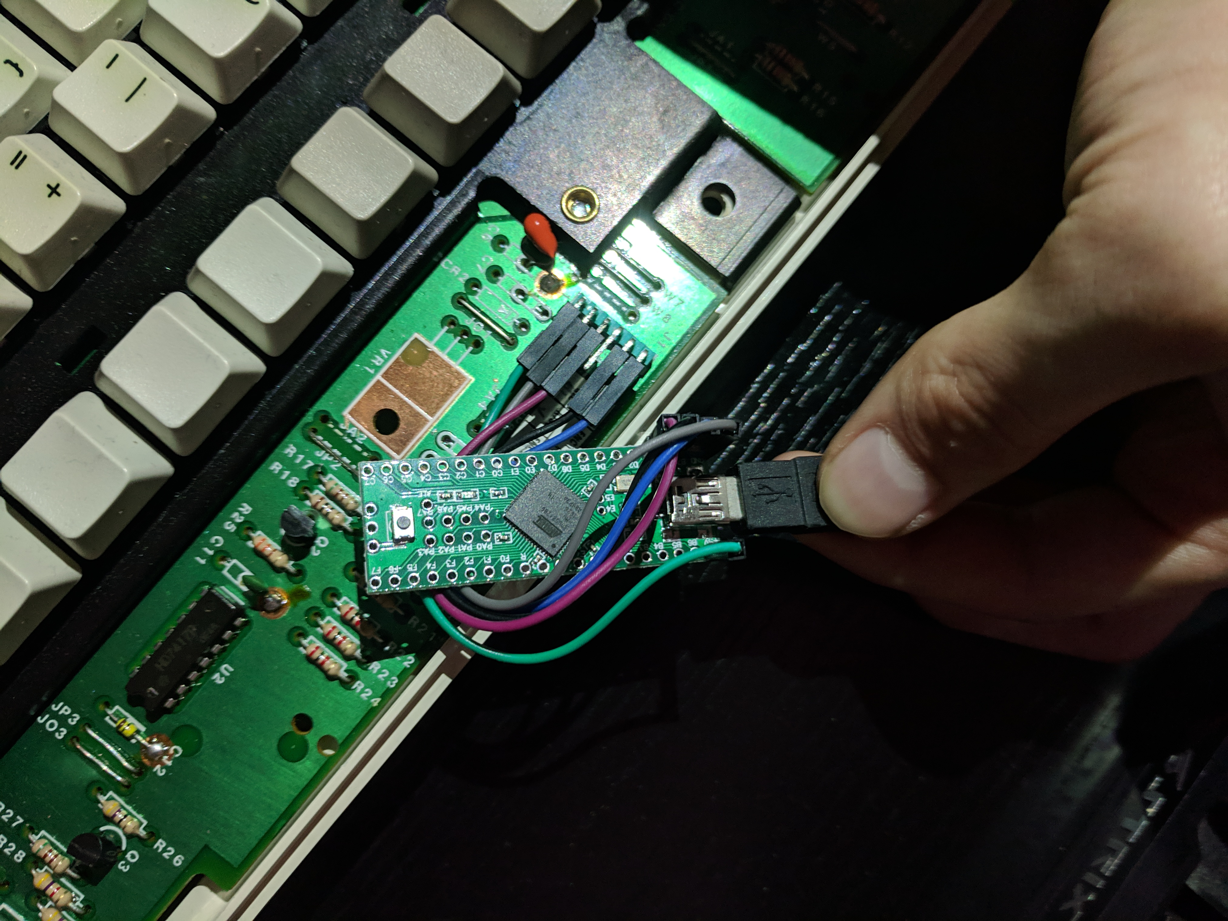

Update here is the pinout for converting it after the jumper wires have been put in.
This is based on the at rj11 conncector that came with my board. For a better understanding have a look at the picture of when it is connected to a teensy.
Top
6 = reset - red
5 = data - green
4 = case gnd - black shielded
3 = clock - yellow
2 = sg gnd - black shielded
1 = vcc +5v - white
Bottom
Top is the original cable and the bottom is the teensy cables:
Top
6 = reset - red
5 = data - green
3 = clock - yellow
1 = vcc +5v - white
Bottom

There is 2 options I think:
Here is something that another user said to use to get the correct voltage. This should bump the voltage to 9v but I would check to see how much is going to the controller before doing anything.
https://www.pololu.com/product/2116
Or you could remove the voltage regulator and see if it works with the normal 5v but there is a bit of difference in the components used between your board and mine. You would have to find all of the missing components that are different to make it work.

hackser
- Location: Switzerland
- Main keyboard: NCR 4950 once I replace the teensy
- Main mouse: Logitech
- Favorite switch: Hi-Tek Series 725 linear (white)
Okay after trying a few things out the mod worked for me. just change out all the jumpers. I had a pcb version with no voltage regulators. My cable looked like a phone cable with 4 conductors and had different color order than consideringquiet's cable. But after the AT conversion, TheInverseKey's pinout worked.
