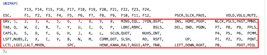

My understanding, which is only superficial, is that the unimap "grid" is bigger than the physical keyboard because it's built to support (at least) 2 keyboards with different physical layouts. So each keyboard, either the 4704 or our pingmasters, uses a different subset of the unimap.
The important thing, though, is that out of the box, the default unimap layout *works*, and when you make big changes to it, then it *doesn't work*.
So, start by making a tiny change. Then flash it and see if it works. If so, make a bigger change. The point where it stops working is the point where your mental model of what's happening has become inaccurate -- a learning opportunity.
kaboom36 wrote: why doesn't the initial keymap match the keyboard???
I believe the initial keymap matches the keyboard pretty well if you look at it as a subset:
Screenshot at Sep 17 13-56-33.png (50.91 KiB) Viewed 3437 times
There are some exceptions, like the keys at the right side of the alpha block actually sending the codes for F1-F4. This is where reading unimap_trans.h should be helpful.
