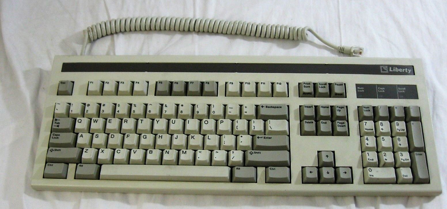

Just finished sprucing up these two for engicoder. I thought they looked particularly nice.
Engicoder
12 Nov 2018, 04:30
snacksthecat wrote: Thanks for posting the video! I love the thockiness of these boards.
Thank you, snacks! I am really looking forward to these two. I will be able to reunite "The Patriot" with his as yet un-named 101 key Liberty big brother.

Is the other Patriot board still available? I'd be interested in it if it is!
snacksthecat
13 Nov 2018, 17:03
milwaukeebs wrote: Is the other Patriot board still available? I'd be interested in it if it is!
Yes! Thank you for the reminder, and sorry for not getting back to you sooner on reddit.
I have one more of the Patriot boards. This one does not have the little plastic insert with the Liberty logo. I'll get to work cleaning it up and replacing the controller like I've done with the other boards.
