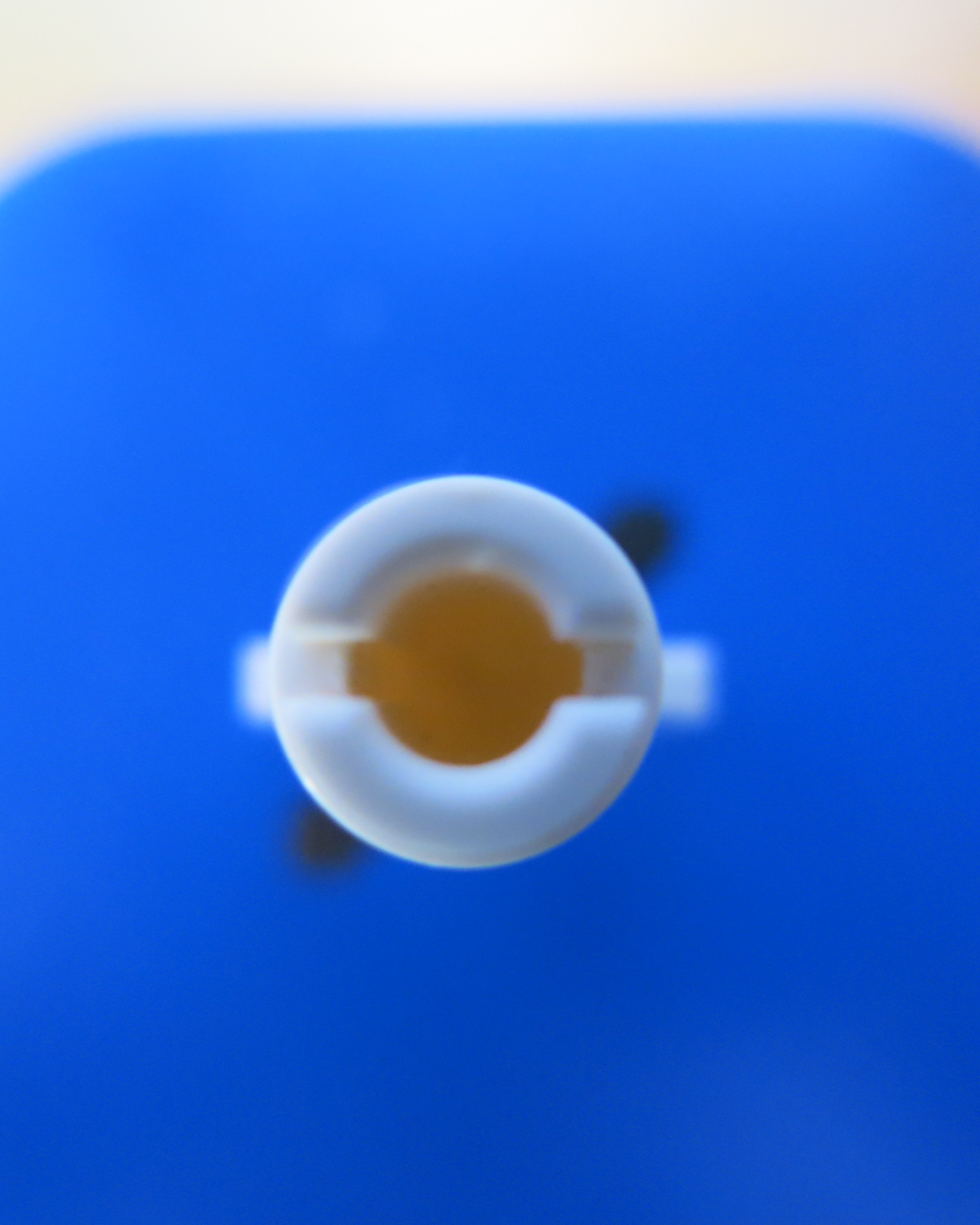

Mostly I need the inside diameter of white part, the rest I can work around.
w/images/2/22/Beamspring-top.jpeg
Can you take a picture of the white part with the metal insert not in there as well? If possible get the picture from a top view so I can get a better sense of the profile in there.

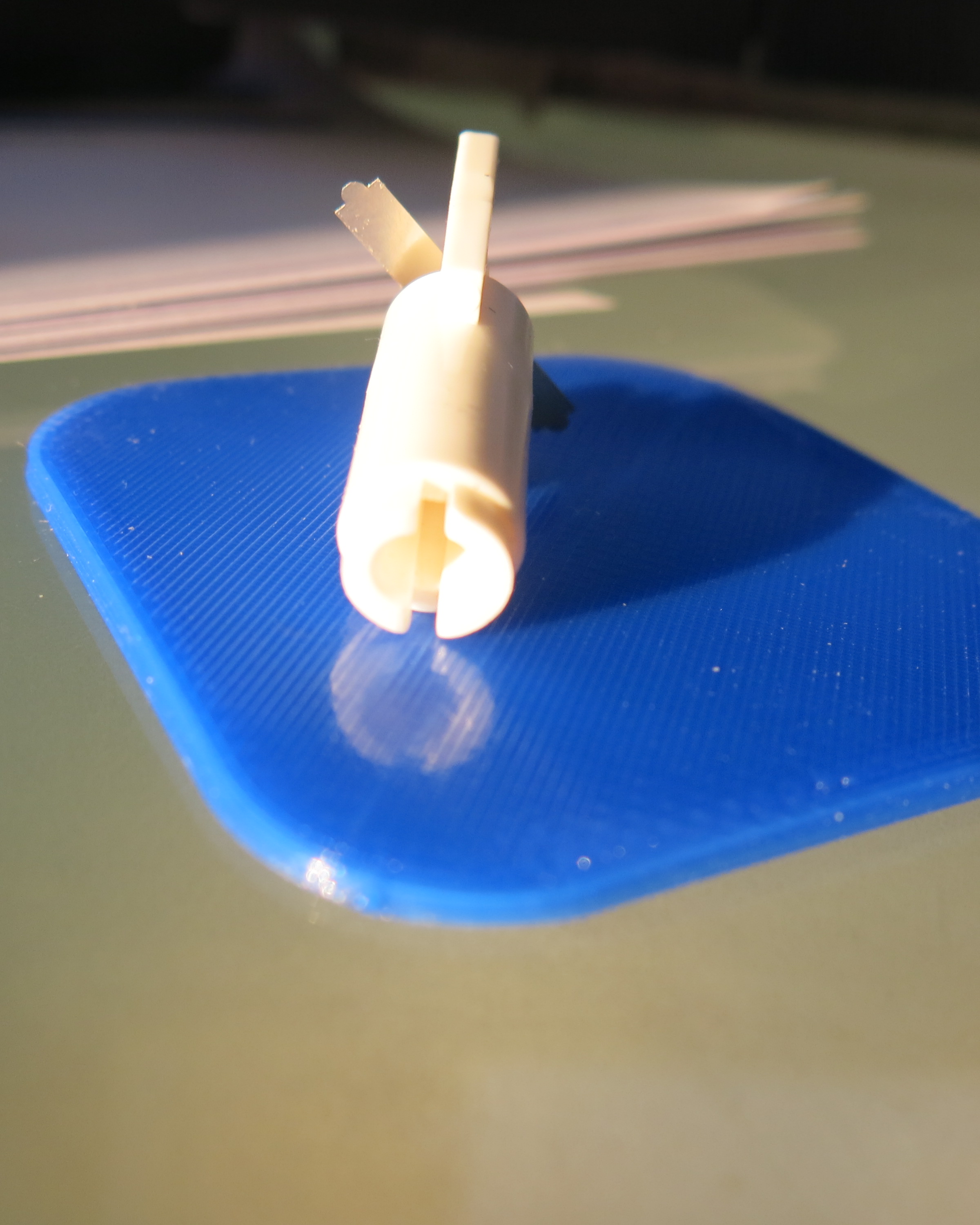

The diameter of the slider barrel is 4 mm. The groove adds another mm - so the diameter is exactly 5mm when measured from groove to groove.
I did my best to get a focus inside the white slider. The last one on the pictures below is showing the "rail" where the mount insert is sliding in. The first one is showing it directly from the top:

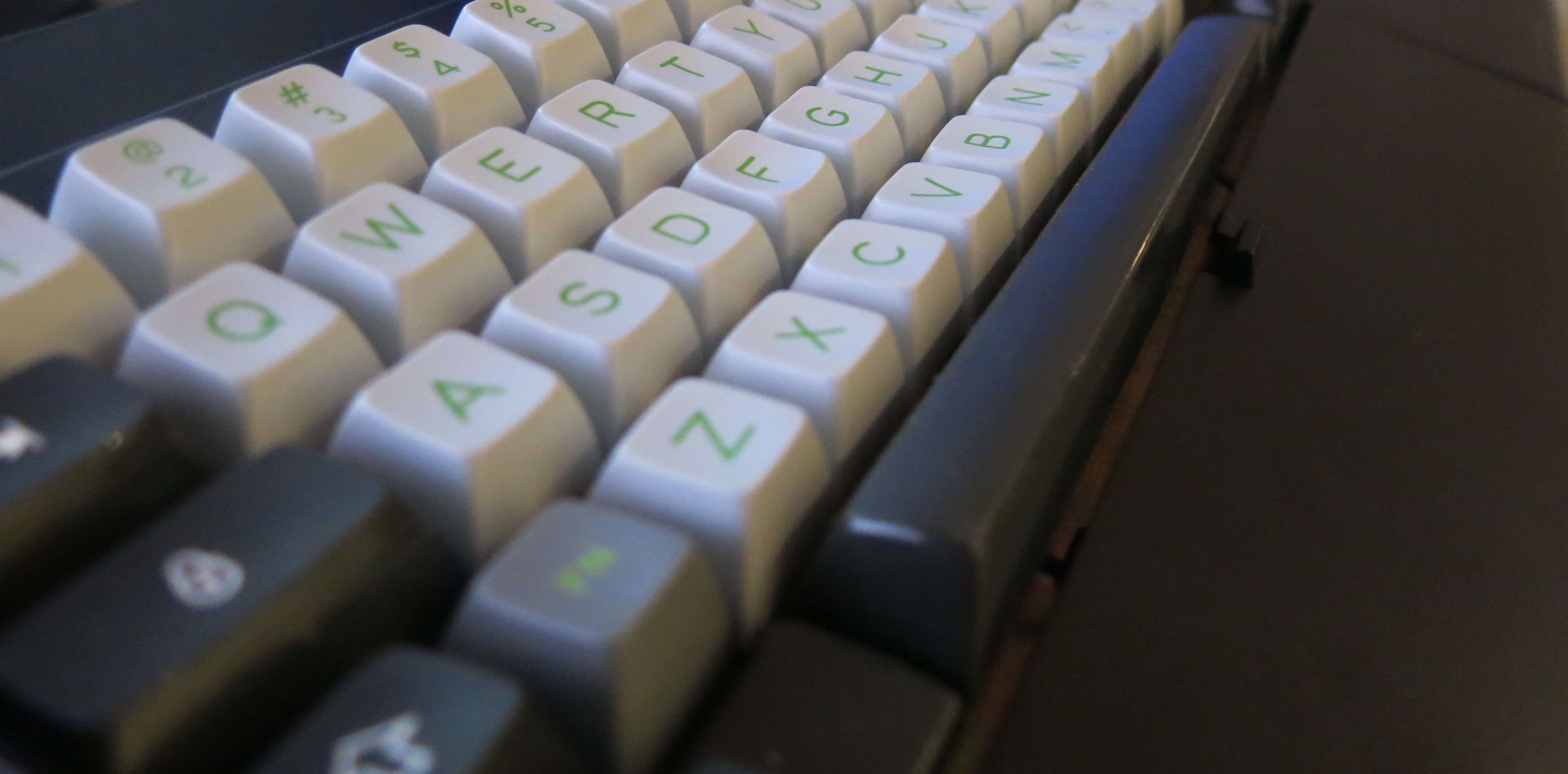

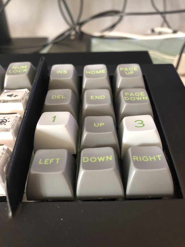

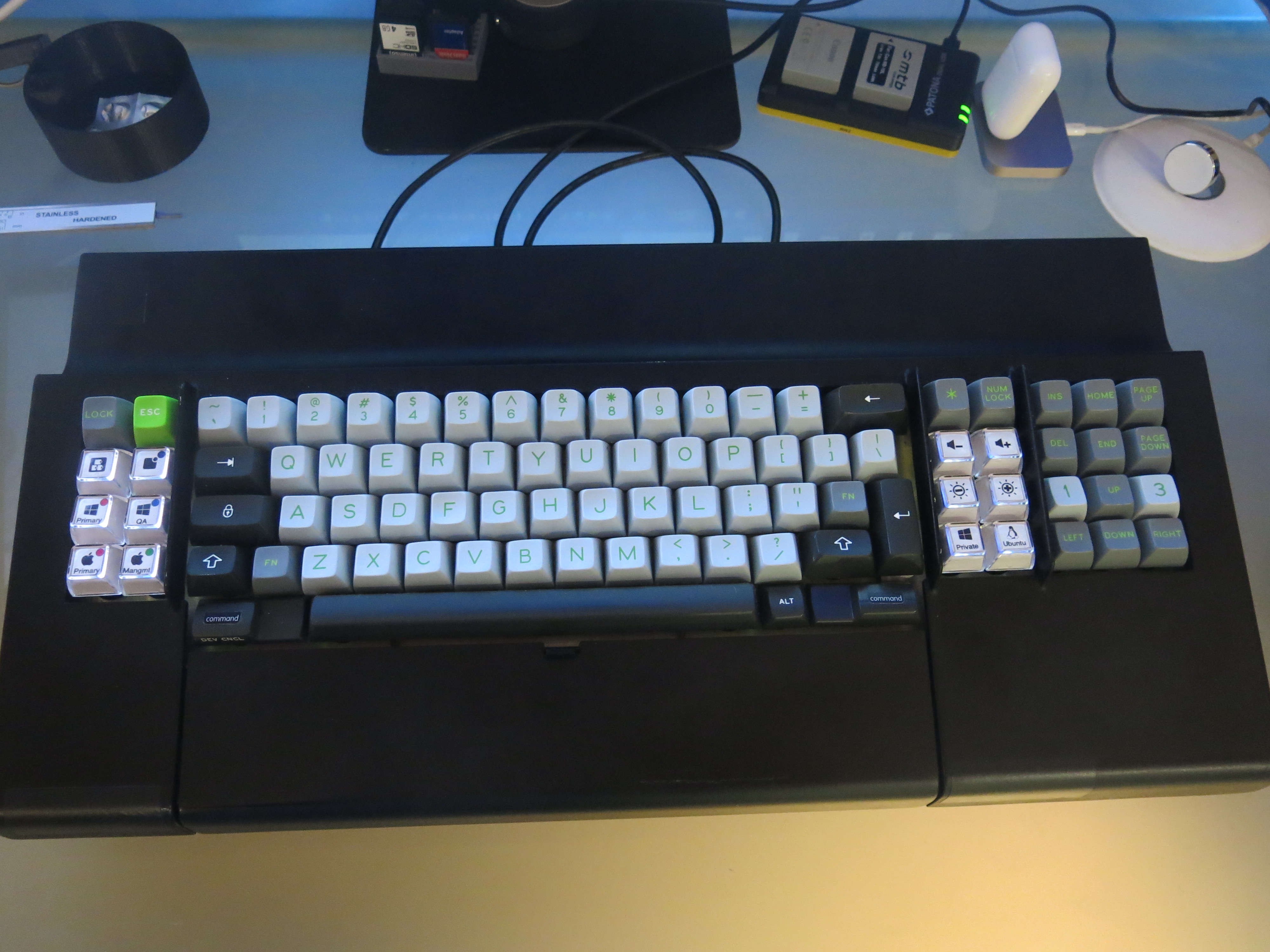

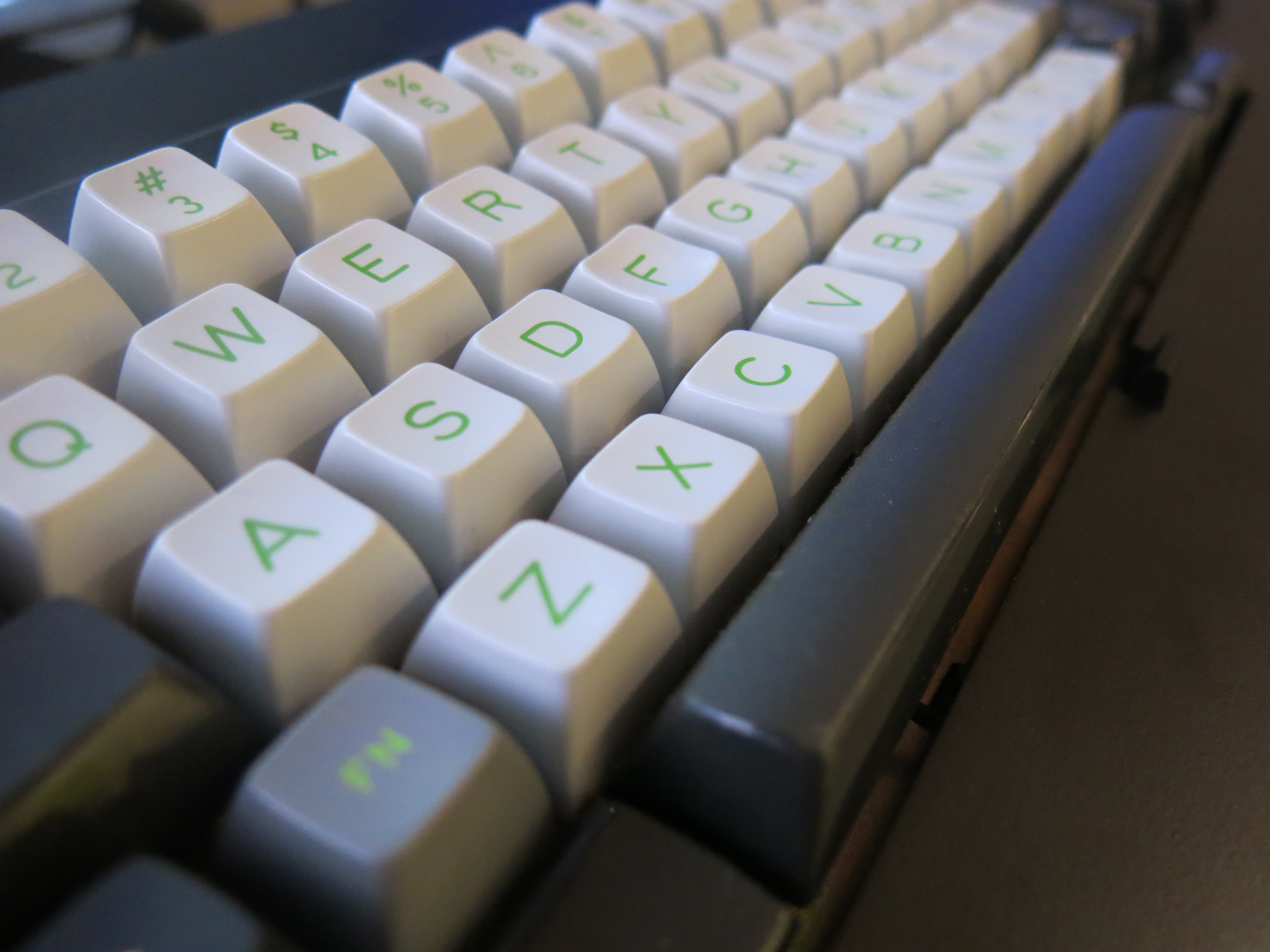

Just in case someone is interested, I have installed a full Cherry MX mount keyset on my BeamSpring (3278), with a few exceptions (I did keep the modifier keys due to some size issues).

By the way the pictures of the barrel are perfect. I thought that was how they were setup, but wanted to make sure I wasnt missing something.

The printout did work perfectly and the MX cap did fit also without issues.
A few things I wanted to share:
- The overall height of the mount makes it to be above the other keys. Something that is probably hard to change, but here's how it looks:
- The stem isn't sitting tight in the slider, so it has to be a bit wider or the "ears" have to be made thicker, so it is a bit jammed into the slider. The original metal stems are sitting super tight.
BUT:
- The keys don't wobble at all anymore with this design (WOW)
- The sound is 100% the same as with metal stems - same hard feeling
- The mount is super easy to print out and very rigid
Very well done !!!!

On the barrel fit issue, I undersized the stem going into the barrel to ensure it would fit, but apparently too much, that is easily addressable.
The height can be likely modified a bit more. There is some more room there but I would need to rework it a bit and need to know how much the height difference is.
Once Wingklip mentioned the wobble issue I figured the wobble came from one of two places and from what you are saying this mx conversion stem fixes that. So it is also possible to make a new stem to fit existing caps and reduce or remove wobble of the keys.
Can you get me a measurement of the height difference that you're seeing?
The barrel fit issue I will most likely iterate with different tolerances and we can test them til they fit appropriately.

New design that lowered the cap height 2mm. I cant go any more than that from what I can tell, I may be able to squeeze out a little more if I re design the part. The sizes have been moved to the nominal sizes you provided. The challenges with FDM printing is that with small features, tolerances are much harder to hold. There may be a few little tricks we can pull though if we need to.
https://imgur.com/a/wQcLdV4
darkcruix
21 Oct 2018, 14:07
Layer_Shift wrote: New design that lowered the cap height 2mm. I cant go any more than that from what I can tell, I may be able to squeeze out a little more if I re design the part. The sizes have been moved to the nominal sizes you provided. The challenges with FDM printing is that with small features, tolerances are much harder to hold. There may be a few little tricks we can pull though if we need to.
YOU SIR - have made a nearly PERFECT stem !!!!
The size is exactly right for the height and fit. I have to admit, the stem has to be squeezed into the barrel with some force, so a little less diameter would be the perfect one when not used with my printer (I printed it in extra-fine and then it won't fit at all).

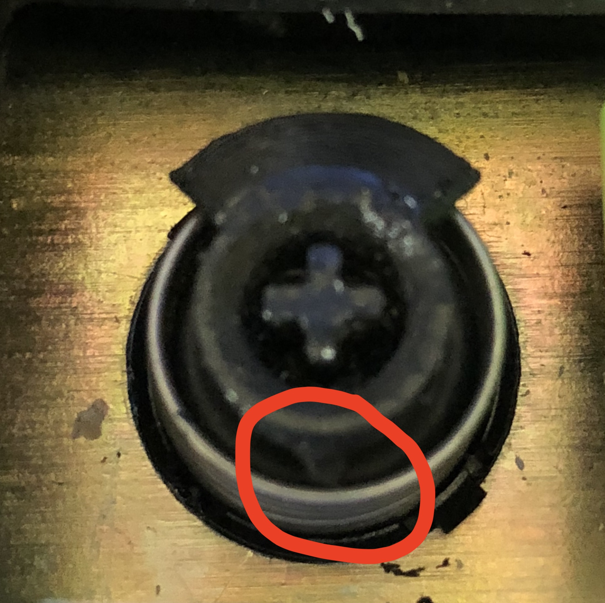

Another item I saw, when using the stem was the hook which holds the spring back so there is a return force. It can jump over and then the switch isn't returning the key anymore. Can you make that thing a little longer?
See picture below:
One more note: The round stem and the way of the design is made, the keys sit even better than the original ones and feel super crisp. I have to say - this might be an impossible improvement for Beam Springs ... WOW

Updated file sent. I reduced the stem diameter and elongated the return spring end by 1mm.
I'm glad that this is not only an adaptation for new cap options, but an improvement to the feel of the keystroke.
I was thinking it would be wise to thicken that return area as well just as added insurance of longevity. I will update that once we get a better understanding of the tolerances that work best.

This version does the trick (for my printer). It is now fitting perfectly in all areas. The only thing I need to test is the durability as well. I have printed five and added them to the sliders. They fit tightly (as they should), but when I tried to remove them out of the slider, the head was ripped off. Not a big deal, as you can use pliers to remove the stem, but something I wanted to mention. Overall - I think it is a great design that has the potential to make the beam spring keyboards to "wear new clothes".
