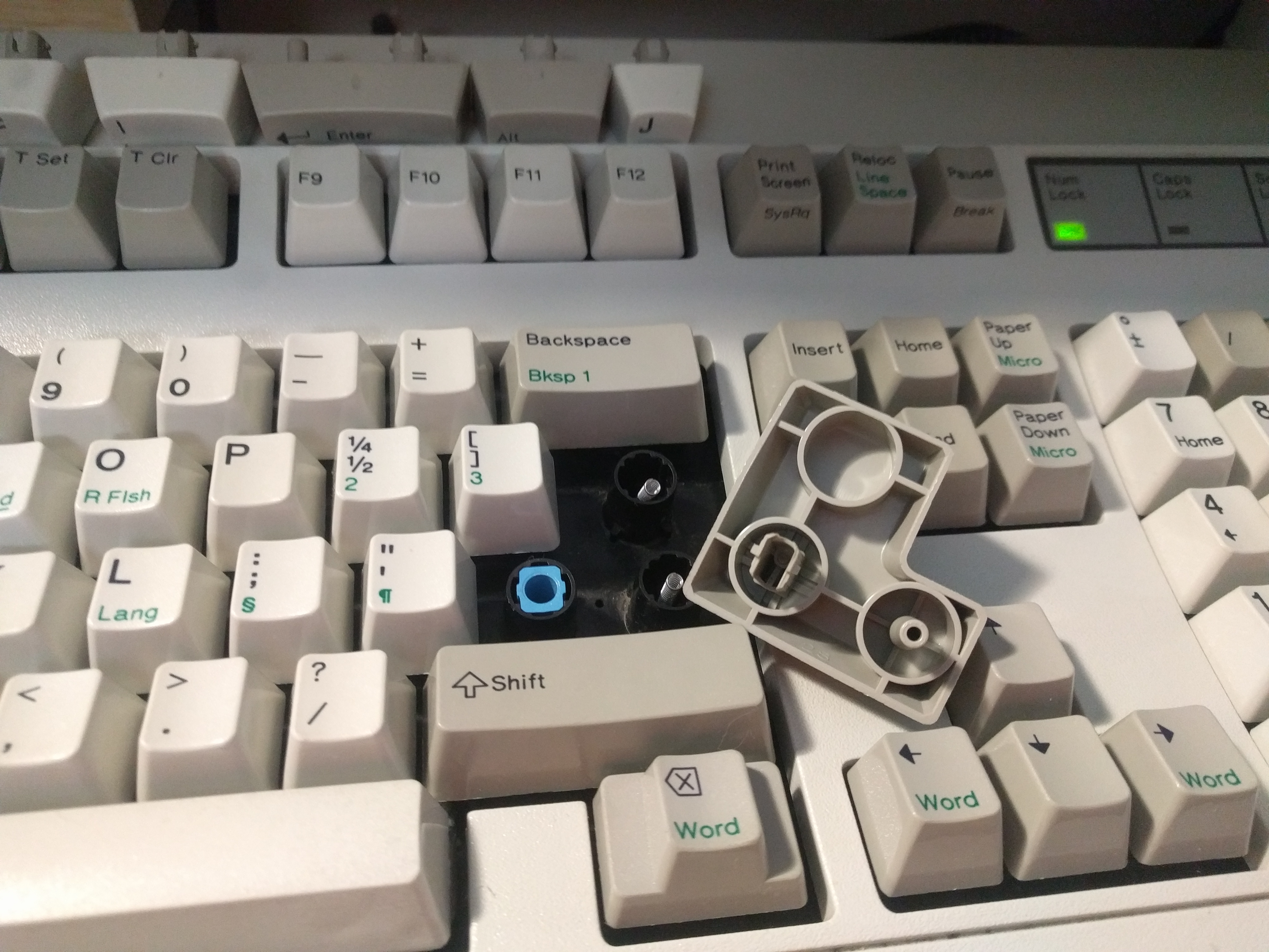

zrrion wrote: You just remove the caps and put it on? Not sure a video would be worth it. It didn't require any modification and I didn't remove the spring/hammer for the "|\" so its just chilling under the BAE. If I had needed to bolt mod the thing I would have removed it I guess but it does not effect operation or feel so far as I can tell.
I did have to trim one of the clips that hold the wire stab to the barrel plate slightly because otherwise the spacebar would not return, and I needed to add an insert for the Code key slider. Not a difficult modification.

I got pretty lucky that the stuff is compatible otherwise I would have had to do a more intensive mod. SInce none of the rivits are broken I would have had to break them myself and that feels like somehting that would earn me 7 years of bad luck.
fohat wrote: I assume that simply replacing Alt with Code can be done from the top.
Yes. Adding the code key was super easy, and I plan to just use it as an Alt key after I remap it.
My question is the BAE stabilization. I thought I recalled that the AT style BAE had wires running both ways.
I've got 2 Wheelwriter 3s and neither of them have wire stabilizers on the BAE, just the rod kind. I don't know which Wheelwriters use what stabilizers so its possible that some use wire while some do not.
