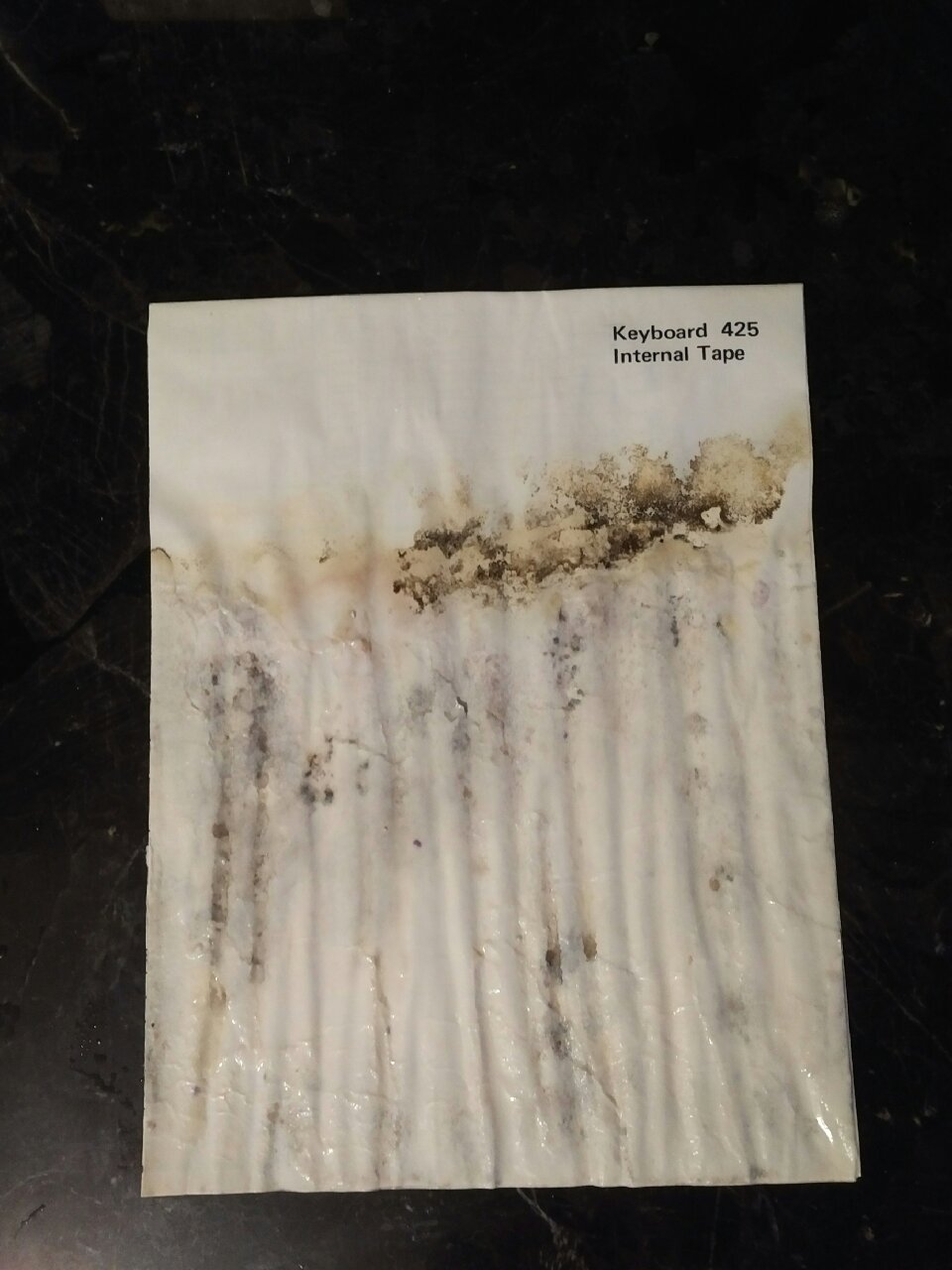

Just so yo guys know, I am soaking the Logic Manual. It is a pack of schematics that I can hopefully get apart. There is a keyboard schematic in the bunch but it looks moldy, unfortunately. Let's see what happens.

snuci wrote: Just so yo guys know, I am soaking the Logic Manual. It is a pack of schematics that I can hopefully get apart. There is a keyboard schematic in the bunch but it looks moldy, unfortunately. Let's see what happens.
That would be AWSOME!
It's not looking good. Let's see when in dries in a day or so. I can't open it or it falls apart right now.
