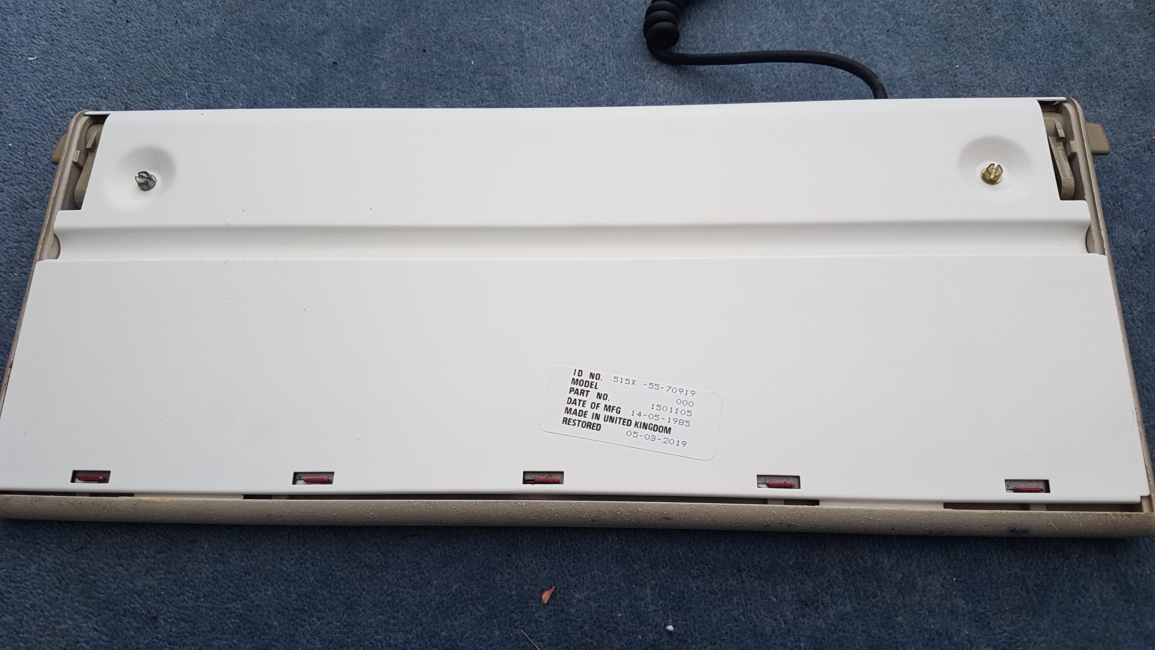

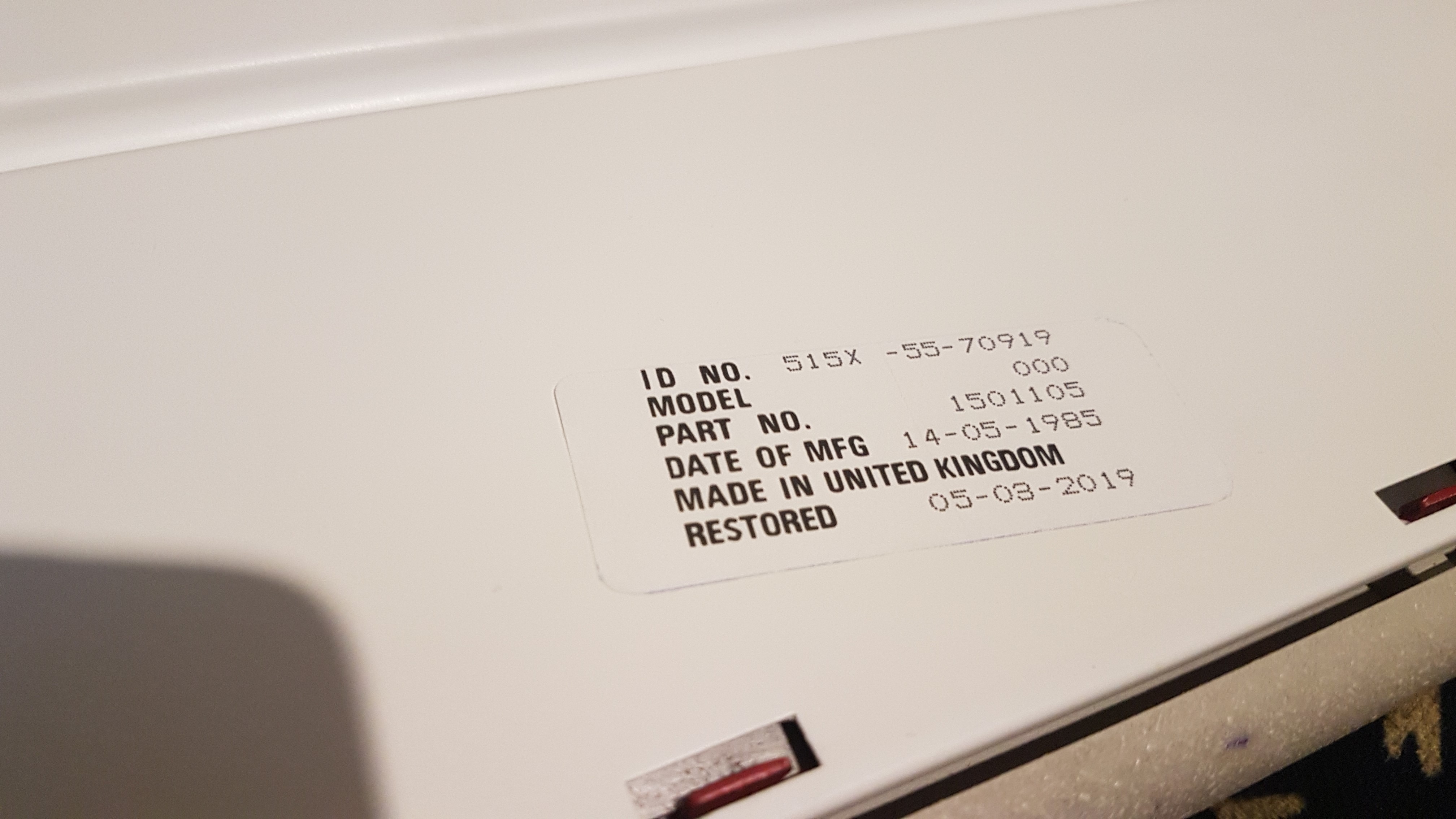

Update 2 - Got it back together. Bar clamp method didn't work one bit, most likely because the foam was too thick. This time, the keycaps went on first try for the most part. Everything works however the keys sometimes the keys activate random ones but that's probably down to the fact that it's a 30+ year keyboard thats been submerged in water.
Some pictures (will post more tomorrow)
Close up showing fixed plastic and red plate.
10 days late...
