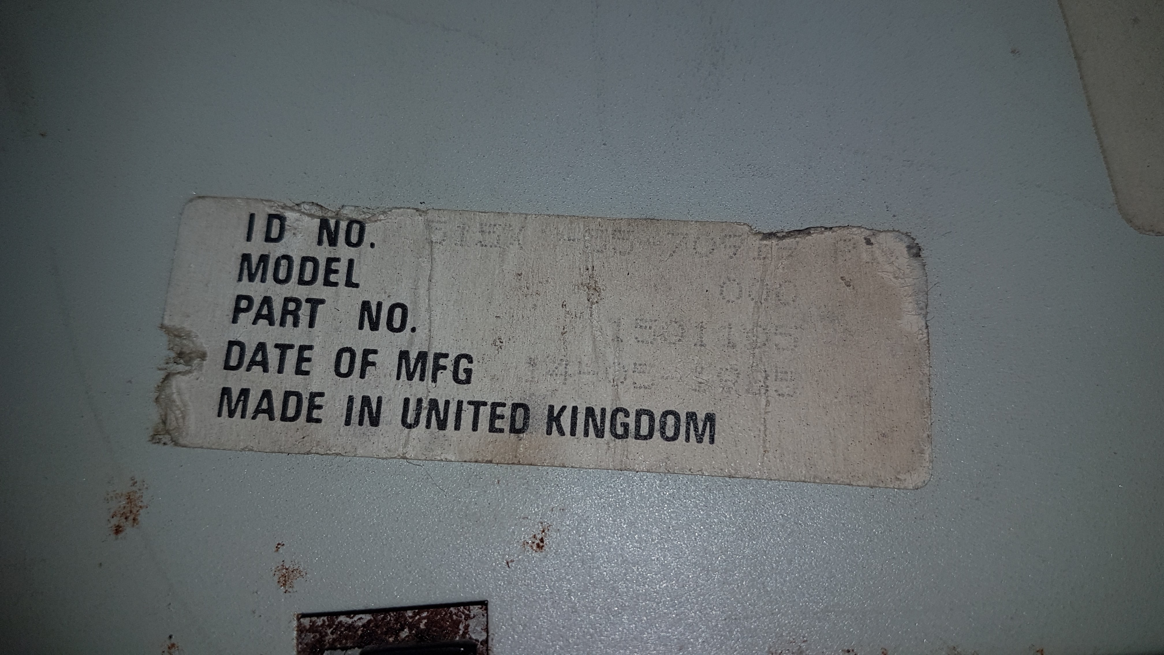

The rear sticker indicates it's a 515x with the model number 1501105 and assembled in 1985. The original cable appears to have been replaced.
rear sticker.jpg (1.73 MiB) Viewed 9711 times

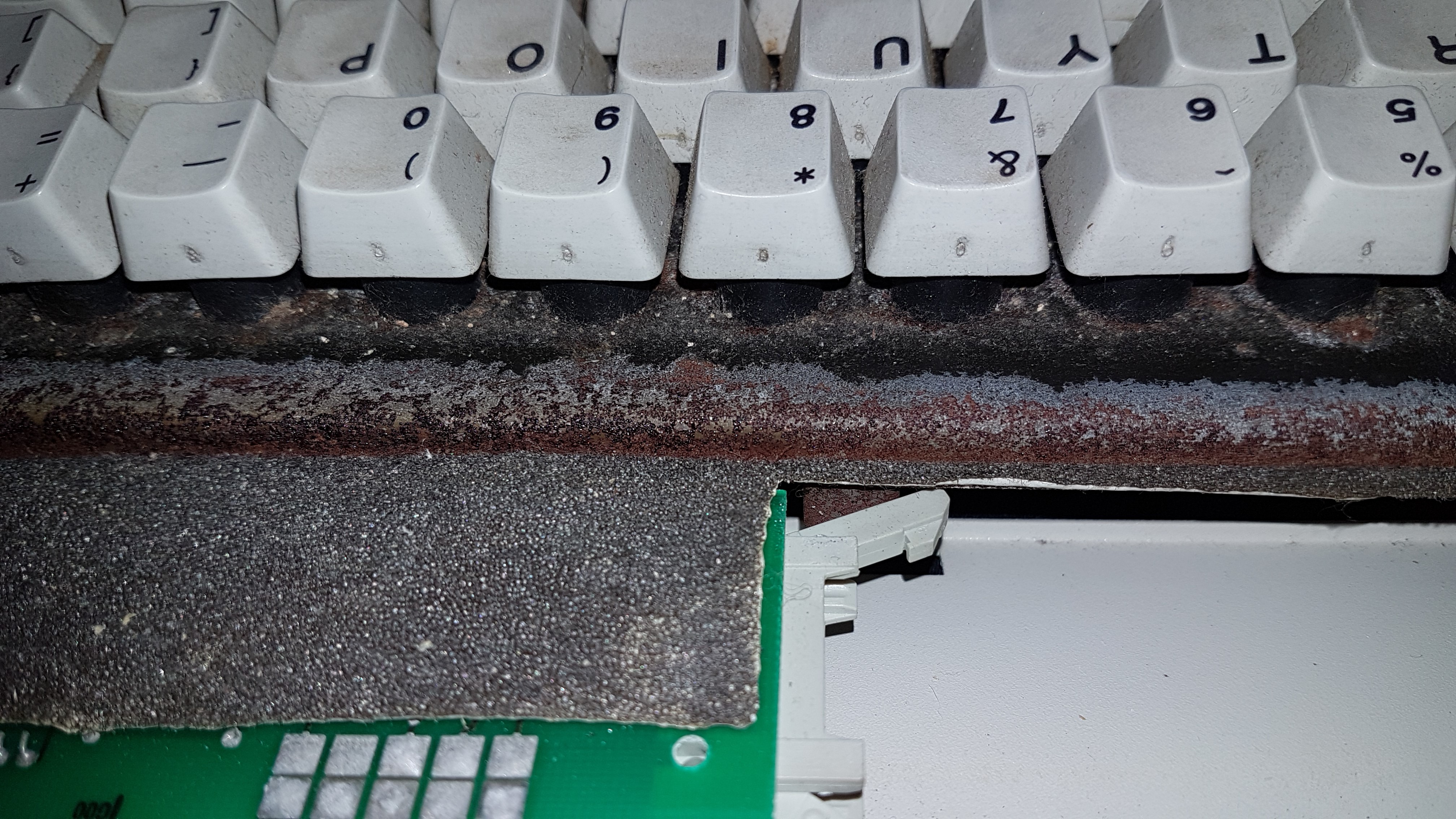

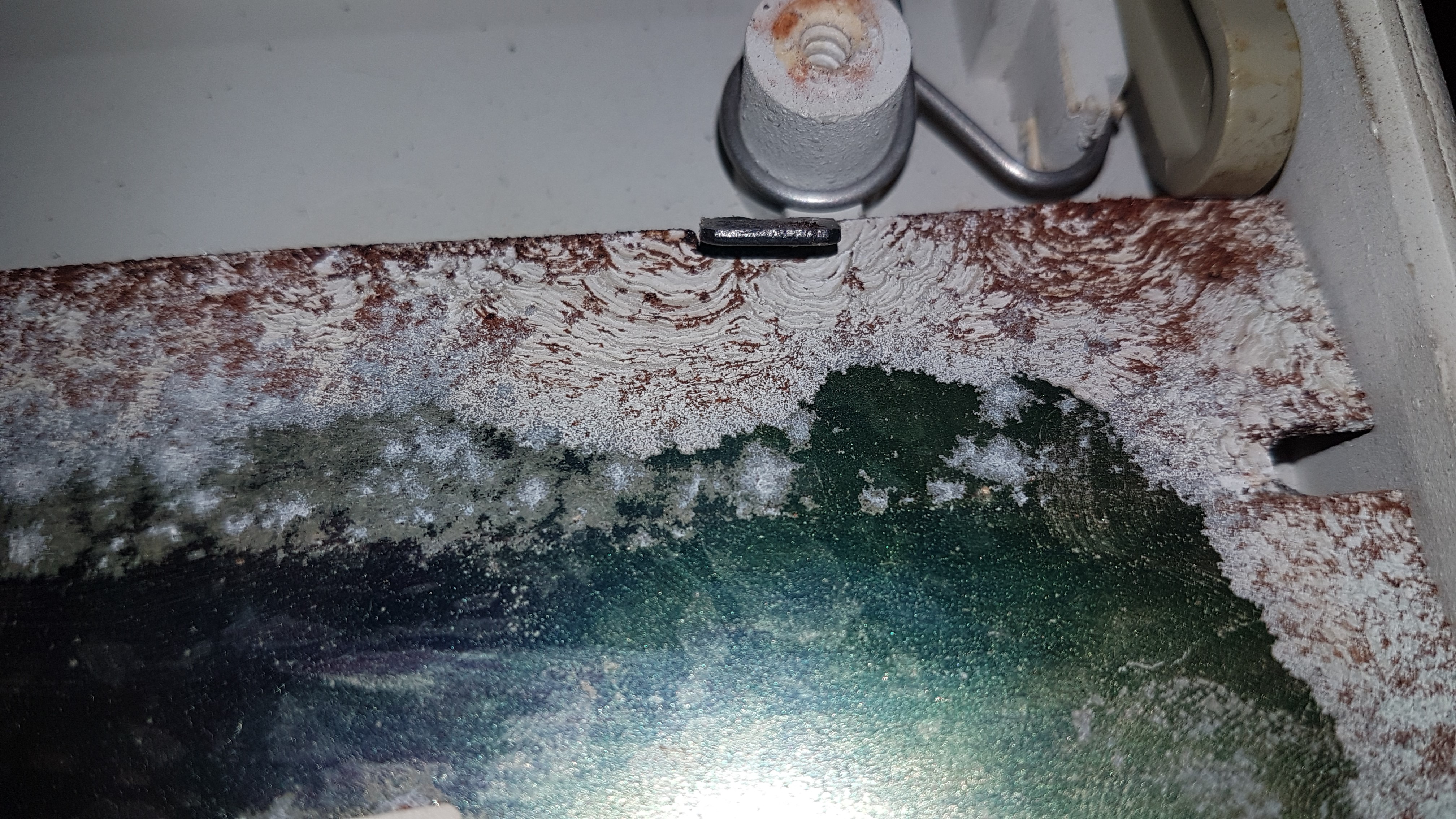

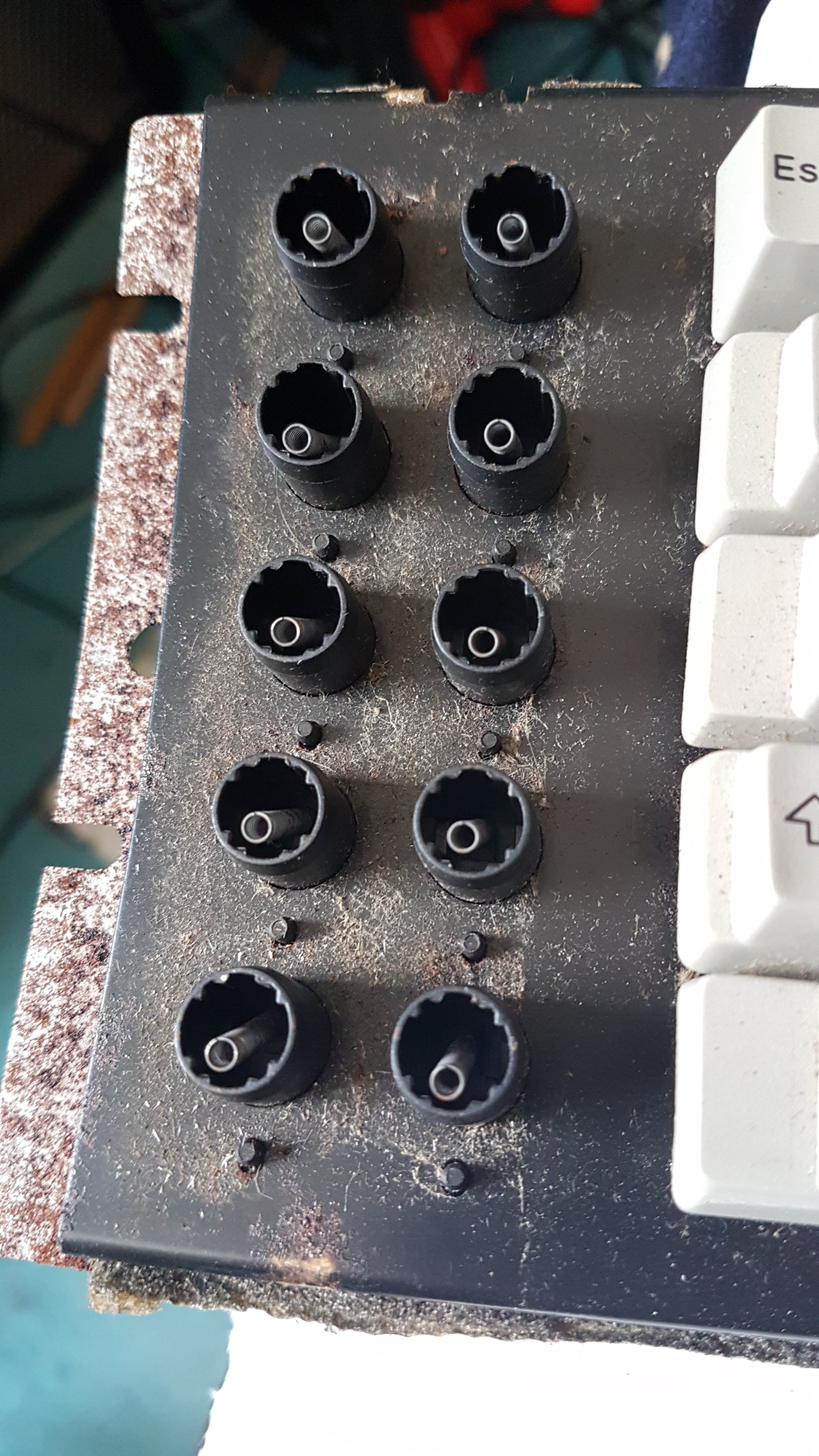

Once I was finished typing on it, I opened it up to be greeted with a lot of powder (from the foam) and LOTS of rust - nice
This is possibly the worst rust I've seen in a keyboard, and I've had a lot of bad ones. I'm confident that this was, at some point in it's life, partially submerged in water. I began by taking the keycaps off so I could see the damage - the barrel plate is also rusted but not as bad (on the top, that is)
dust under caps.jpg (1.93 MiB) Viewed 9711 times

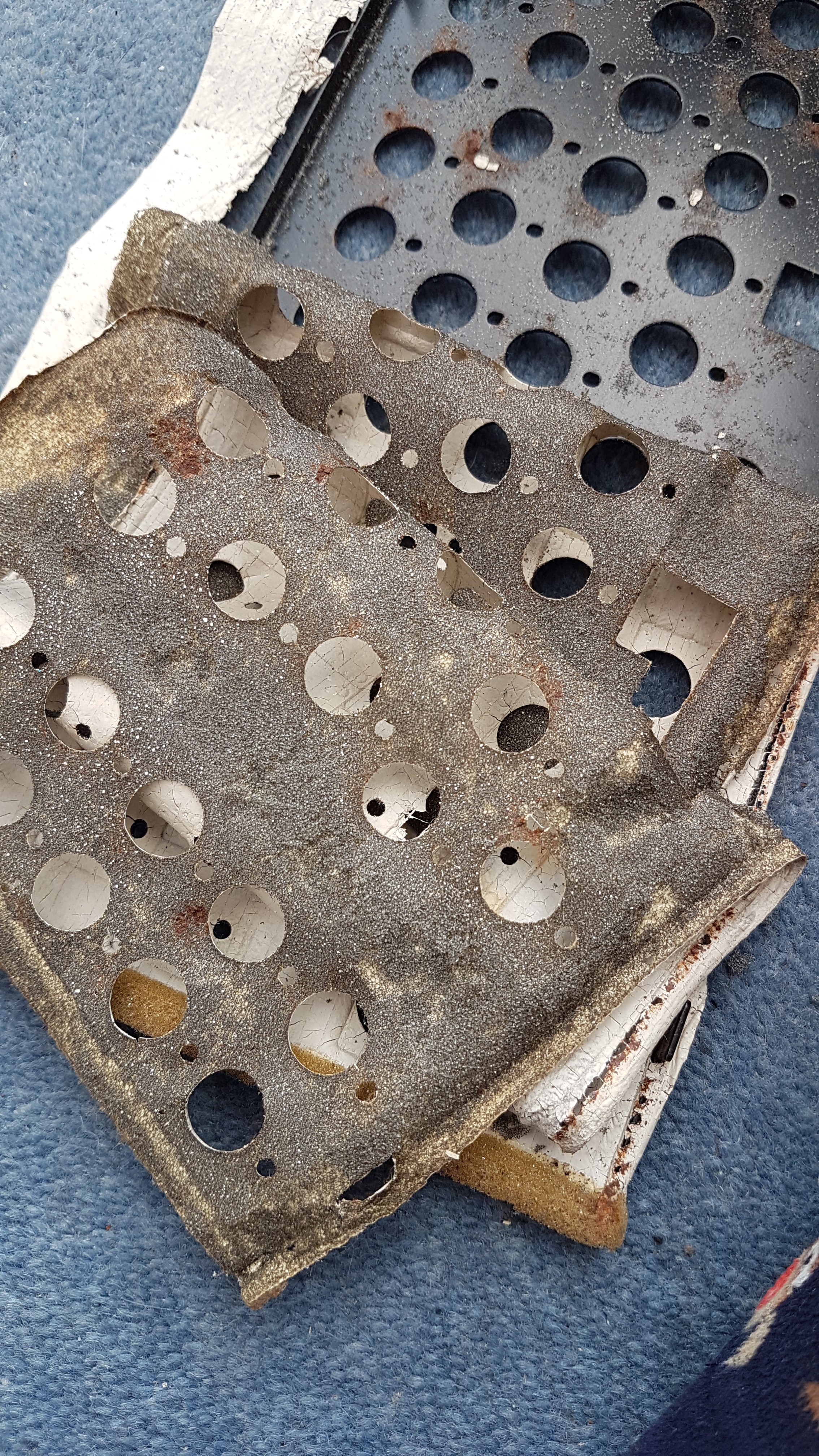

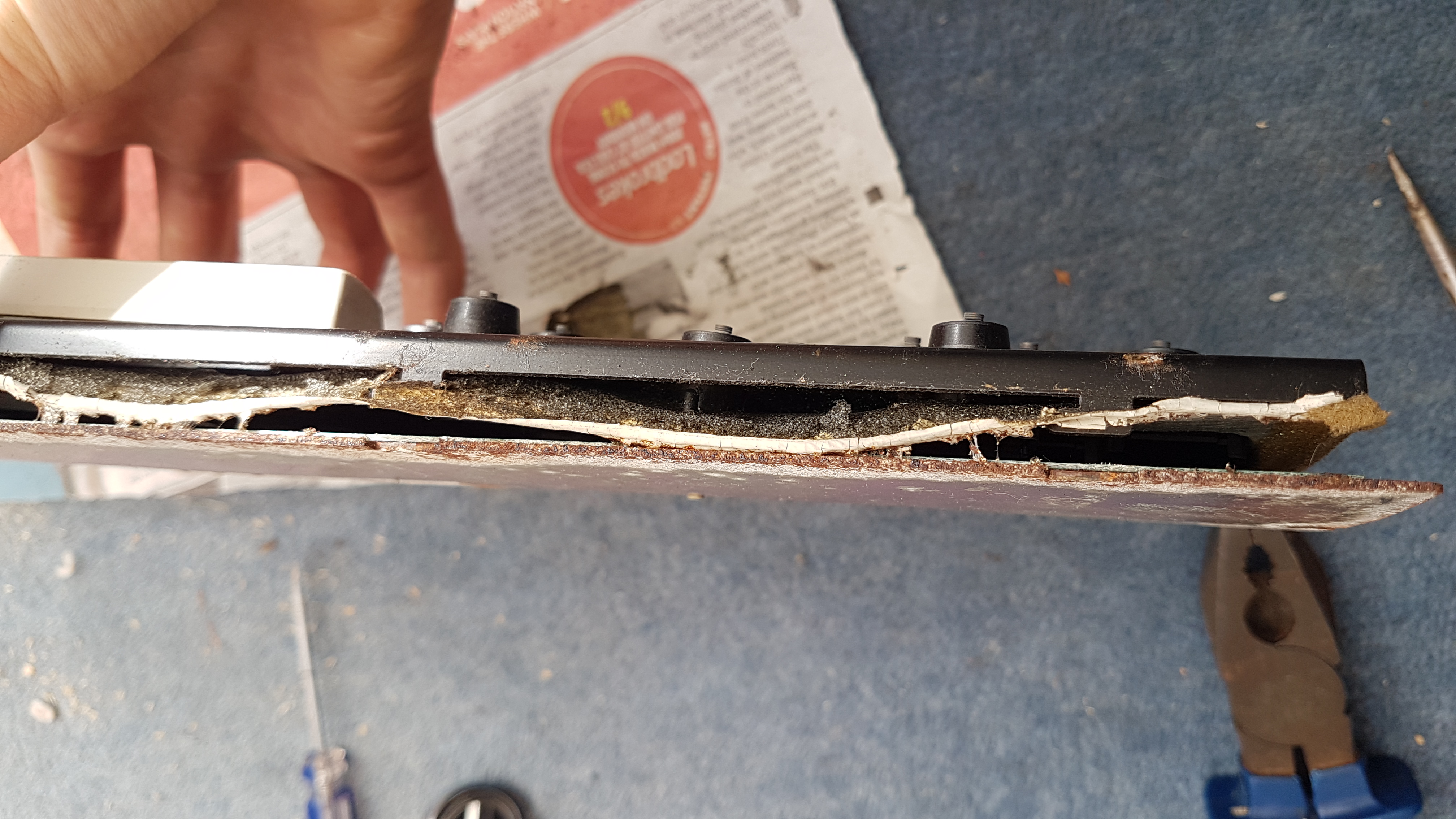

Once all the caps were off, I separated the assembly with the help of some pliers. The goo from the foam and the rust made this difficult.
The foam was completely powder and goo meaning I need to make a new foam mat at some point
foam 2.jpg (3.37 MiB) Viewed 9711 times

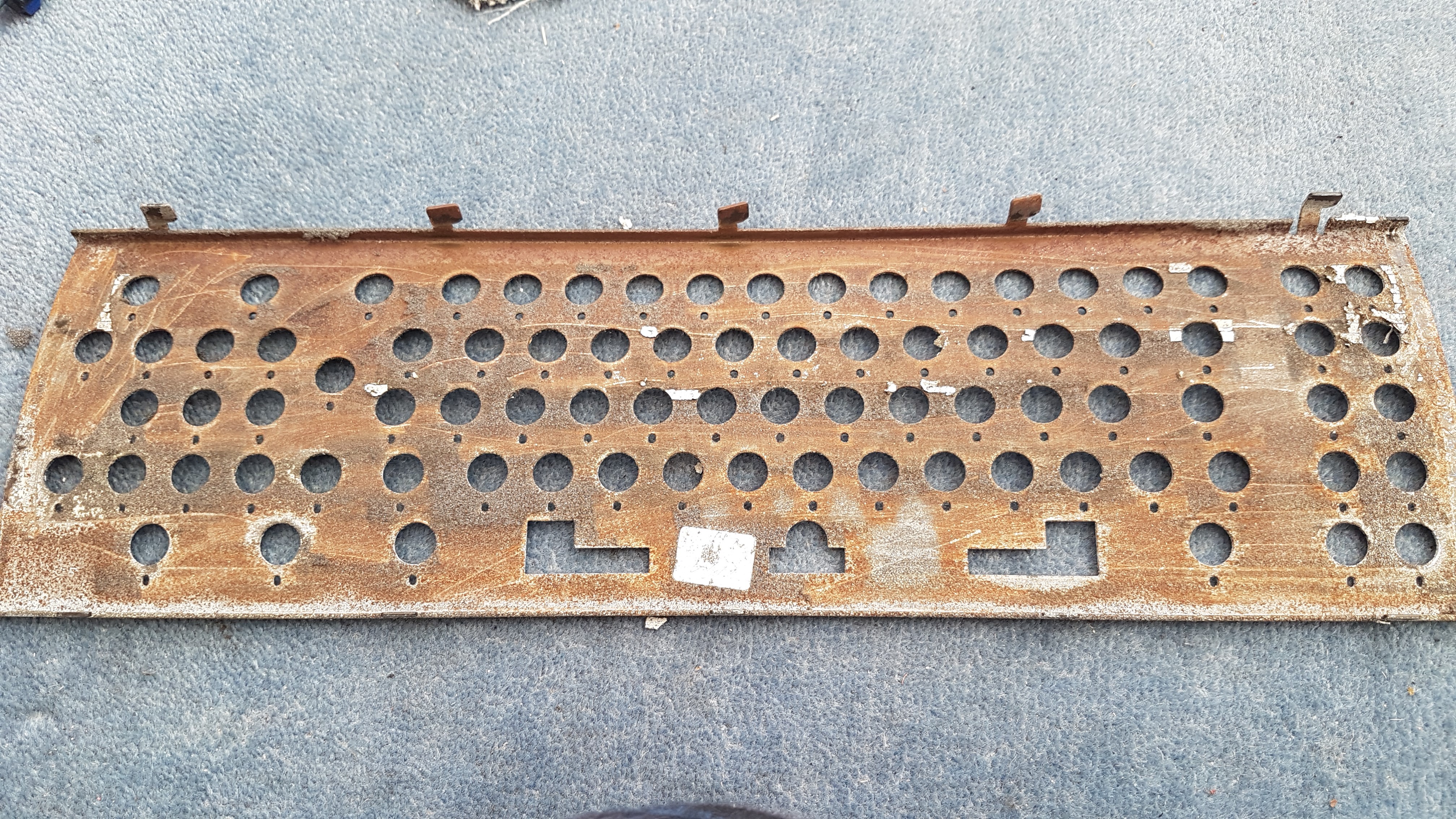

The rust is incredibly bad on the inside as well. I've started sanding it down but it will take a while before I'm finished. My goal is to spray everything with Polyurethane but I'm not sure how effective that would be.
rust on inside.jpg (2.24 MiB) Viewed 9711 times
rust sanding.jpg (4.97 MiB) Viewed 9711 times

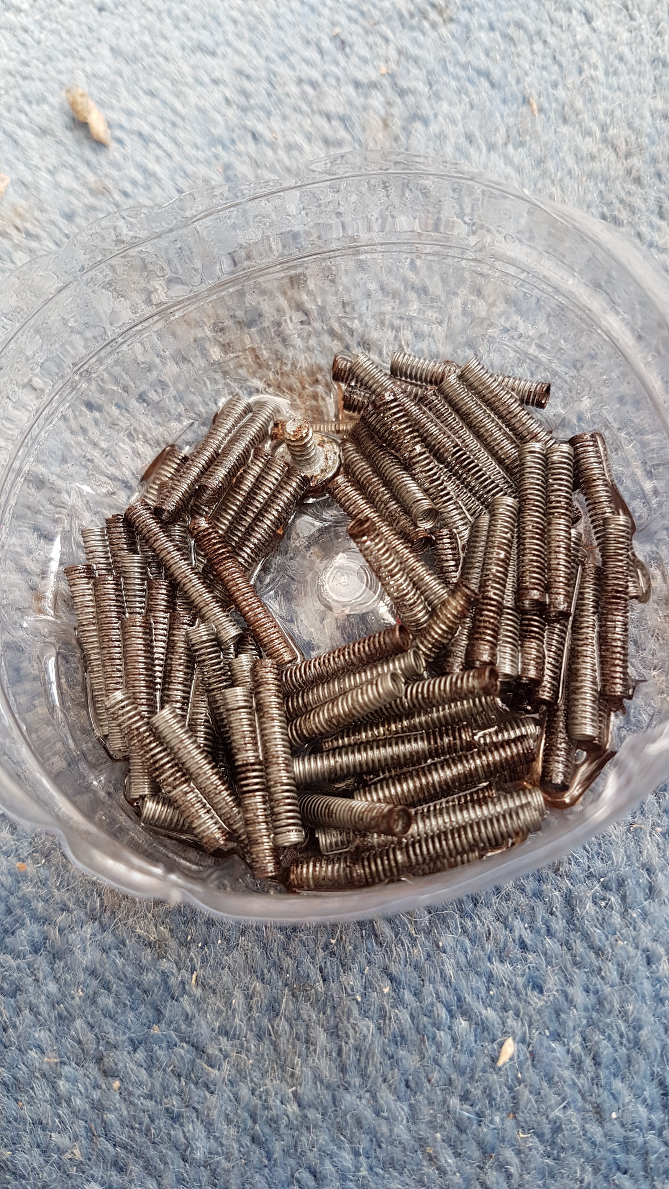

Regarding the other hardware, I've currently got the barrels and keycaps soaking in soapy water and springs and bolts soaking in WD40. So far the springs are looking much better as they were coated in rust.
springs in wd40.jpg (2.51 MiB) Viewed 9711 times

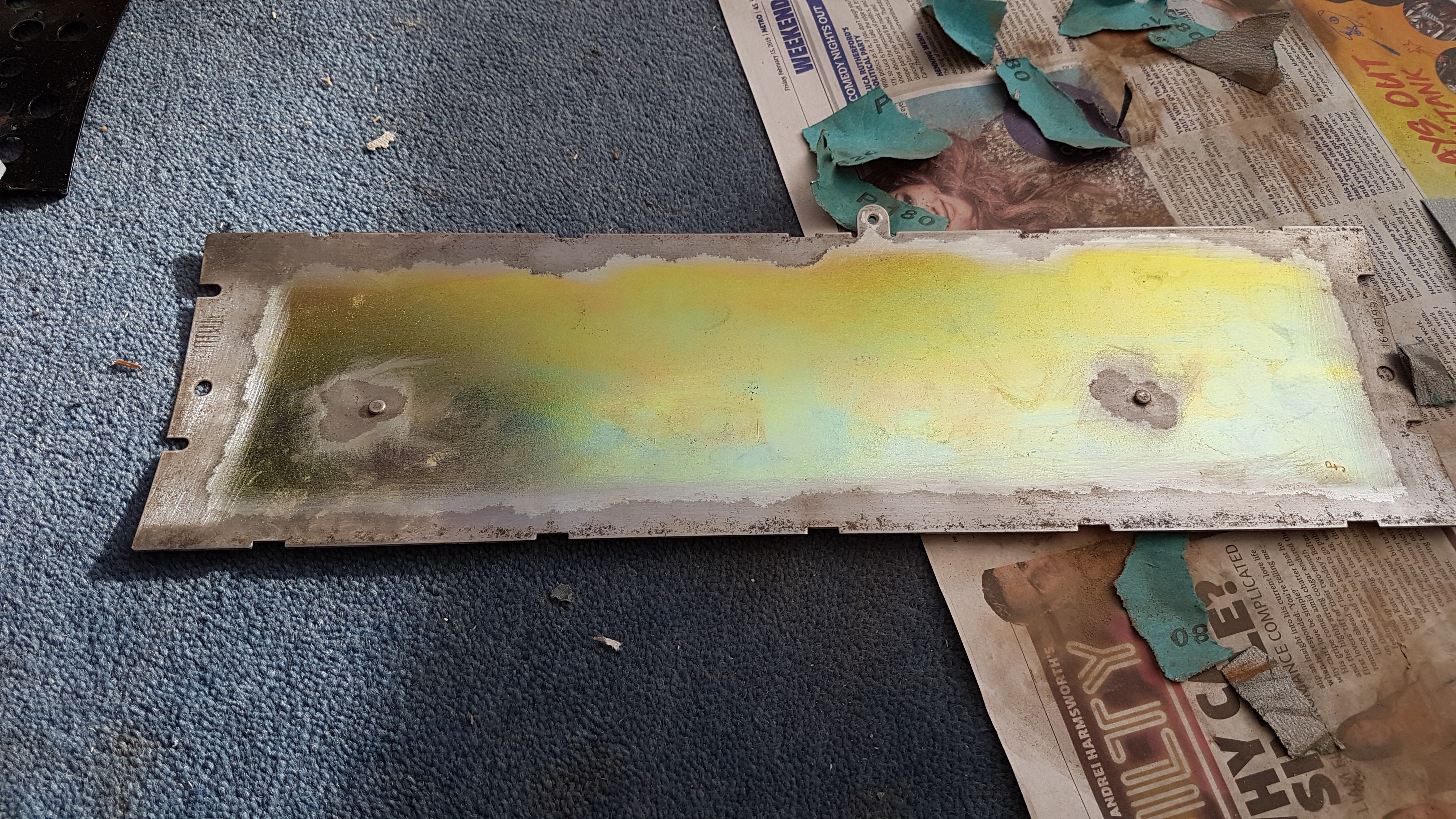

--Day 2--

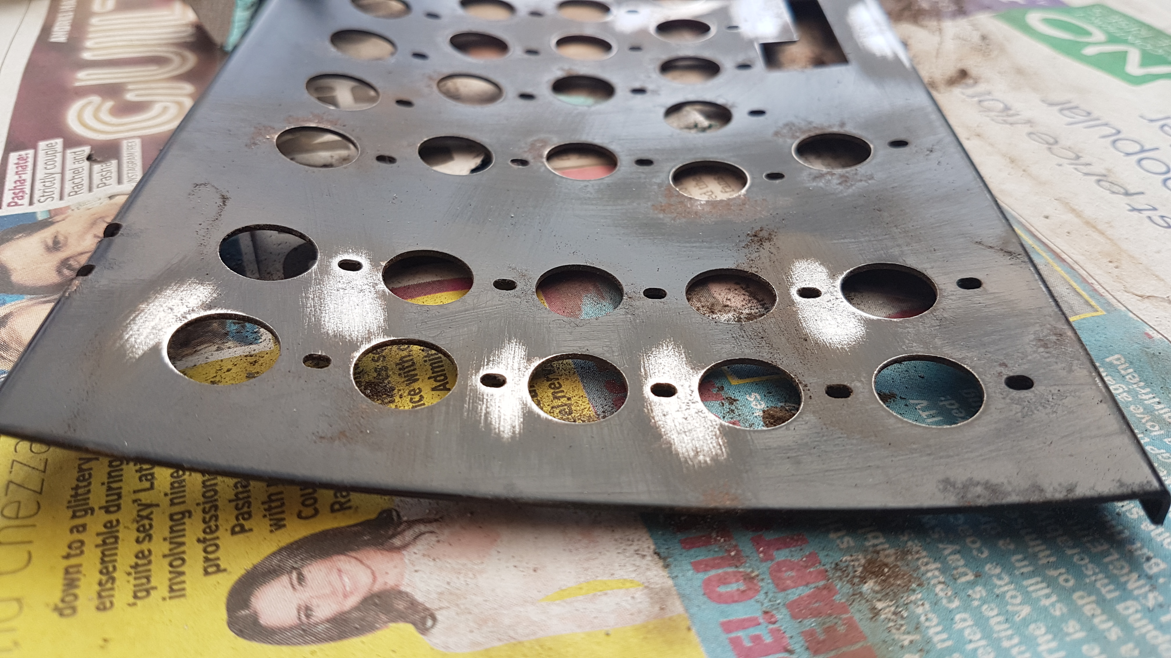

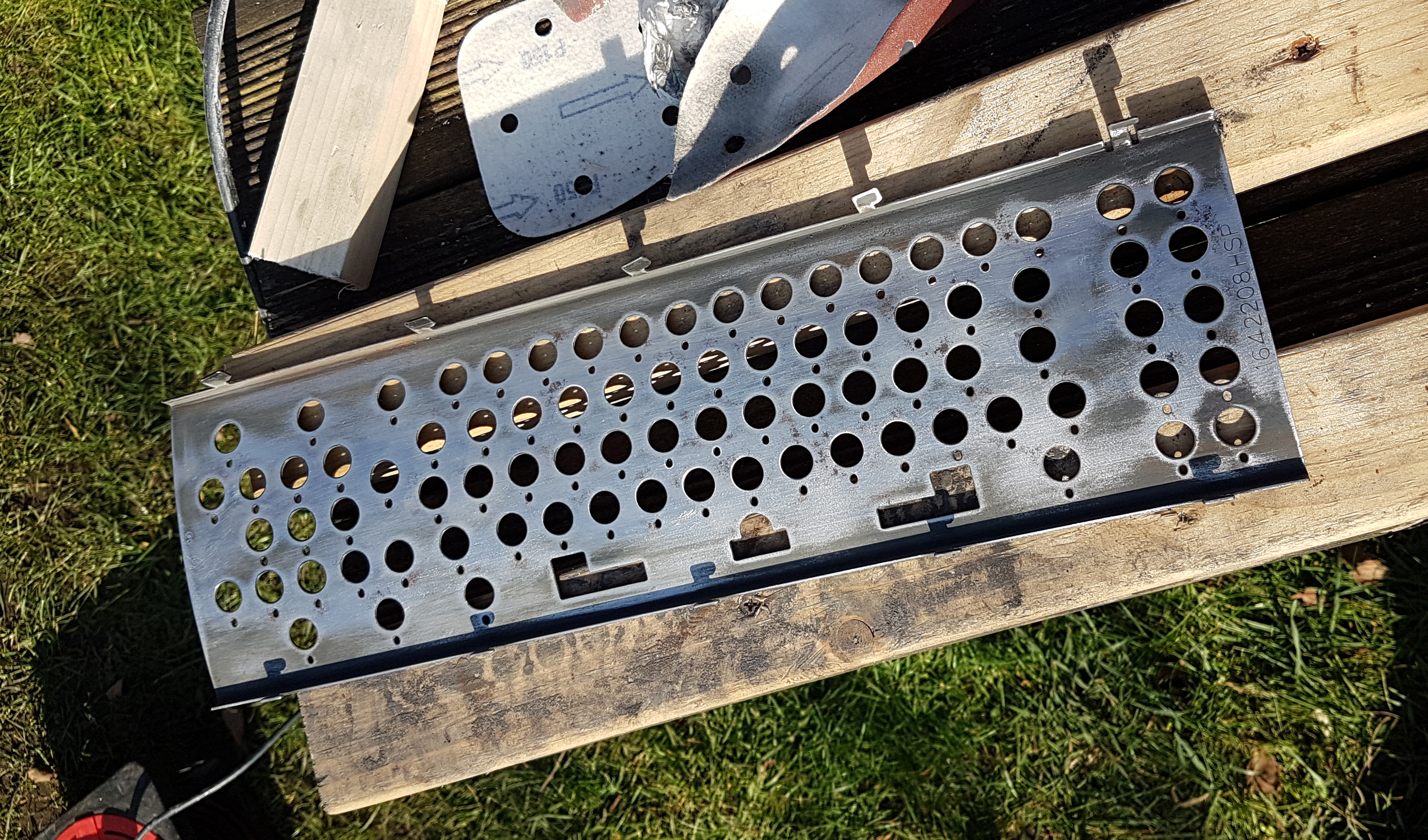

While the keycaps and barrels were drying off, I finished sanding the rust off the bottom plate. Unfortunately, I had to leave one spot because I would've had to destroy a sticker otherwise.
rust removed.jpg (2.91 MiB) Viewed 9601 times
The barrel plate is frustrating as it's hard to sand. I'm also going to have to paint this part once I'm done sanding.
removing rust.jpg (2.79 MiB) Viewed 9601 times

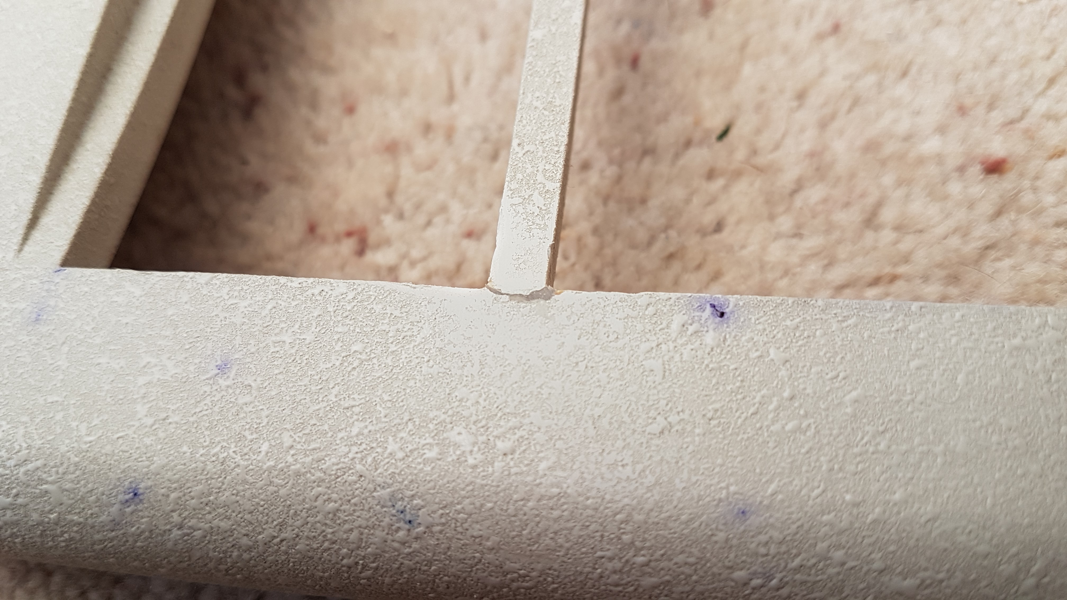

I also began removing excess epoxy from the case. It doesn't look pretty but at least it's functioning.
epoxy cured.jpg (1.39 MiB) Viewed 9601 times
As it turns out, the WD40 didn't help the springs at all. Some of them are very rusty but still function.

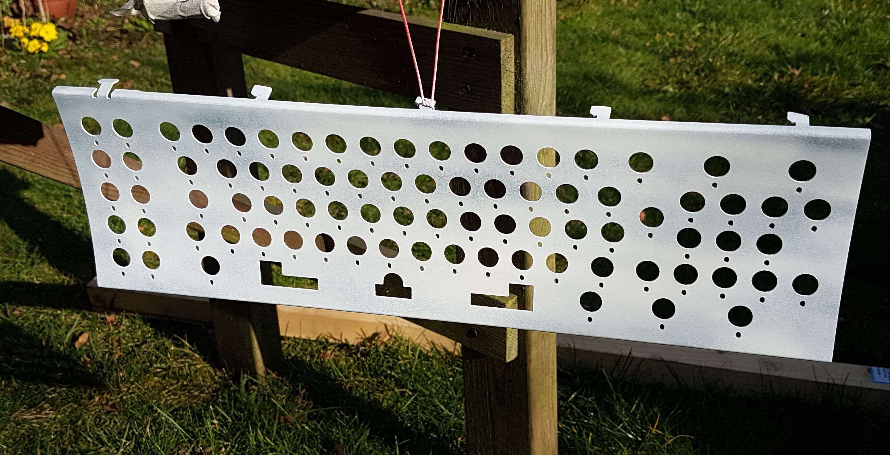

Sadly nowhere had any enamel gloss type paint so I settled for some red rust-oleum stuff. I had a little bit of crappy cheap primer left so I used that to prime the plate.
Priming plate.jpg (1.62 MiB) Viewed 9582 times

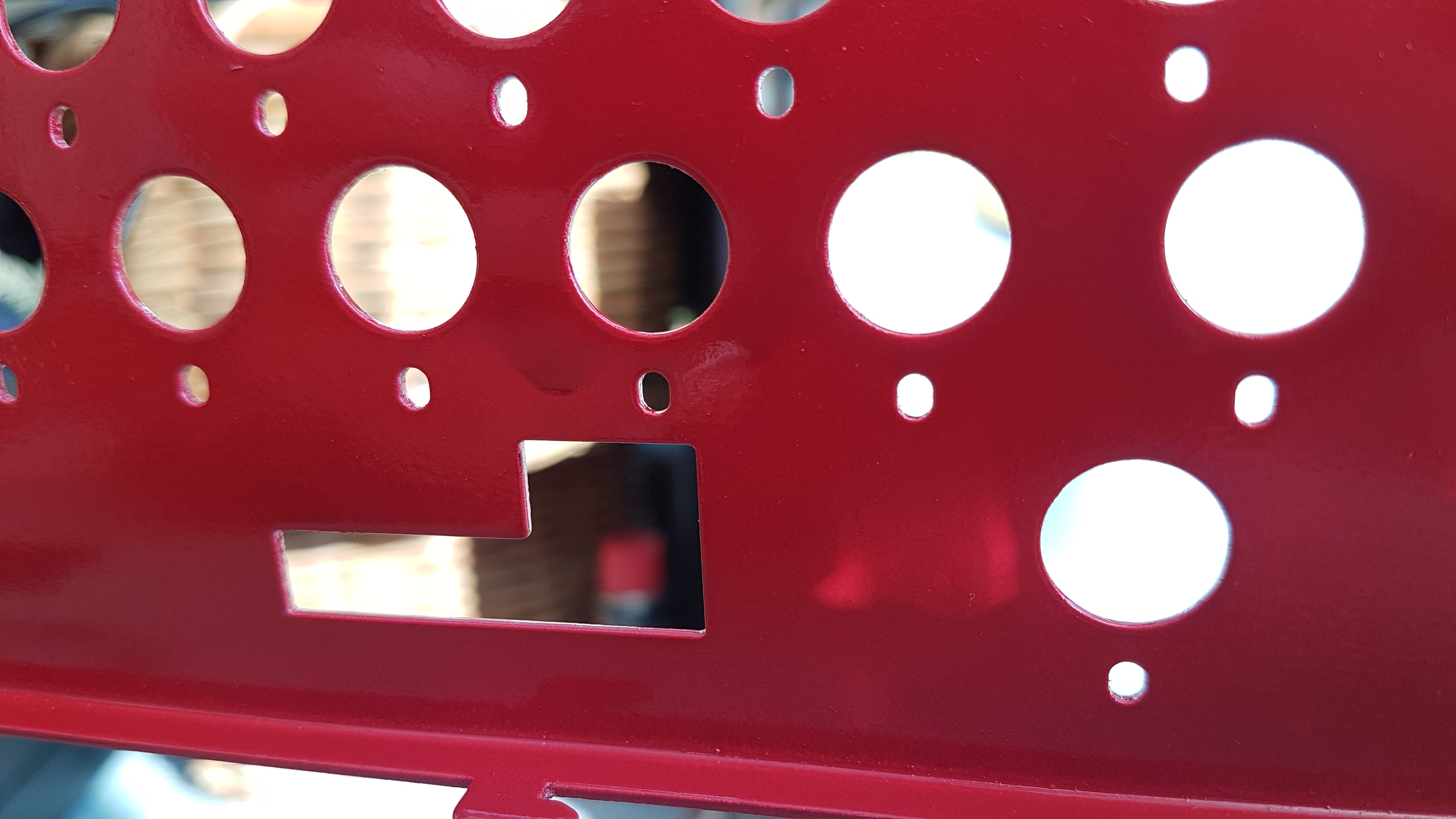

This morning, I decided to start painting it. It turned out alright but there are some drips visible which I will need to sand down once dried.
Paint dripping.jpg (1.13 MiB) Viewed 9485 times

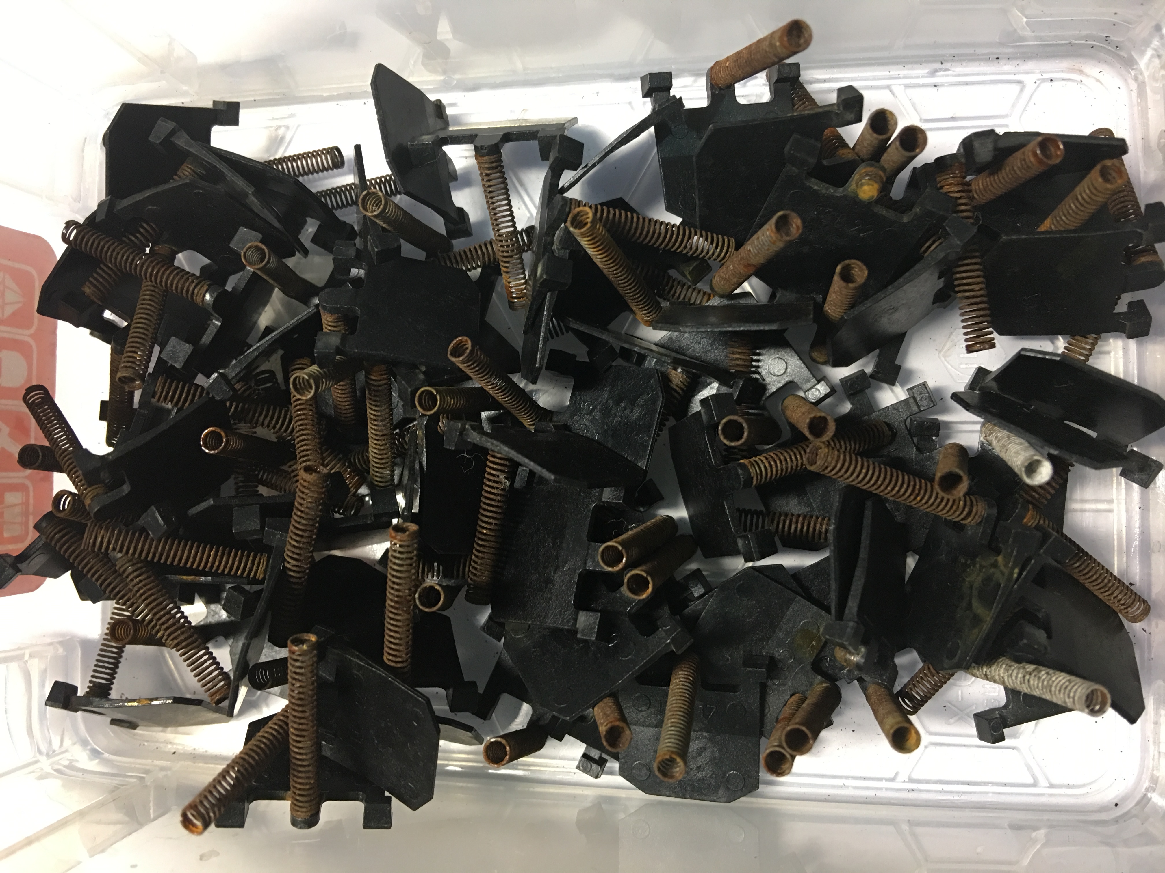

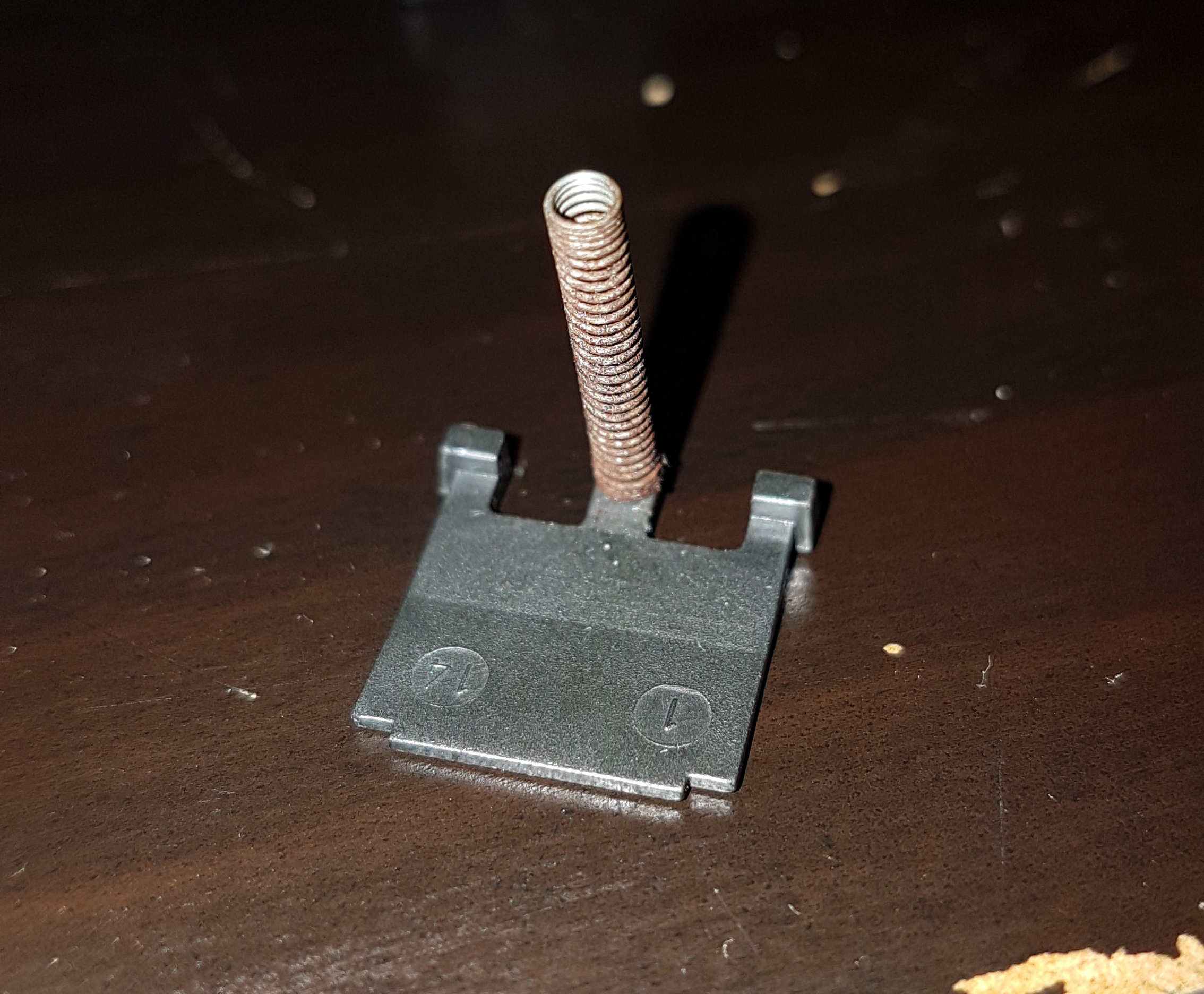

I also face the intractable problem of the rusty springs, no helpful solution after searching whole forum.
Tried vinegar and WD40 also, still like shit.
If you have good idea finally, really really appreciate it. :D :D :D
Aran.E99
23 Feb 2019, 17:44
Holy shit those are some of the worst springs I've seen! I considered trying a contact cleaner but it's very similar to WD40 so I doubt it would work. The corrosion seems really stubborn on the springs and other metals which is strange because vinegar normally works fine for me.
23 Feb 2019, 18:23
Shit man. This is a project here. I would say try and find a product called Evapo-Rust. I use it all the time on springs, screws, etc. It works like magic (chelation) and isn't harmful to metal like acids and you won't have an issue with flash rust after derusting. Acids tend to take good metal along with the rust. Krud Kutter or Naval Jelly (phosphoric acid) are good products as well but cost more per ounce than Evapo-Rust. Once derusted you can apply some gun oil to prevent future rust. Your other options are to find another Model F or use some springs from a Model M.
John Doe
24 Feb 2019, 03:27
JP! wrote: 23 Feb 2019, 18:23 Shit man. This is a project here. I would say try and find a product called Evapo-Rust. I use it all the time on springs, screws, etc. It works like magic (chelation) and isn't harmful to metal like acids and you won't have an issue with flash rust after derusting. Acids tend to take good metal along with the rust. Krud Kutter or Naval Jelly (phosphoric acid) are good products as well but cost more per ounce than Evapo-Rust. Once derusted you can apply some gun oil to prevent future rust. Your other options are to find another Model F or use some springs from a Model M.
Thanks, JP!
I will try your method and reply when get any result.

John Doe wrote: 23 Feb 2019, 16:42 I also face the intractable problem of the rusty springs, no helpful solution after searching whole forum.
Try Evapo-Rust

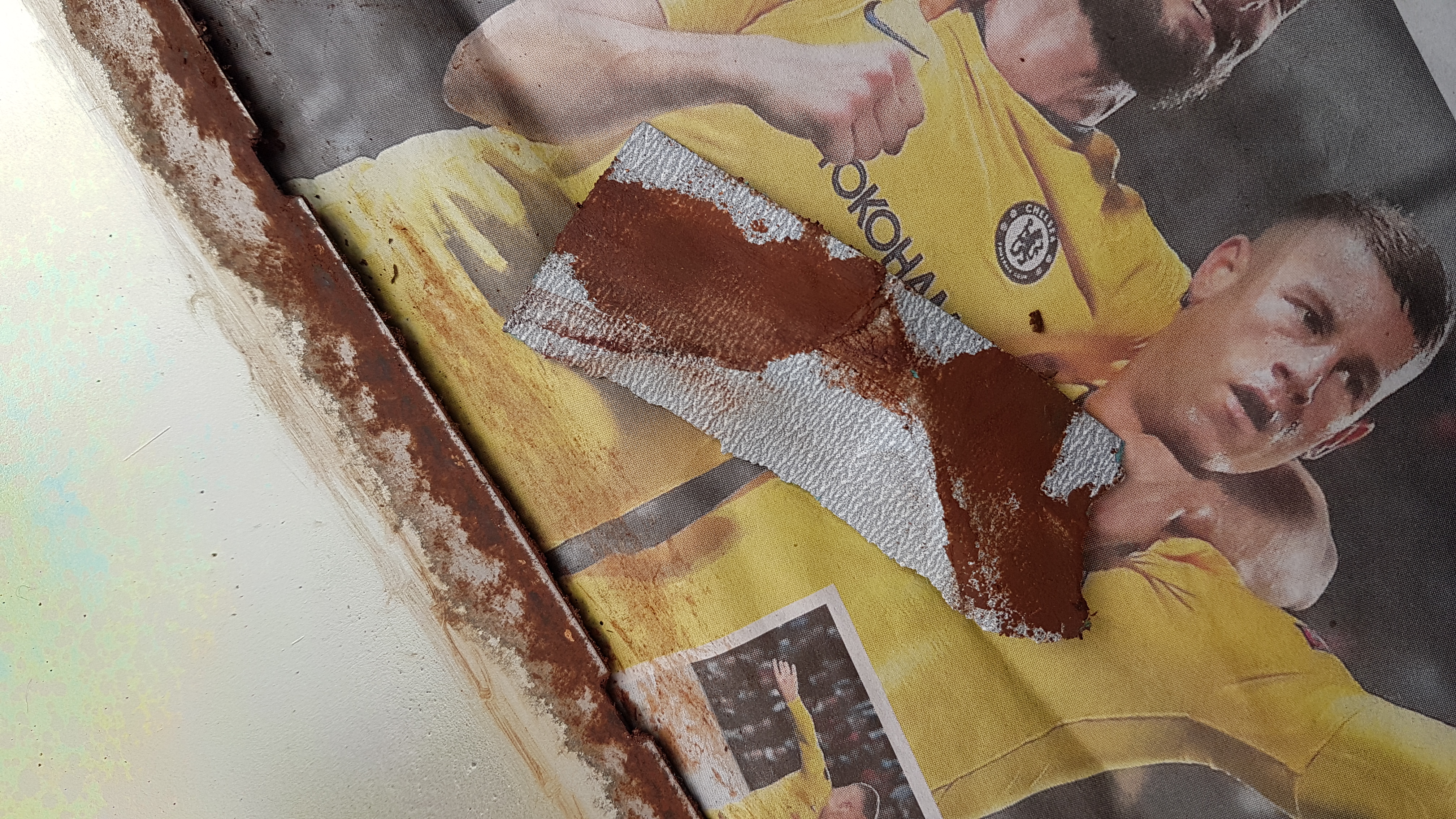

Managed to get another F XT from the same seller. Jesus. Fucking. Christ. It might be even more rustier than the first. The top of the barrel plate has thick corrosion and the back plate is bent. If he gets any more I'm definitely asking for a lower price...

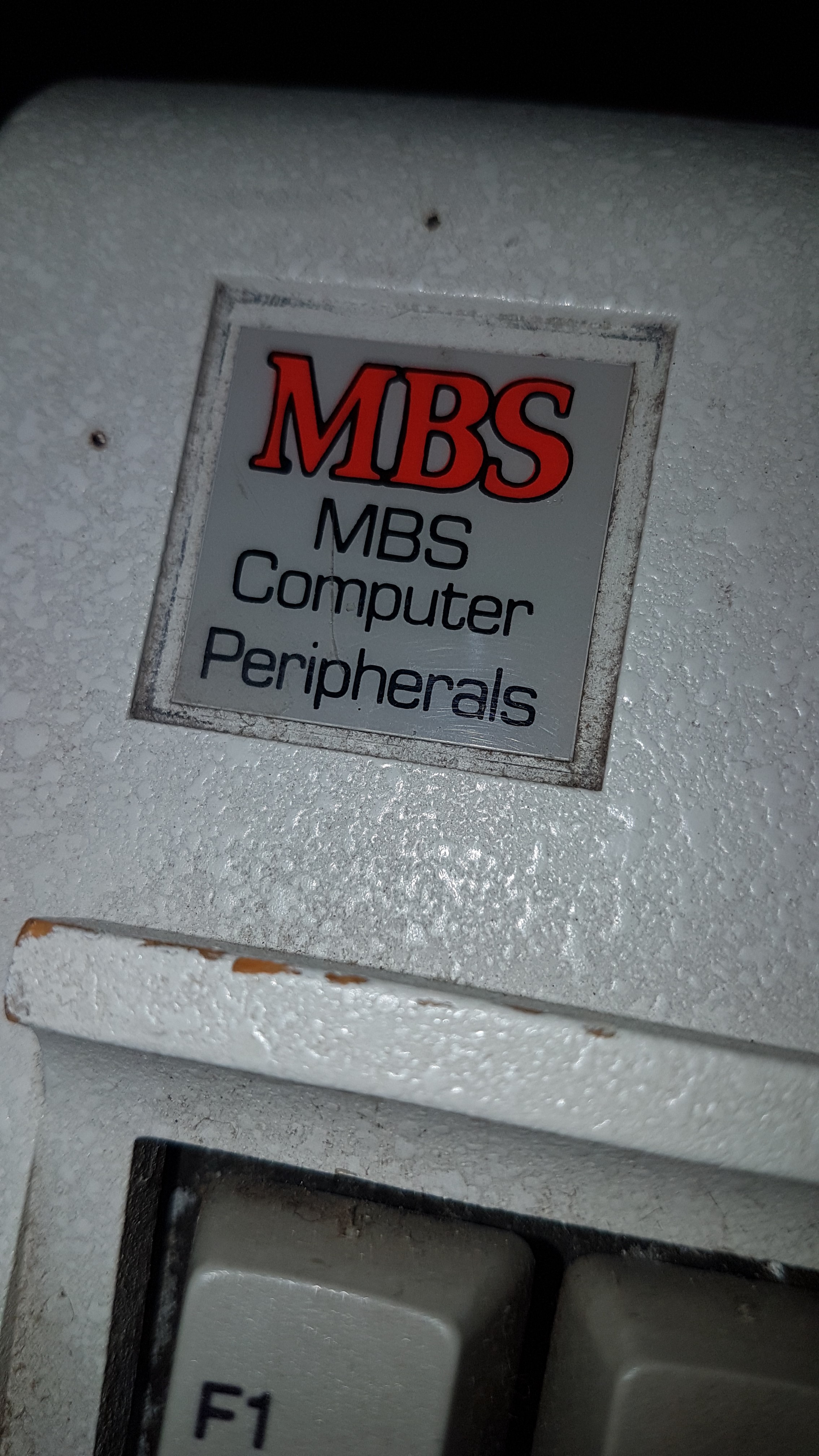

Surprisingly the springs (from what I saw) are really clean and the bottom pan looks clean but the internals look like they've been submerged in the ocean since 1986...
I mean how does this even happen to a keyboard?
MBS whoever they are (presumably the company that ripped out the IBM badge to replace it with their own)

Update on keyboard 2: definitely more rusted.......
rust plate.jpg (3.29 MiB) Viewed 9288 times

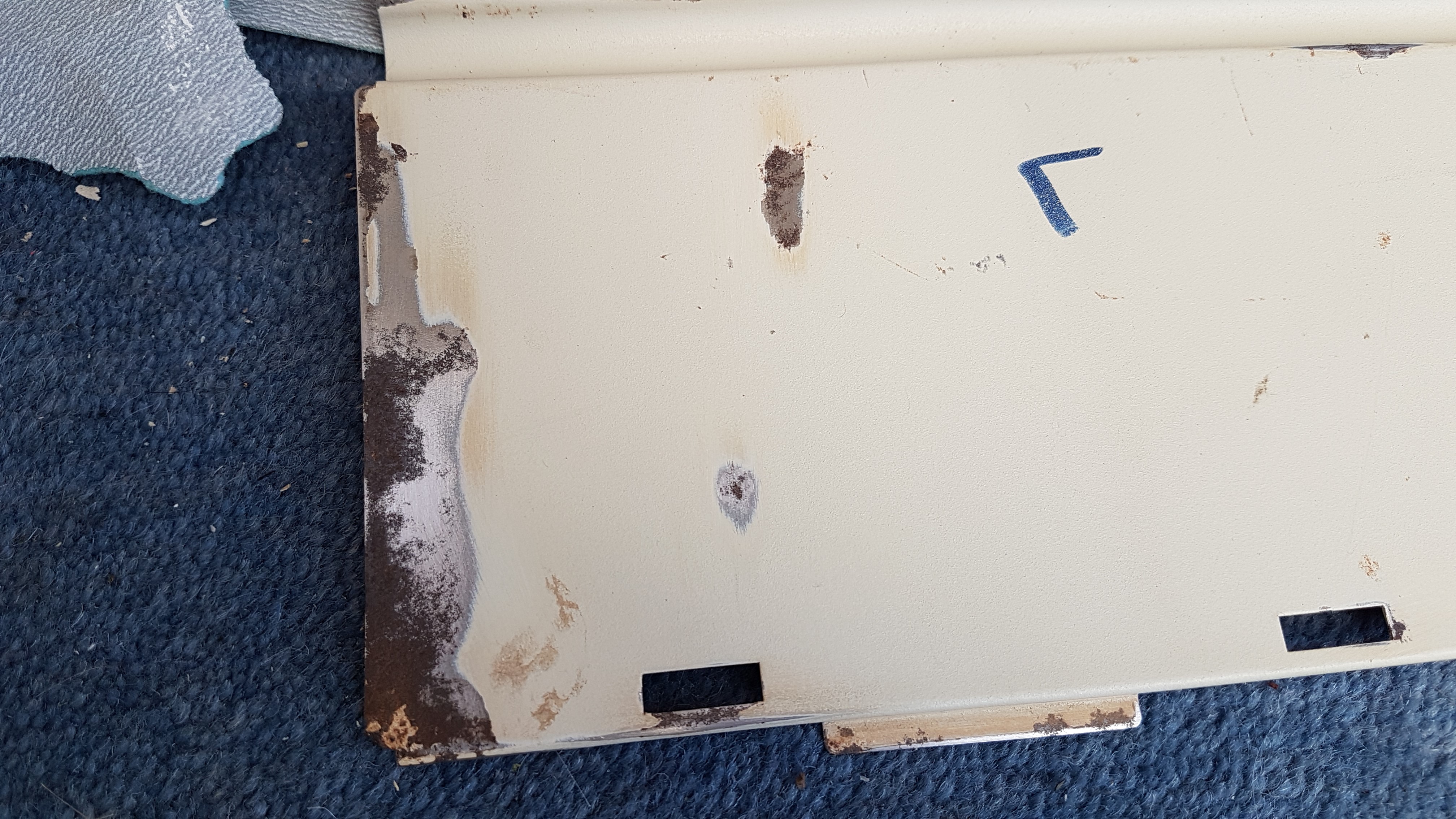

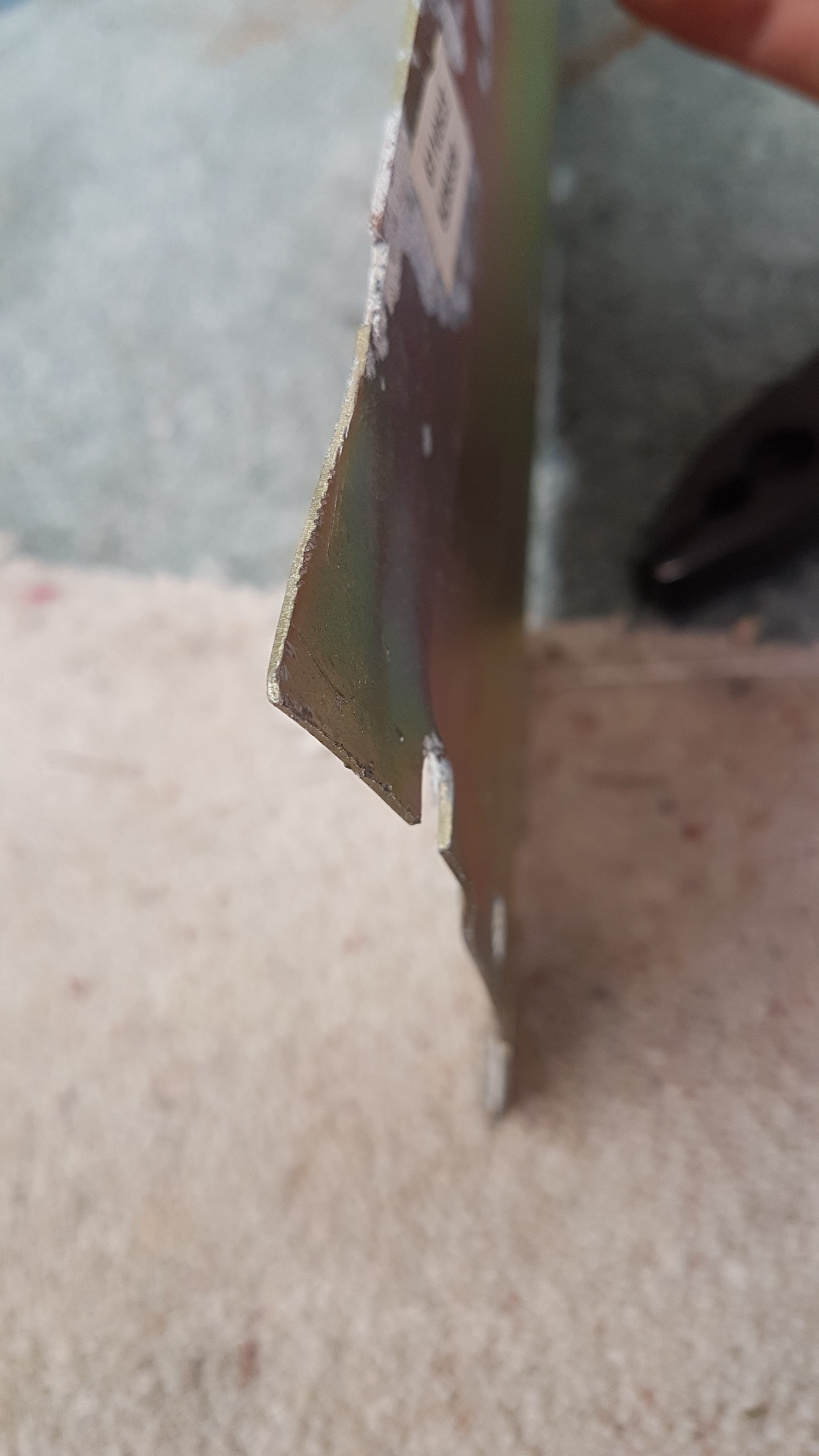

The bottom plate is also bent in the corner (if anyone knows a good fix, please let me know!)
bent plate.jpg (956.06 KiB) Viewed 9288 times

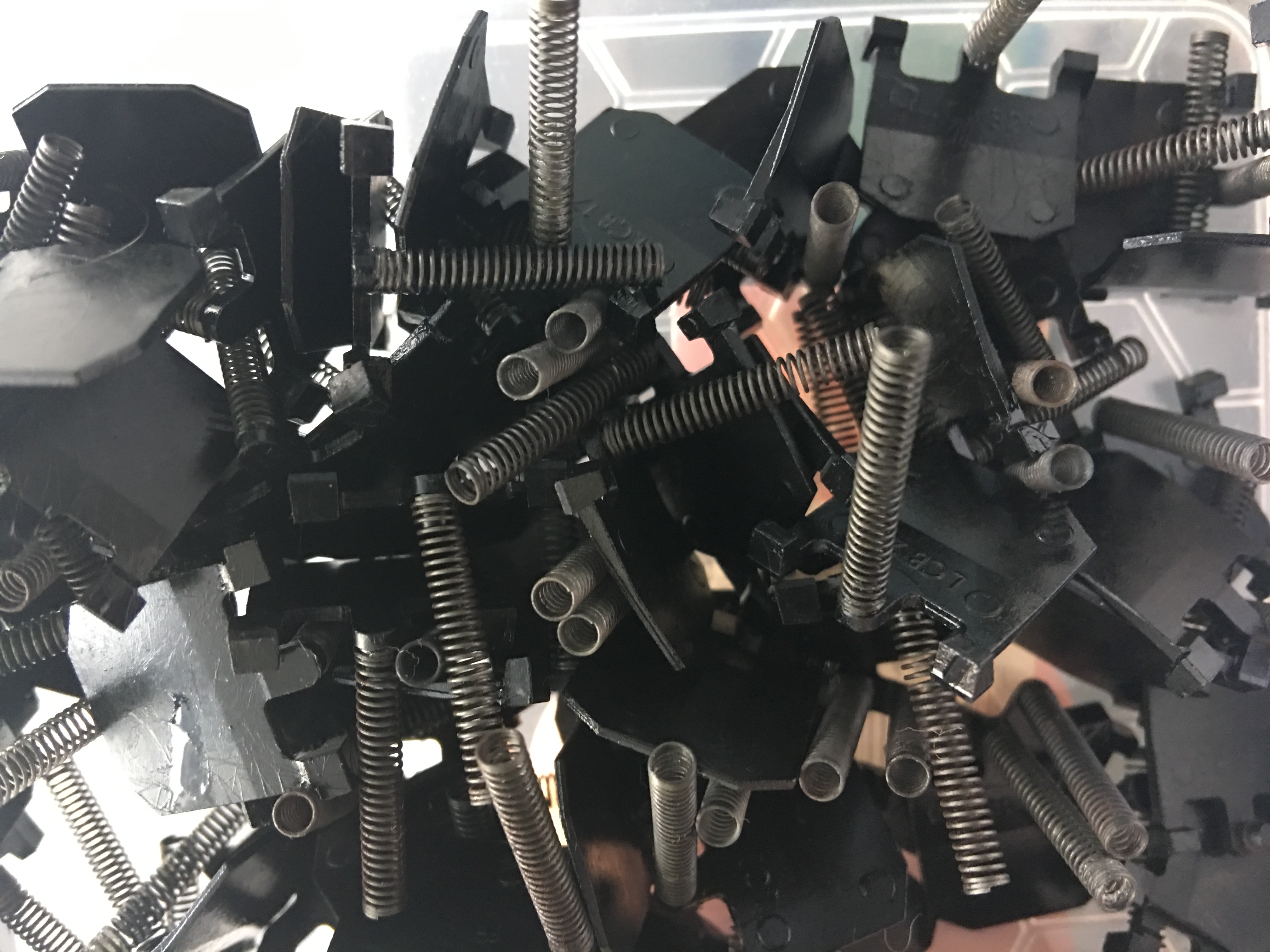

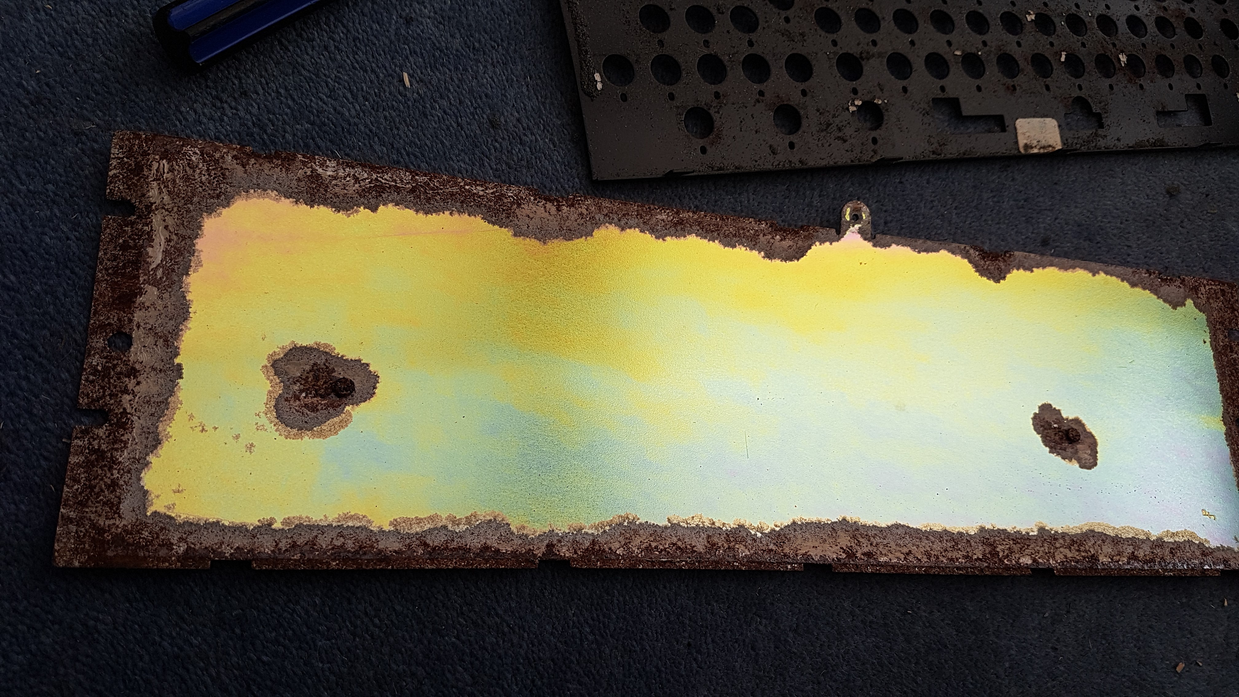

John Doe
04 Mar 2019, 06:34
What I got after Vapor-Rust using, its really like magic, thanks guys.
Aran.E99
04 Mar 2019, 16:42
John Doe wrote: 04 Mar 2019, 06:34 C0BBB33D-7AB3-4839-AA18-C9E723D21AC4.jpeg
Looking good, might try it myself at some point (when I can afford the stuff!)
John Doe
04 Mar 2019, 16:46
Aran.E99 wrote: 04 Mar 2019, 16:42
This is what left after the rust removed. :lol: :lol: :lol:

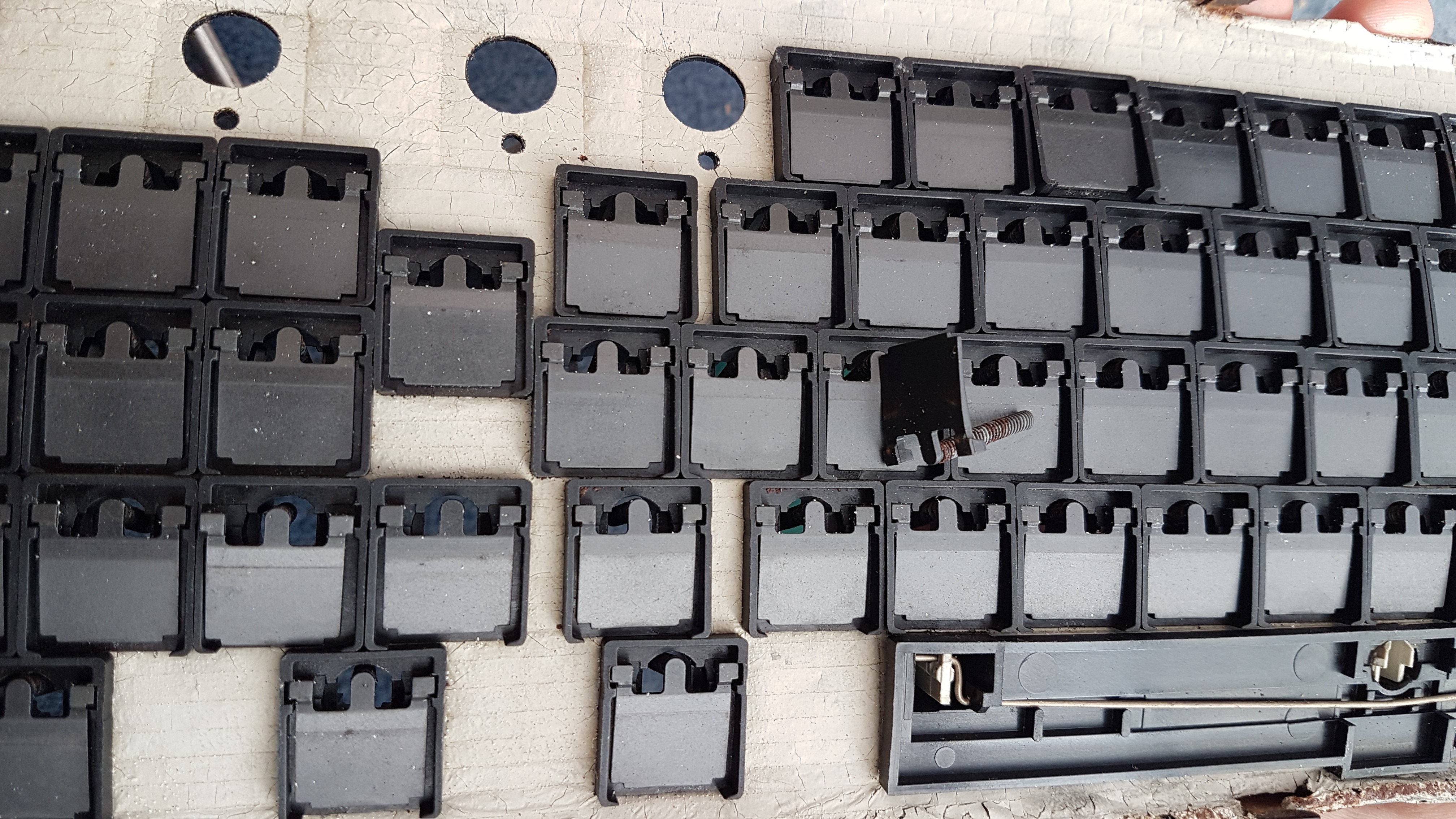

Okay so after placing all the barrels & flippers in, I managed to get everything clamped down. I hammered the plate until it was slid in place. I've noticed while putting on the keycaps that maybe 20 or so springs don't buckle at all no matter how I install the cap. Other keys feel very loose and not responsive and only buckle once bottomed completely out (different feel to the other one I have). I have a feeling this is related to the foam not being of proper tension but I'm not taking it apart again until I get a bar clamp.
05 Mar 2019, 15:16
The "flippers" (pivot plates) have obviously jumped out of their tracks. I was able to open and close XTs a couple of times by hand before I started working on the big Fs, but nowadays I always use clamps.

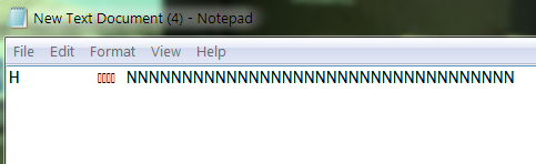

Hooked up my teensy converter I made using an old midi jack and everything worked well in Aqua apart from the occasional key getting stuck and sometimes not registering. I decided to close Aqua and open a text doc to type it's first words in many years. The result?:
oh no.PNG (29.49 KiB) Viewed 9007 times
