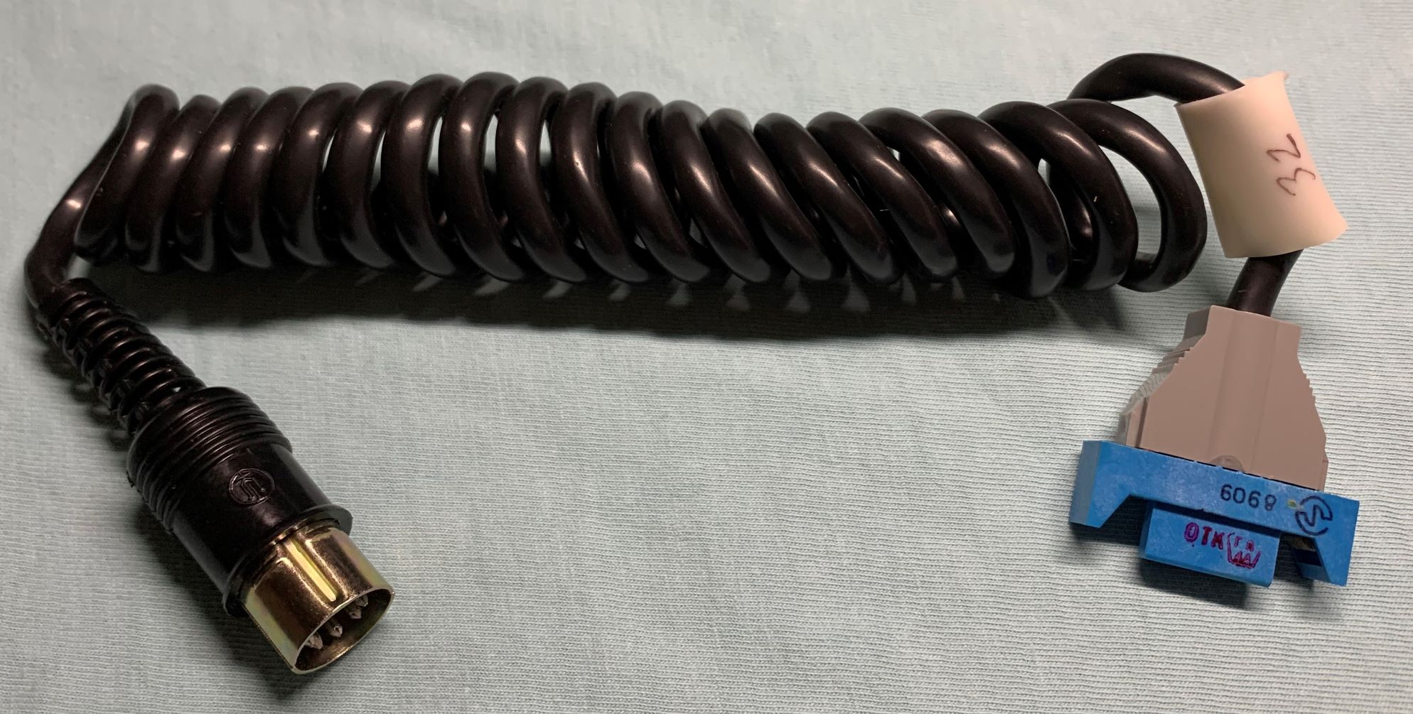

MMcM
31 Dec 2020, 03:19
Believe it or not, the missing cable goes to DIN-5, but implementing the LK201 protocol and not the XT one.
More here.

headphone_jack
10 Jan 2021, 23:57
I just bought one of these NOS. It has the missing cable pictured as well as an operation manual. Hopefully I can convert it with this cable, as it should be trivial if it indeed uses the LK201 protocol. It also has a different case, in a light color rather than the dark color of this one. Hopefully the switches feel better than described here, I might attempt mods to stabilize the keycaps more.
