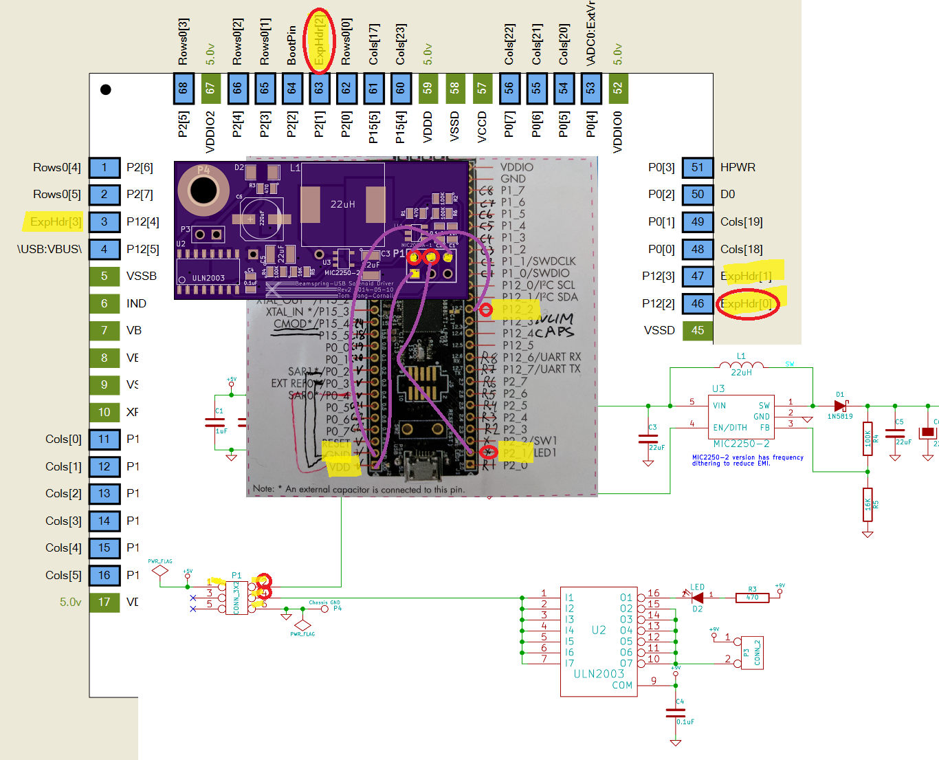

I think there is a typo in this section of the documentation:
ExpHdr (AKA "Solenoid connector")
Configured to blink the kit's LED on keypress. 12.4 is a CapsLock LED, 12.3 - NumLock.
Leave it alone, unless you really know what you're doing. You can permanently damage GPIOs if you fuck up here.
DO NOT POWER ANYTHING FROM GPIOs. Max GPIO source current is 4mA. FOUR. MILLIAMPERES.
So, ExpHdr0(12.3 by default) would be "enable" line, and ExpHdr2 (2.1) is the "fire" line. Delay settings are in "Hardware" section of FlightController. ExpTgl "USB scancode" toggles between normal operations and "all GPIOs are pulled to the ground".
ExpHdr0 should be 12.2 by default now (and otherwise it would be conflicting sentence with the second line where it's stated that 12.3 is NumLock)
So in the end I'd document it also in the picture with the pinout that the solenoid driver should be connected to 12_2 (enable) and 2_1 (fire) so that in xwhatsit's solenoid controller it will go to pins 2 and 4 respectively.
I also have a frankenstein picture of my interpretation: let me know if I understood it all right :)
Kr,
tent:wq

is there anybody able to confirm the above with the now new default 24x8 config?
tentator
26 Nov 2019, 00:34
I just tested it, and can confirm solenoid now works on 12.2! please snacks, can you update?
