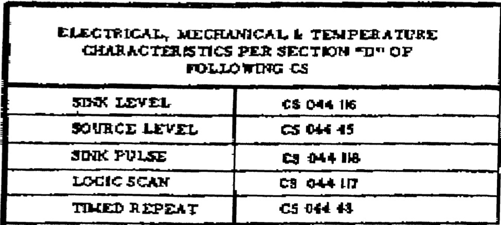

http://bitsavers.org/components/microsw ... odules.pdf
My assumption up to this point is that the two inner pins are separate but identical outputs.
The Micro Switch SD information packet on bitsavers tells a whoooooole different story. This would totally explain why I always am encountering "dead" switches when they're hooked together.

Scan, pulse and hold switches are different variants of these SD switches. You have hold and pulse switches (Or, in wiki terminology, you have sink level and sink pulse switches. Your part numbers for the switches do *not* match the wiki, it seems like for yours the first number is the switch weighting and the second place is the switch output description. The S in the end is just to annoy me, because now I can not tell people that S in the last place are the good ones. )
As for your latest post, are you sure about the matrix? I have a keyboard with hold low switches, and there are no columns and rows there, or rather each output can be a column and a row, depending on which switch it is connected to.
The gist is that each switch has a unique combination of 2 output pins. The controller then only has to check if exactly 2 pins are low, and in that case it can look up the matching key. If zero or more than 2 pins are low then no output is emitted.
If you want to show it as a matrix, then the all pins will be on both the columns and rows, but the switches will form part of a strict lower triangular matrix.

That Honeywell switch guide is really helpful. Do you have any leads on this chart printed on the last page?
Electrical, Mechanical & Temperature
Characteristics per Section "D" of
following CS
Sink Level   - CS 044 116
Source Level - CS 044 45
Sink Pulse   - CS 044 118
Logic Scan   - CS 044 117
Timed Repeat - CS 044 48
Electrical, Mechanical &amp; Temperature Characteristics
Electrical, Mechanical & Temperature Characteristics
Screen Shot 2019-08-20 at 5.17.38 .jpg (117.03 KiB) Viewed 12005 times
The text is tough to read, so, what might be a "11" may in fact be a "4" and vice versa.
