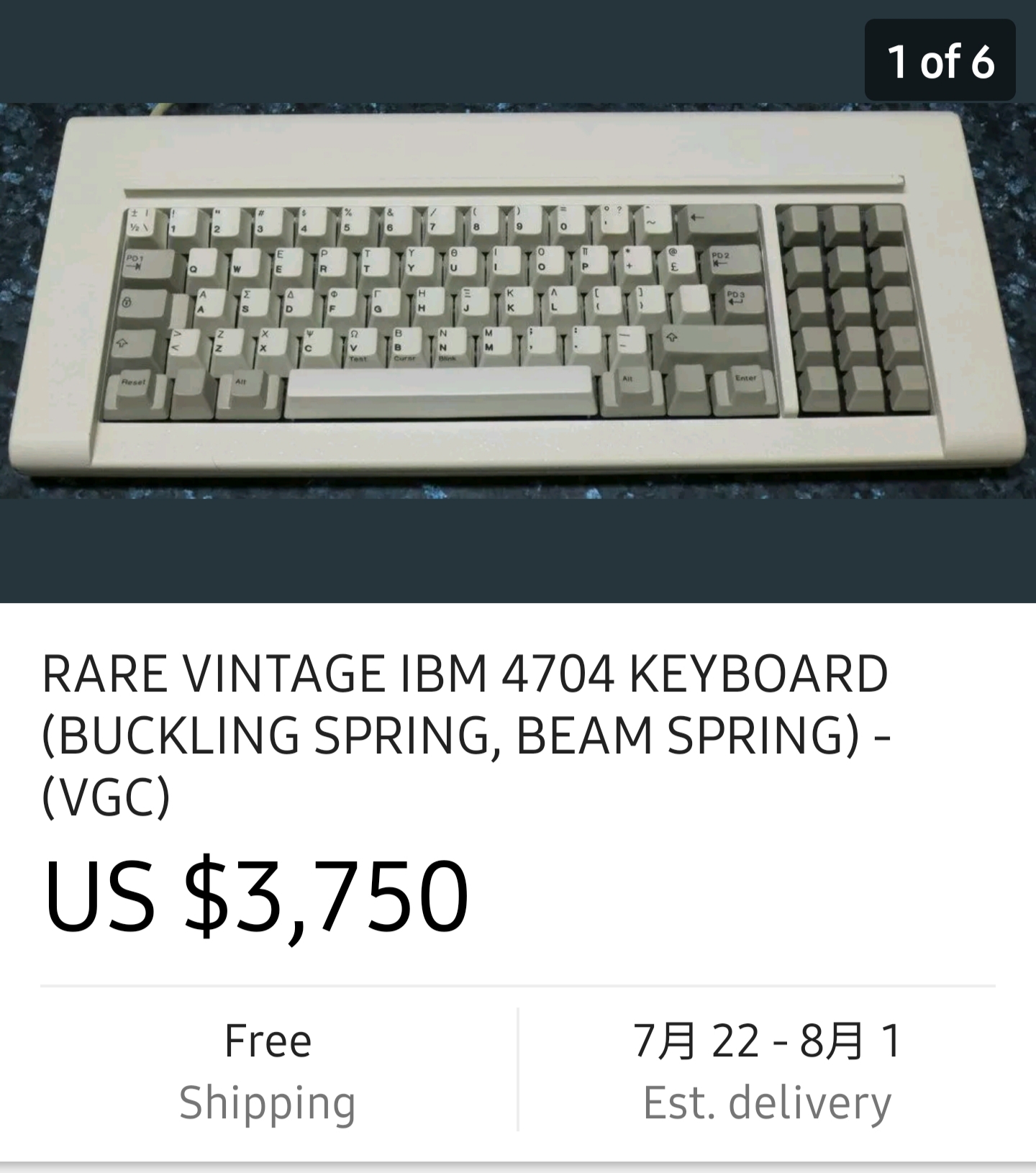

One of these just came up on ebay and instantly sold for almost $4000

Really??? When?

That's scary lol

//gainsborough wrote: 10 Jul 2019, 00:20 https://www.ebay.com/itm/163771082226/
uh..... f77!?
around 15:20 PST, hahaha

Weezer wrote: 10 Jul 2019, 04:07 One of these just came up on ebay and instantly sold for almost $4000
Where? The only one I saw is still sitting at $5000 unsold.
User101
10 Jul 2019, 04:56
Anyone wants to see the sale here it is.
