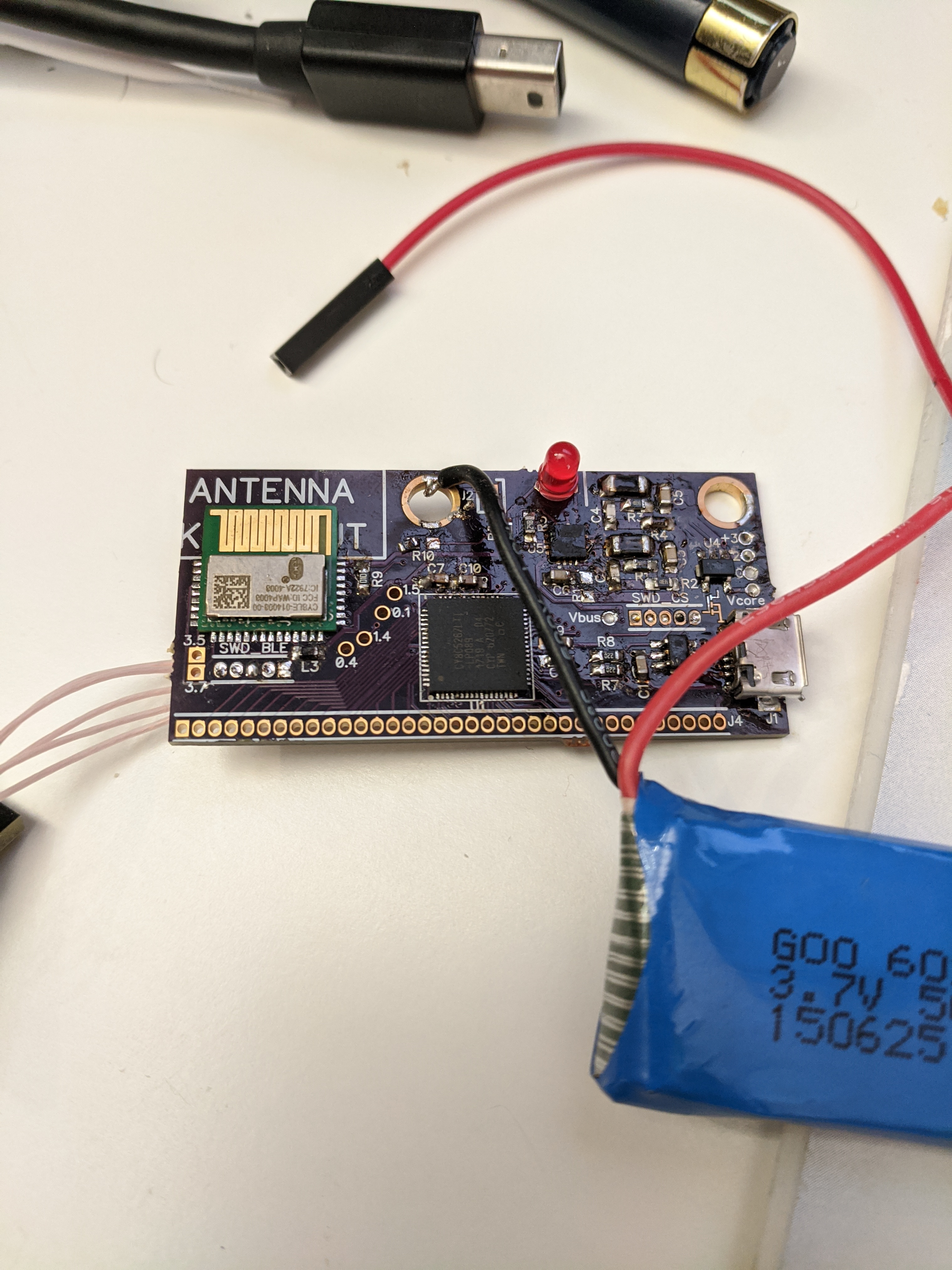

Sure, but I need to actually go and integrate BLE for reals first.

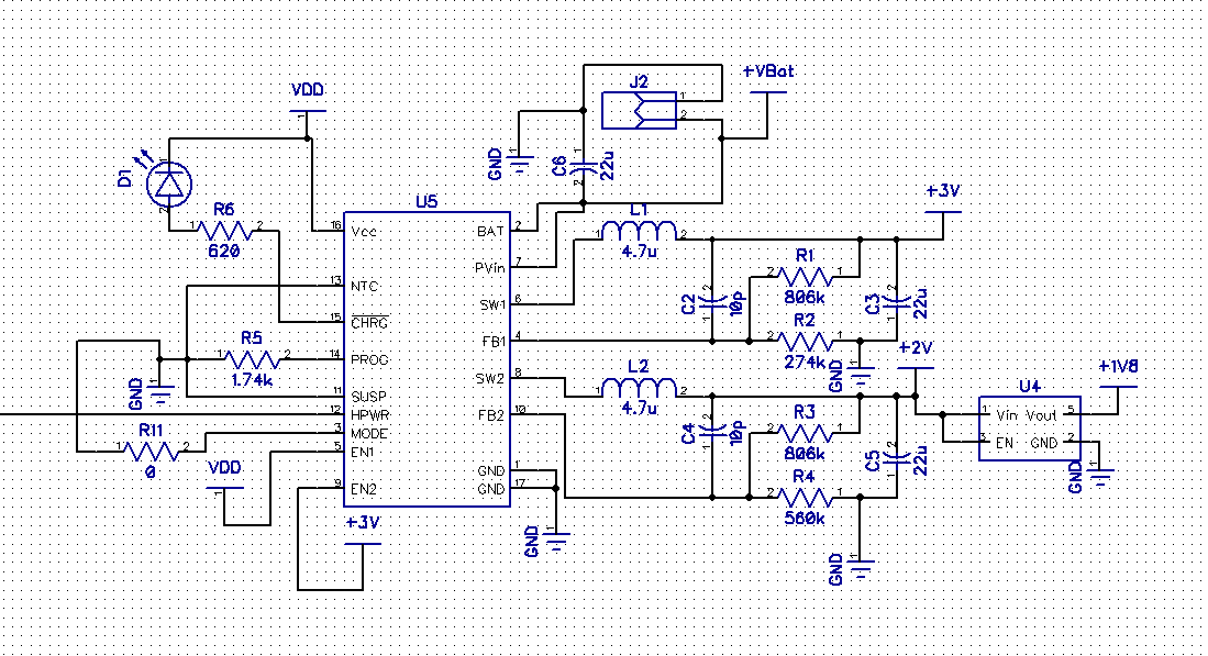

I have a board with two bucks (3v3 for keyboard and 2v1 for radio) and LiPo charger, QFN PSoC5 and a BLE module (which is not even programmed), and I have 2 cypress kits (058+143) jury-rigged into a CS-BLE - which kind of works, but requires pressing buttons on the 143 to pair to the device, so quite far from prod-readiness.
3Ah should be enough for like a month - IIRC 500mAh was good for ~20h full bore operation. My worry is current power controller won't be able to get anywhere near 600mA recommended current.
Also not sure it's time to do all that BLE stuff - it looks like cypress plans to release PSoC64 soon(https://www.cypress.com/products/32-bit ... -m4-psoc-6) - and that will allow for a single-chip USB+BLE.
Which will be awesome, but will require some serious rework of everything - software, power, 4-layer PCB for the BLE antenna.. 0.9V _might_ be too low to drive sense card..
Although they promise that for 2+ years as of now, so not sure if waiting worth it.
Isn't that a maximum recommendation for improved lifespan? I can't recall ever seeing a minimum mentioned, only fast charging negatively affecting the life.
I'm curious about your power controller if you don't mind sharing.

Ah, yes, the power management. Almost forgot.
3V: VddIOVddD (Lowest allowable for USB operation) & VddA (must be highest voltage on the chip)
2V VddR (radio) & VddIO
1.8V: VccD/VccA (PSoC5 LP cores).
PSoC5 LP internal LDO turned off to save power.
This is kind of ridiculous, but I almost lost the BOM. Almost. Luckily U5 properties contained the name.
U5: LTC3559EUD: https://www.analog.com/media/en/technic ... 3559fb.pdf
U4: MIC5504-1.8YM5-TR: http://ww1.microchip.com/downloads/en/D ... 06006B.pdf
Lessons:
1) NO QFN. Or rather "No PCBA = NO QFN".
1.5) castellated edges on subassemblies is a must
2) Stick to 100mil pin pitch.
Prototype 0 looks like this (WARNING - 4 MEGABYTE IMAGE):
Main MCU looks programmed (SWD headers are tinned but empty). Must be that "BLE01_USB" project.
Upd:
Battery still holds some charge.
Current consumption from battery - 20mA.
Device is discoverable as "CommonSense", but doesn't want to pair to my android phone.
Main MCU is indeed flashed, presents as a 8x16 beamspring.
Judging from all matrix cells reporting 255 - I screwed up ADC Vref traces. Not the first time.
You have a heart strong enough to power all of Iron City for years. This is lost technology. Nobody's made this stuff since... before The Fall.
I literally don't remember making this.
Upd2: updated power rail usages.
Looks like I didn't screw up the Vref after all. 5267 can only use P0.4 as ADC Vref, and I routed for P0.2. Luckily, P0.4 is routed to the edge connector and this is easy to fix.
