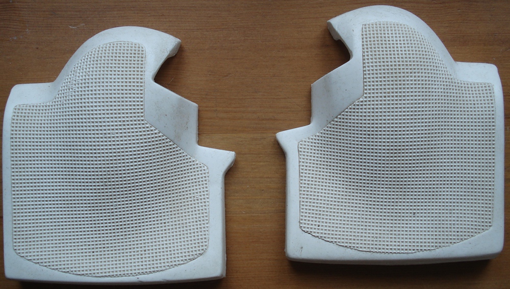

input nirvana wrote: Can you show a top side of the palm rests? They don't use the threaded insert anymore, it just has a locator nub. And they aren't scalloped out on the bottom, just solid material, and very heavy. I am going to try and replicate the palm rests with a mold so I can copy my 'large' palm rests for Hoggy. I think it's just a silicone or latex, but I don't know.
Sure, here you go.
datahand palm pads top

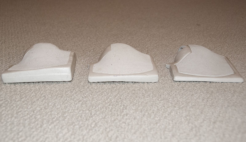

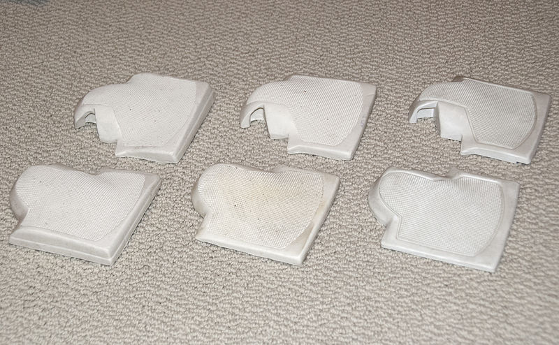

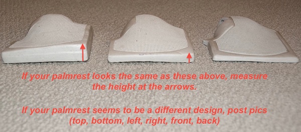

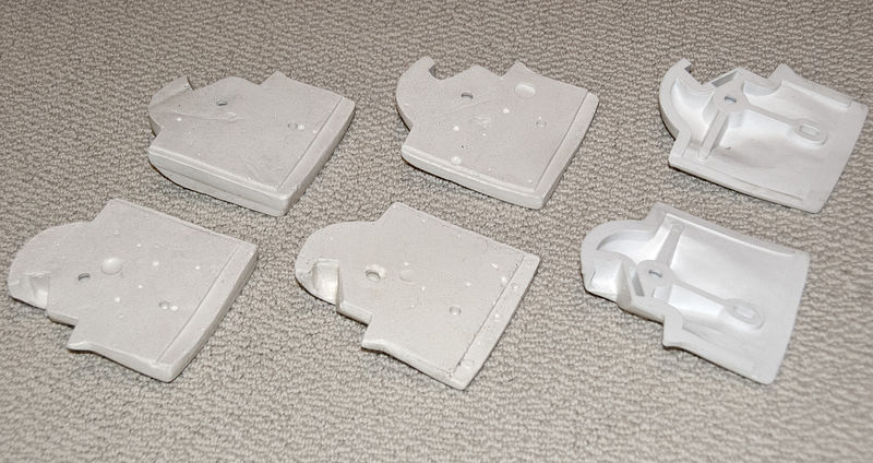

*****I HAD TO EDIT THIS PALM PAD INFO...I HAD INCORRECT INFORMATION REGARDING SIZES AND THE GROOVY-GROOVE*****
PALM PAD STUFF (for the more modern Datahands (Personal, Pro, Pro II)
- Sizes: Small and Large. But there is a smaller, undocumented palm pad that is Xtra Small.
- Attachment: Threaded insert now just a ball-shaped nubbin. (this change affected the Datahand unit itself as well).
- Design: Cross-hatched top, some have cross-hatched top with a deep groove around the perimeter of the cross-hatching
(not completely sure of this, maybe only the xtra-smalls have the groove, but minor detail and won't affect me molding replacements for people)
I am fixated on the palm pads only because it seems to me that the palm rests are important as part of the fit of the Datahand, and being close the the best size is of some importance, especially for RSI prone individuals. Datahand currently doesn't have large available, small being the only option at this point. Since purchasing used is the only option, it's rare someone has both sizes (I know for a time around 1999 Datahand would send Small and Large with a purchase) and it's a 50-50 shot if it comes with the best size for you.
<I don't really know where it's best to post this, I'm not trying to hijack your thread but I think it has value for some RSI inflicted persons. And since you are documenting tearing yours apart and modifying, it seems you may have an interest as well. Your photo thread may become a repository for some unique Datahand info on the web. Who knows, maybe you need a different size too? Using the pics below, which size do you have?>
Here are some pics Geoff sent me of the 3 sizes of palm rests, and the couple styles. I don't know when (serial #) they changed from the threaded insert to the locator nubbin. In one pic, there is an xtra-small with a scalloped underside and a groove. I had an xtra small, scalloped underside with the groove (circa 2009) and now have a large with no groove and a locator nubbin, so who knows? The groove doesn't matter but having a threaded insert or nubbin affects attachment. (The photos are labeled S-M-L... but that's not how it is....XS-S-L would be more correct).

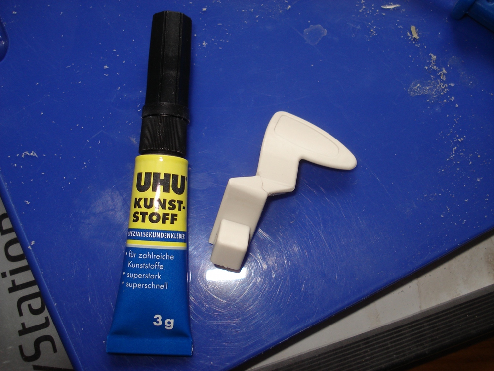

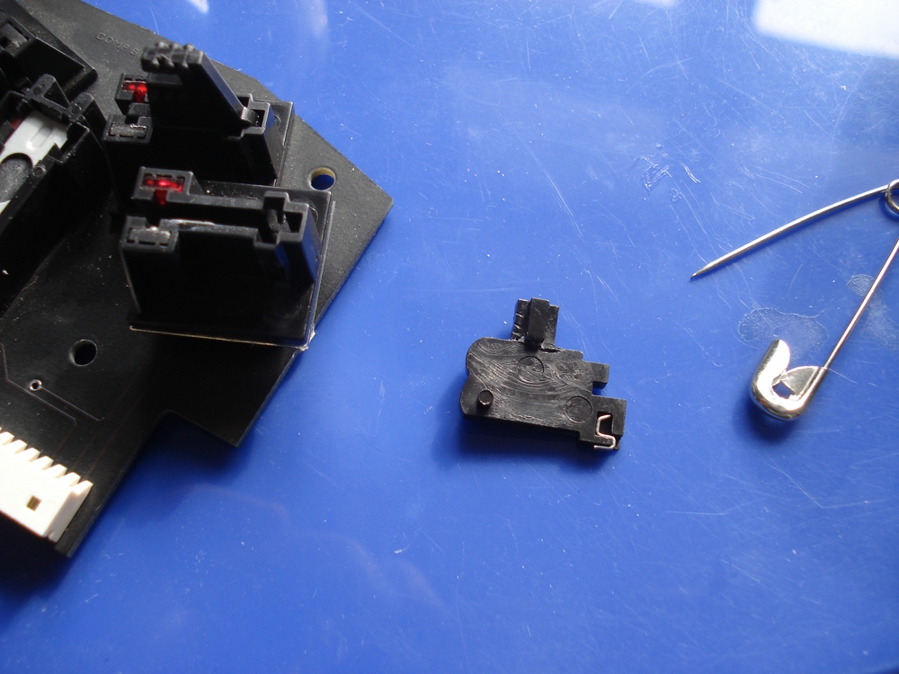

Aaaaalright... I have put it back together.
a few notes on that:

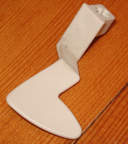

This is the switch part that was broken. I glued it but as you can see there is still a little gap there because the plastic was so bent.
I immediately broke that again when putting it back together. It is higher then the rest of the board so if you drop something on it or put it down the wrong way around ...boom.
There might be some clever way to fix this since it only needs to actuate upwards so it might bend in the opposite direction.

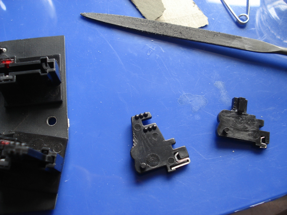

I used the needle to get the stem out, again gently but determined will do.
One of the other switches kept sticking so I took it out and sanded down the sides, works fine now
This is the lever that I glued and the glue I used. The glue worked really well!
I also added a little extra plastic to the bottom to make it a little sturdier. It's pleasantly invisible on the assembled unit.

The broken stem seems to hold up fine but otherwise I would probably try to contact the guy whose website was linked to above. He seems to have a bucket of datahands for replacements. But as I said it's fine, that glue is really awesome. :)

"There are two sizes of palm rests available: small and large!"
heehee
Seriously though, input nirvana if you could make copies of the different palm rests that would be awesome. I would love to try them out.

I'm going to get a pair of large palmrests to Hoggy, the man paid so much for his Datahand, he deserves a "large" hand! Get it? Get it? Huh? :)
I'm hoping to have some routine aspects of my life settle down very soon. That will allow me to rejoin the human race and do cool things again...it's been a while since I've had a real smile on my face. But that means a period over the next 1-3 months.
I'd like to figure out what the palmrests are made of (latex, silicone, or whatever) and then try casting the large I traded for since Datahand doesn't seem to have any more as of last summer. I have been motivated to do this since I saw the "Make your own key caps" thread on GH. Did you look at the side view to determine what size you have? Maybe take a height measurement at a specific location and we can compare with my known 'large' and Hoggy's to figure it out.
EDIT-
I was thinking of making the palmrests from black material...for obvious reasons.
Datahand palmrest measure.jpg (68.89 KiB) Viewed 6576 times

Oh well,
It looks like I've already got the large pads. Mine are clearly the same as the one on the right.
It's about 5mm.
Black sounds like exactly the right choice, I'd be interested in a black pair, even in the same size.

16 Apr 2012, 22:07
I definitely have the leftmost ones...
