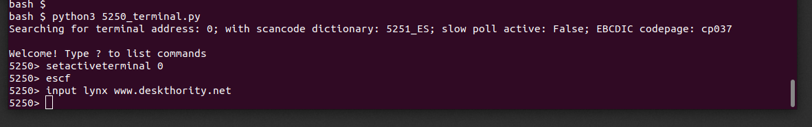

The structure of the Python program (5250_terminal.py) is as follows:
  • The program starts a thread to manage the serial port communication, to and from the Teensy. That resource is shared between all the managed terminals.
  • One thread is started for each managed terminal that starts a shell process and captures its standard input and output for that terminal.
  • The output generated by the shell process (character stream) is captured and converted to a 5250 command sequence. For that, the program makes an ASCII to EBCDIC to character conversion for standard text characters, and for the control characters (ASCII and Escaped) it converts them to 5250 commands that emulate the control character actions in the 5250 terminal. So a character stream is converted to a command sequence for the 5250
  • The input received from the 5250 keyboard in the form of keyboard scancodes is converted to ASCII character data, that can be regular text characters (uppercase, lowercase or "alt" depending on the status of “shift”, “alt” and “caps lock” keys) or escape sequences if we press the configured “control” key plus another key.
  • The main thread ends up displaying a command prompt where the user can execute some administrative and debugging commands, like restarting a terminal, sending commands to it or sending text input to the shell (the same as typing it in the terminal)
Conversion program command prompt
I won’t give here a full description of the VT52 escape codes, but as an example this is how the ESC_E escape code is converted to 5250 commands (ESC_E is clear screen, that we will receive from the shell as the two-character sequence 0x1B 0x45 in Hex):

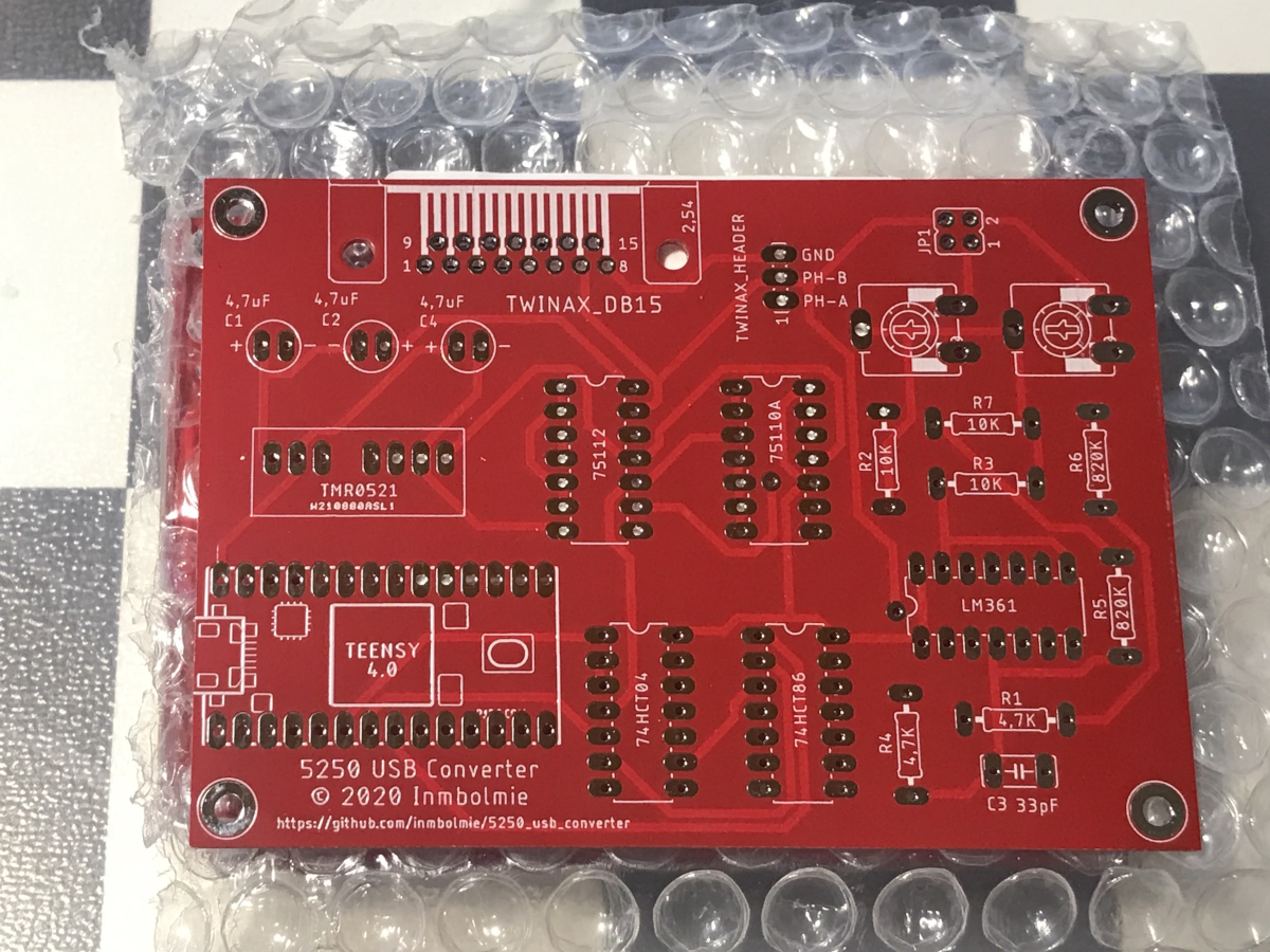

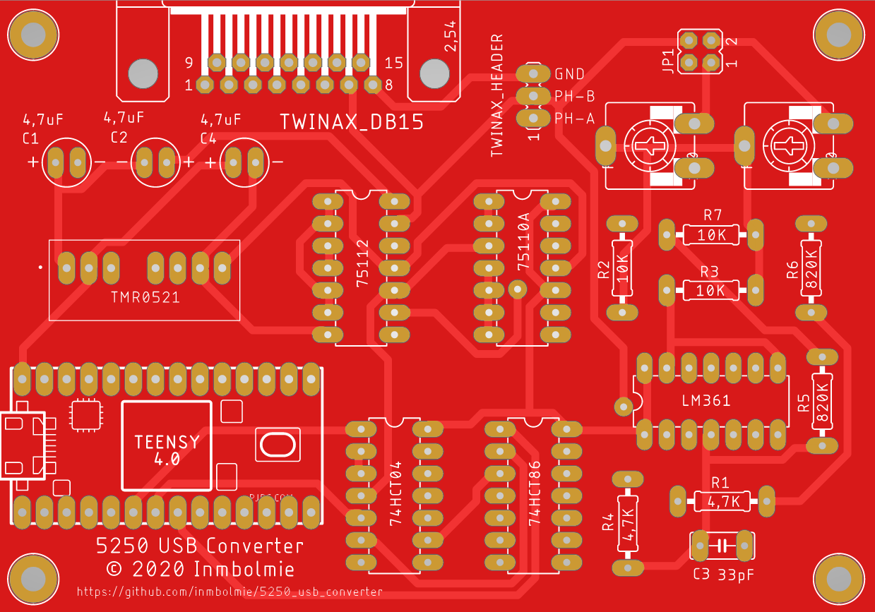

I've uploaded the PCB files to the repository. So now, "version 1" of this project is ready and anyone with a desire to do this by itself has all the necessary information published.
The final result looks like this:
I've also been finally able to test the converter with real Twinax cables, and it works fine, at least with short cables.
I think I'll make a small order of PCB's to some professional manufacturing service. For making like 10 pieces there are very cheap providers nowadays. Although the "self made" PCB works fine, soldering the components on a two layer self made PCB is a torture and the result not very aesthetic.

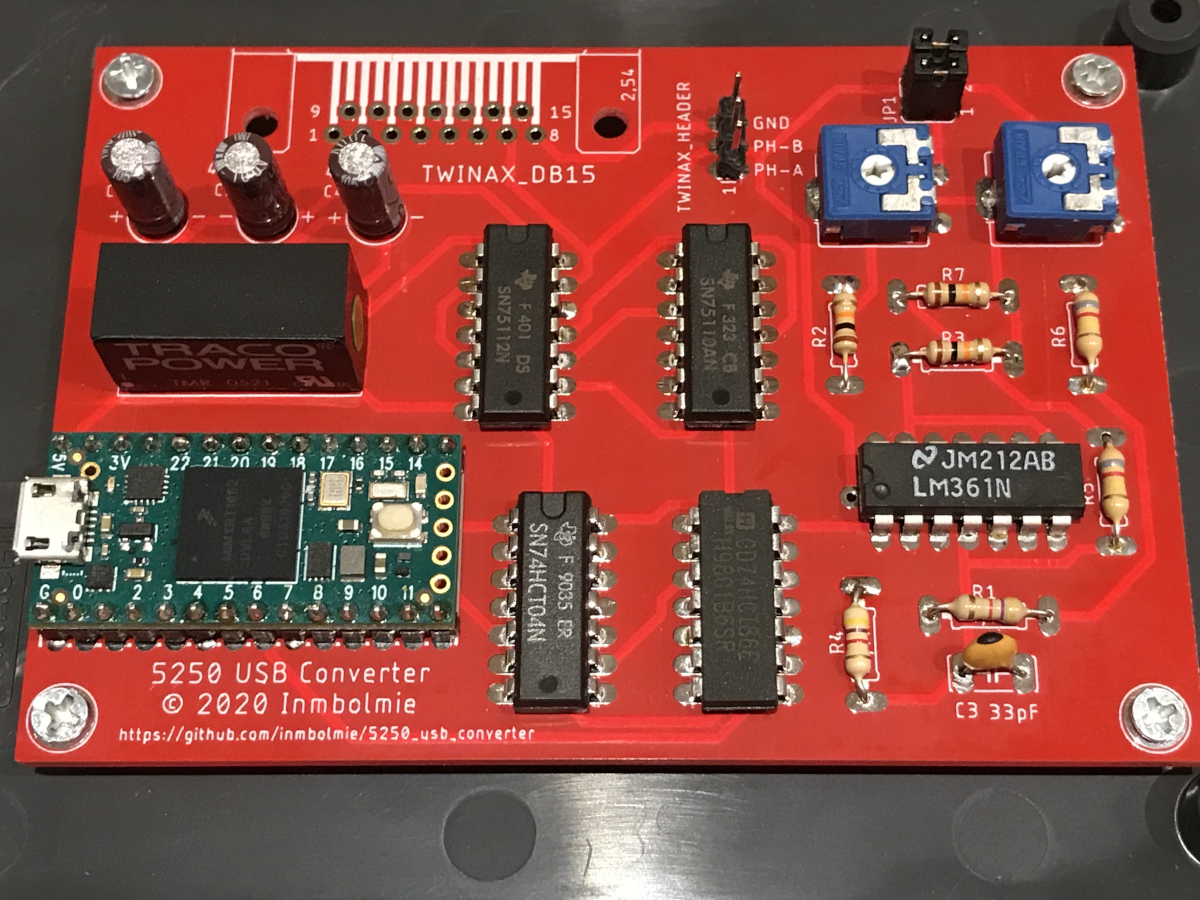

23 Jun 2020, 20:49
I have received the final PCB boards, much more pleasant to look at that the DIY thing.
Assembled board
Everything works fine with them, there are no layout errors in the final design so I feel that for a first version, this project is finished and is sufficiently documented. I will close now the production of a small batch of converters with the people that have showed interest.
After that, if anyone is interested in a spare PCB for making its own converter send me a PM.

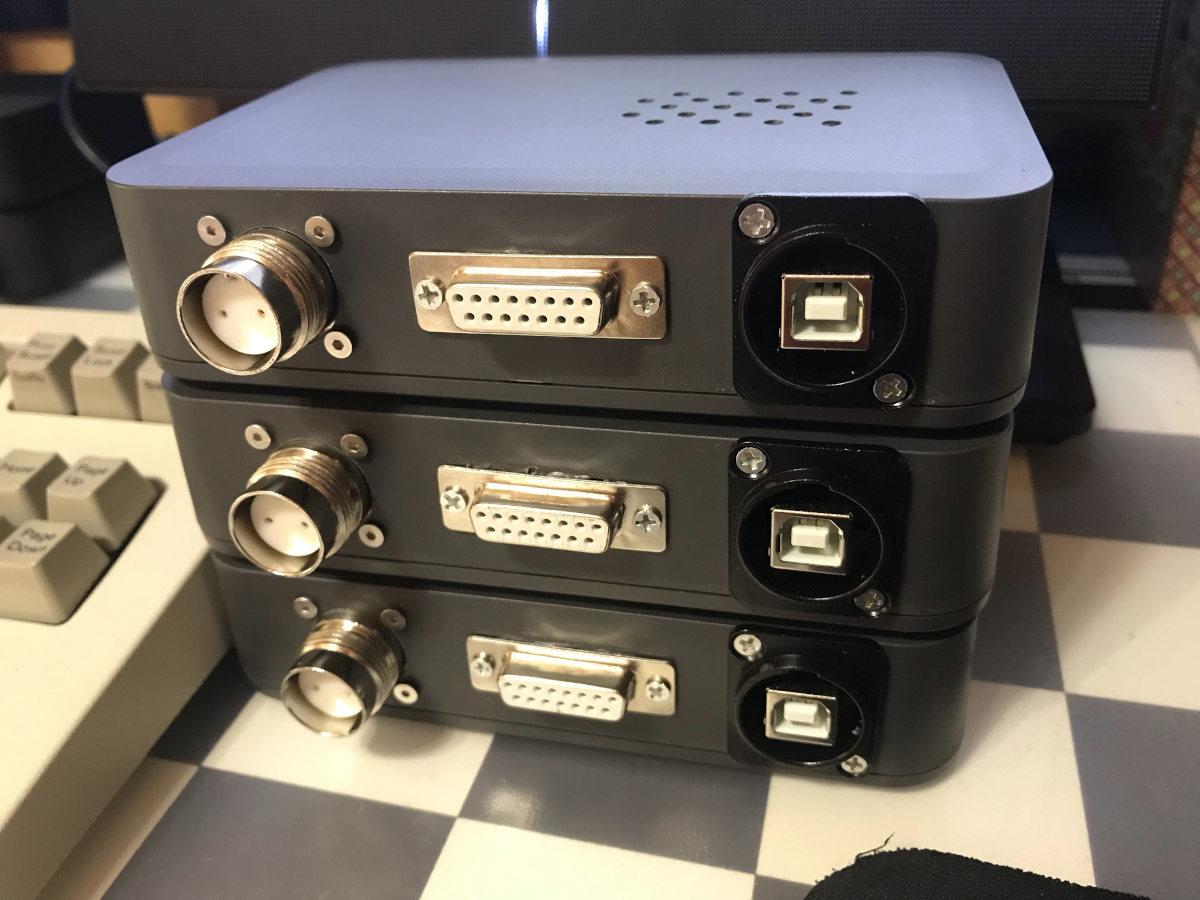

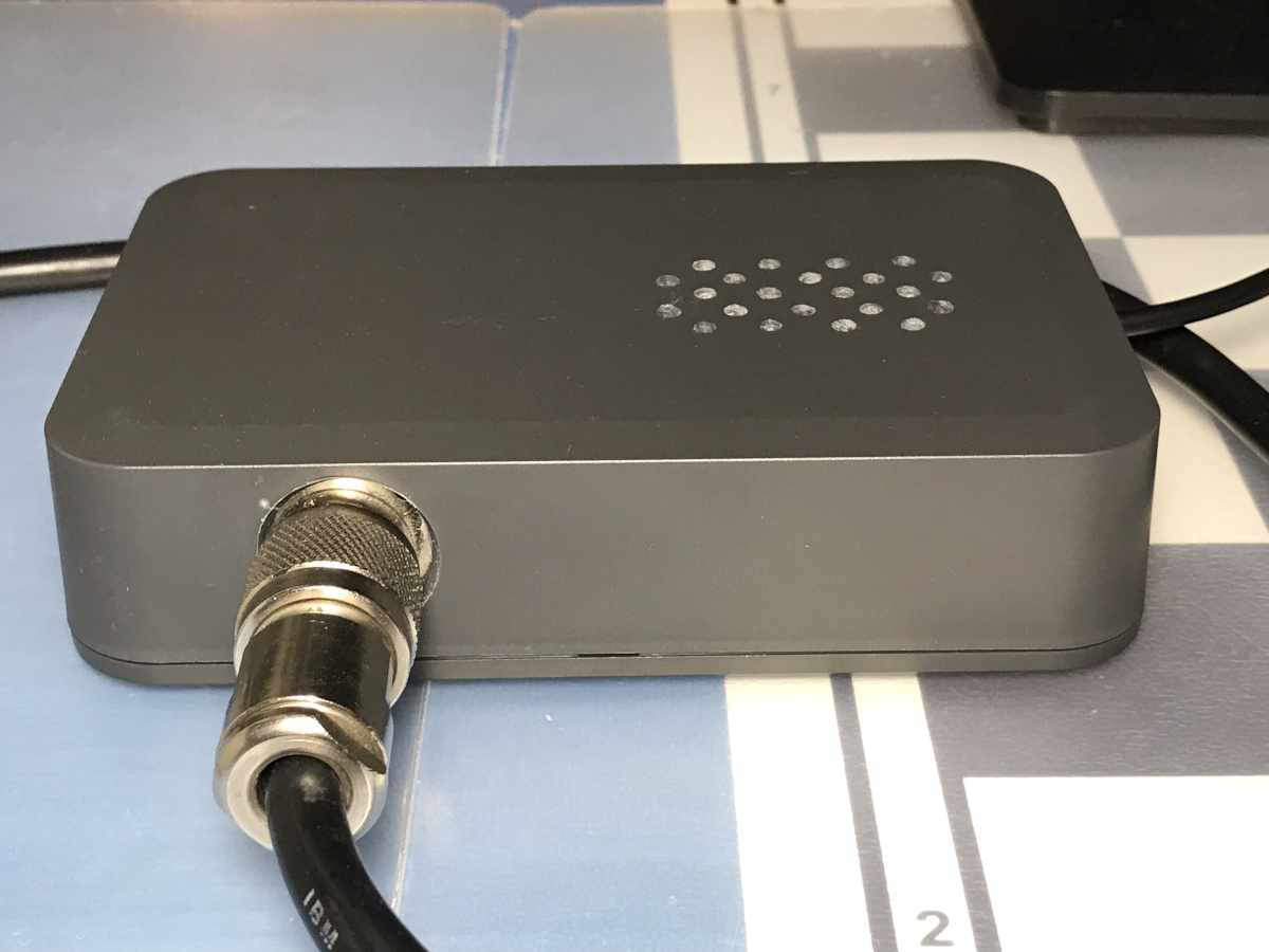

BTW I’ve decided to put a USB-B external connector in the box. The twinax connector and its attached cable are so sturdy that I feel that the micro-usb connector is a joke in comparison, mechanically speaking. I fear that in the long term the micro-usb will be ripped up by the tensions generated by the twinax cable, so a stronger connector is needed.
I’ve also added some vent holes as the DC converter becomes quite hot inside the sealed box. I’ve tested it for 12 hours of continuous operation without a glitch.
Later I will post a video showing the current performance of the 5251 terminal with the converter.

inmbolmie
08 Jul 2020, 23:21
Also I want to comment that the first (and probably last) batch of converters is now closed, but I have spare PCB's if in the future anyone is interested. But it is so cheap to order that online nowadays that going directly that route is also a good option.

I noticed you have either a panel mount or a pcb mount twinax connector on your boards there, got any part numbers? :D
inmbolmie
01 Oct 2020, 09:27
listofoptions wrote: 01 Oct 2020, 02:11 I noticed you have either a panel mount or a pcb mount twinax connector on your boards there, got any part numbers? :D
Sorry, no part numbers nor any markings whatsoever, just generic parts picked randomly off Ebay.
