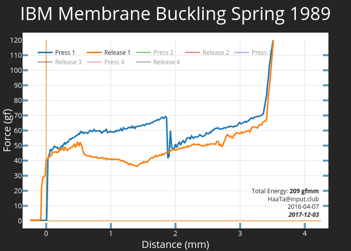

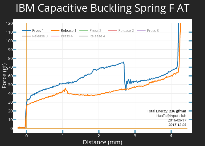

Hypersphere
26 Jul 2020, 15:45
Here are the closest quantitative comparisons I could find between Model M and Model F switches with respect to peak actuation force and total energy (area under the force-displacement curve). These were each measured by HaaTa:
According to these measurements, the peak actuation force for the Model F (measured on an F-AT keyboard) is about 75gf and the total energy is 236gfmm, whereas the peak actuation force for the Model M is about 70gf and the total energy is about 209gfmm.
Of course, each of these measurements is only an "n" of one (1), so that no statistical inferences can be drawn. However, if these curves should turn out in further measurements to be representative of the two switch types, I suppose it is possible that there are subjective factors about each switch that might give the impression that Model F switches are lighter than Model M switches. For example, these curves apparently do not reveal the relative "scratchiness" of the switches.
gianni
26 Jul 2020, 16:14
So these graphs show that the model f is lighter.
Having used cherry switches for a long time, I feel that the "initial" force, the one that makes the switch move in the first steps, is quite important, probably more than the actuation force. In this case you see that the model f is about 10 grams lighter. The same happens with reds, and silent reds. With the same spring, the normal red is lighter in the first microsteps of the movement, and this makes a big difference.
I've found that many haata graphs are wrong, but he refused to retest them. Not because of laziness, but because he didn't have more switches to test.

Hypersphere
26 Jul 2020, 16:53
@gianni: I definitely agree with your qualitative assessment of the sound and feel of Model F vs. Model M switches: "The F feels more precise with a sharp metallic click; the M feels raspy with more of a plastic on plastic sound." This is exactly how I would sum up my impressions of the two switch types.
26 Jul 2020, 17:03
gianni wrote: 26 Jul 2020, 16:14
The key travel on the F also feels shorter than on the M,
Doesn't the graph show that the stroke of the Model F is almost a full mm LONGER than the Model M stroke?
