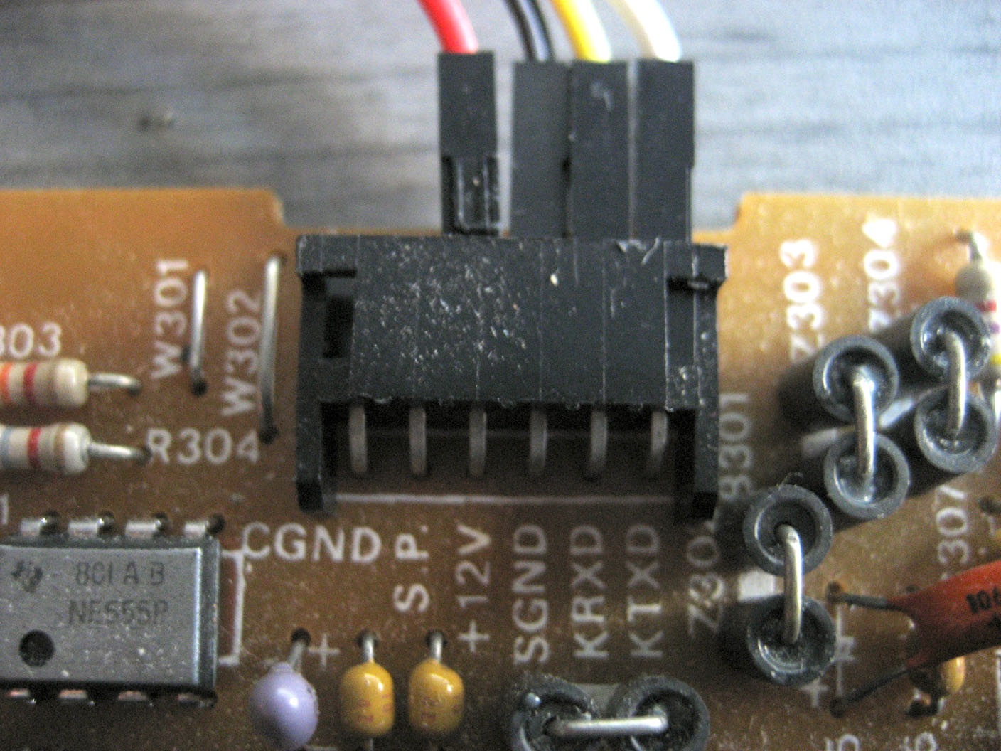

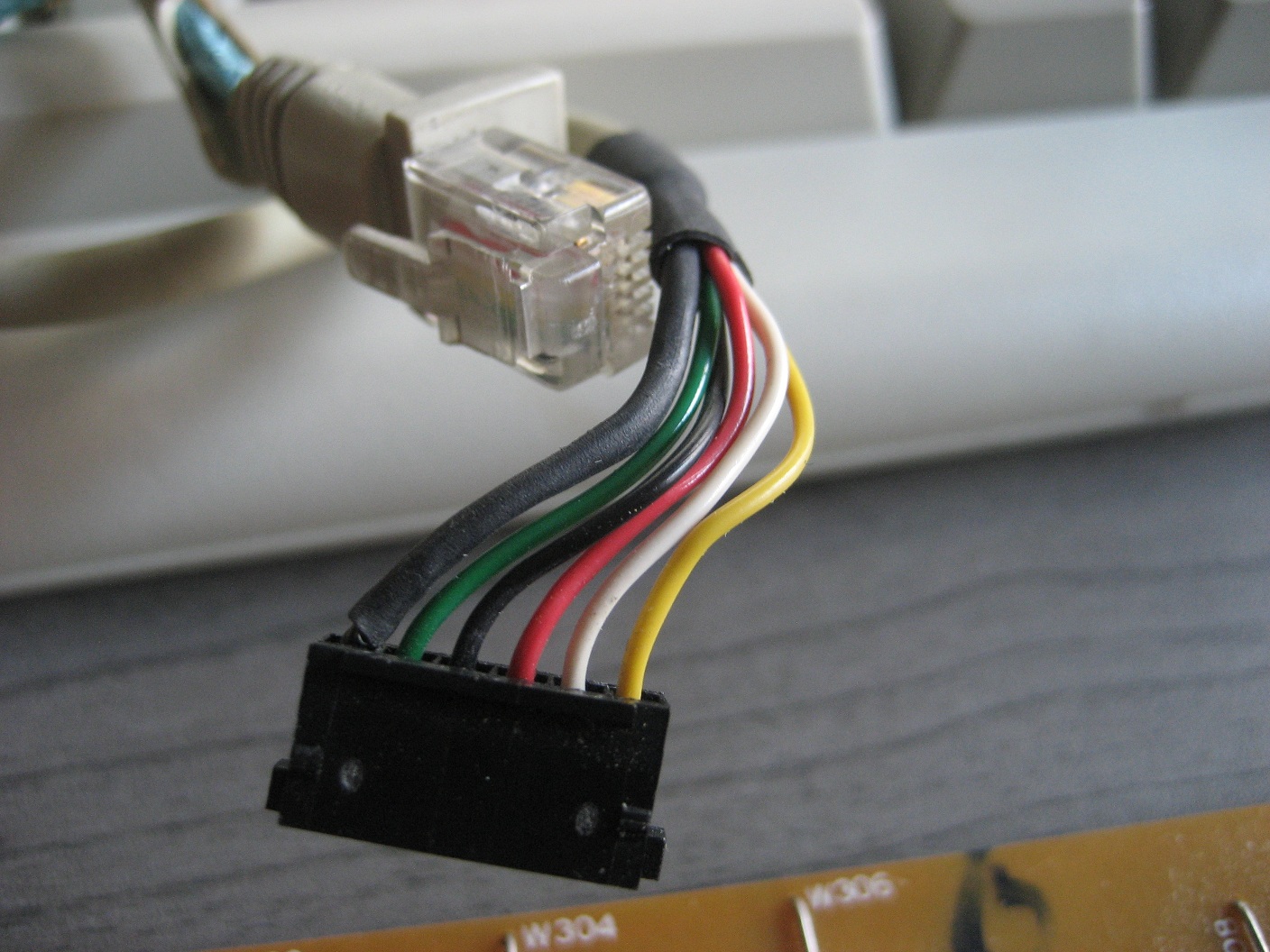

As the uninitiated, soarer's converter sounds like a protocol converter, so you'd have to figure out the protocol and mess with that; a lot of good fun to be had I'm sure.
Other option (as sixty(?) wanted to go for) is to birth the board a new controller- disconnect the lot, reuse the existing matrix (or build your own) and connect that to for instance that teensy, upload some keyboard hid firmware and tweak to fit (and setup some layers perhaps).
Soarer
09 May 2012, 20:22
dirge wrote:You're much better at this type of thing so would you offer some advice on how I could start getting this http://keyboardporn.com/mx-switch/wyse-wy60-terminal/ converted?
Just need to know how to start, have breadboard, teensy2, female connector for the WYSE. I'll try not to be a massive pain in the arse :)
I'm going to assume for now that its signalling is something like the two shown on kbdbabel...
It will be quite hard work, I think. The problem is that it runs pretty quickly, so the code on the Teensy would have to keep up. Responding to an interrupt reliably within 17uS is actually quite a challenge, since every other interrupt routine has to finish within that time (mainly this is the USB interrupts). That can only happen reliably if they are written to not block other interrupts. That said, it's not impossible.
It would be far easier to replace the controller though!

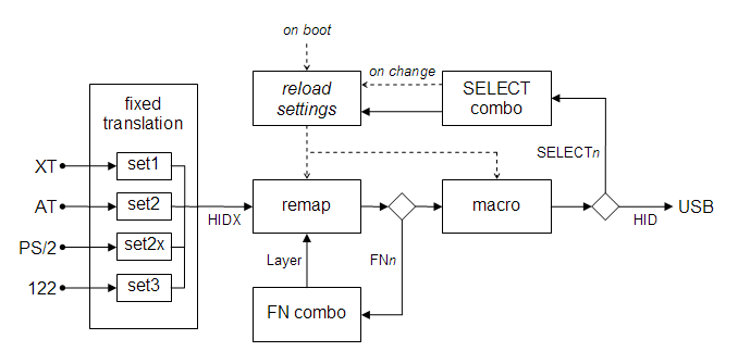

In case it helps understand it, the macro stuff happens distinctly after the remapping stuff, and the layers are part of remapping...
Macro triggering is complex enough already, so I'm reluctant to add more to it by combining those blocks!

I use the double-shift myself, in the base layer, and find it feels quite logical. But, indeed, Fn + NumLk would also make good sense :)
There is some logic behind the way it works at the moment - in effect layers just give you a bigger virtual keyboard, and then you can define which keys of that bigger keyboard trigger macros. I admit though, it does fail on modifiers, as in your example.
I could add a bunch more fake HID codes, perhaps called MACRO_1 etc, that you'd use to remap to if you just wanted the keys to trigger macros, so config files remain readable. (You'd still have to write the macro trigger etc). Although it's not really any different to using some of the strange (and unrecognised by Windows) codes such as EXSEL, it would make more codes available for such use. And/or I could allow numeric codes to be used. Either would only need changes to scas (and scdis); the converter itself would already handle them just fine. Still doesn't cope with your example though :lol:
