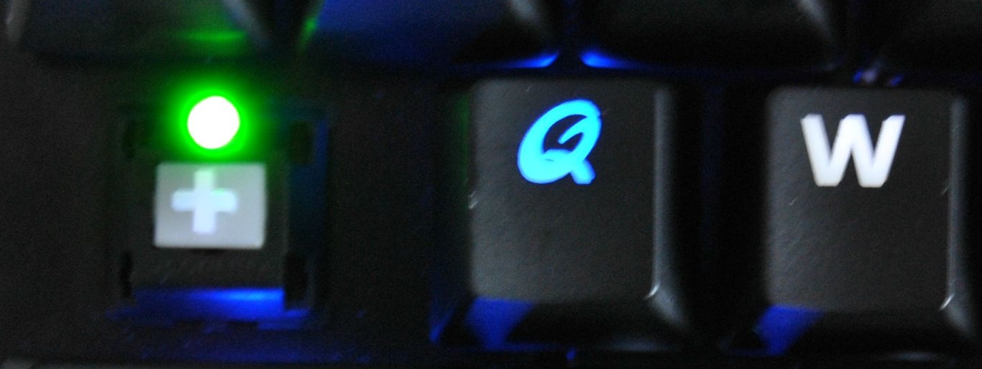

I'm done with this f*cking keyboard now. This was the worst mod I've done in my whole life, Qpad raelly did e verthing they could to make this board hard to mod, the LEDs were really stuck there. But oh well, 40 hours later I got this:
I still got some work to do tho, the number 1 on the numpad doesn't light up and the key "a" shatters.

And I haave to say that Ergoclears on a plate mounted board is WAY different then ergoclears on a PCB mounted board, the tactile feedback is atleast twice as big.. Feels kinda strange.
