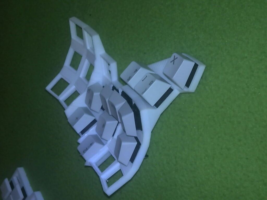

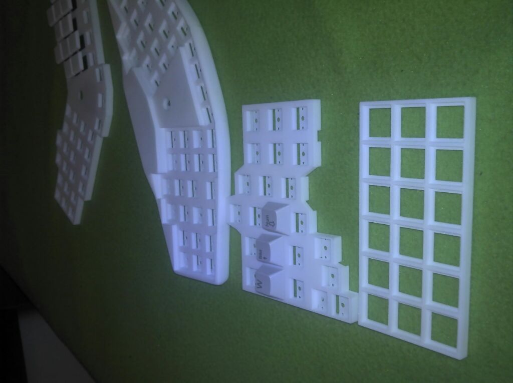

Well, I wasn't so sure when you mentioned it but you're right, I first had ML designs with wider MX spacing before shrinking it down and thus making it a lot less desirable.
uploadfromtaptalk1335475704210.jpg[/attachment ] Another promising design I never followed any further as complicating the layout with additional depth per column seemed not so much better than the simpler alternatives. Tilted thumbuttons are great though, but need to be closer together to be comfortable... [attachment=1]uploadfromtaptalk1335475945226.jpg
off

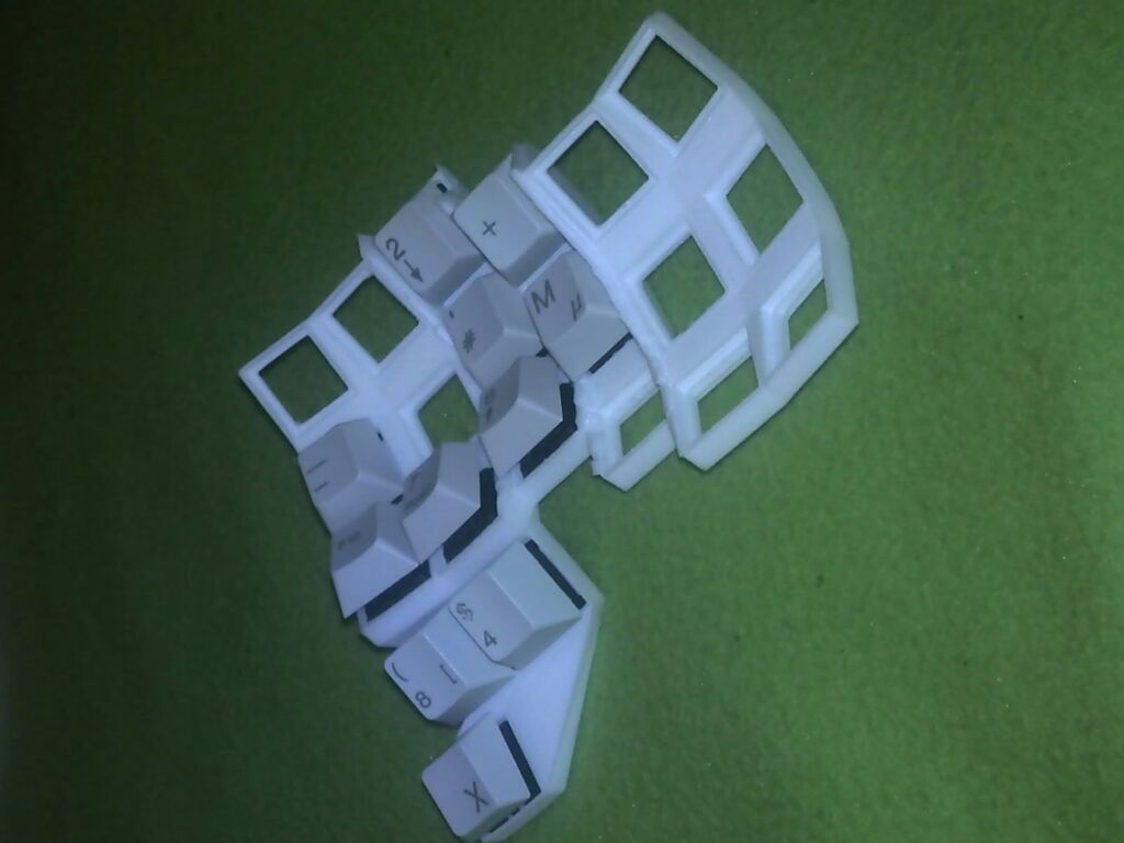

26 Apr 2012, 23:42
while you're taking pics, could you do a sideshot of that one?
'cause it's a true mindfsck for me atm; the top pic vs the bottom one 'render' completely different things in my head xD
noted that small (custom?) caps are required for that thumb-block on the middlepic.

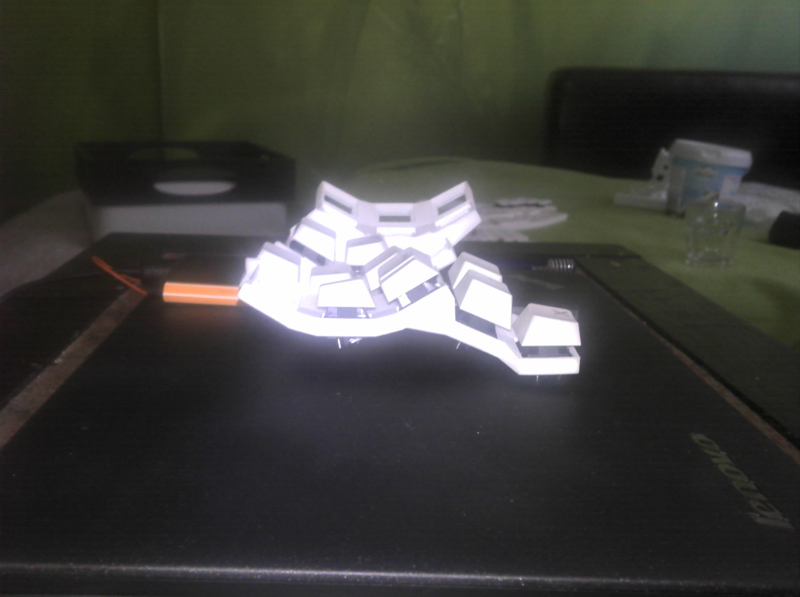

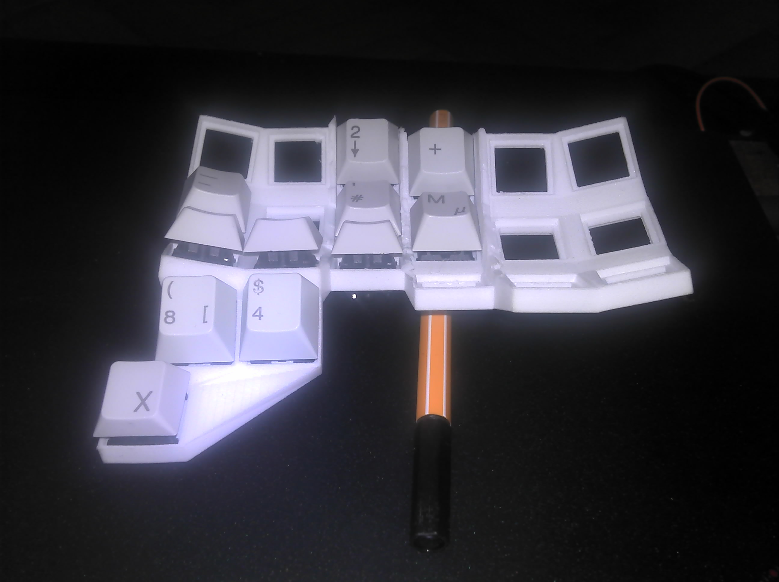

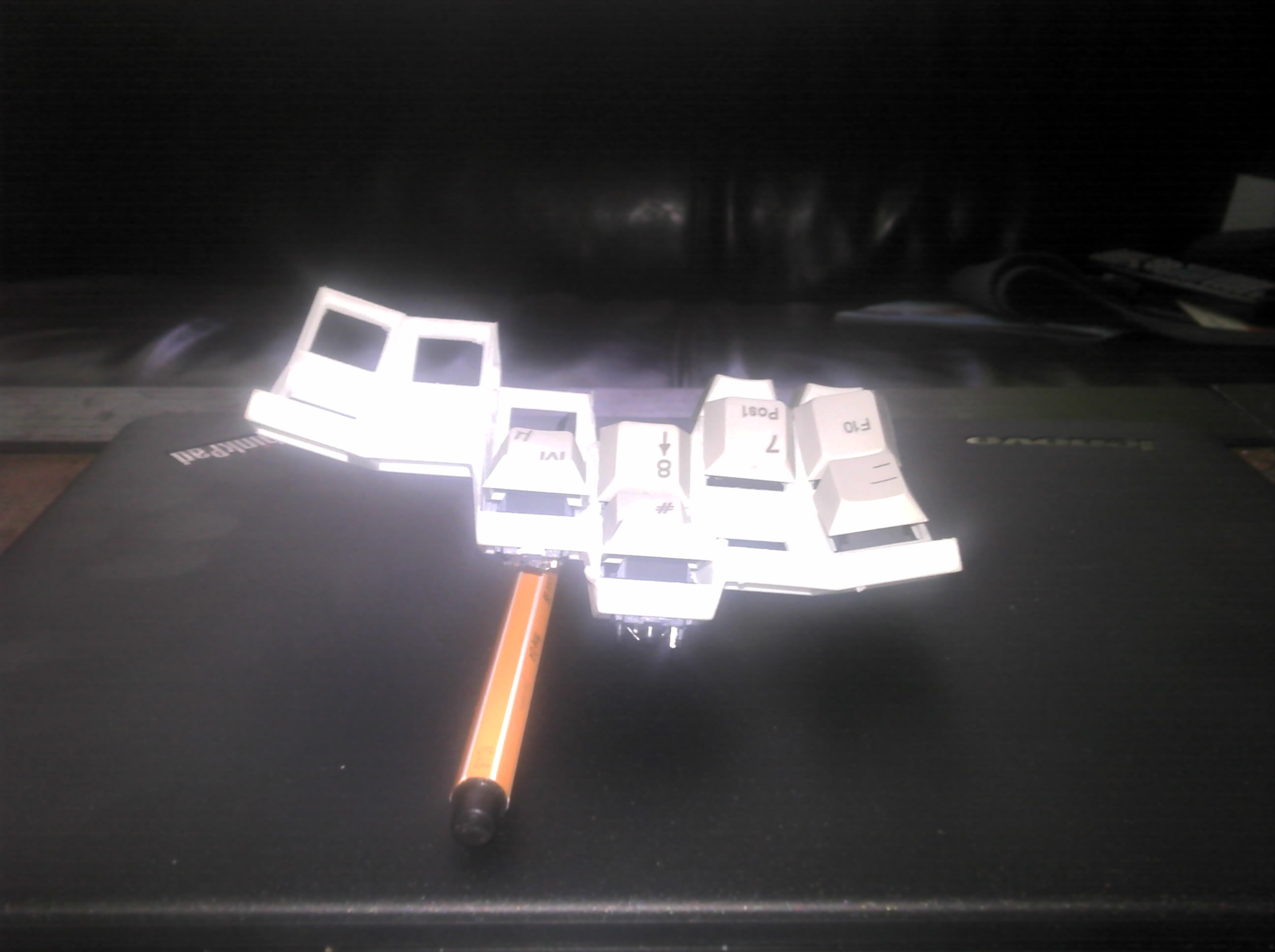

off wrote:while you're taking pics, could you do a sideshot of that one?
Sure, here they are (please excuse the bad quality): I put a pen under it to show its warp, it was of course intended to be tilted upwards with the pinky row staying on the desk. But in this position, the "X" on the thumb and the center middle finger "#" are level with the ground, while other columns are offset in two directions and the outmost ones also tilted slighly.
All in all a promising idea, but from my experiences overly complicated...
Seen from front, X and # are flat on the ground
Notice the individual offsets per column
Should be tented with pinky row on desk during use, of course

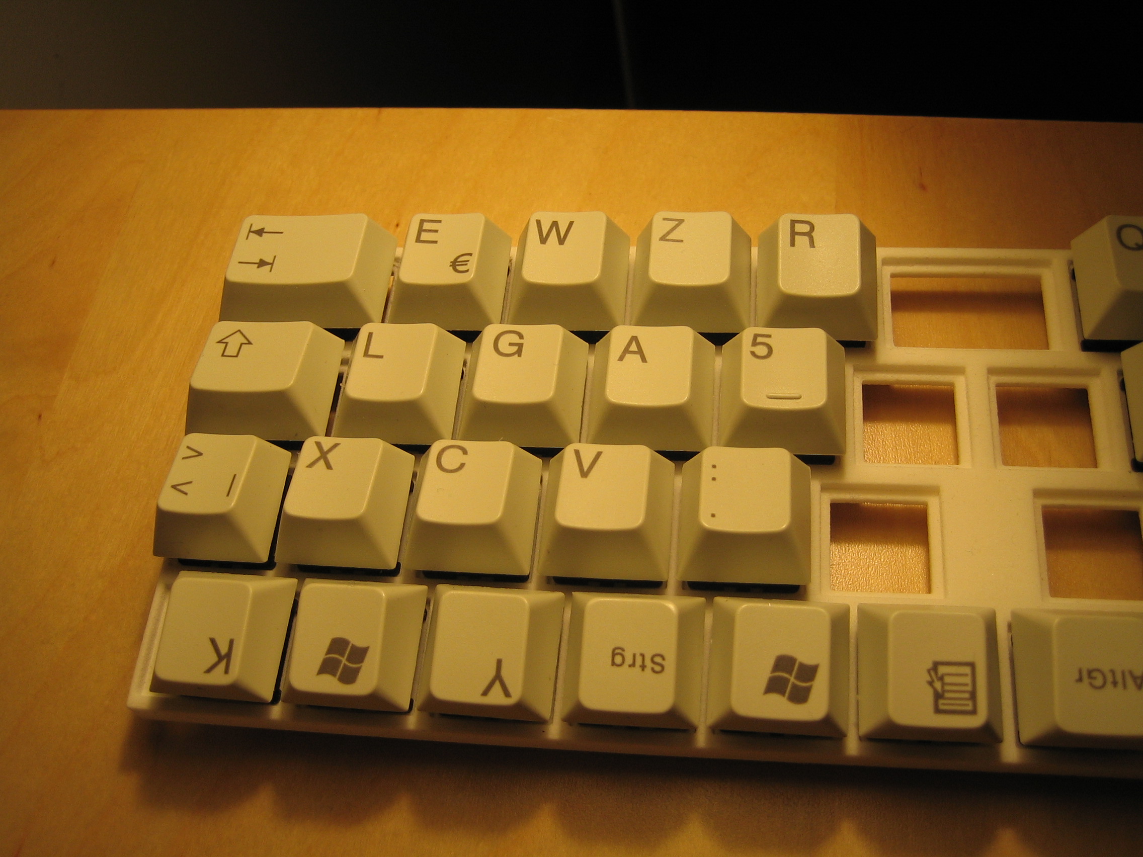

I also made keycaps for both ML and MX, but only very simple flat ones in different sizes you'll notice in some of the pictures - but switched to designs using standard cherry ones as that was another lesson learned: the well-shape and very smooth finish helps a lot in constantly re-orienting your fingers in the right position. It was more difficult (but not impossible) to adjust to the rougher flat surfaces of for example above winged design.

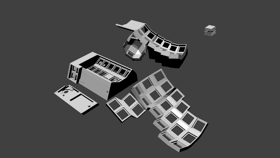

Here's an old blender source with several prototypes - sorry, I haven't got access to the warped, smooth one atm but I'll post it when possible. These are simply demonstrators, no guarantee dimensions are exact and tested for this file...
Thats inside...
Thats inside...
kb-prototypes.zip
Blender source of above 3 models in early state
(775.95 KiB) Downloaded 586 times

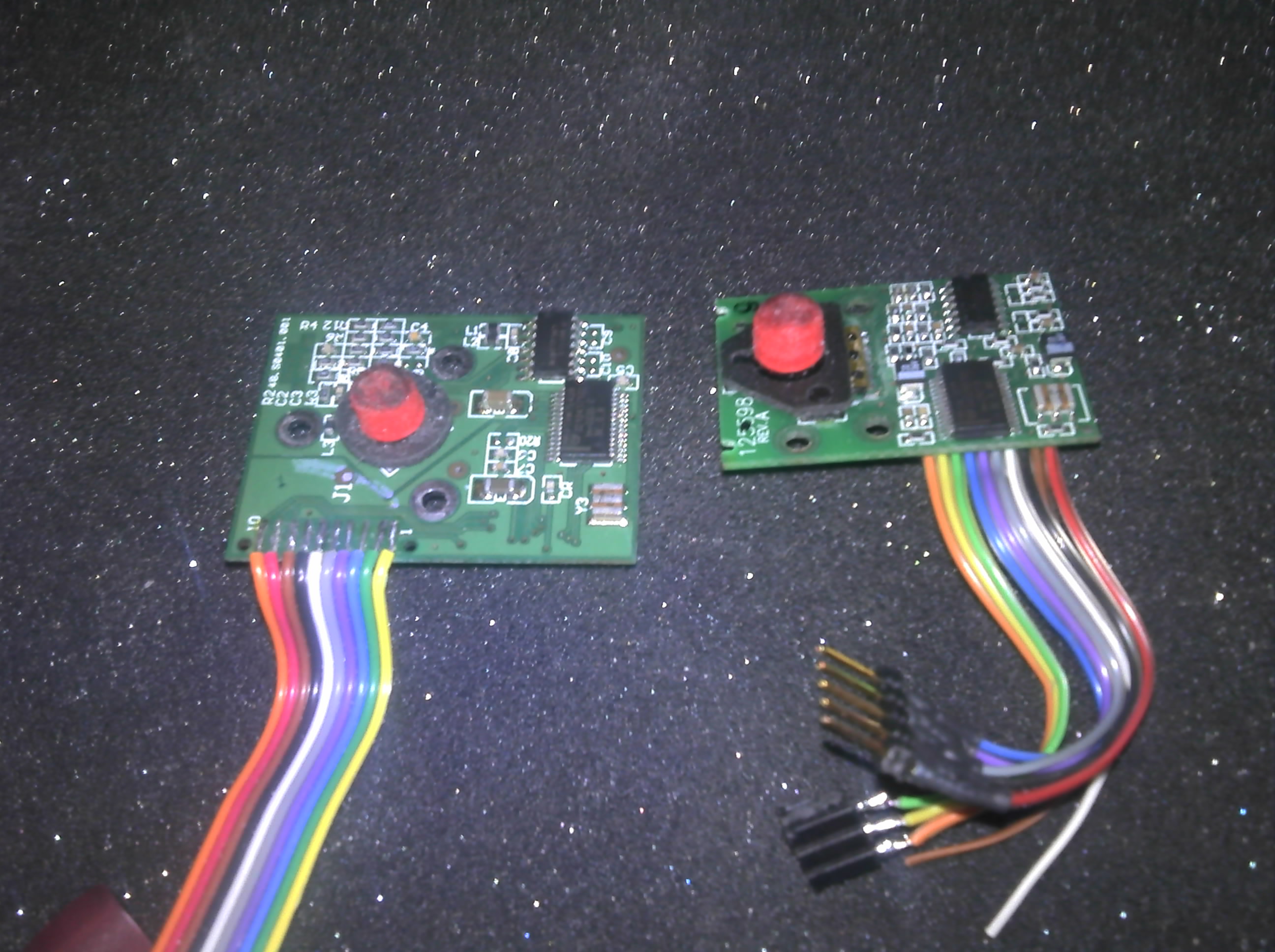

CeeSA
11 May 2012, 20:27
great, i am speechless.
could you give some technical information about the trackpoints you use?
You use IBM trackpoint you stated, but i like to know more about pin assignment and so on.
suka
frobiac
11 May 2012, 23:55

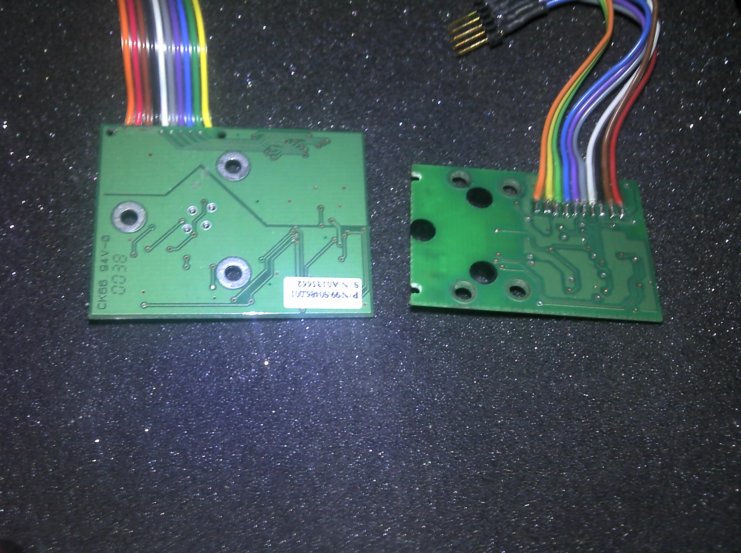

I used two different trackpoints from scrapped laptop keyboard replacement parts: While different PCBs are used, both employ a design as described in a pdf from Philips "Microcontroller with TrackPoint microcode from IBM" (TPM754) that I found on http://www.datasheetarchive.com/TPM754* ... datasheets. The serial numbers on the PCB did not really help as I found no references to them anywhere, but the TPM754 (or its A revision) seem to be used in most TPs I have come across so that should be a good start
I am not sure 100% about the larger, left one in the pictures, but I think it also had the same pin assignment as the lower one I recently built into my keyboards:
red: RESET
brown: unknown
black: DATA
white: unknown
gray: GROUND
purple: VCC +5V
blue: CLOCK
green/yellow/orange: 3 Buttons
It can then be registered in my firmware as a normal PS/2 mouse, or most likely even directly attached to a PC if you solder a plug to the appropriate pins and attach some buttons.

Excuse the bad picture quality, if you need more details feel free to ask.

hasu
27 Jun 2012, 05:41
You can get specification of TrackPoint here.
http://wwwcssrv.almaden.ibm.com/trackpo ... nload.html
You may be interested in TrackPoint specific PS/2 commands described in this spec. It seems you can invert axis, calibrate and even configure ADC with the commands! :o

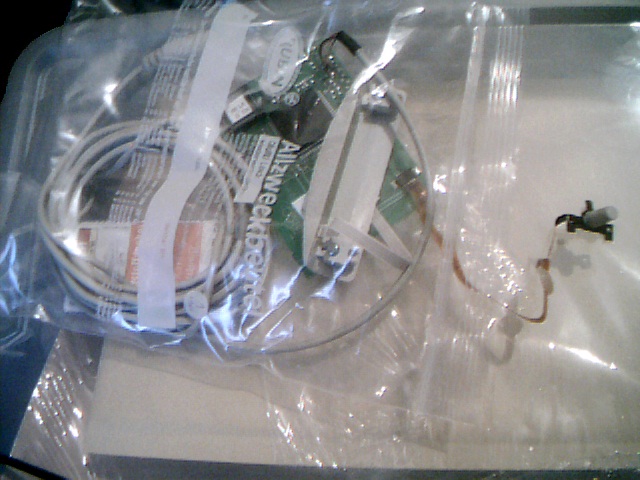

I was going to ask if you have use for some trackpoints...I am sitting on a pile of 100 g81 desko boards with trackpoints, that will most likely end up in the trash.
The actual trackpoint "footprint" is tiny and connects to the pcb with a ribbon cable. The two mouse buttons are on a seperate ribbon cable, attached to that white plastic piece. PCB plug attached.

Ascaii wrote:I was going to ask if you have use for some trackpoints...I am sitting on a pile of 100 g81 desko boards with trackpoints, that will most likely end up in the trash.

Well, I was going to use my last original IBM one for this, but yours look much better suited for a custom design. With their smaller footprint I guess you could even fit them between the switches without having to increase the base height for the PCB. Thanks for your offer, PM sent.
