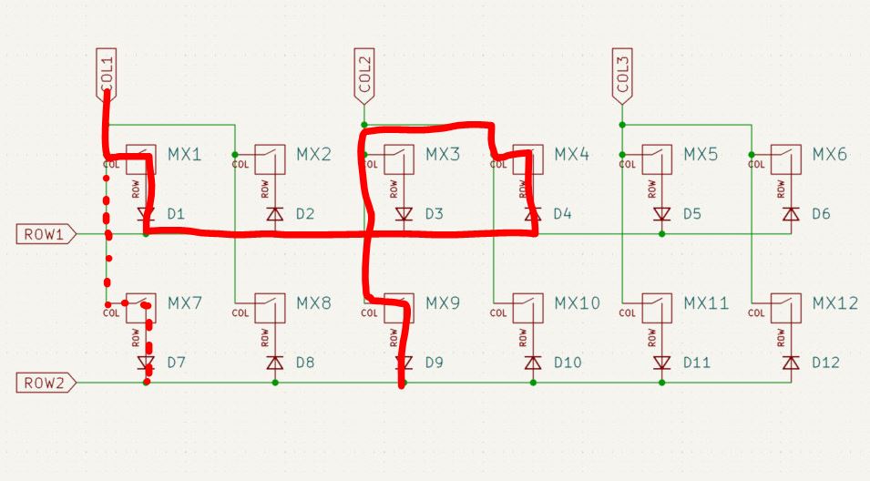

Hey, did you know you can handle 200-300 switches with a simple Pro Micro? I cover the 200-switch solution in my write-up titled The Japanese duplex matrix
25 Apr 2022, 18:30
Oh! That's actually rather neat. Kinda makes me want to try a Nice!nano all the more now. Only drawback is the matrix itself has to be designed with this shared column / alternating diodes in mind, so no using stock PCBs.
Speaking of PCBs: got an example of one to share? Your diagrams understandably deal with the trivial 3 × 2 case, but a visual of what a 60% or greater really looks like with this arrangement would be illuminating.

Is the Japanese duplex matrix truly NKRO?
In 3.3V application it's probably not an issue though. A generic 1N4148 diode has a forward voltage drop of around 1V so I guess by the time the signal makes its way through 3 diodes it's low enough that the GPIO registers it as off.
With the mega 32u4 and 1286 on their way out this definitely makes the little nRF chips a lot more appealing.
Also neat that there's a name for the overlapping rows; I thought I came up with something for once :/
jsheradin wrote: 07 Dec 2020, 01:26 Image

Muirium wrote: 25 Apr 2022, 18:30Speaking of PCBs: got an example of one to share?
I was fascinated by the theory but haven't tried it yet.
As I can see, this matrix style was picked up in Japan late 2018, early 2019, and many projects from that time have disappeared from the net.
On the other hand, members of the Japanese community tend to keep their PCBs closed-source in general.
So e.g. the Angel64, which I guess uses this matrix, has only a build log: https://kakunpc.github.io/buildguides/angel64/
I'm not sure this helps.
25 Apr 2022, 21:07
Diagonals to dizzy the mind! Well, mine at least. It’s pretty busy as you’d expect.
Can’t say I can follow it (without pulling out the tracing tools, which I shan’t for once).
Jsheradin’s point about ghosting is noteworthy, however:
Looks to be 2KRO. That third key triggers a phantom fourth.

Follow-up to my Japanese duplex from last week: I'll have to update that post with some explanation why and when the voltage drop across three diodes may take care for ghosting.

Muirium wrote: 25 Apr 2022, 21:07Looks to be 2KRO. That third key triggers a phantom fourth.
I'll have to update that post with an explanation.
By carefully choosing diodes (voltage drop matters a lot!) this should work with both RP2040 and ATmega32u4 without ghosting.
Or if you have tons of 1N4148s at home you can use two of those for each switch with the atmega.
