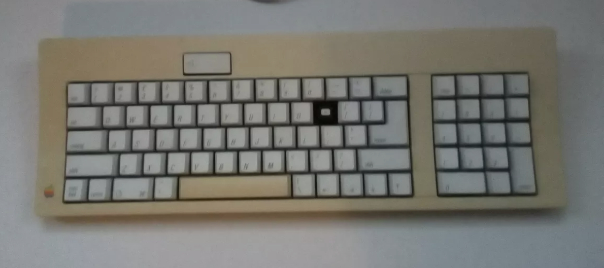

Also, the Arabic version of the M0116 is listed in the wiki as sometimes having white Alps. But perhaps the contributor meant damped white/cream? I’m aware of this as I checked this yesterday having stumbled upon an M0116 on ebay with this blurry photo:
Definitely not an orange or salmon slider. Annoyingly I lost reception before I could make a bid - maybe someone here nabbed it and can report?
Palatino
01 Mar 2022, 22:45
No reports of anything but Salmon or Orange in this thread: https://geekhack.org/index.php?topic=92659.0
I’m really intrigued now. But maybe it’s as simple as a previous owner transplanting white switches into the keyboard.
