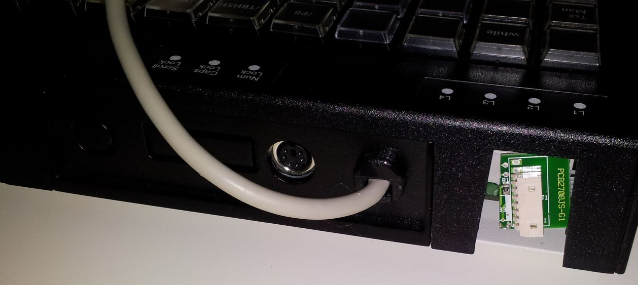

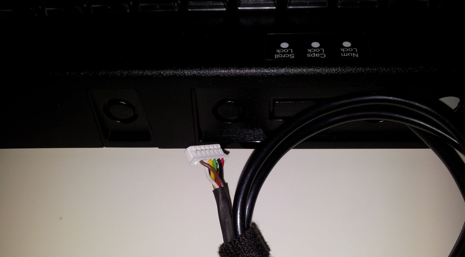

ok, here you are:
internal con1.jpg (71.99 KiB) Viewed 4329 times
internal con2.jpg (85.4 KiB) Viewed 4329 times
This connector (male and female) was part of the cardreader.
Just cut the pcb with the female connector. The male part connector is soldered to the tipro internal connection bus/connector.
After connecting, the plug (of course not the cable) can be hidden in the casing. Could you imagine?

Yes!
Now only a small metal bracket to mount the connector in place, and perhaps some rubber (or metal/plastic from the cardreader casing) to make it a clean and easy connect/disconnect.. perhaps something like heatshrink around the loose connector on the cable and it's bloody awesome! Thanks for pics.
To be clear, this was relevant only because he removed/disconnected the controller from one of the boards. Right?
CeeSA
10 Jun 2012, 19:08
yes, that's right.
