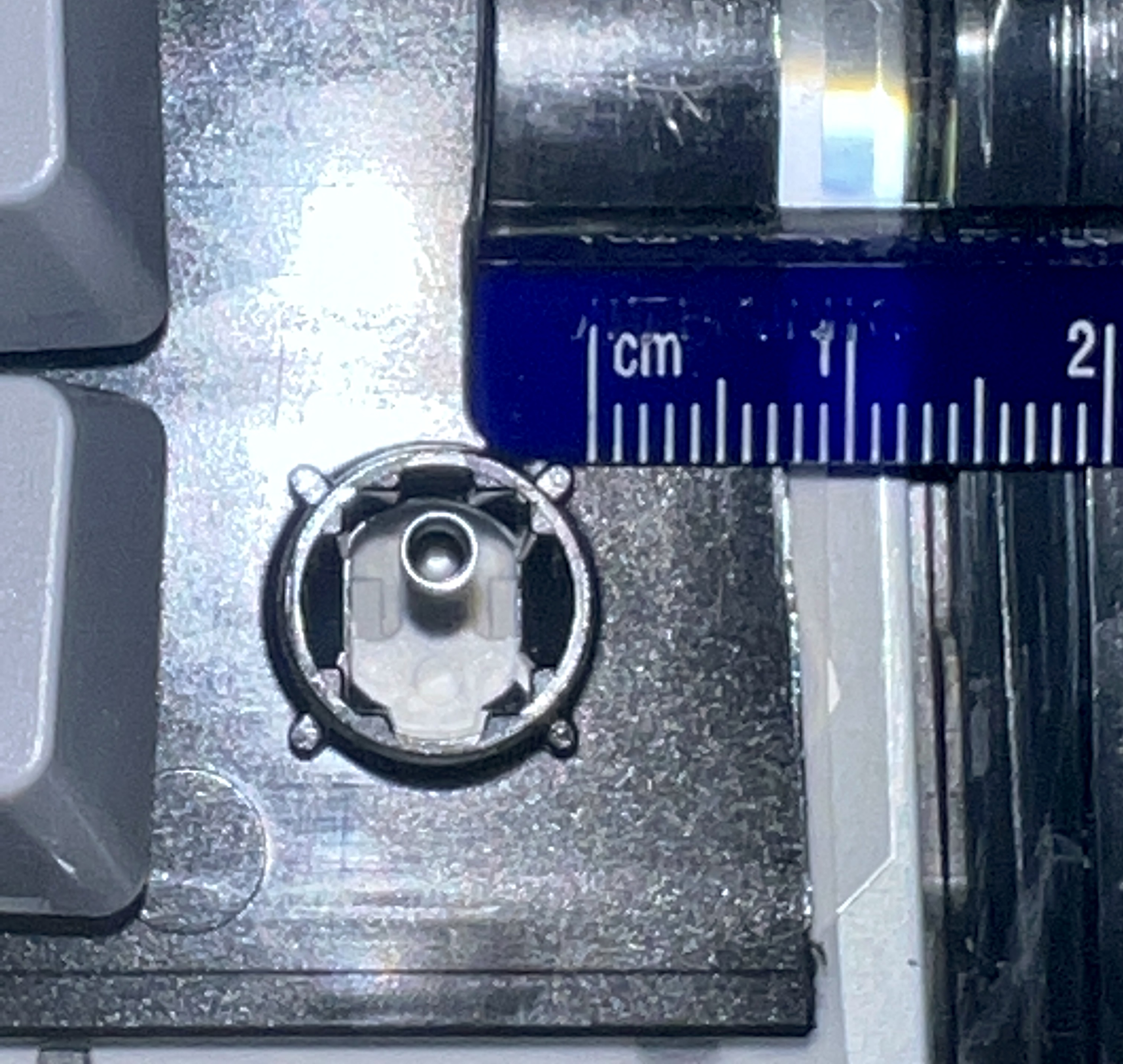

thefarside wrote: 19 Nov 2022, 11:50 If you can provide the dimensions I can measure my Mini M and confirm if they’ll work.
Can you measure the distance from the right side of the furthest right barrel to the right side of the barrel plate, and the left side of the furthest left barrel to the left side of the barrel plate?
Even if the PCBs don't support Mini M this time, the plates might as well.

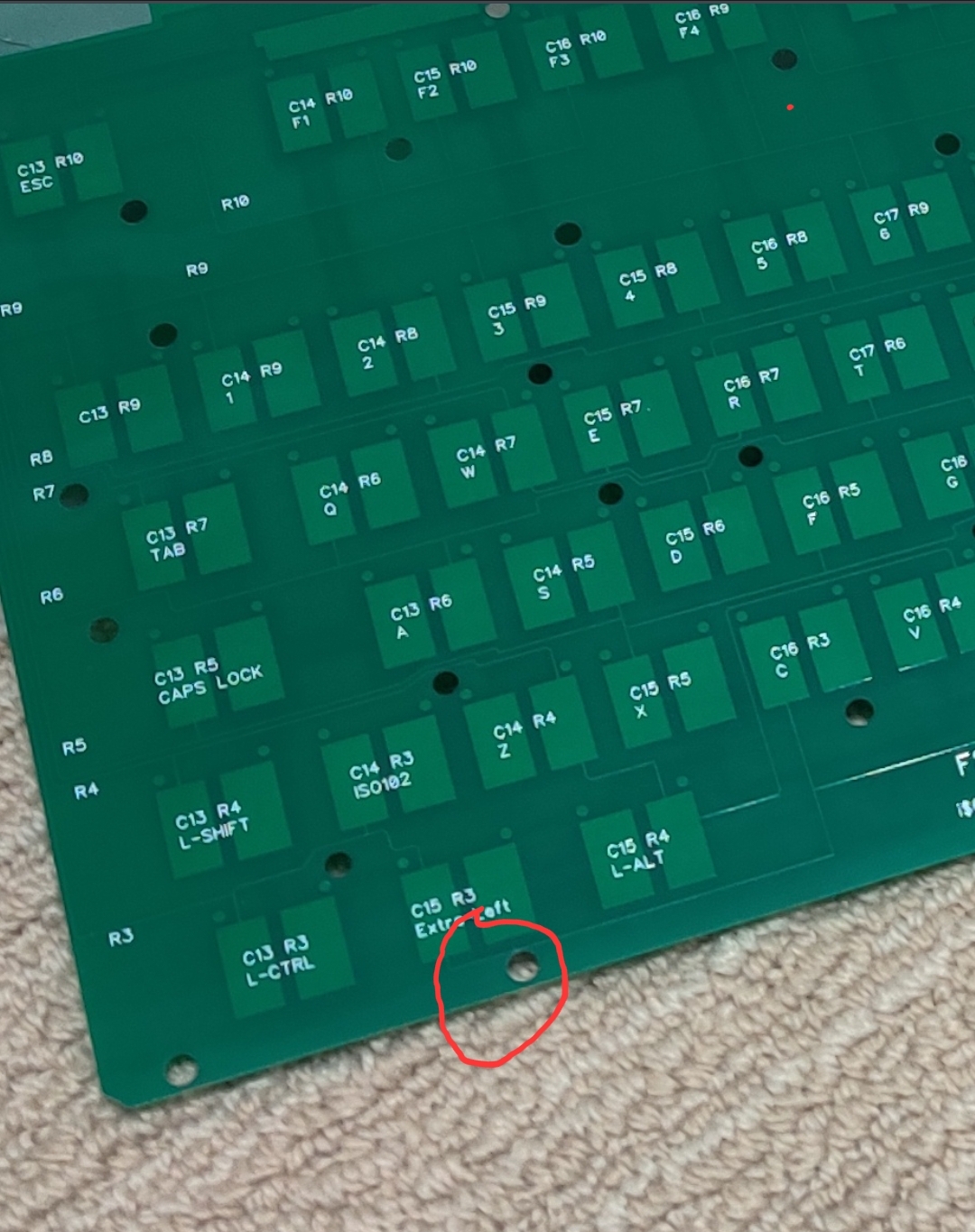

DMA wrote: 19 Nov 2022, 17:05 Since we're editing PCBs - please add vias between floating pads and the pads under them - one small via, somewhere in top 3mm of the pad.
I guarantee you this will result in way better signal when key is pressed, without affecting the resting state - which, in turn, will virtually guarantee lack of xwhatsit-specific problems with sensing.
I have been told by multiple people who are far smarter than me to not use VIAs on thin, curved PCBs, so I hope you understand my reluctance. I could try this out in the future, as I will definitely be designing more capacitive PCBs, but for now I want to try to limit the scope of this project: the more innovations I try to include, the longer it will get pushed out.
The FSSK PCB is a known working PCB, and although I'm sure it can be improved, I don't think now is the time, at least not for me.
I understand that you know way more about electrical engineering than I do and I really appreciate your feedback; please don't take this as an insult.

taylorswiftttttt wrote: 20 Nov 2022, 06:14 Unfortunately the 74AHC595D,118 shift register used in the SMD Model F Controller is out of stock on JLCPCB's in-house parts inventory.
I can serve as a PCBA shop if you send me the parts, PCBs and a stencil (although with no QFN parts stencil isn't really required, I can just hand-solder it all). Will even do initial programming. May even be cheaper - depending on parts costs.
taylorswiftttttt wrote: 20 Nov 2022, 06:14 I have been told by multiple people who are far smarter than me to not use VIAs on thin, curved PCBs, so I hope you understand my reluctance. I could try this out in the future, as I will definitely be designing more capacitive PCBs, but for now I want to try to limit the scope of this project: the more innovations I try to include, the longer it will get pushed out.
The curvature is pretty small, so risk is virtually zero - but ok, I semi-understand. You are driving that part, after all. Double-check, however, that you don't touch any traces with your edits - xwhatsit (at least the exemplar I had my hands on) _severely_ overdrives the columns, and column traces locations and lengths _are_ pretty critical. Same goes for extra keys - unlike the vias, it's a _real_ minefield for xwhatsit-based designs.
taylorswiftttttt wrote: 20 Nov 2022, 06:14 I understand that you know way more about electrical engineering than I do
I don't. But I have 3 F122 PCBs in my garage with pretty interesting modifications. So the vias advice comes from practice - it boosts the readout about 6x, which boosts the SNR about 6x.
taylorswiftttttt wrote: 20 Nov 2022, 06:14 please don't take this as an insult.
None taken - you're driving this, it's your authority.

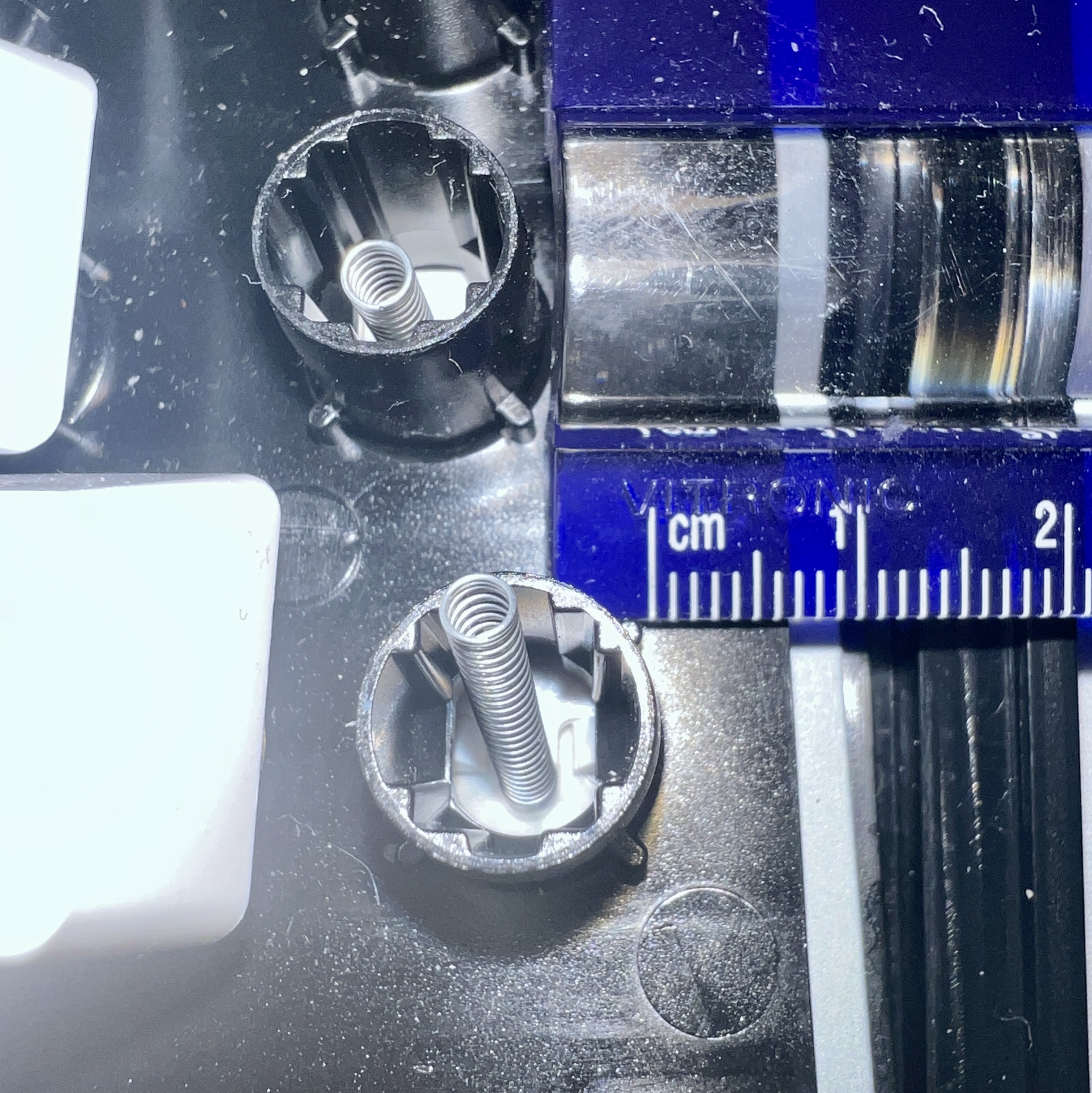

The right side appears to be a little over 7.5mm from the rightmost barrel to the edge of the barrel plate.
The left side appears to be 6.5mm from the leftmost barrel to the edge of the barrel plate.
Hope this helps!

DMA wrote: 20 Nov 2022, 06:54 The curvature is pretty small, so risk is virtually zero - but ok, I semi-understand. You are driving that part, after all. Double-check, however, that you don't touch any traces with your edits - xwhatsit (at least the exemplar I had my hands on) _severely_ overdrives the columns, and column traces locations and lengths _are_ pretty critical. Same goes for extra keys - unlike the vias, it's a _real_ minefield for xwhatsit-based designs.
I will have to try this out the next time I order capacitive PCBs.
thefarside wrote: 01 Dec 2022, 01:54 The right side appears to be a little over 7.5mm from the rightmost barrel to the edge of the barrel plate.
Thanks! The distance on either side of my barrel plate is just under 9 mm. Judging by your pictures, this is a little less than the width of the back plate, so, the plate will probably fit, but again, I cannot confirm it.

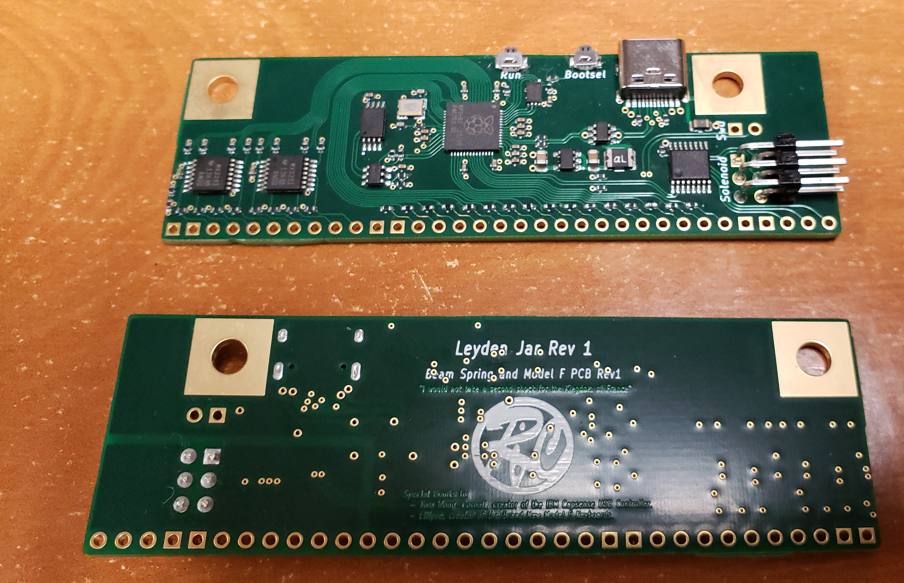

I’m kinda mesmerised by these RP2040 capsense controllers–check those curves–but tried and tested is good, too.

Great update for a great project. This MF things and their derivatives are becoming more and more popular here on DT even though it's already been several years since it was introduced by i$.
My 2 cents advice, regarding my previous experience with jlcpcb, is this: pay attention to the circuit path highlighted here in the attached pic.
Mine was interrupted by the hole, and I had to patch it up
21 Jan 2023, 17:41
Good point. Looks like an accident waiting to happen.
I see the affected key is the “extra” pad, between Control and Alt on an OG SSK. Does a flaw in that trace disable that one spot or does it take out other (actually populated) keys on the matrix?
