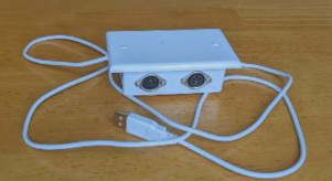

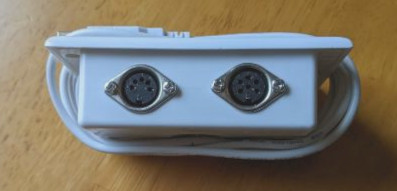

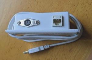

I don't know where you heard that. My old project looks embarrassingly crude, but it works fine.
https://geekhack.org/index.php?topic=58 ... msg1348717
I, quite literally, finished building something exactly like that about 10 minutes ago, only it uses TMK. Yours looks better :D.
That embarrassing guide from years ago proved my concept.
Subsequently I built a nicer one, still using parts from the electrical department at Home Depot.
