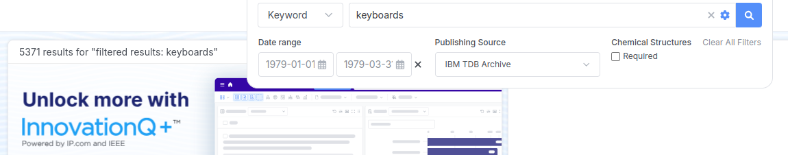

https://en.wikipedia.org/wiki/IBM_Techn ... e_Bulletin
The IBM Technical Disclosure Bulletin was a technical publication produced by IBM between 1958 and 1998. The purpose of the Bulletin was to disclose inventions that IBM did not want their competitors to get patents on. The Bulletin was a form of defensive publication. By publishing the details of how to make and use the invention, patent examiners could have a searchable source of prior art that they could cite against subsequent patent applications filed by others on the same or similar inventions.
Access to the IBM TBD archive is here : https://priorart.ip.com/
You need to select the gear at the right of the search button:
I will attempt to find the attach pdf file as a test.

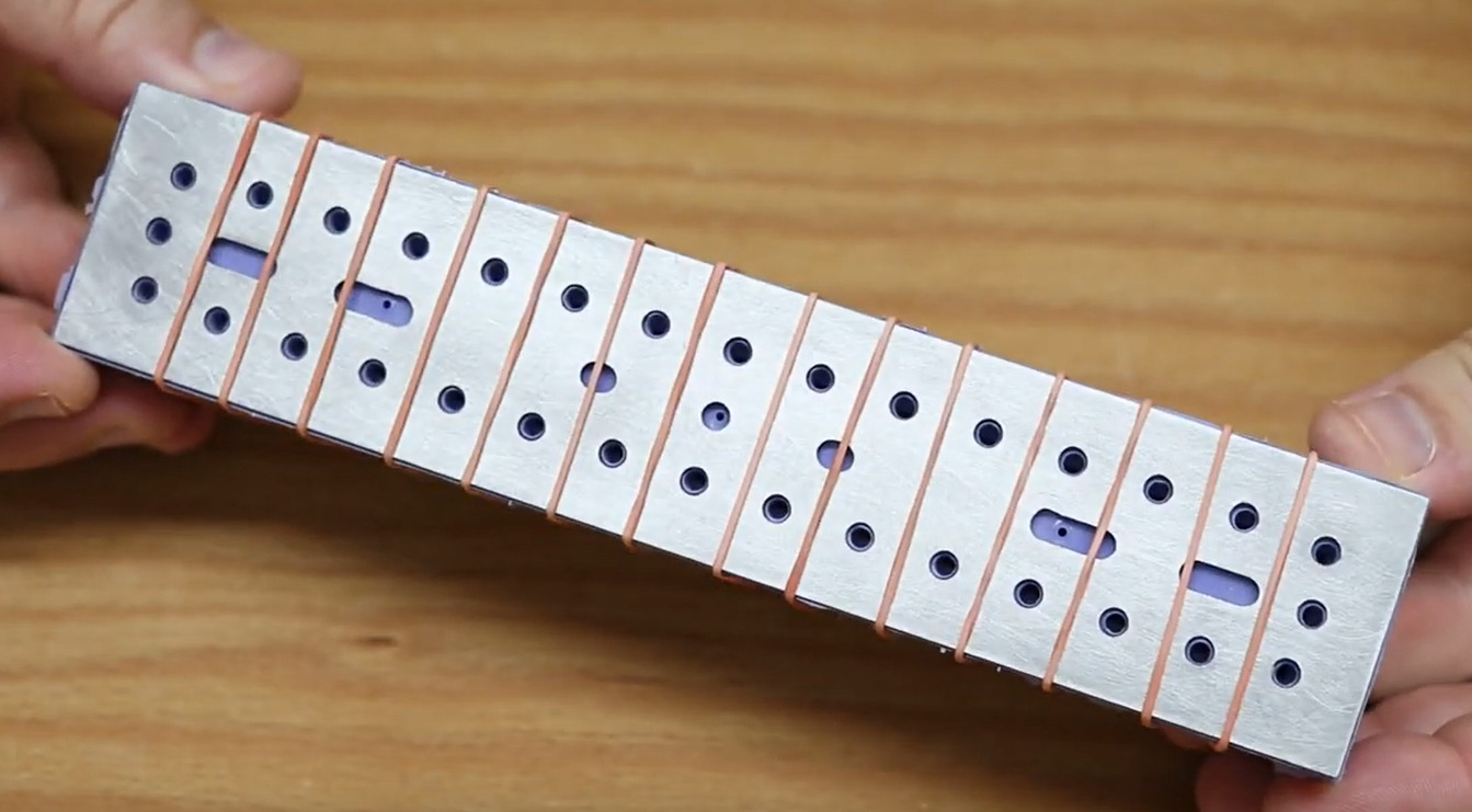

idollar wrote: 04 Jan 2025, 11:47 I wonder if we could create a silicon mold from the original flippers and cast a mix of regular epoxy and graphite
We do not need conductivity but enough conductive material to change the capacitor built in the PCB
Casting is slow and needs vacuum. 3D-printing and painting bottom layer with 843AR will not only be faster, but also cheaper. Sure, 843AR is ~$0.03 per flipper, which is expensive, but compare that to casting setup..
So for functional prototyping 3D-printing should work, for production I recommend finding an injection molding shop willing to do the job..

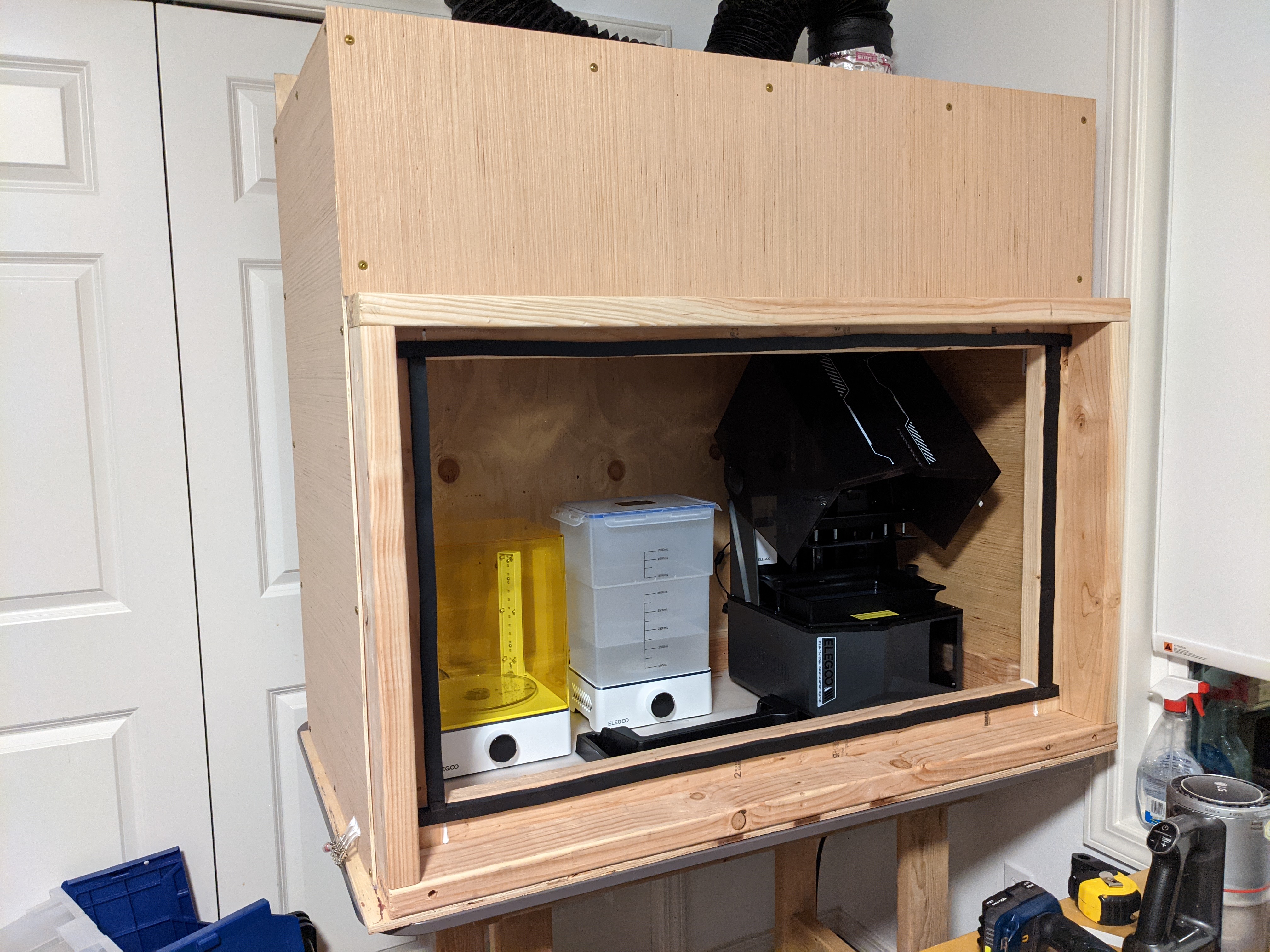

OK, my small additive manufacturing facility is ready for the pilot.
See ya after surgery! (which is tomorrow)

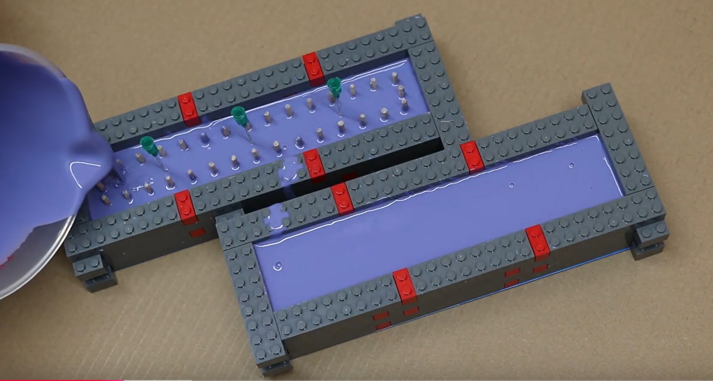

macmakkara wrote: 07 Jan 2025, 13:31 Hi there. Il also post over here as i did few DMs with i$ i proposed resin casting with graphite powder or carbon (fiber). We could 3d print 2 piece mold for testing and do few cast. I don't own 3dprinter but could try to use community one at library and maybe do few test casts.
3d printed parts would not work for resin casting. The resin would get glued to the parts.
Instead you have to use silicone ... search in youtube for "2 parts mold resin casting".
I have already purchased the resine, the silicone and the clay. I have some graphite at home.
I am planning to cast something this weekend. I will take some pictures to document my mistakes :) I have never done it before.

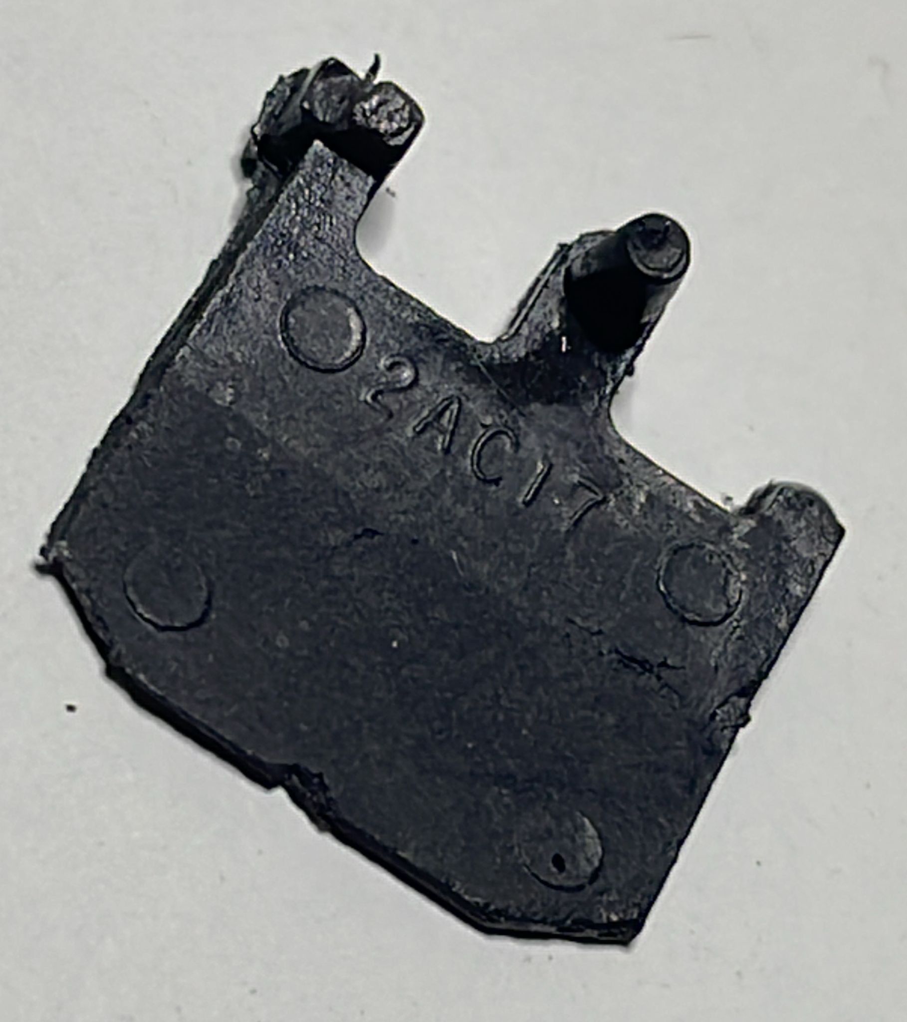

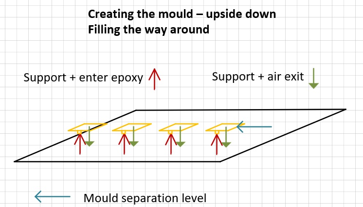

13 Jan 2025, 10:16
Hello,
A quick update on the flippers test during the weekend:
  • I managed to create a mold for the flippers using silicone. This is my first attempt at doing something like this. It's a learning curve.
  • I usedthe following mix:
    • 3 g graphite
    • 14 ml epoxy
  • The resulting flipper was not 100% perfect. A part was missing. I believe this happened because I applied too much pressure on the area holding the two mold parts together, which closed the path for the epoxy.
  • The good news is that the flipper copied all the features (see picture). Note that I have not post-processed the flipper to improve the edges.
  • The epoxy takes longer to solidify than expected. Longer than 1 day.
  • I will try again and may create the mold anyway. kmnov2017 pointed me to a YouTube video with a better technique.
  • I installed a Leyden jar on my spare FEXT PCB:
    • My own compiled firmware, which allows me to check (and modify) the code.
    • Metal grounded plate under the PCB as DMA suggested.
    • Confirmed working with the Leyden jar testing tool and metal on top of the PCB.
    • Confirmed working with the Leyden jar testing tool and the original flipper.
    • My flipper does not work! The level change happens, but it is too low.
    Conclusions:
    • Producing flippers by casting with silicone molds is possible. It's just a matter of finding the correct procedure.
    • Graphite will not work. Adding more graphite will be difficult.
    • I am thinking of using copper pulver in my next attempt.

[*]My flipper does not work! The level change happens, but it is too low.
3/17 = 17%. 4g graphite+13ml epoxy will be 23% - which might just be the ticket (could be mechanically unsuitable, in which case better carbon black might work - may be even at original 17%). Copper flakes, depending on particle size, might also work.
idollar wrote: 13 Jan 2025, 10:16 [*] The resulting flipper was not 100% perfect. A part was missing. I believe this happened because I applied too much pressure on the area holding the two mold parts together, which closed the path for the epoxy.
Could also be that there's no way for air to escape, and air from the empty space forms the higher-pressure bubble which prevents epoxy from flowing into that area.

Hello DMA,
Good to see that you are back on track :) !
DMA wrote: 14 Jan 2025, 07:57
  • 3 g graphite
  • 14 ml epoxy
Copper was ordered yesterday. It is in its way.
I must admit that the intended proportion was 5+5ml (epoxy) + 5 g graphite.
The procedure which I had in mind was to mix 5g graphite with 5ml of epoxy part-A. Then add the part-B
But when checking the graphite I thought that it would not mix with 5 mm or epoxy.
Also I went to far with the part-A ... so I had to mix 7ml.
For next attempt I will try to mix:
  • 5ml part-A with 3g of copper
  • 5ml part-B with 3g of copper
  • mix the two together.
Lets see if I do not make again mistakes.
In any case is just a prove of concept. Going in a massive production 1000+ this way may not be suitable.
The other sourcing threads are been tracked in paralell.
No, this was not the case DMA.
I made sure that I injected the epoxy from to top (where the spring fits the flipper) and I made a hole to exit the air on the very bottom of the part.
I am sure that I need to play with the rubber bands to:
  • put enough pressure
  • distribute it across the full mould.
The walls that I used to hold the silicone were not straight neither. It looks so bad that I did not post the images :)
In my next attempt, I plan to use lego blocks, as I saw in the video from lispnick here. It is always good to listen and learn from the real masters :)

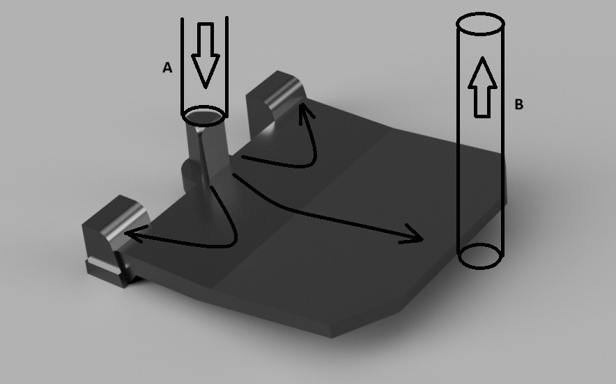

Hello DMA,
There is only one low point and a high point.
This is the configuration that I have used in my first attempt:
Flipper 1.jpg (54.1 KiB) Viewed 24519 times
I added some wooden sicks to create a channel on "A" and exit air on "B".
My plan for the next attempt is to:
  • Use LEGO for the walls.
  • Design and 3D print a plate with support bars holding the flippers upside down. I can make many at the same time. The flippers will be placed on top of these bars at the same height. I need to find out if I can add some small glue points to hold them in place.
  • The plate will be placed at the bottom of the LEGO walls, with the bars pointing up, creating the "A" channels for the different flippers while also supporting them.
  • I plan to use syringe needles attached to the same plate to create the air exits ("B") and support the other side of the flippers. They are thinner and will retain some pressure inside. These can be positioned in the middle of the flipper. Once again, lessons learned from Lispnick here.
  • I will fill the mold up to the flat part of the flipper with silicone and let it dry.
  • I will then spray some liquid on the top surface to allow for the separation of the two parts.
  • I will pour more silicone to create the second part.
second attempt.jpg (80.75 KiB) Viewed 24519 times

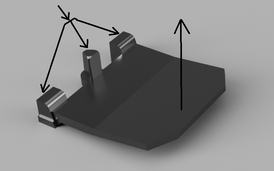

DMA
16 Jan 2025, 04:01
idollar wrote: 15 Jan 2025, 10:28 There is only one low point and a high point.
If there was high/ultra-high vacuum inside the mold - that would indeed be the case. But there's 1atm air there, and as epoxy flows into the mold, it will eventually create air bubbles in the flipper feet (pointed by bent arrows on the drawing).
In injection molding air naturally escapes via parting lines and around ejector pins. Still, sometimes dedicated vent channels are needed - even though plastic is forced into the mold at tremendous pressures. Here's some random (but decent) internet site explaining in more detail.
So, in your case, epoxy pressure is way lower, and air bubbles won't even be compressed 2x. Which means, in current configuration, that the moment epoxy reaches point "B", all the air remaining within the mold will be forced into the feet. In your first attempt, you got lucky with one foot, but not so lucky with another. You should puncture a very thin channel into the mold at all local high points. After the epoxy reaches "B", you should close it with something, and try to push more epoxy into "A", to ensure there's no air pockets left.
Alternatively, you can remake the mold so flipper is "feet-down". The idea is to fill the mold from the local bottom points, ensuring there's no places for air bubbles to form. IF your epoxy is *very* low-viscosity, you can try it with one inlet and hope the feet will be filled before epoxy cuts them off the exit gate (because if that happens - air will need to form a bubble, and that's hard).
..anyway. I'm still at the "printing exposure calibration targets" phase - resin printing is surprisingly messy and surprisingly hard at the initial setup phase. Will report once I get to something.
idollar
i$
16 Jan 2025, 09:56
DMA wrote: 16 Jan 2025, 04:01 [So, in your case, epoxy pressure is way lower, and air bubbles won't even be compressed 2x. Which means, in current configuration, that the moment epoxy reaches point "B", all the air remaining within the mold will be forced into the feet.
I see what you mean. I did not contemplated this option. You are correct.
DMA wrote: 16 Jan 2025, 04:01 In your first attempt, you got lucky with one foot, but not so lucky with another. You should puncture a very thin channel into the mold at all local high points. After the epoxy reaches "B", you should close it with something, and try to push more epoxy into "A", to ensure there's no air pockets left.
Another alternative is to enter in the three points at the same time.
As I am trying to 3D print the support, it should not be difficult to create this triple Y
Flipper 2.jpg (49.81 KiB) Viewed 23977 times
DMA wrote: 16 Jan 2025, 04:01 Alternatively, you can remake the mold so flipper is "feet-down". The idea is to fill the mold from the local bottom points, ensuring there's no places for air bubbles to form. IF your epoxy is *very* low-viscosity, you can try it with one inlet and hope the feet will be filled before epoxy cuts them off the exit gate (because if that happens - air will need to form a bubble, and that's hard).
My epoxy was quite liquid to my surprise. But I see your point (again).
It will become messy if I do it "feet-down". I believe that if I enter in the three points at the same time it will work.

DMA
17 Jan 2025, 04:22
idollar wrote: 16 Jan 2025, 09:56 Another alternative is to enter in the three points at the same time.
"at the same time" implies luck. Consider yourself very unlucky when designing such things: multiple exits are OK, multiple entry points - not so much..
So, considering you want to keep flipper position in the mold intact (which totally makes sense - you want parting line to be as close to horizontal as possible), I'd advise to make air exits in the flipper feet and keep everything else as it is. It will be more logical to fill from the "B" point and have both feet and stem as exit points - but "B" a high point itself, currently collecting air from complete flipper foot area. Filling from "B" is likely to introduce air bubbles at the sides of the flipper foot. If I was doing this - I would actually fill from behind in the lowest point, and 4 vents. But I'm prone to overcautious approaches.

DMA
29 Jan 2025, 06:07
I thought that I'll be resin printing power user, but instead it turns out I'm an EARLY ADOPTER. Yes, resin printers are like 10 years old tech, and yet.
I mean, it's OK for printing miniatures - i.e. where absolute size doesn't matter. But the moment you want something that needs to actually be 5.00x5.00mm - all hell breaks loose. Actual size depends on buildplate location! You print 5x5x5mm cube - it will be 5.02x4.99x5.66mm (and if you shift it 20mm to the right - that will become 5.00x5.03x5.66mm, because every point in XY plane seems to get some random shift (so much for advertised 18x24 um resolution!), and bottom 0.4mm gets squashed by "automatic build plate leveling" (there were g-code commands to alleviate that, but latest firmware disables those commands!)).
Unfortunately, my 30 days return window closed two weeks ago, so I'm stuck with this printer.
The lesson here is to test things immediately, folks. Don't buy something unless you allocated time to thoroughly test things out.

DMA
31 Jan 2025, 03:13
@vvp I have Elegoo Saturn 4 Ultra.
I guess my measurement system is too precise - I have 0.01mm resolution digital calipers. 0.02mm over 5mm is less than 0.5%, after all - but those damn marketoids shouldn't promise "16x24 um" resolution then.
I bought a heater - it heats AIR, not vat - but I guess that's OK because my house is kept at +23C at all times, and if printer is turned on for even 30 minutes, vat temperature is above 25C, so resin viscosity shouldn't be a problem.
I was able to finally print Cones of Calibration yesterday so that the sword is fitting the scull but not the fail holes, so I guess I'm good.
Knowing all I know today I would definitely buy the DLP resin printer (who am I kidding, I would order the prints from some website instead). But I have what I have, return window has closed (and in any case I can't simply undo the hole in my ceiling), so I'm printing those flippers and barrels and key stems on what I have - just need to figure out the supports (automatic supports - whether in chitubox or in prusa slicer, generate some Lovecraftian horror 10+mm in height instead of 3mm straight supports they supposed to). So probably a week?
Elephant foot is actually mitigateable - lights-off delay shrinks it significantly, and actually making the printer to not squash those damn bottom layers (which sounds impossible with the damn "automatically leveling build plate" - support sent me some magic gcodes, and I'm trying to pull what those gcodes mean out of them currently) should cure it completely.
