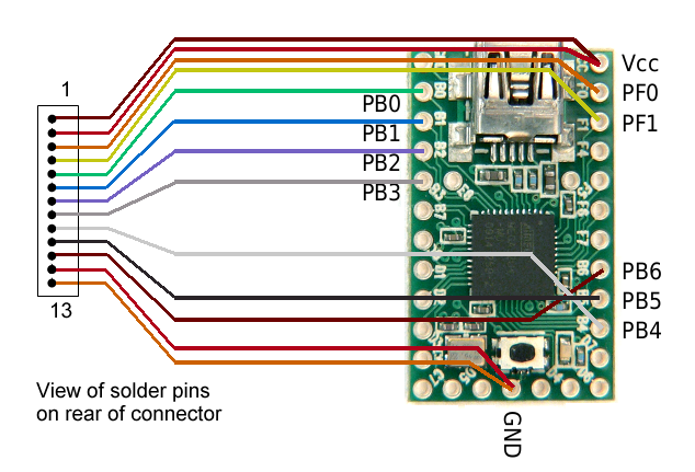

Soarer wrote:The only code changes needed to make it work on the non++ Teensy were in hhkb/matrix.c, to use PF0 and PF1 instead of PE6 and PE7. And of course changing the MCU definition in hhkb/Makefile.pjrc to atmega32u4. Any pins could be used, but those worked out nicely for the wiring.
I was asked in a PM for more detail about the code changes I made for the non++ Teensy, so here they are! These defines match the wiring diagram I posted. It looks a lot more than it really is because this is a single chunk to paste over the existing defines. Just match the first and last lines of the chunk in hhkb/matrix.c...

And in hhkb/Makefile.pjrc, change the MCU setting like this...
#MCU = at90usb162       # Teensy 1.0
MCU = atmega32u4       # Teensy 2.0
#MCU = at90usb646       # Teensy++ 1.0
#MCU = at90usb1286      # Teensy++ 2.0
The other detail is which way round to wire the connector, since it only fits one way. In fossala's Pro 2, the cable to the stock controller had coloured wires, so I used the same colours for the build and the wiring diagram. It's easy to check if you have the keyboard and connector in front of you, so this is just a reminder to check before starting to solder :lol:
This improved wiring diagram now includes the connector. It is from my memory and notes... I will not accept responsibility for any mistakes!!
Please double and triple check, because wiring it backwards would probably be fatal for your precious!!
Soarer

dfxdx
08 Sep 2012, 11:54
Just replicated this mod last night. To my incredible surprise it worked first time - I thought that my not-yet-that-proficient soldering skills would let me down. A very big thanks to Soarer for the excellent instructions and the Teensy++ to Teensy mod, Fossala for the write-up and Hasu for the original code etc. Much respect to Soarer - soldering the wires to the header and still leaving enough room for the heatshrink tubing is quite tricky - good job! If I can add my little contribution to the knowledge base. Should be filed in the 'Difference between a pro and a dumb-ass' section:
1/ Definitely get a decent soldering iron. I am currently using a 12 W model that I bought from Argos years ago. I can only get needle-nosed tips which in itself is not a big issue but the iron has problems heating the end of the tip meaning that I had to continually apply heat from a spot about 3mm from the end. Absolute pain.
2/ Did this late last night and while I did double-check the pin-mappings, I did not double check the direction of the wires going into the Teensy. Managed to solder everything down before I realised the orientation of the header connection and the Teensy. Everything matched the excellent pin-out that Soarer documented but I had the wires going into the top of the Teensy which meant I had to twist the wires 180deg to get the USB connector to match the hole in the case and header connection from the keyboard.
Thanks again everyone.
