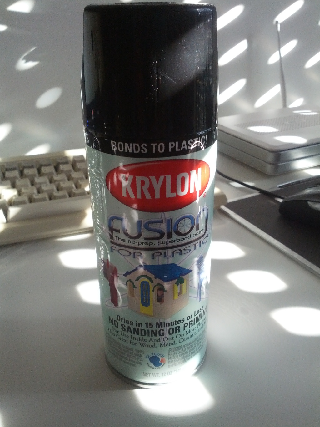

So like i said i've found the krylon can, but i cant understand if this is identical to vinyl dye because its says no priming or sanding.
- Krylon fusion black spray can
- IMG_krylon.jpg (381.64 KiB) Viewed 9730 times

I found sabotaz in an german online shop and its called vinyl spray. I don't know how well it works but I will probably try it soon and then report back.

Fusion is ok, it is not quite as good as others I mentioned prior but they do have a lot more colors. I don't use it unless I really really want some weird color they have like lime green or something. Try it on some old abs plastic scraps or junk keyboard first to make sure it comes out looking like you want and won't hurt to get some practice in because it will make runs if you are not careful.

Sure, it is more like our average spray paints, with a slightly different formula geared towards plastics specifically than the all materials kind. Basically I think it just has less acetone and things that are not so good for plastics. Better to use proper technique to avoid runs etc. though of course.
