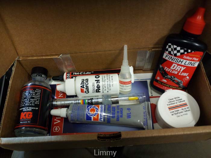

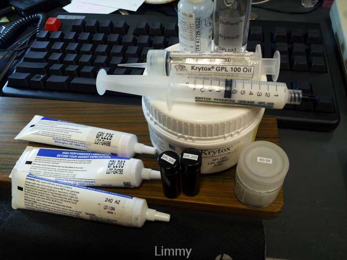

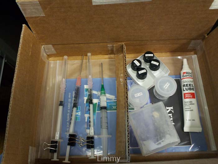

Best solution I found along the journey of lube business was Krytox oil + grease mix. Thin coat of grease + oil spread evenly worked best. Only oil was good enough. Only grease was not good enough. RO-59 was good but left something to be desired.
Here is what I tried so far. The Krytox collection by itself cost me some hundred dollars. I don't know why but lyrics of a pop song came to my mind. "Hey I just met you this is crazy, here is my Krytox collection believe me maybe?"
2012-07-31 16.46.09.jpg (85.79 KiB) Viewed 6842 times
2012-07-31 16.45.01.jpg (80.19 KiB) Viewed 6842 times
2012-07-31 16.43.13.jpg (82.14 KiB) Viewed 6842 times
