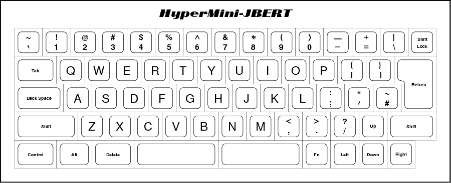

I can add more options if there is enough demand.JBert wrote:Hmmm, quite some interesting stuff, but none like this alternative poker layout. (Although the linked design might have some inconvenience WRT to the small right shift).
Here is how it would look like:
- HyperMini_JBERT.png (20.97 KiB) Viewed 8217 times
